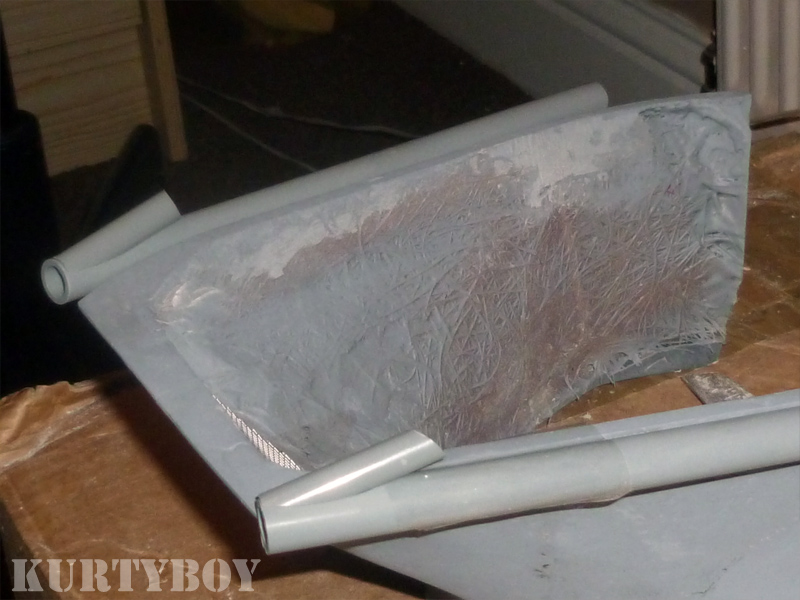

Re: Kurtyboy's new Vader Reveal project is underway! Update 11 Aug: Vocoder

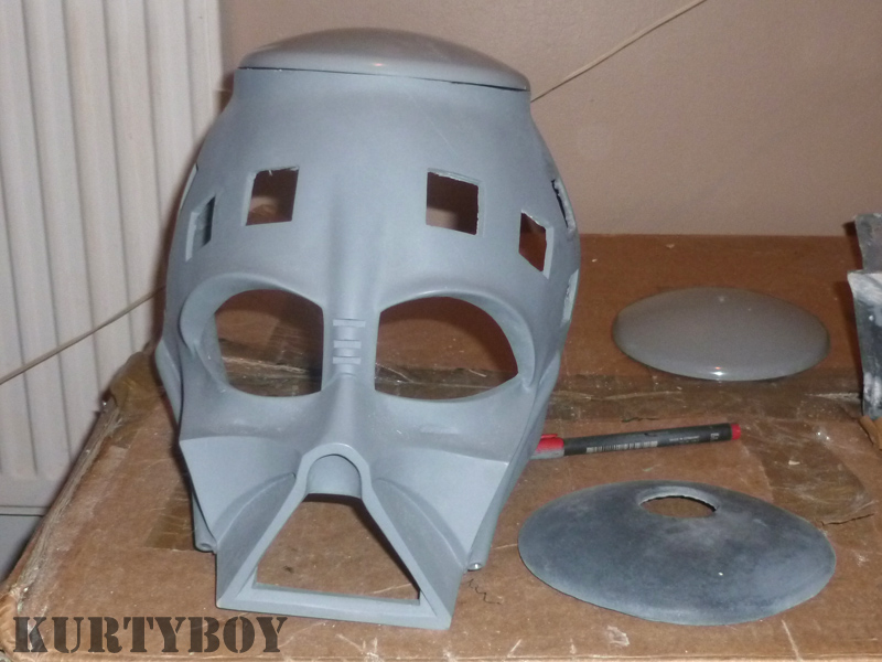

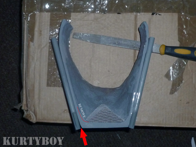

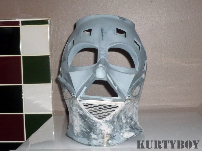

Started to reshape the front of the neck but still much work to do.
Got the other parts of the upper tubes shaped.
Neck is still very wonky. The left side needs more of a curve to it and eventually I will have to shorten the right side. Still unsure exactly what shape it should be so leaving that until later!
Good news is that both sides now form almost perfectly straight lines.
Off with his head!

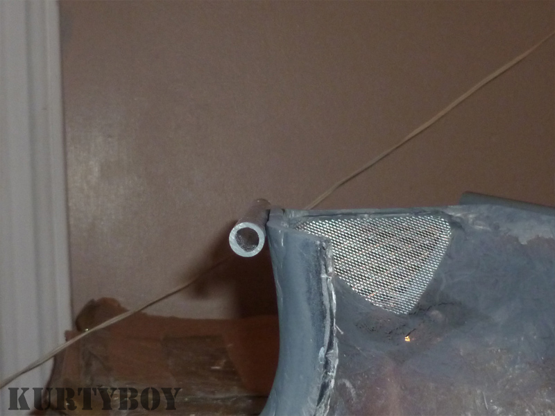

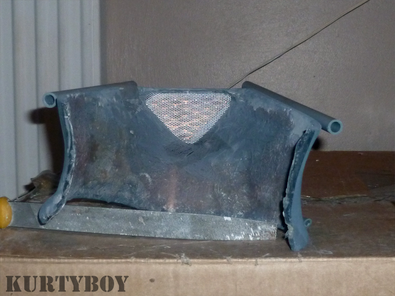

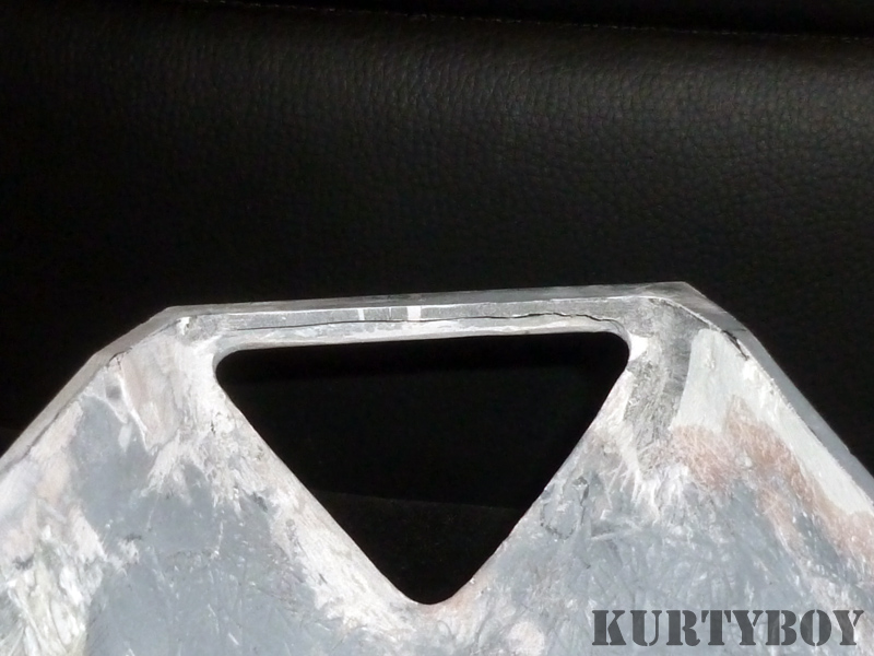

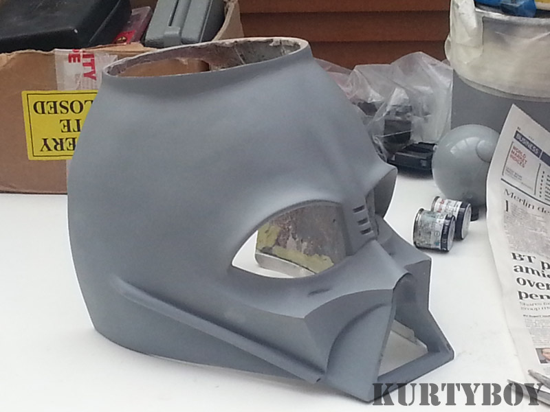

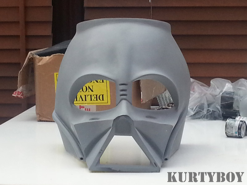

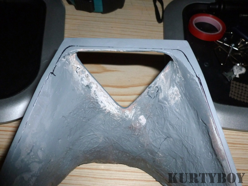

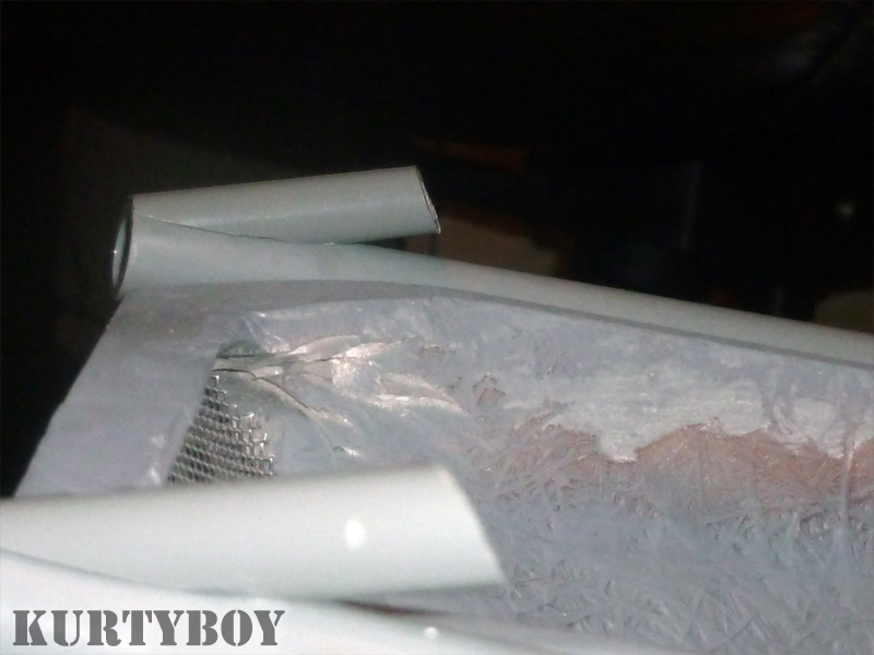

And next.... extending the tubes a little.
Due to the warped nature of this mask, the front of the face and neck were still not lining up on one side so I extended that too.
Things are starting to look pretty good.

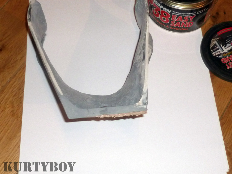

Using a correctly scaled photo of the original to trace the shape of the mouth sill.

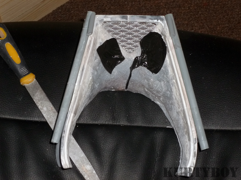

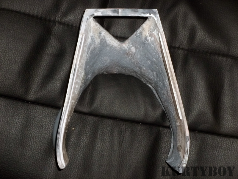

Hey Mark and jameth, the vocoder that Marcus is using was made by me.
It took hours of tracing from high-res photos in Illustrator, scrutinising shots of the Reveal prop from various angles, and is made up of a central block that the mesh and details sit on, and two separate side parts.

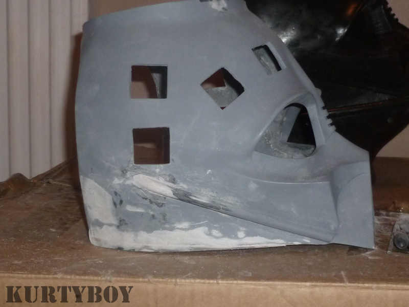

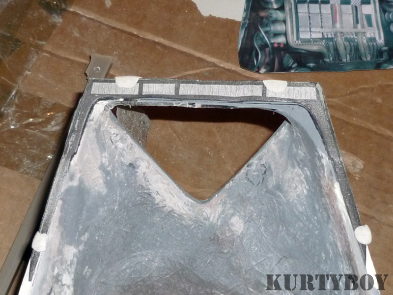

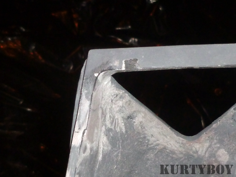

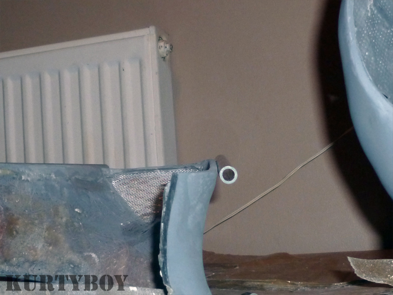

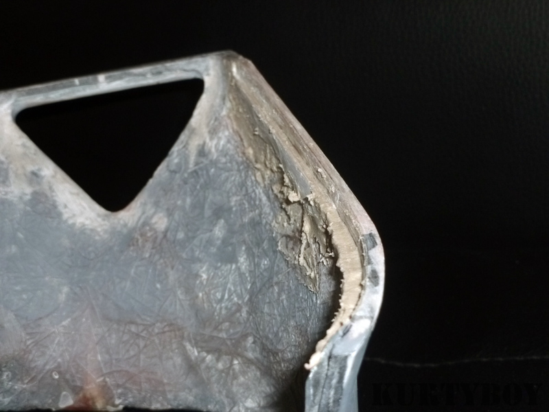

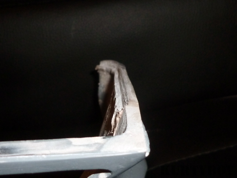

Kurtyboy's new Vader Reveal project. Update 15 Sept: Adding grooves to lower mask

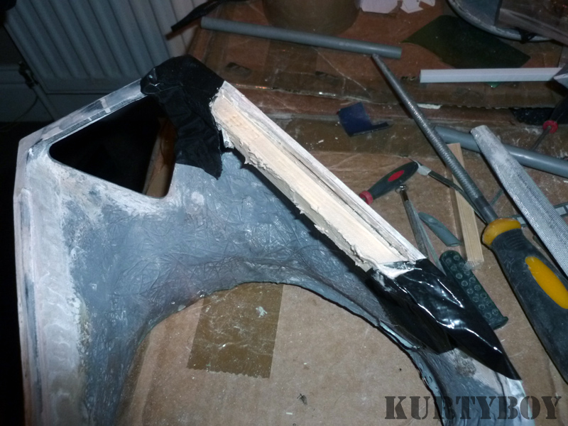

The upper and lower mask parts of the original prop marry together using a rails/grooves system. There are metal rails on the underside of the upper mask and grooves in the lower mask for them to slide into. Here we go with the grooves...

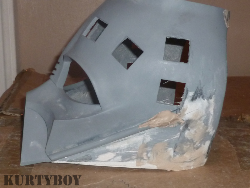

Re: Kurtyboy's new Vader Reveal project. 15 Sept: Adding the grooves to the lower mas

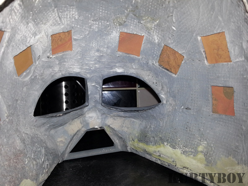

Finally some news Markus!

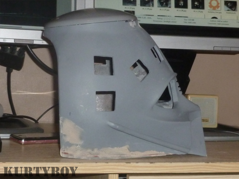

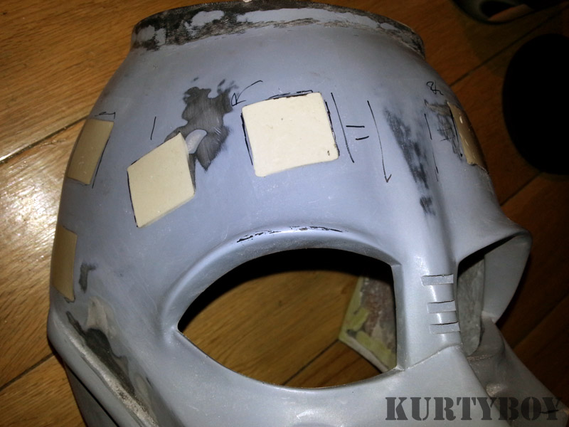

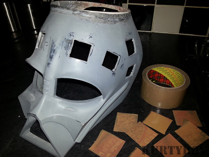

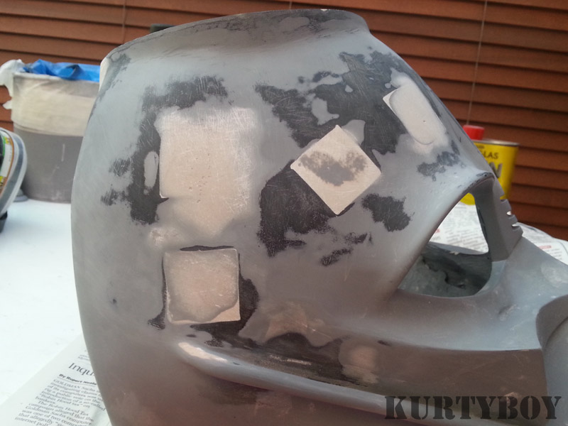

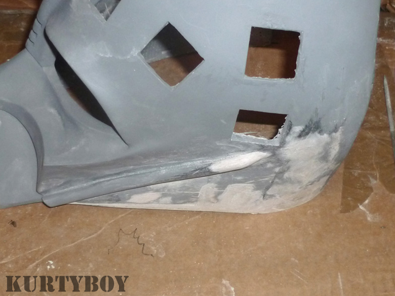

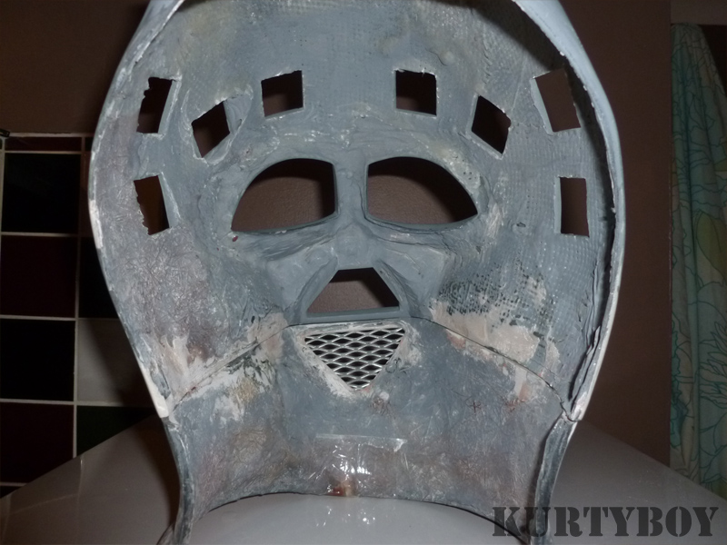

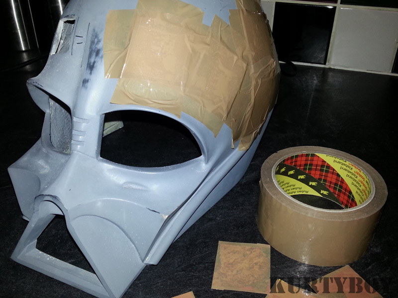

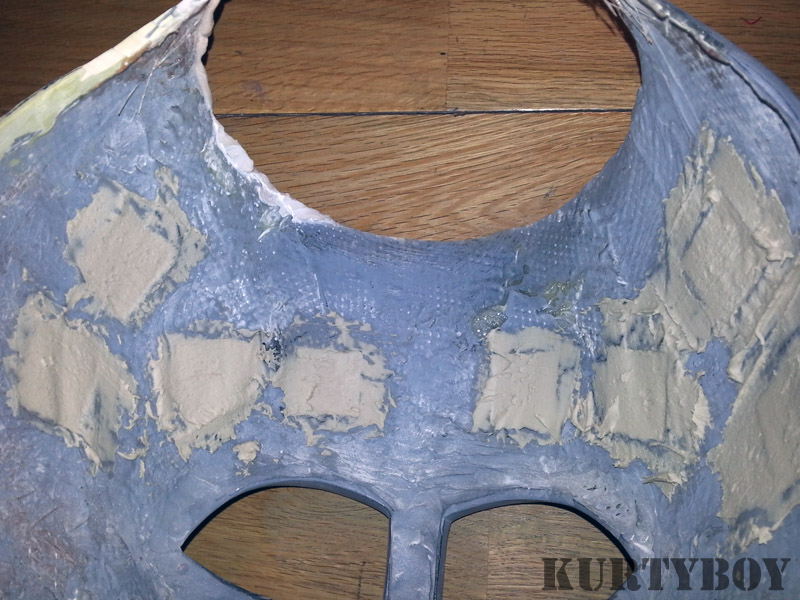

The position of the dynode holes was way off in places so I decided to fill them in and cut new ones. Thanks to Gonk27 for the filling technique!
