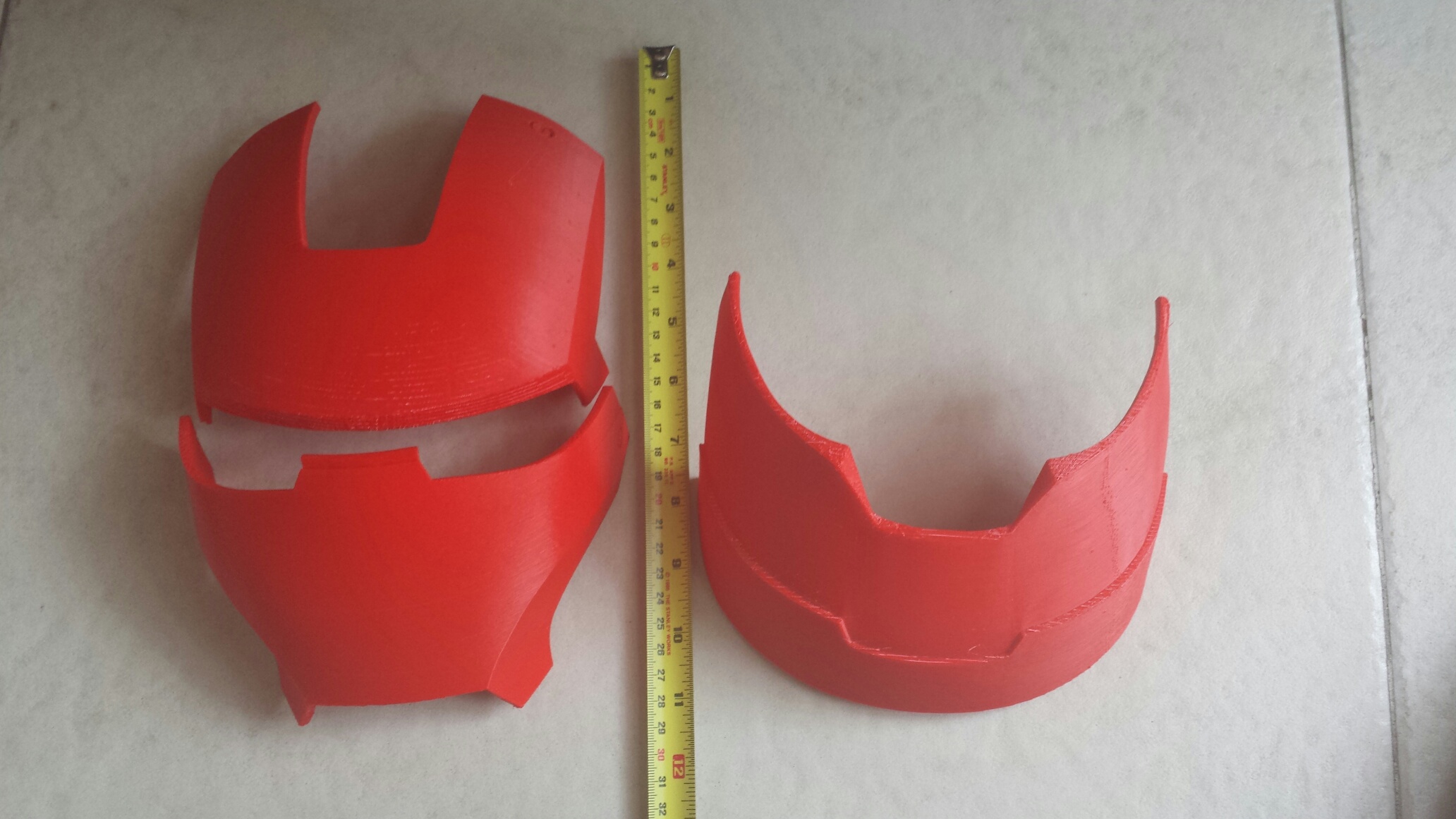

Dancin_Fool, these are raw prints without sanding.
GhostMinion, I used ABS filament and replicator g for my prints
My build size is 9x6x6 so I have to cut into printable size the top and bottom helmet parts, which I'm having no success in printing, this may be due to me being new at this. I'll post more of my prints when I succeed or ask for help soon. Thanks for the feedback.:)

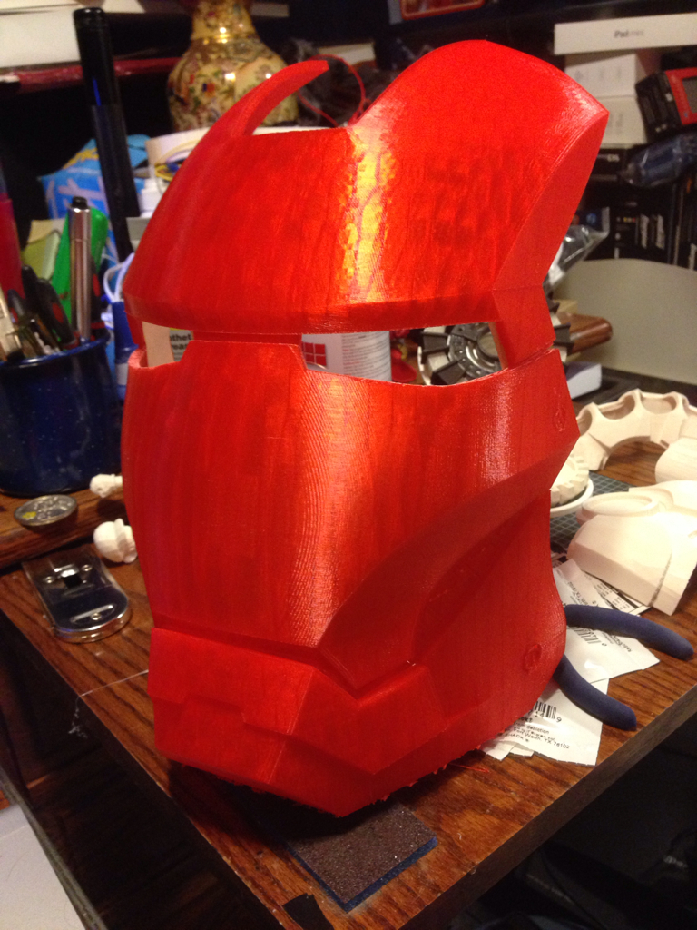

That is fantastic for a raw print. We're you printing at 0.1 or 0.2 z resolution. Also what speed were you printing at. Sorry for all the questions, just really impressed with your results.
Re: My Iron Man Mark III Helmet 3d Print Files (New Helmet available in post #1!!!)
Dancin_Fool, the print is at .27 hight with a feedrate of 40 mm/s and 55 of travel federate. nozzle temp is at 220. Glad I can help

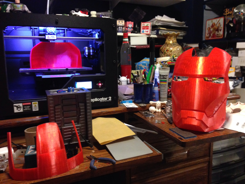

My process so far. Printing the jaw next.
tommyb345 looks great! thanks for sharing!

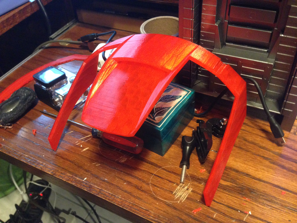

The jaw will be done printing tonight. Will post pics.
tommyb345 wow!!!! that looks so great! thanks for printing this stuff out! Think you could post some close ups of just the jaw from different angles? I'm interested to see how the jaw underneath and mouth area turned out.

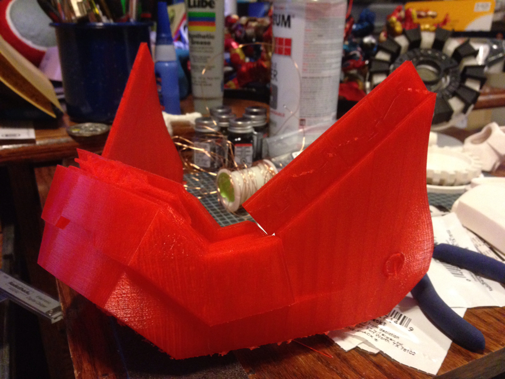

Still needs some sanding under neath but it came out great.

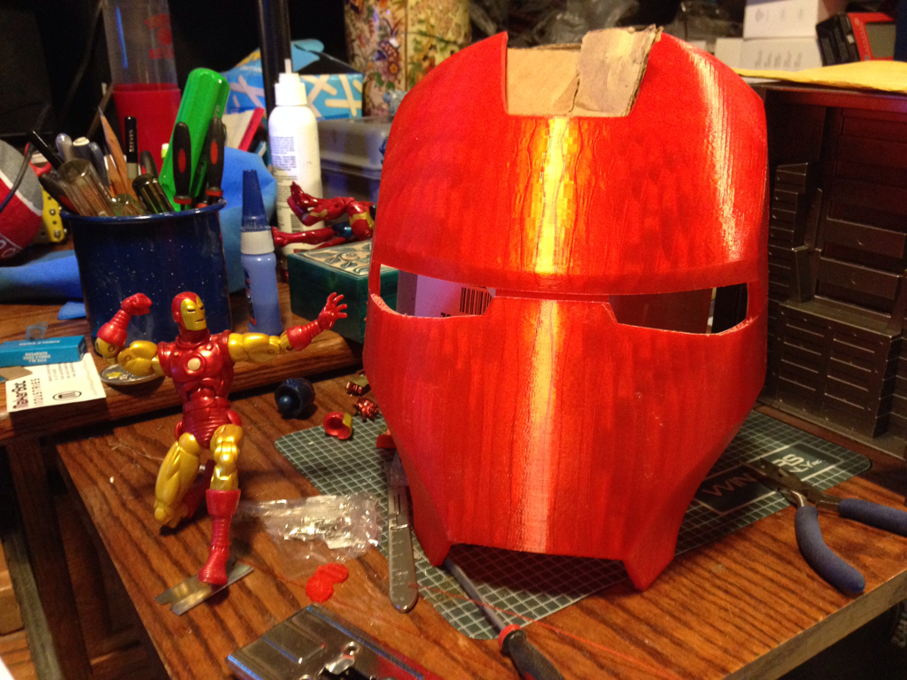

Back part of the top of the helmet is almost done. Damn I got a big noggin.
