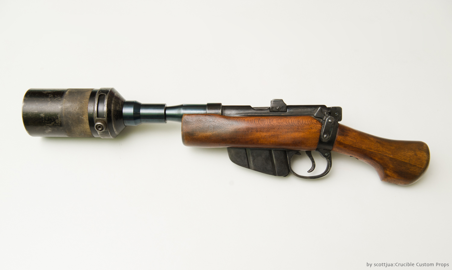

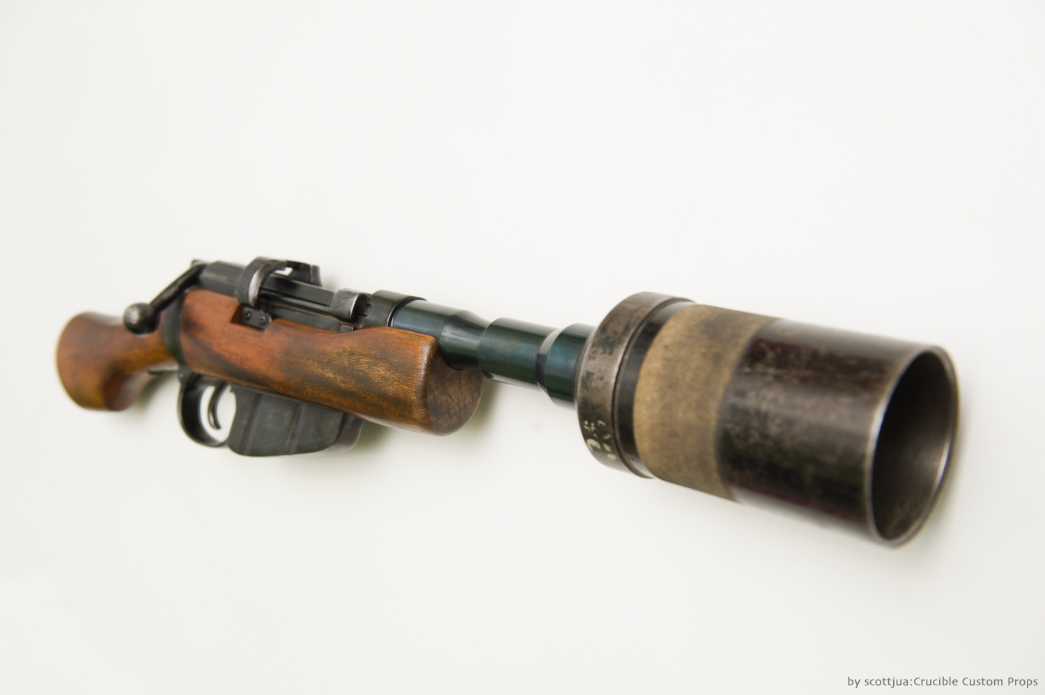

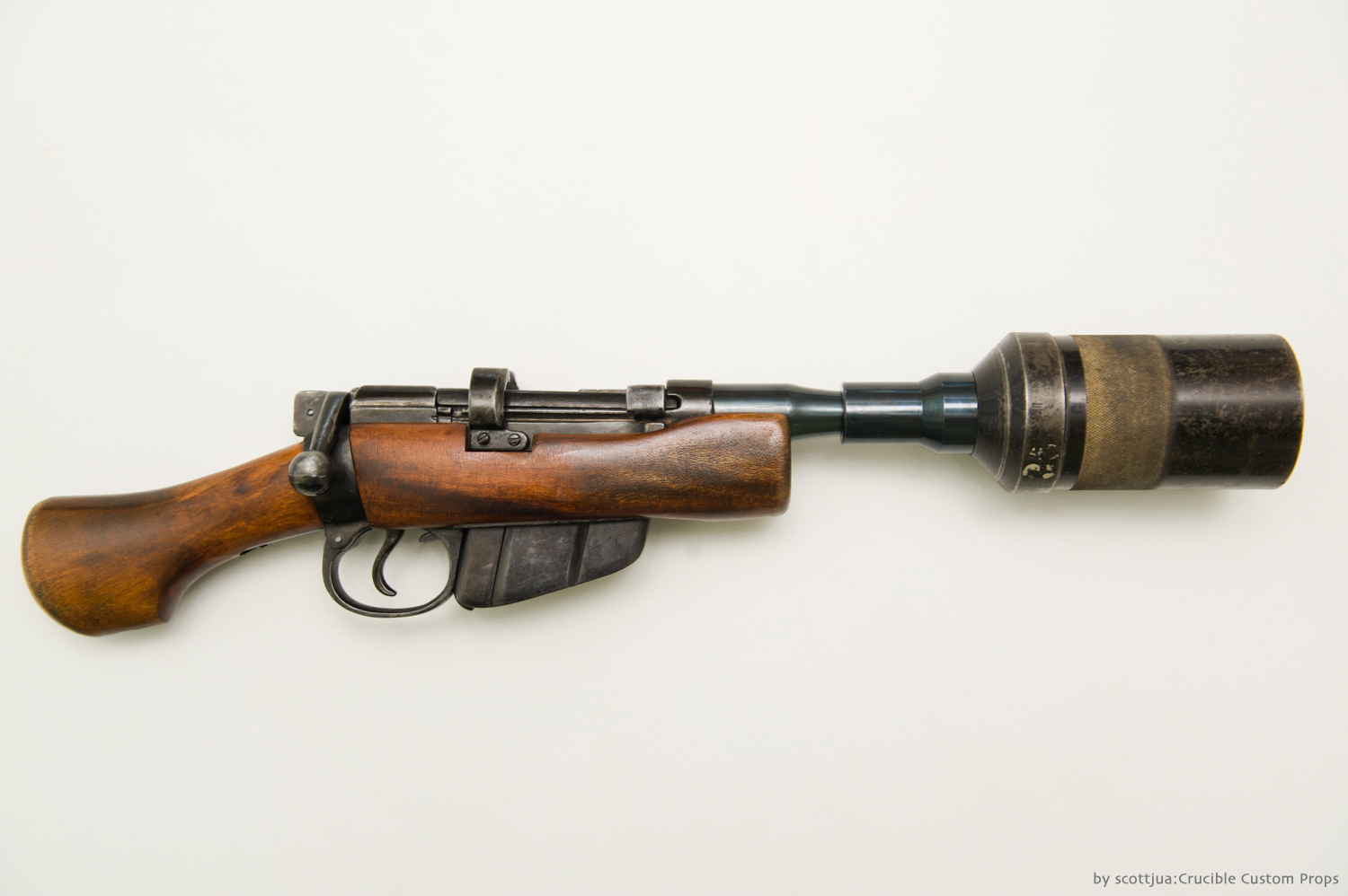

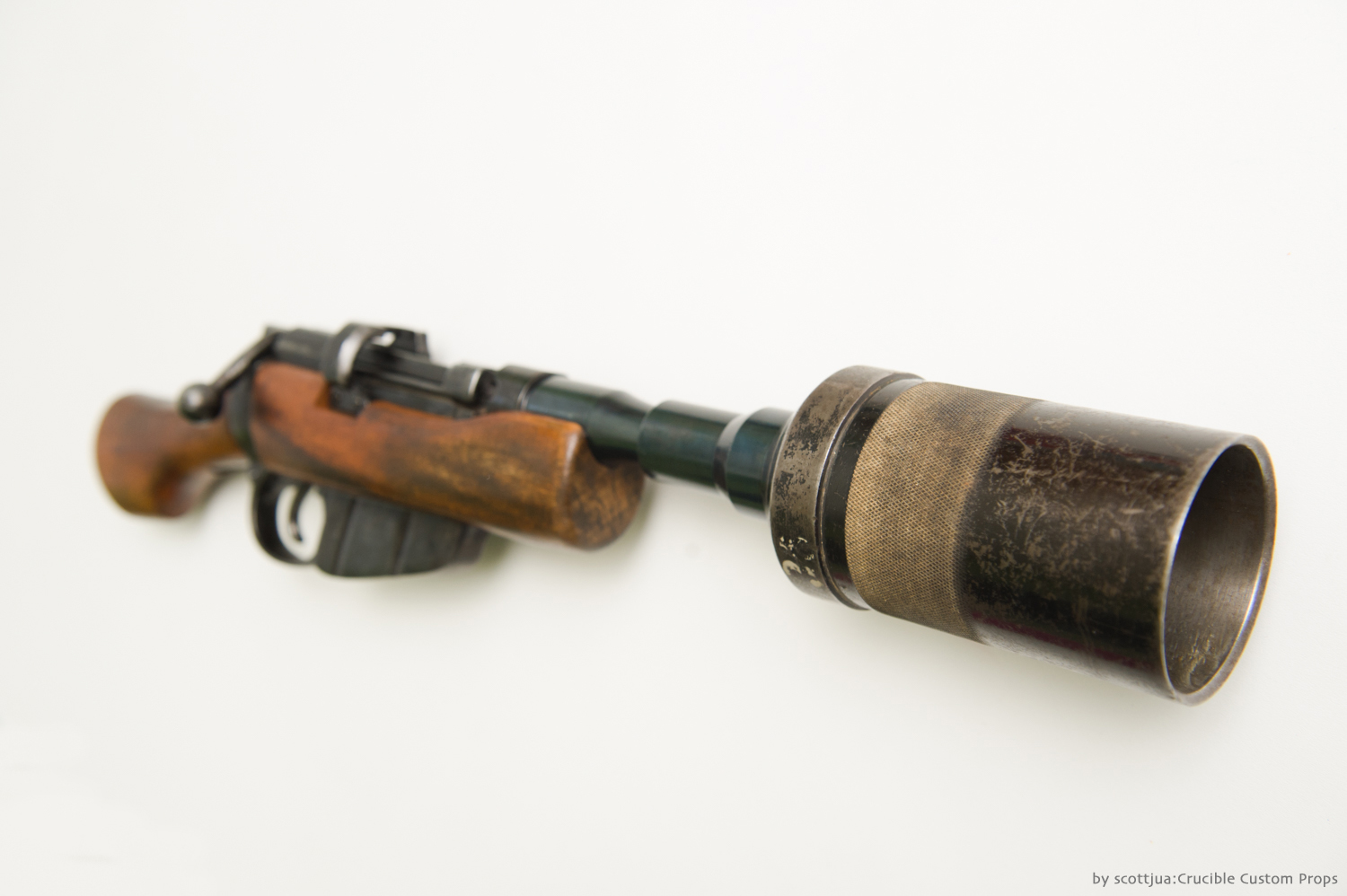

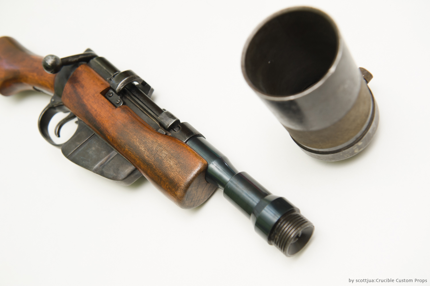

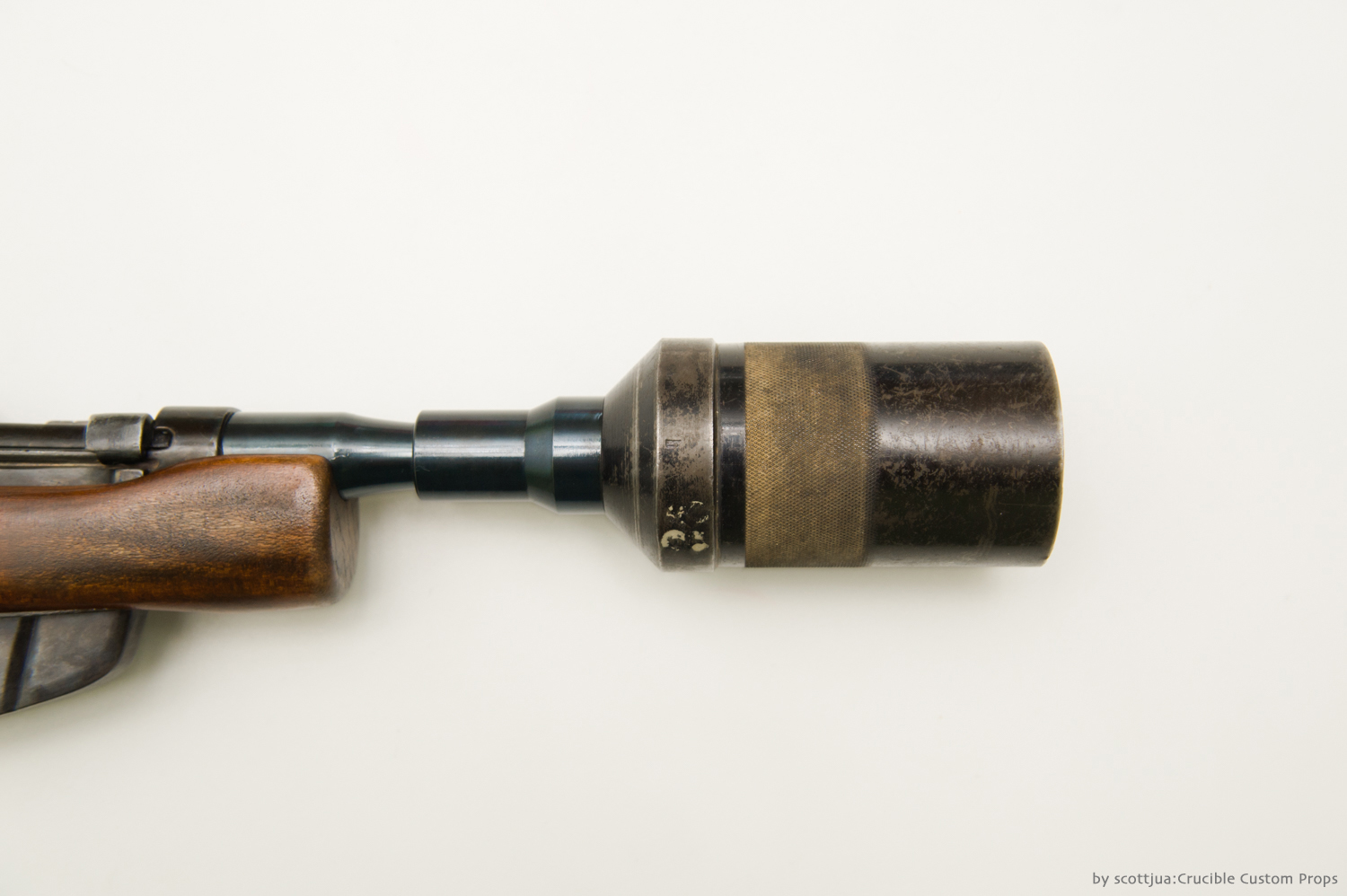

Here's my first Jawa blaster build. This one for Peter in Hong Kong, and based on a Denix SMLE with a real vintage grenade cup.

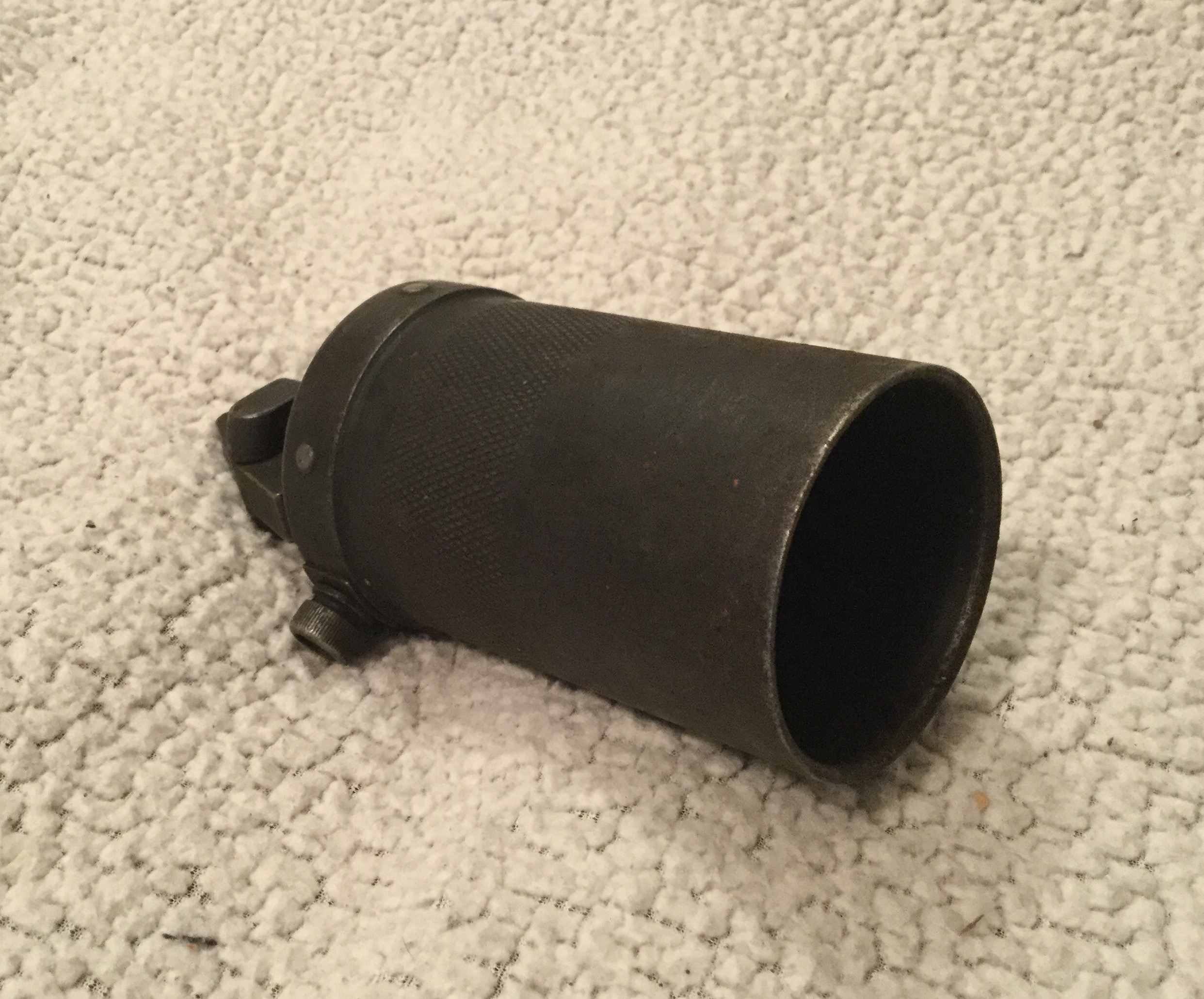

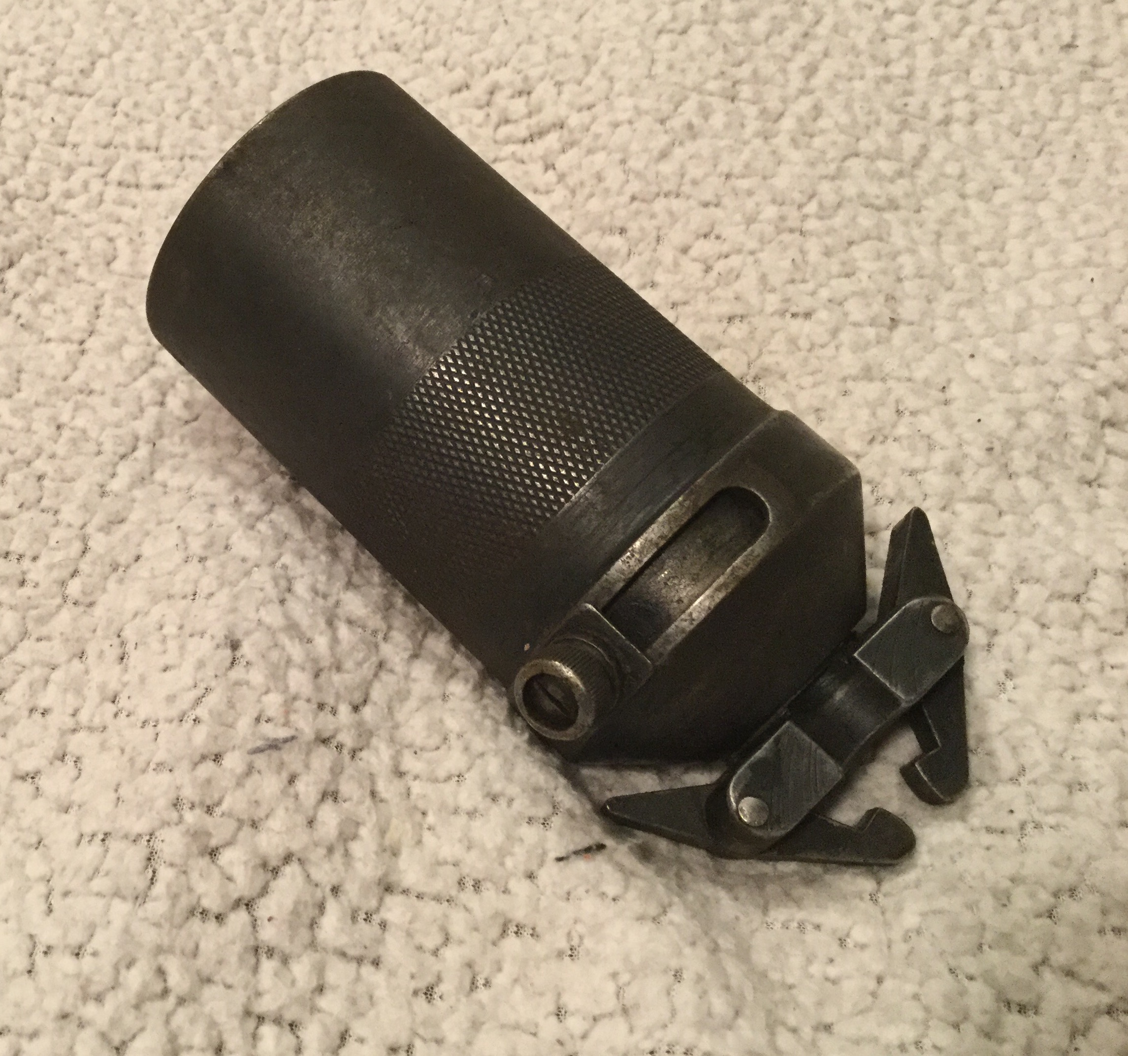

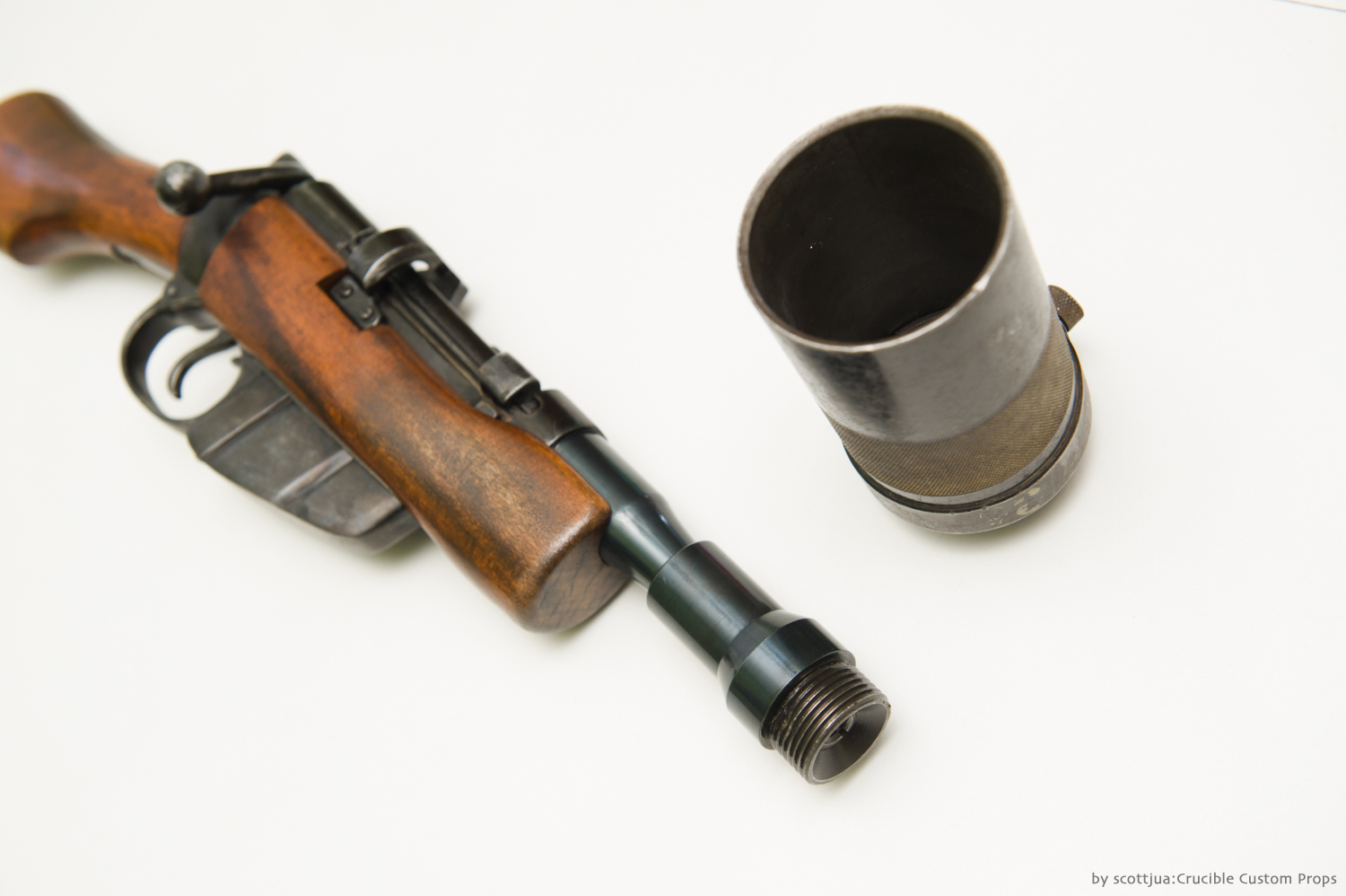

The denix doesn't have a full barrel up top, so once you cut the wood you have to MAKE the barrel. I also had to make the adapter piece that goes up against the grenade cup. The grenade launcher cup comes with a mount for attaching to the SMLE, but it's flat and has claws that grab on to the muzzle. So I had to machine that hunk of steel down to a post to press fit into the aluminum adapter I made. It wasn't very fun. Tiny red hot steel shards flying everywhere while turning it down.
Anyway, it allowed me to use the original threaded attachment point. I then blued the aluminum bits and attached it all together by press fit and epoxy. It shouldn't be going anywhere unless you club droids with it.
Here's some pics.
