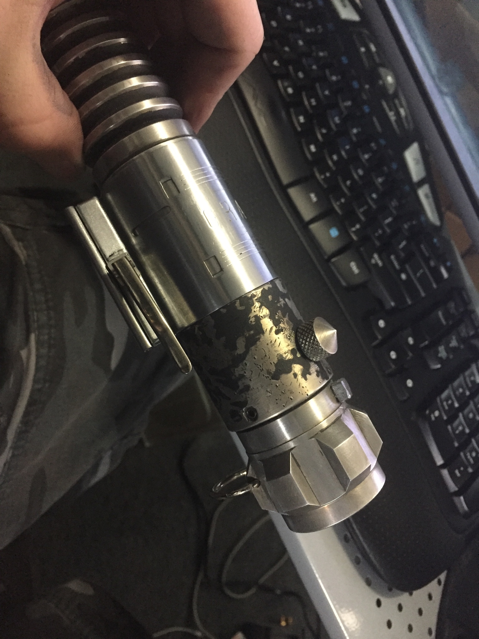

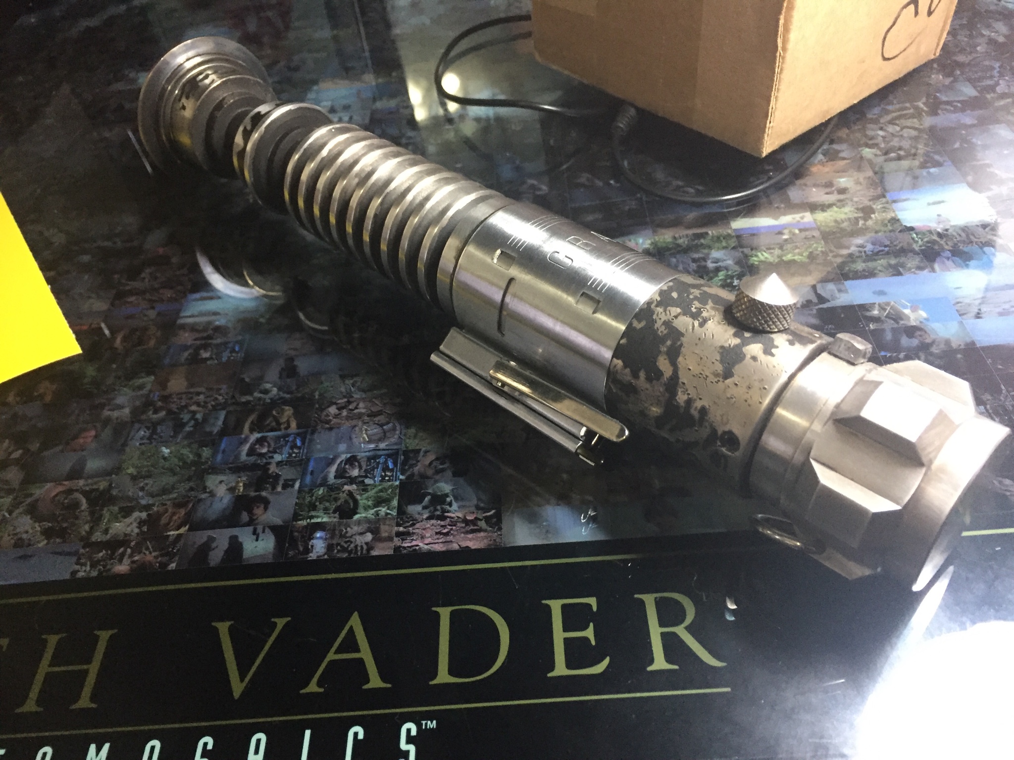

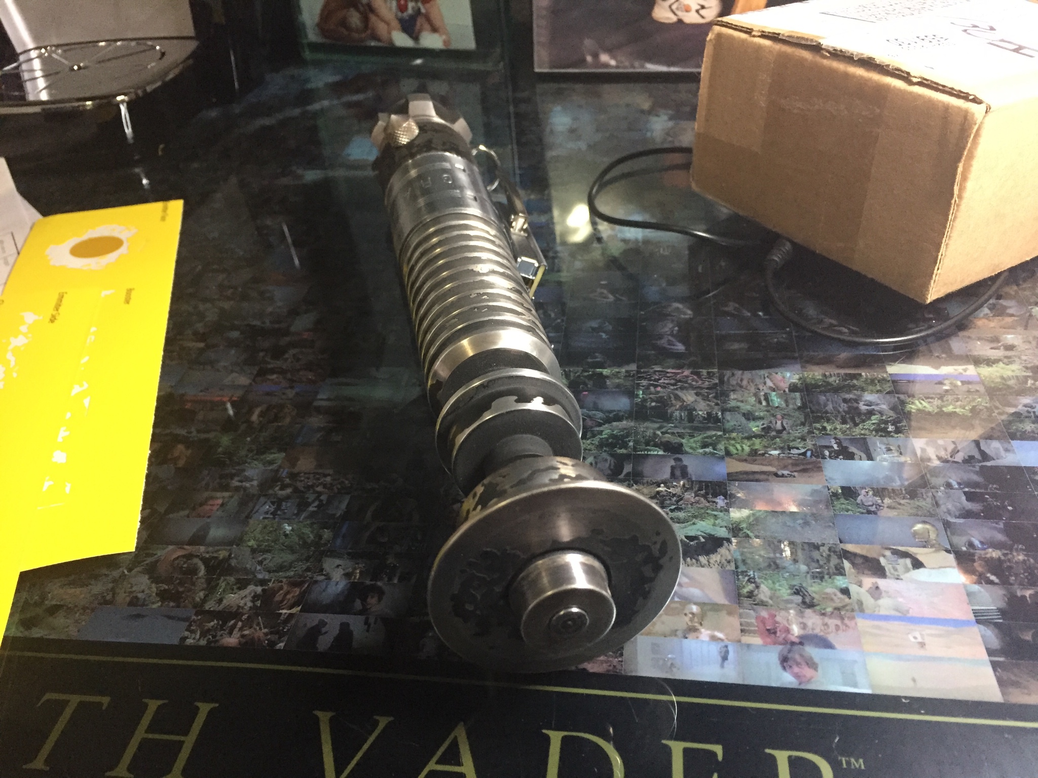

Here's mine after running it in the dishwasher on a quick cycle with my normal detergent packs, fully painted, assembled, clamp, stencils, and all. Lol
Then after a quick rub down with some steel wool
I'm not going to leave it like this of course. I'm going to strip it and repaint but I wanted to see what it would look like so I just threw the whole thing in the washer.
https://uploads.tapatalk-cdn.com/20170202/7e0ecc7d2e138ba5156fda6be6da66dc.jpg
https://uploads.tapatalk-cdn.com/20170202/fea447098f2108a67c332a6c5d71dee5.jpg
https://uploads.tapatalk-cdn.com/20170202/d717405201968f26431b45751883ac45.jpg

Going to repaint because the dishwasher did cause a few bits of paint to curl up and wash off.
I'm going to strip it, wash it again, get each section the right tone, then repaint.
