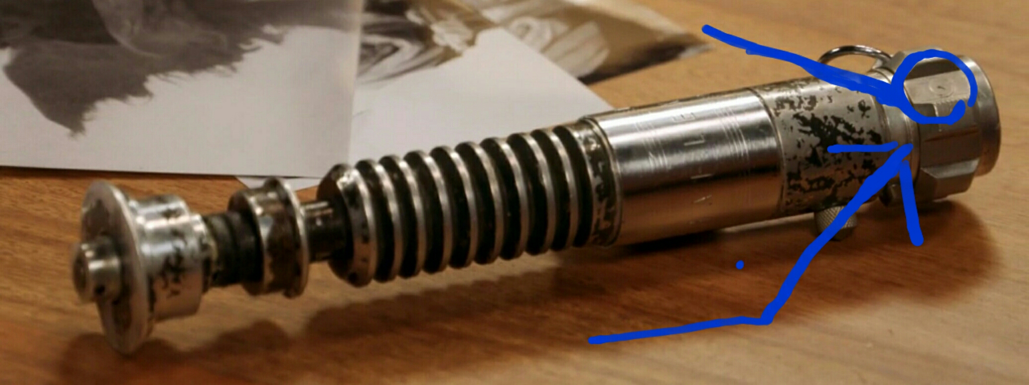

I would like to see the bottom half of the cube section on the pommel. The top half to looks like the cube section slides over the circular part of the pommel. There is a gap between them, so it's either 2 pieces or a really detailed machine job
Glad I'm not the only one that thinks it looks like a ring over a cylinder. But I happily discount that because it would be a PITA without a logical explanation that I can come up with. :)

Not my photo but I marked it for my crazy idea.
My thought was the cubes to the pommel are separate and held in place by the mystery circle
The arrow points to the gap, the small circle is my pin that holds the cubes in place?
Is this totally out of the question or can it be possible.

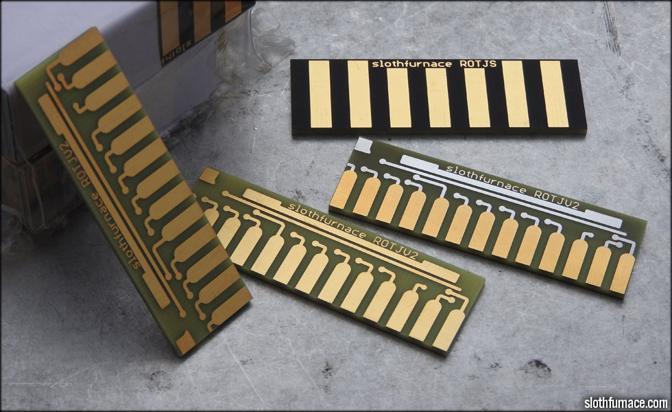

I have my new batch of V2 cards in, and they've been updated with a new pattern on the opposing side... I added the stunt pattern in gold plated and black matte soldermask. Seems to be what we're seeing for the Luke saber both for the stunt version in ROTJ and in episodes 7 and 8.
I ordered these with extra gold plating, and made sure the surface level of the gold plated traces matched the height of the black stripes. They're flush across the surface, so you can't tell they are there if you run your finger across. This will help them wear better over time, and not develop scuffs on raised areas of the surface.
And for you folks who want the card to be green, I think it just depends on your lighting. However, when I do the silver solder job on it, and clean the flux off with acetone and polish, the fiberglass does go a little darker green than the unsoldered card. I suppose that's now a good thing, since the original prop card seems to have darkened with age.
excellent job sloth!
