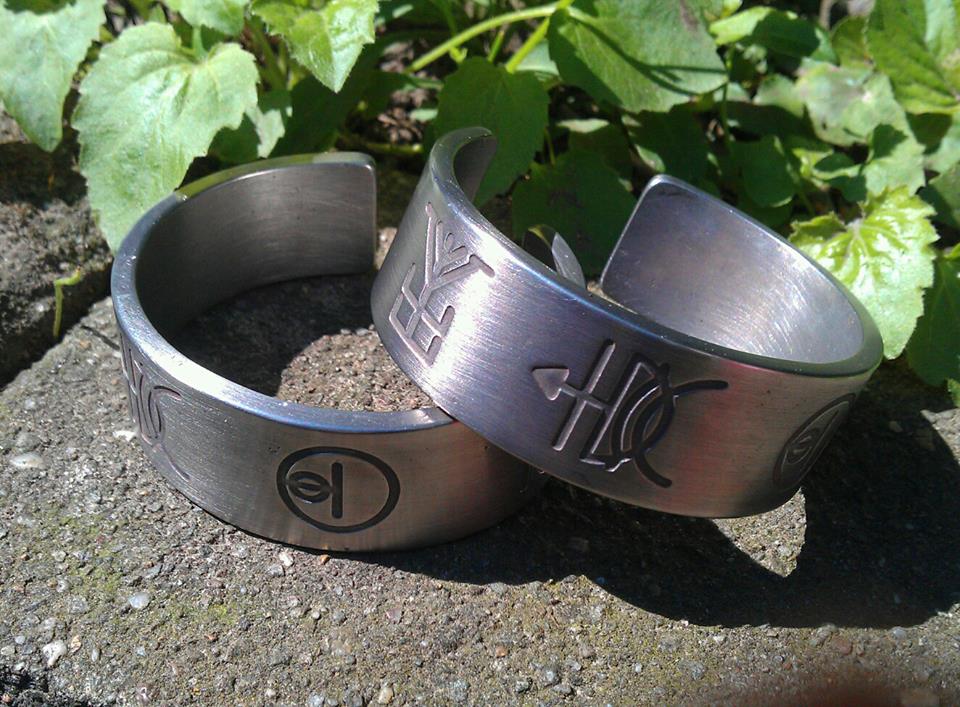

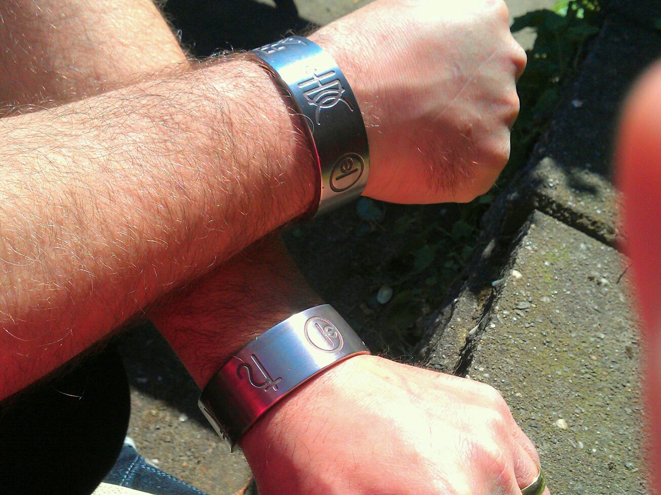

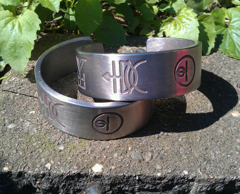

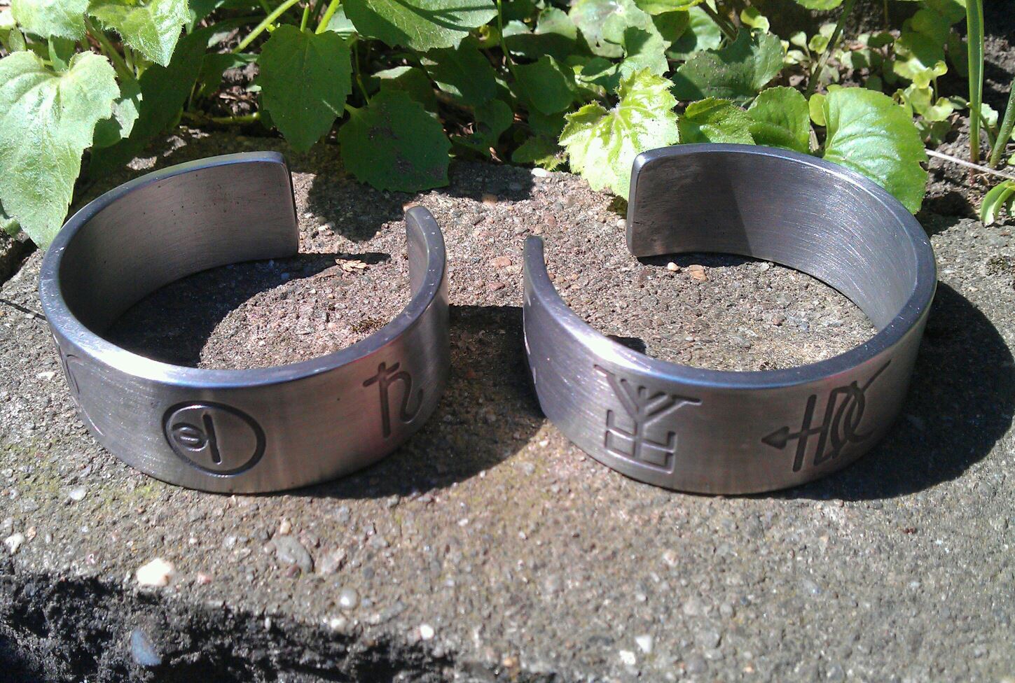

Recently i discovered "The Dresden Files" and there are some cool props in the show. I wanted to make accurate copies of Bob's Manacles which i finished last week.
I started with the sigils that were posted in an old thread on a syfy forum, but after checking out screencaps from a 720p rip of the show i noticed they needed to be made more accurate.
when the graphics were done, i saline etched them in a strip of aluminium and (with a plastic ring) made a bracelet master. A 2 part mold was made and pewter copies were cast. The castings were cleaned up with sandingpaper and steelwool. I chemically aged the bracelets with ferric chloride which also makes the sigils stand out a bit. The pieces were cleaned up again with a scouring pad and have a nice old look, which will tarnish more over time.
combined they nearly weigh 400 grams and i am very happy with the result :)
Thanks for looking

I was the one that picked up your first pair from ebay. I just picked them up from the post office this morning. I wanted to say thanks and that in person, these are AMAZING! I would take pics but yours are way better than any that I could take. And you weren't kidding about these being heavy, but I love that, it's makes these feel very substantial and "real" if you get what I mean.
Thanks again for tackling these.
good to hear they arrived and you are happy with them. Finished a set for my own collection last week and still pick them up every other day and wear them :)
