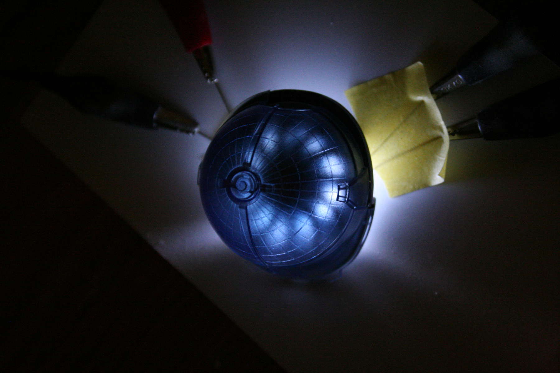

I proudly present my version of the Bussard collector lighting.
Here is a picture of the parts used:
I drilled some ring-shaped openings into the back plate and painted it grey-blue-green with a bright ring where the light will shine through. A circular piece of diffused clear plastic is glued atop. The rotor part as described some posts ago got the blades bent backwards and with the help of 1mm thick plastic as spacer it was glued to another circle of the clear diffusion material. In combination with two bright white LEDs from behind this already looks interesting:
The Bussard dome was sprayed with a thin layer of clear blue and added on top:
Even with the clear blue making the dome much more diffusive than I hoped I am really happy with the result. If someone of you knows a way how to make the dome more transparent again I'll give it a try though.

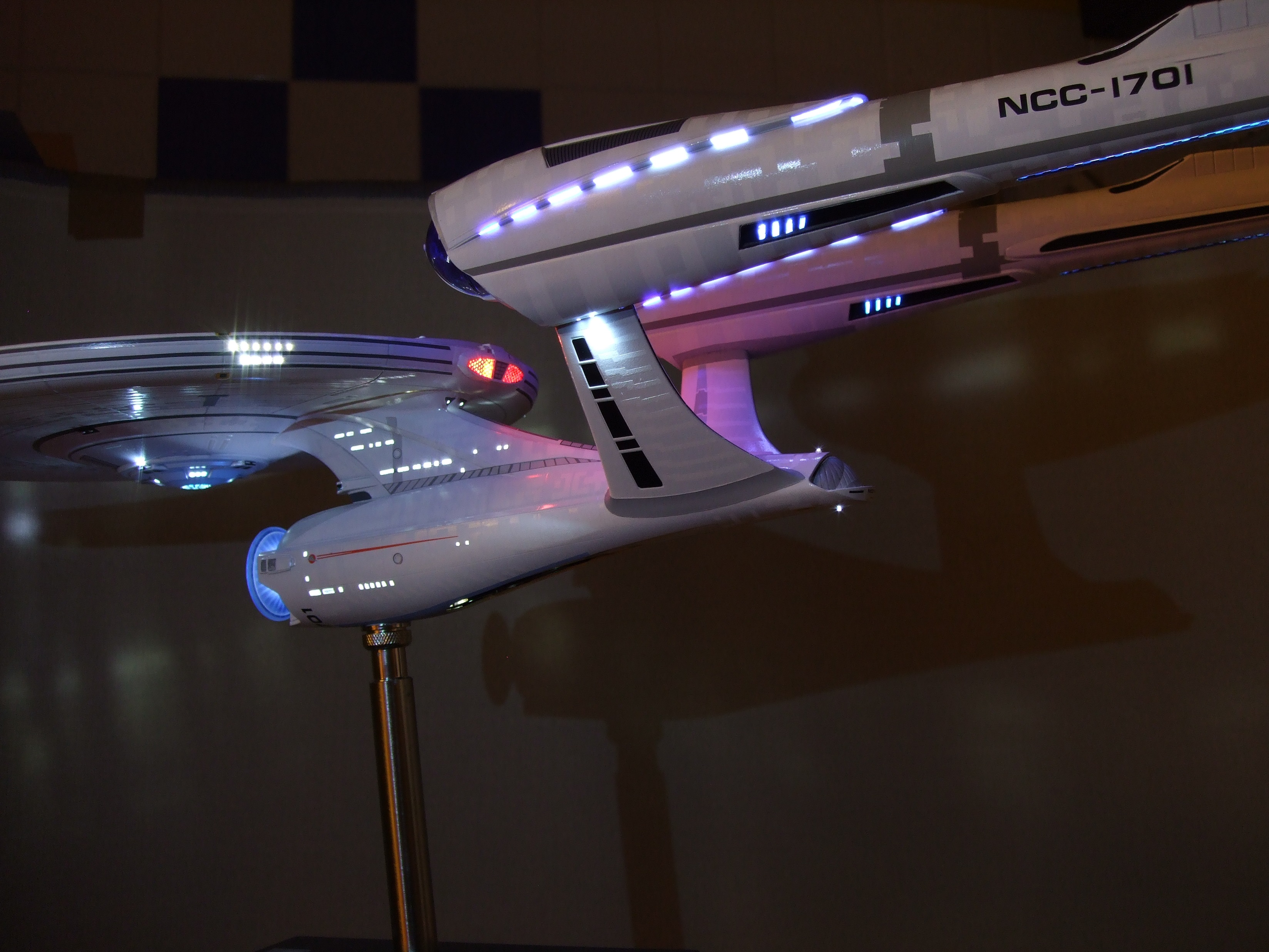

Hello I have just come across this site and nice build you are doing there, A suggestion with the clear bussard covers why not tint them from the inside with Tamiya clear smoke paint as I did, everyone seems to using blue on them but they are only lit up blue and should still remain clear so you can see the fan/blade/spinners. I put on two coats of the smoke paint to give it a dark tint but still allow the light to clearly come through, when all the lights are turned off I think the bussards look very smart! they almost black.
I never thought of using SMD led's before as I used fibre optic cable for my spot lights and like the look they give, ok not perfect but and easy install.
I had a major headache to trying to get the main deflector dish to light up correctly.
I will upload some more pictures of my model soon.

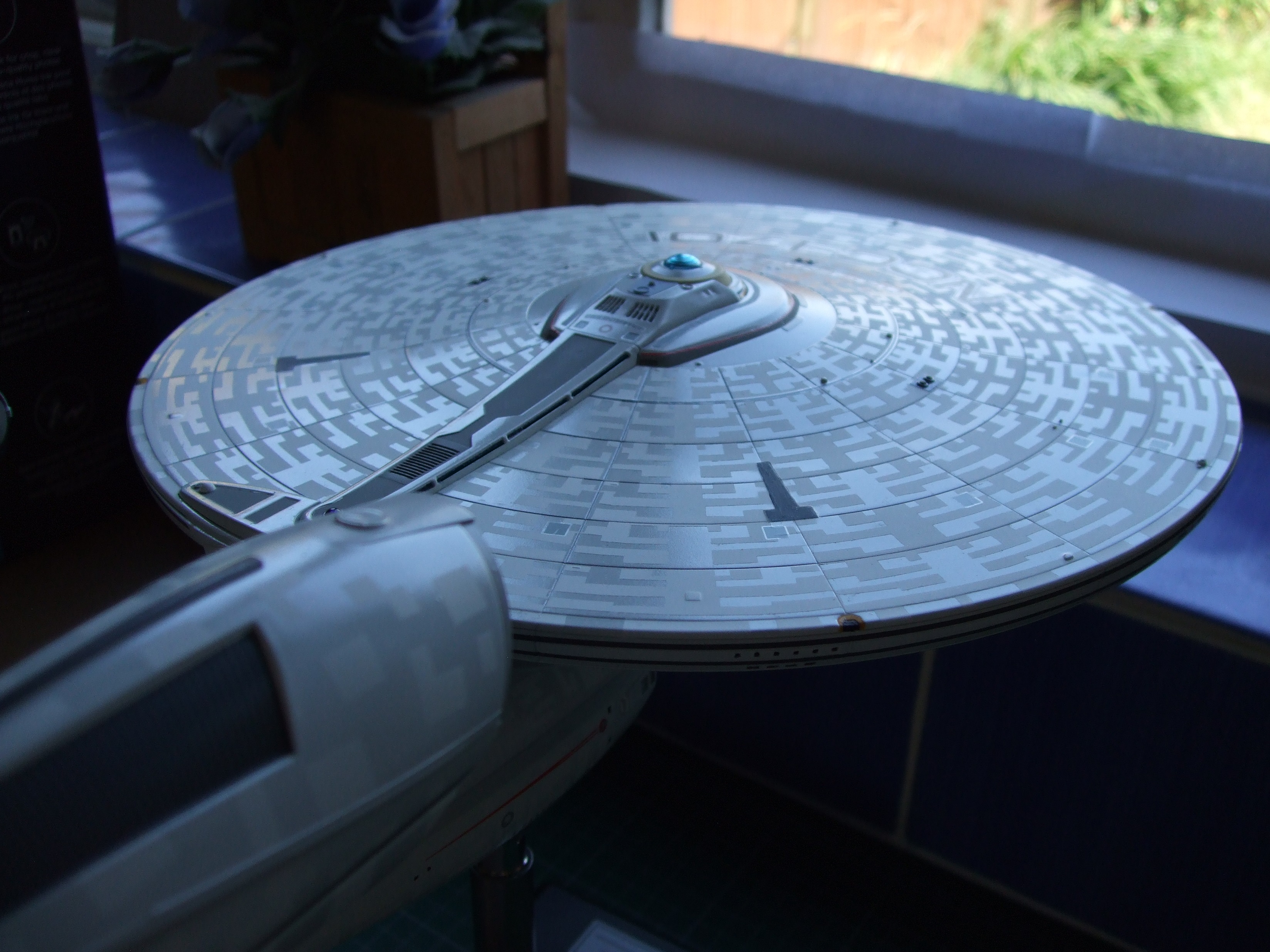

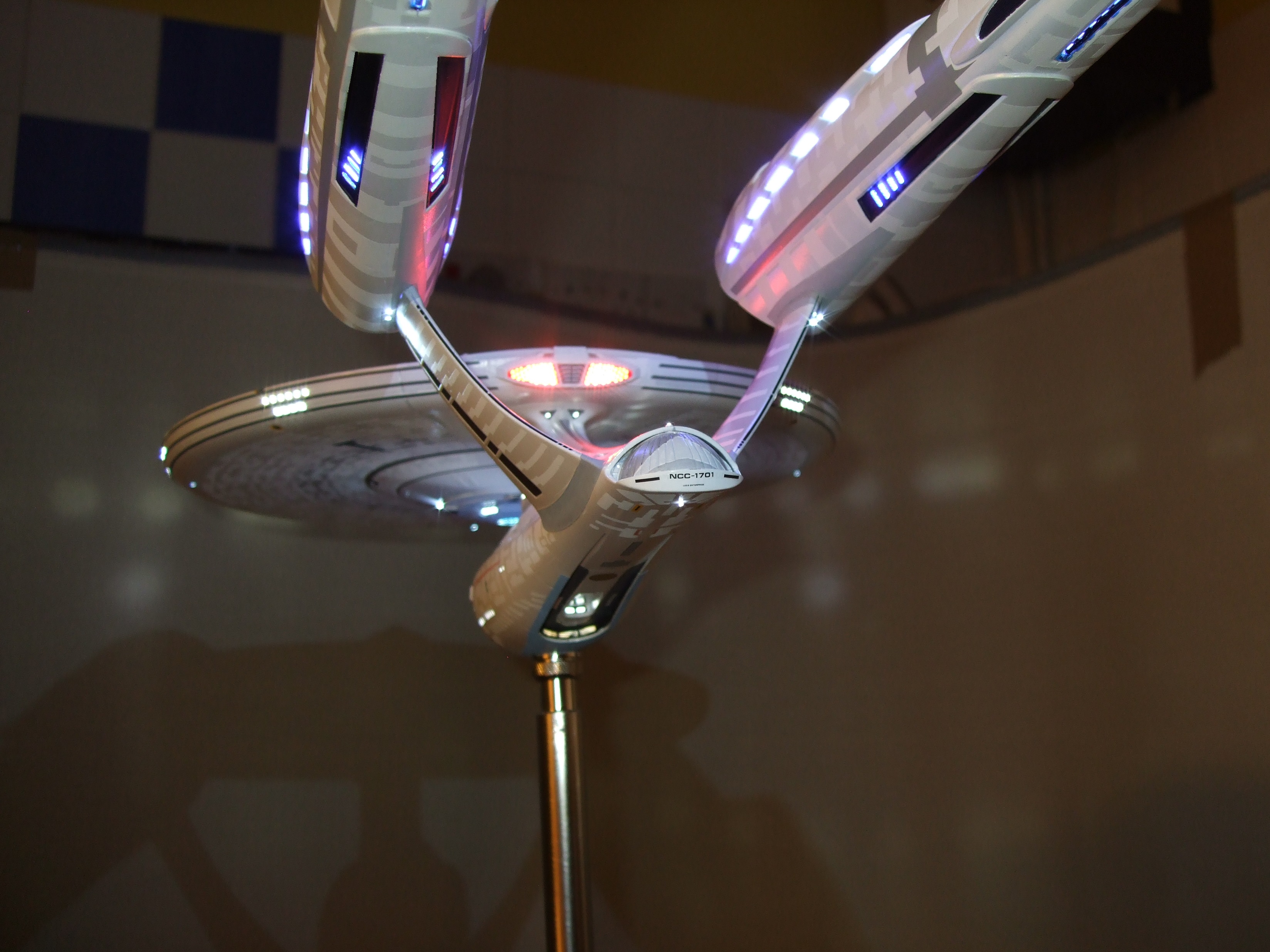

Here is some more pictures, the Aztec panel effect was done using just a gloss base paint then second layer of matt which gives a reasonable effect, in the pictures i have taken photos in different lighting conditions to show what it looks like, the deflector dish did have a copper colour to it but the light did not disperse enough so off it had to come.
