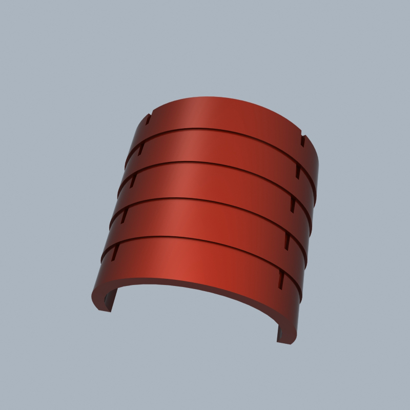

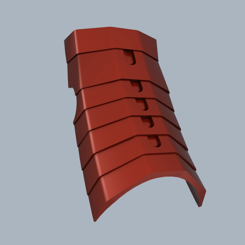

Inner Elbow Shutters available:
Shutters measure 3-3/8" at their widest point.
http://www.kenlandrum.com/IM_mkIII_elbow-shutters.obj

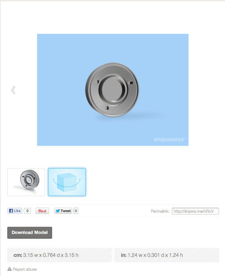

FYI: I just created a "Shapeways" account and tried uploading a few of the models here. I am using new parameters when exporting to .obj.... so far so good. Size looks proper too. I will continue to test these.

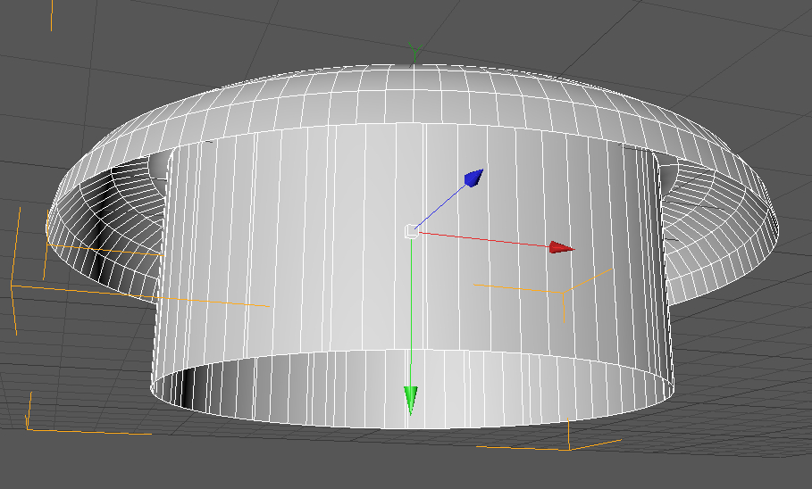

I saw that some folks were having trouble printing stuff like the unibeam. I took a look and the problem is that some of the parts aren't watertight meshes such as this:
When run through mesh repair programs it will try to close the mesh, therefore covering over the grill pattern. Depending on the printer and software used it may or may not print correctly. On most printers it won't.
