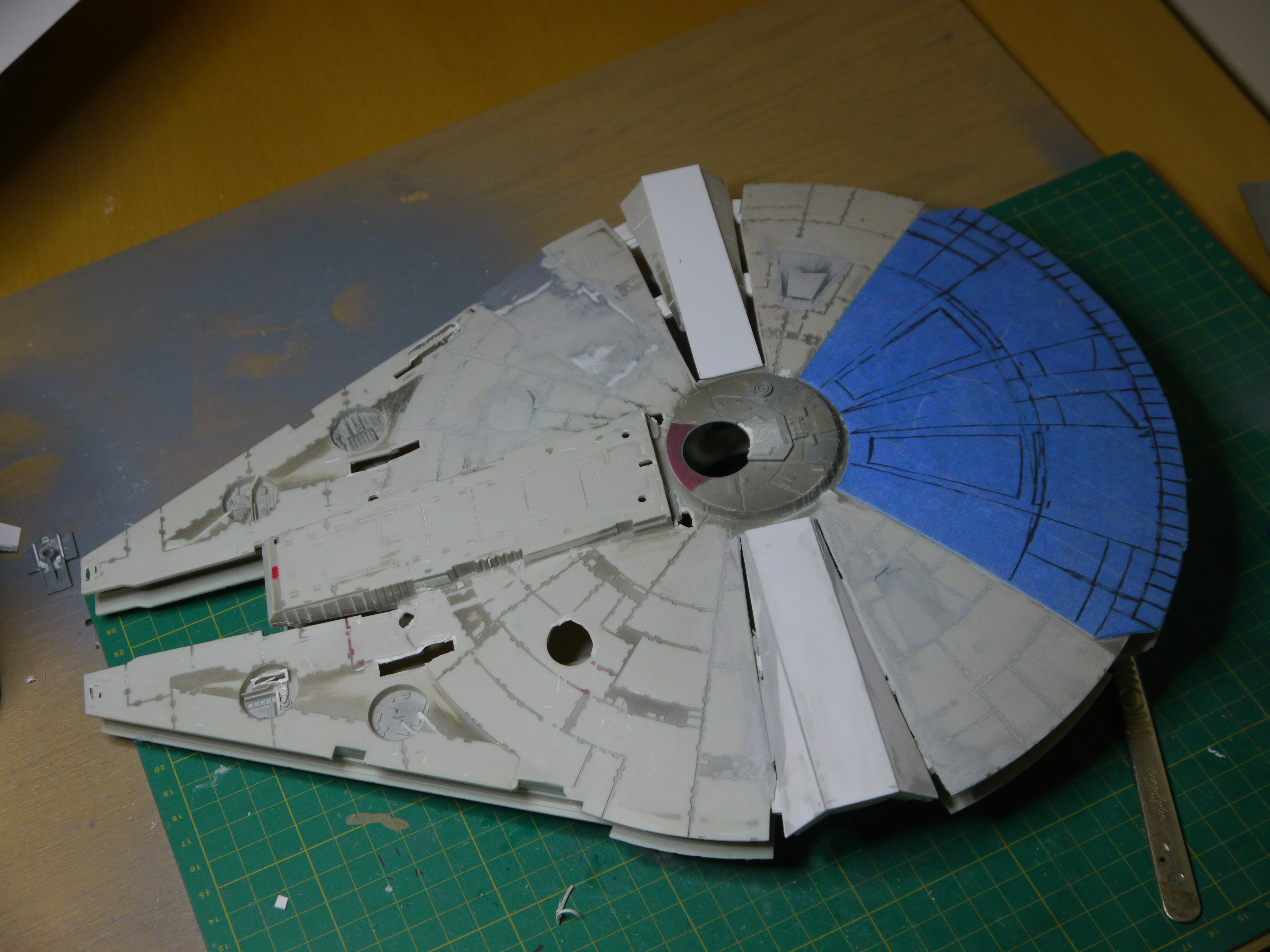

I entered the Scale Model Addict Spring Contest with the hopes to convert a Revell Easykit Millennium Falcon to a design sililar to Ralph McQuarrie's concept paintings

A lot of the surface details are to be removed:
Underside clean:
The upper Docking arms removed & gaps supported:
The Engine deck hull drawn on:
I bought an Airfix 1/72 Seaking to use it's cockpit etc (loads of nice details) & a Revell 1/72 Merkava Mk III for greebles
Heres some photos of it with 'bits stuck on': :D
That's where I'm at
Thanks for looking
John

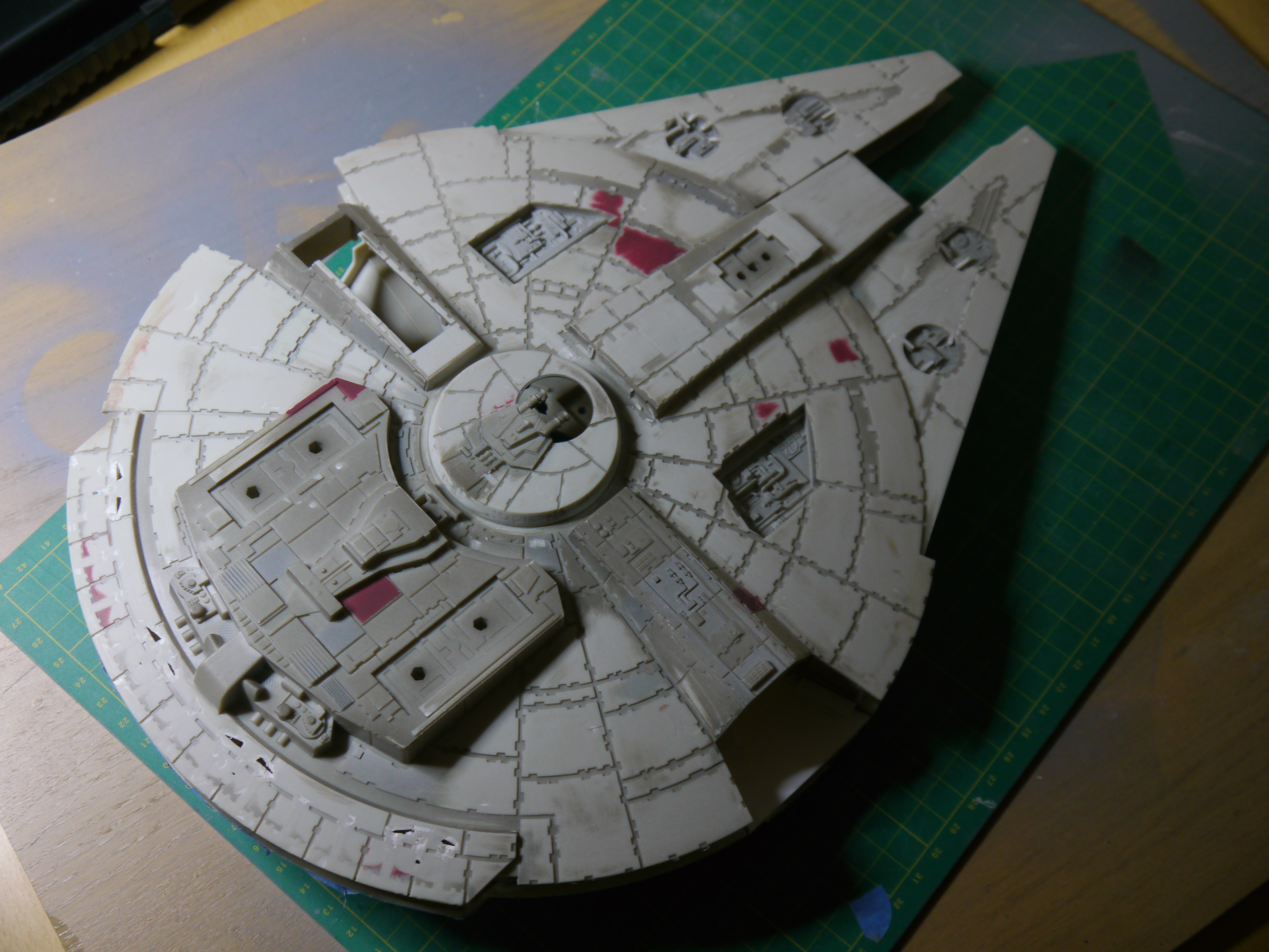

It has very simplistic computer designed details straight off the Code 3 Die-cast design:
....but the plastic is very easy to cut & modify

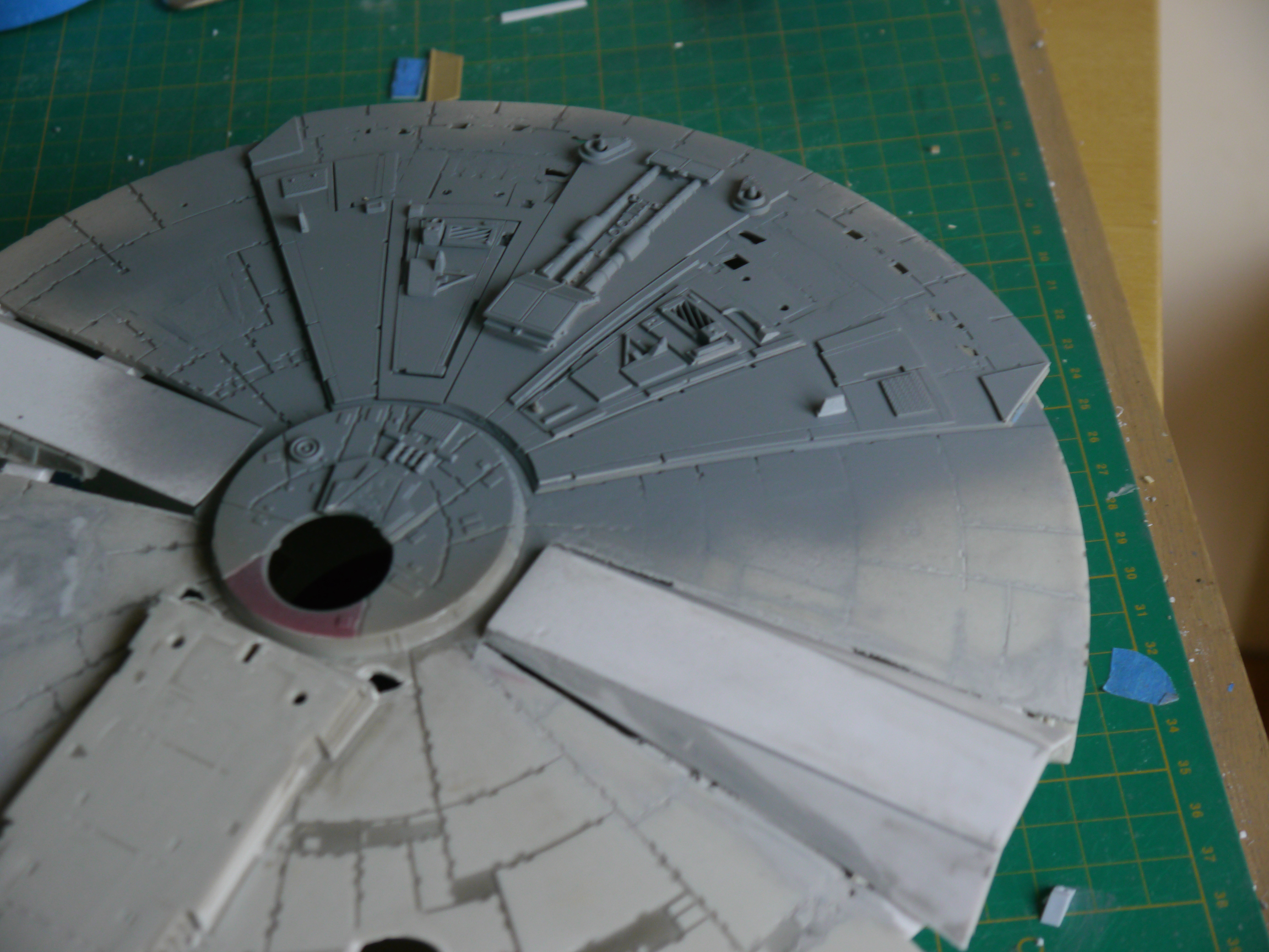

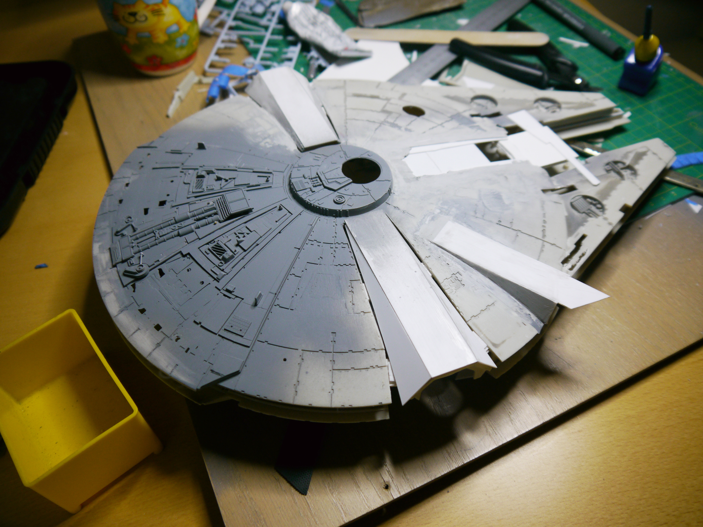

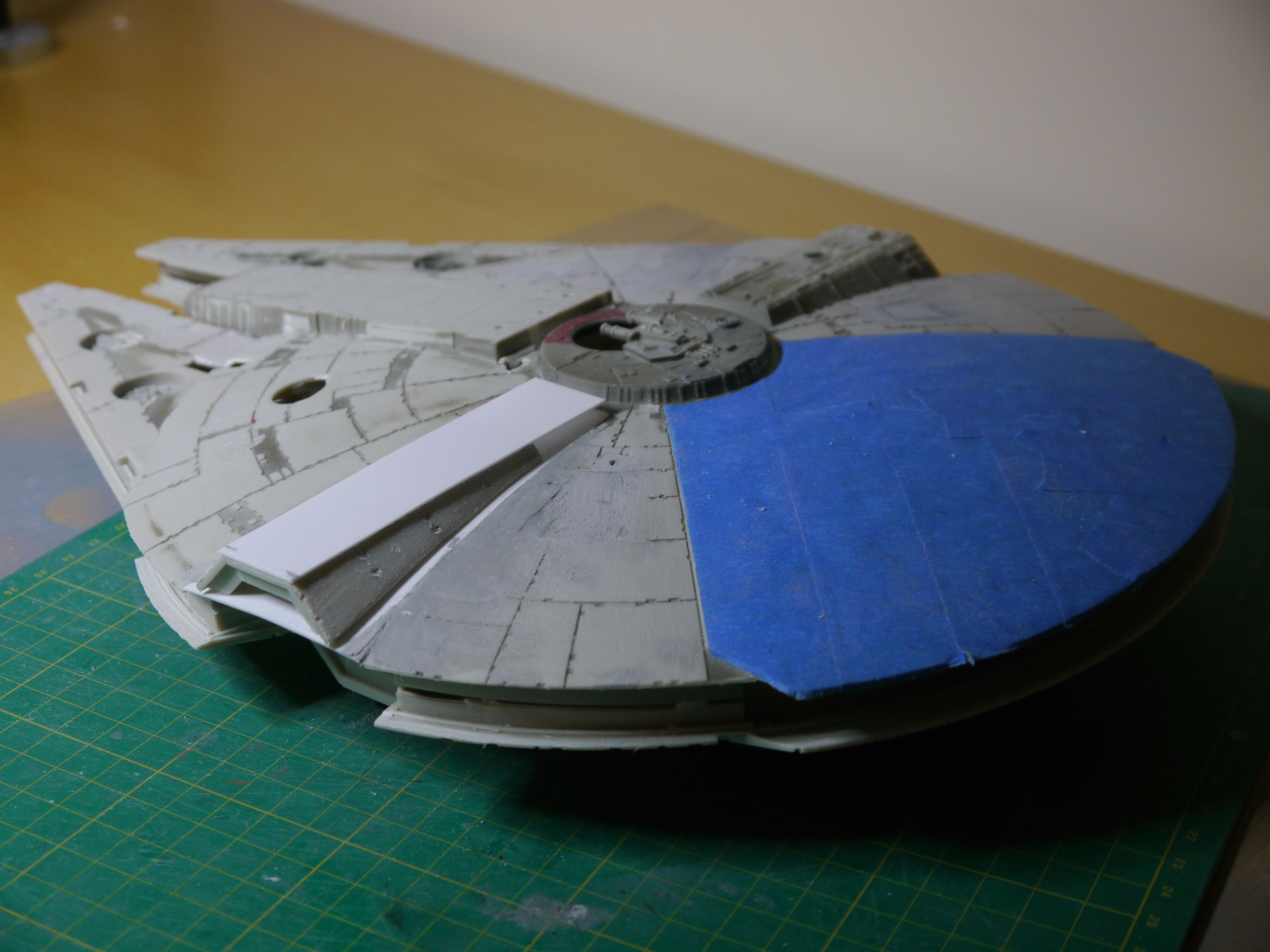

OK, just a small update, I had to cut off the top jaw (& will have to do the same for the lower) as it widened too much at the turret, it was also too long.
I've modified the mandibles in the top half of the ship (will follow up with the lower half also)
Ive also made the walkway to the cockpit:
John
