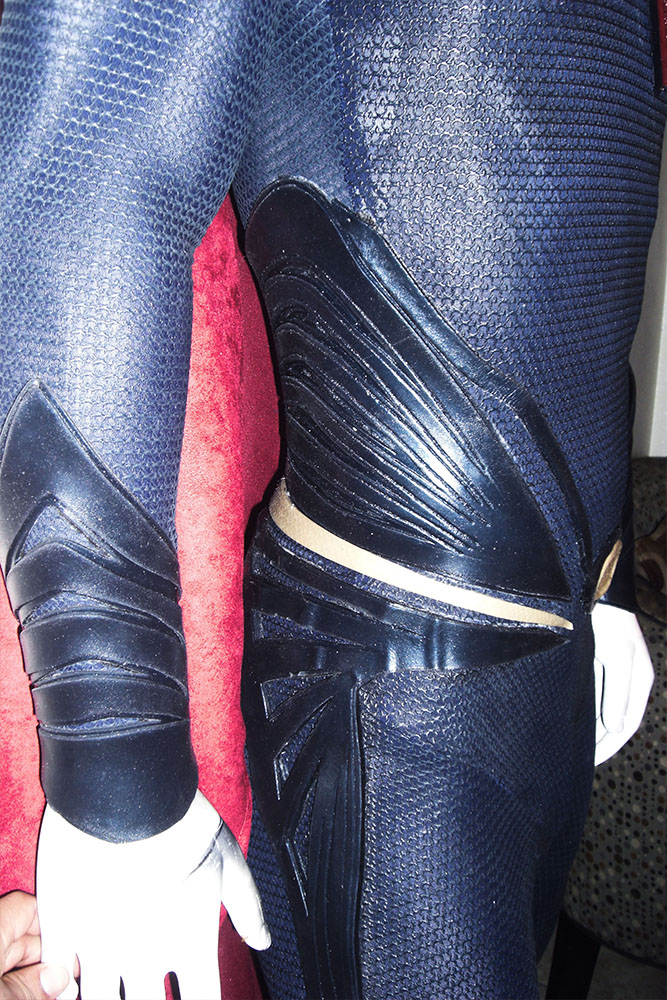

Superman_2013.jpgThis was my first attempt at using Eldon's stencil. I design and draft patterns for a living and this one does have a few structural issues (especially with the boots)...nothing that cannot be worked around. I replaced the stencil with stretch leather and used an embroidered "S" to give it depth. Okay for a first try, but did not like working around the pre-printed design. For a basic suit, this one's okay.

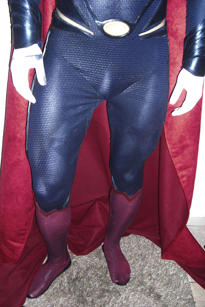

Looks great so far! Only thing I would suggest is in the belt area the belt should sit higher up closer to the top of the center buckle area instead of lower.
Example of it being a bit higher up.
Hope that helps! Can't wait to see the finished product!

View attachment 234074This was my first attempt at using Eldon's stencil. I design and draft patterns for a living and this one does have a few structural issues (especially with the boots)...nothing that cannot be worked around. I replaced the stencil with stretch leather and used an embroidered "S" to give it depth. Okay for a first try, but did not like working around the pre-printed design. For a basic suit, this one's okay.
you did a great job with that print buddy it was one of my favorites
