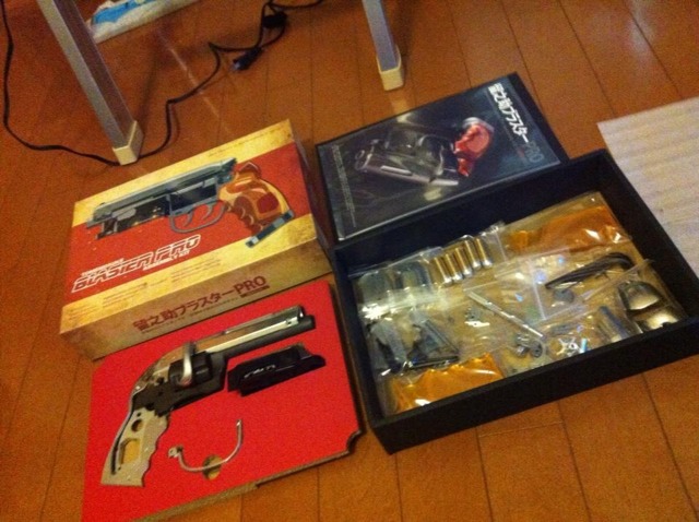

    Jul 5, 2013, 8:06 PM - Re: Blade Runner Blaster news: model kit version of the Tomenosuke Blaster is coming #627
    mtrixman said: View Post
    Yup that's where you put it
    I'm still confused on where to put the rubber washer goes. Can you draw an arrow. lol
    Ck
    Here is mine
    Click image for larger version.

    Jul 5, 2013, 8:25 PM - Re: Blade Runner Blaster news: model kit version of the Tomenosuke Blaster is coming #628
    Take the steyr upper and slide off the gun. remove the slide/bolt, leaving just the upper. The washer goes behind the end cap that is bolted to the front end of the upper.
    that fills the gap left when you close the slide. the washer is sandwiched in between the front end of the slide and the back end of the cap with a little pressure which keeps the lever from flopping. It goes inside the upper about where the red line is, behind the cap.

    Jul 5, 2013, 9:07 PM - Re: Blade Runner Blaster news: model kit version of the Tomenosuke Blaster is coming #630
    Hey guys check this out! Let me make sure this is going to work and ill post up a howto!
