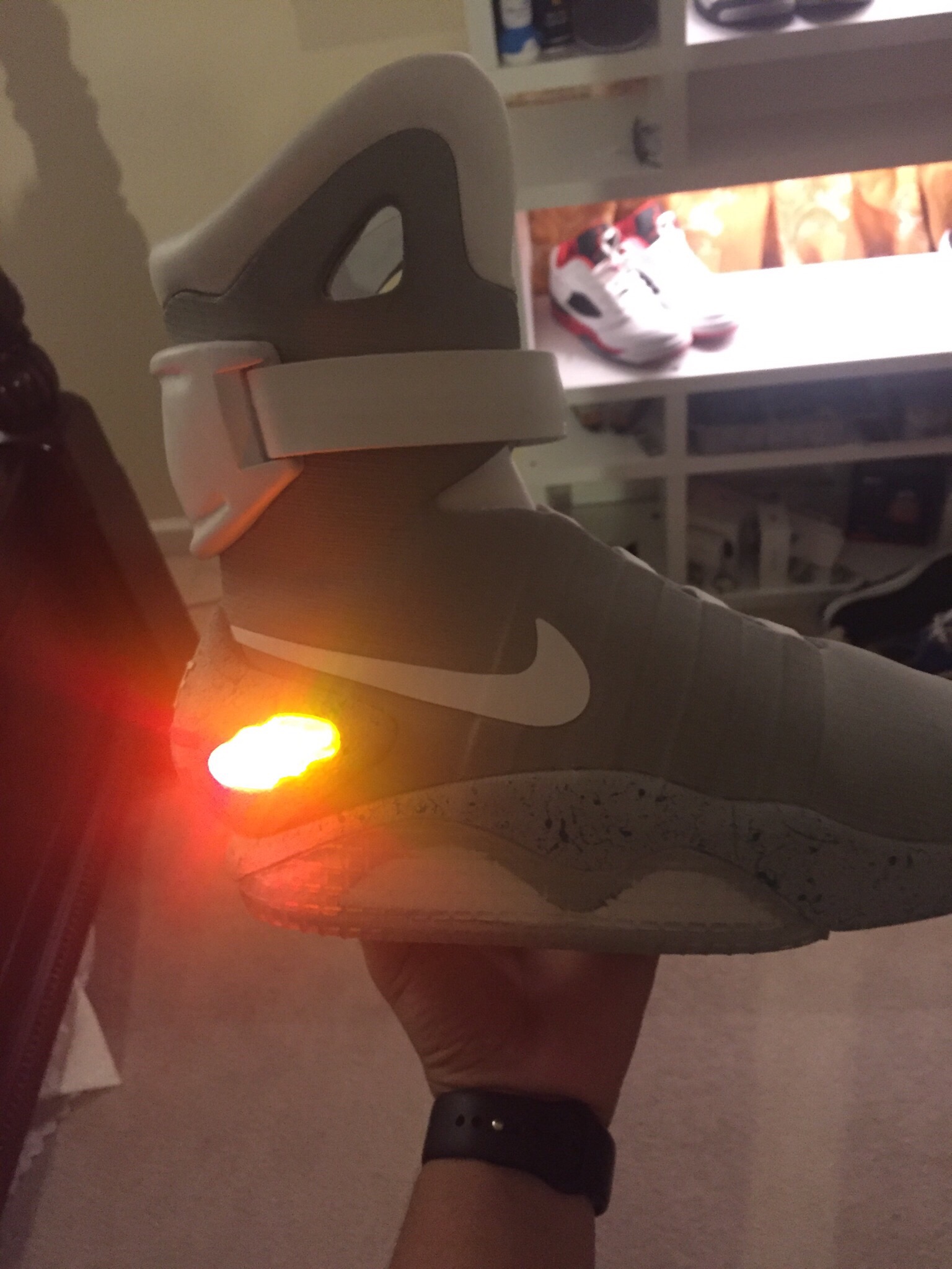

So can anyone fix this for me ?? please !!!
No wonder I keep I breaking my MAGs...
attachment.php
Split again!

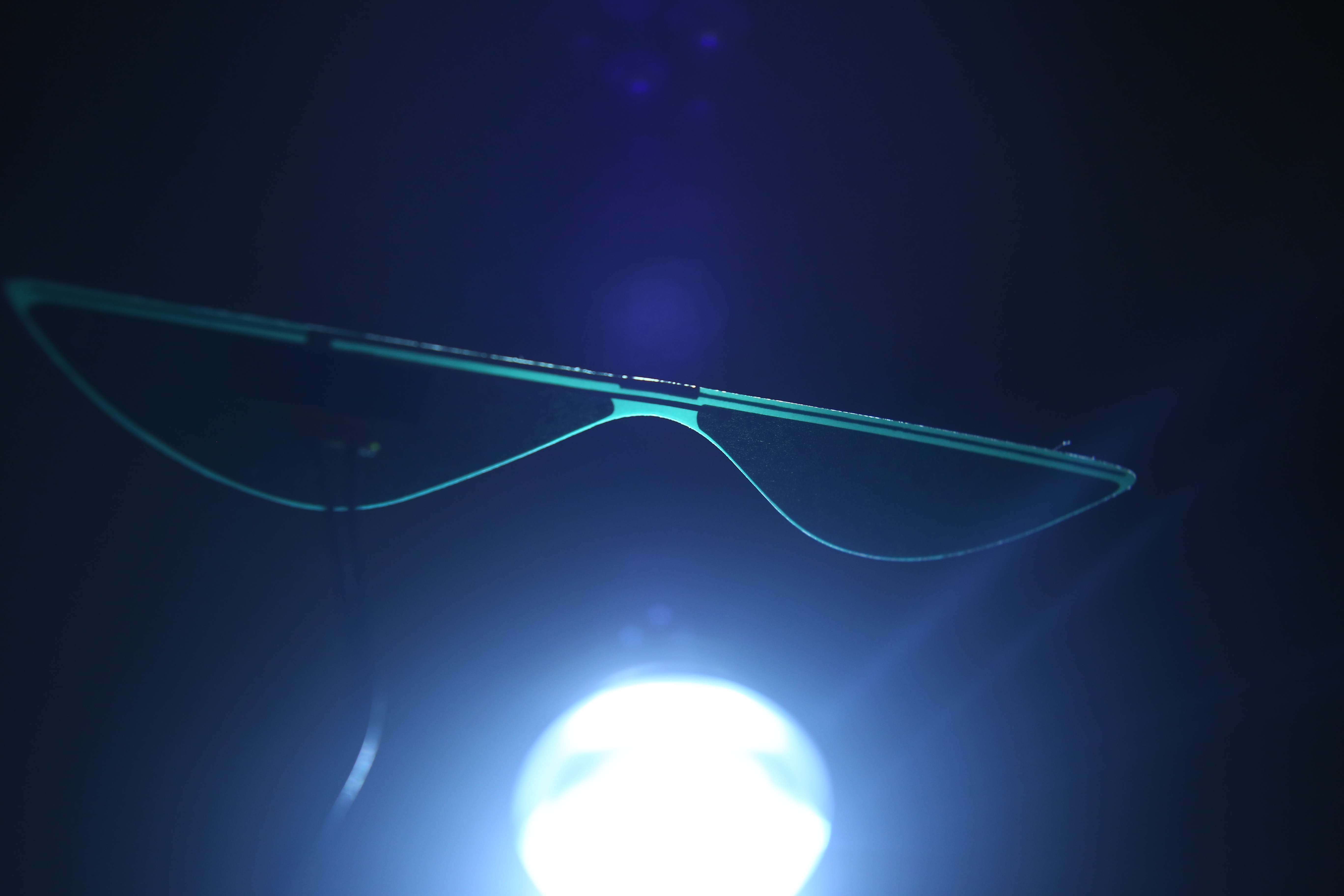

Try pressing your thumb hard in different places with the shoe on. It will give you a good idea where the problem is. Try the center of the el panel first, then try the large dome...then above the large dome on the fabric area. Most likely your EL panel failing in the center though, it can somehow cause both domes to go out...not just the front one. I've seen a front dome go out, then a few minutes later the whole thing went out. Here's a pic holding the EL panel over a light, you can see how small the connections inside it are.
its the el panel around the large dome area, I opened up my mag and the connectors are fine the panel is the ine giving me problems
