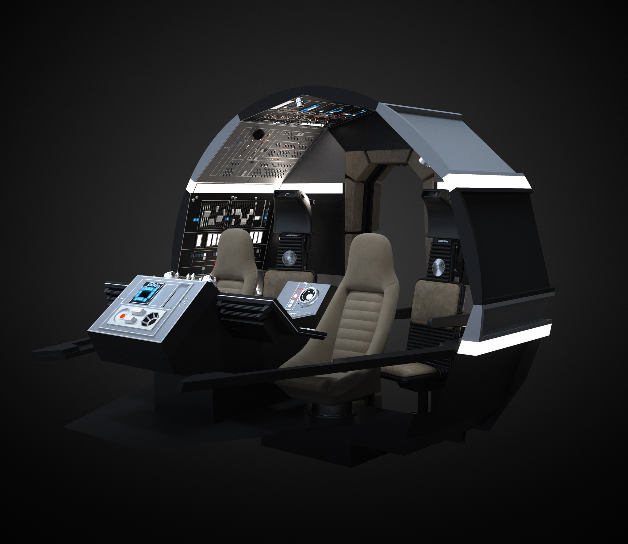

Due to the surface/solid nature of the files - you could take them a part and use just the bits that are useful to you. All the buttons, toggles, LED's, levers and so-on are separate objects within the file and could be printed separate or as a whole assembly.

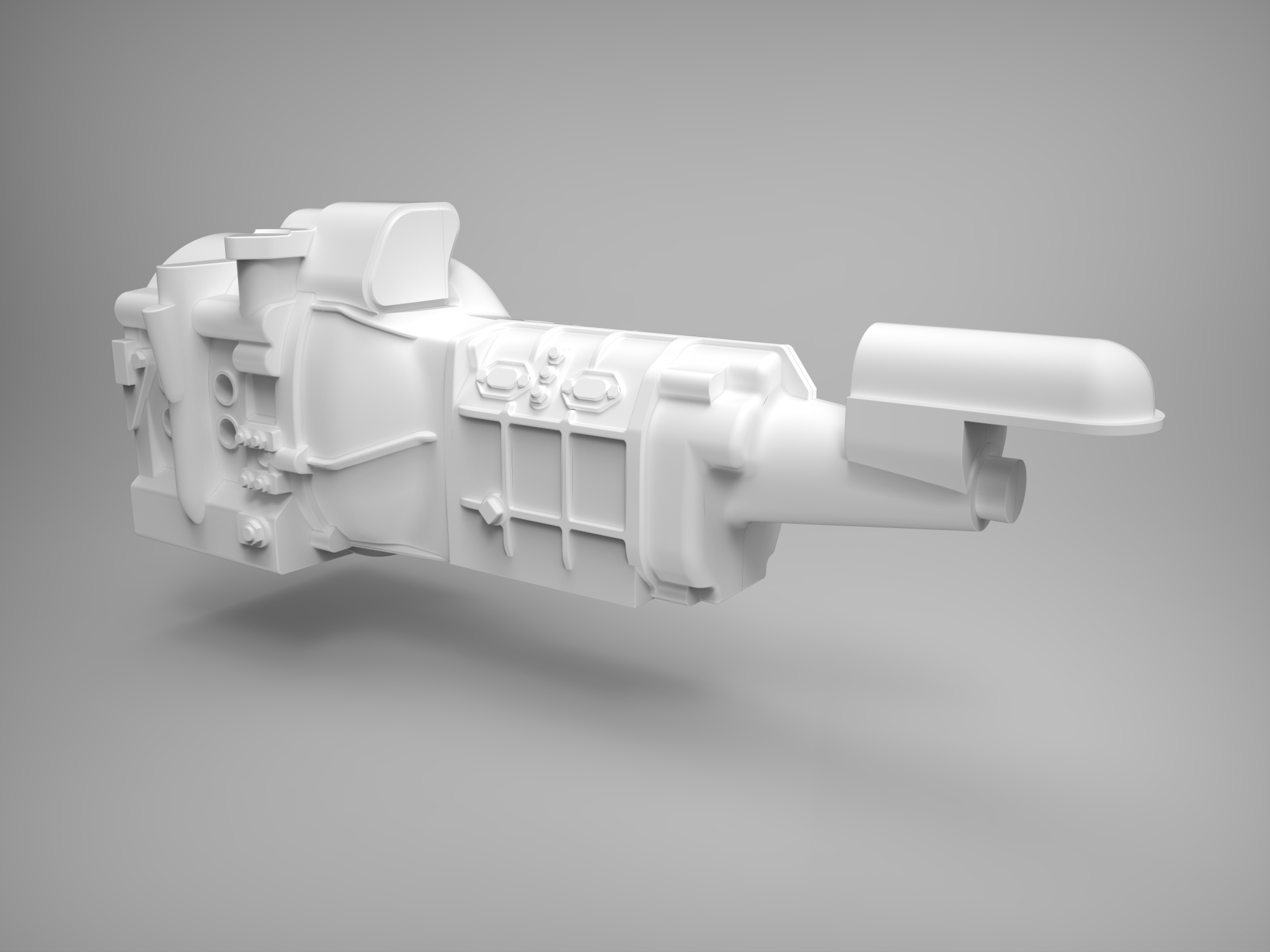

I typically scale the STEP files to the size I want them, then mesh the model to a resolution just a bit higher than what my printer is capable of.

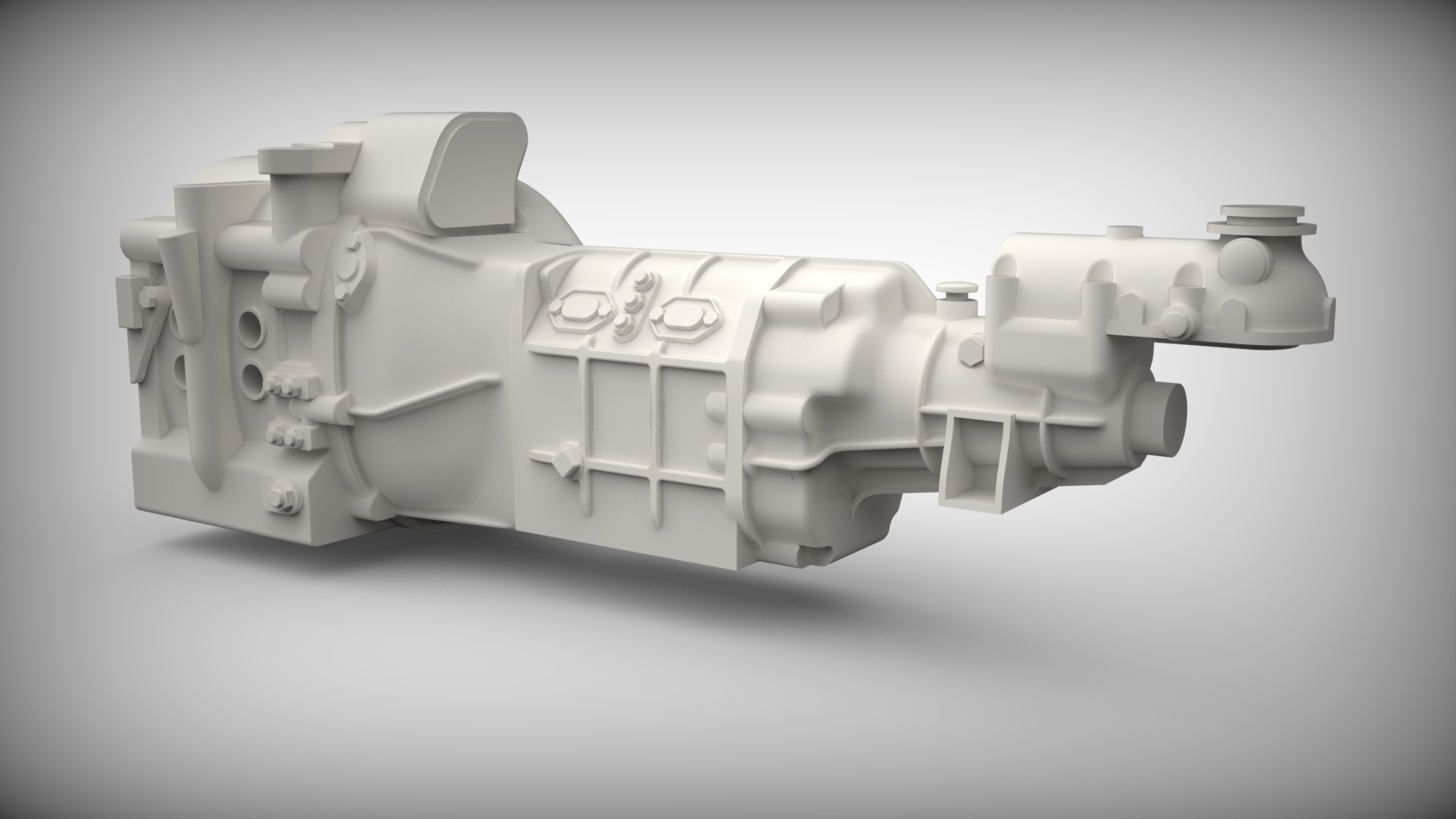

PS: I think once I get in to making the kit parts it will go quicker - by nature, they are small bits, and are more easily managed. But my plan still holds to work in resolution independent formats and let the user decide how to mesh and print the files. A hypothetical scenario is someone wants to make a full scale falcon - but the original 5' falcon used a ¼" scale wankel transmission as a greeble. So you could take the kit part and scale it up 5.5x and have the right part for the full sized bird - at this point you'd probably be machining the part and not printing it - but the STEP files are good for that too.
