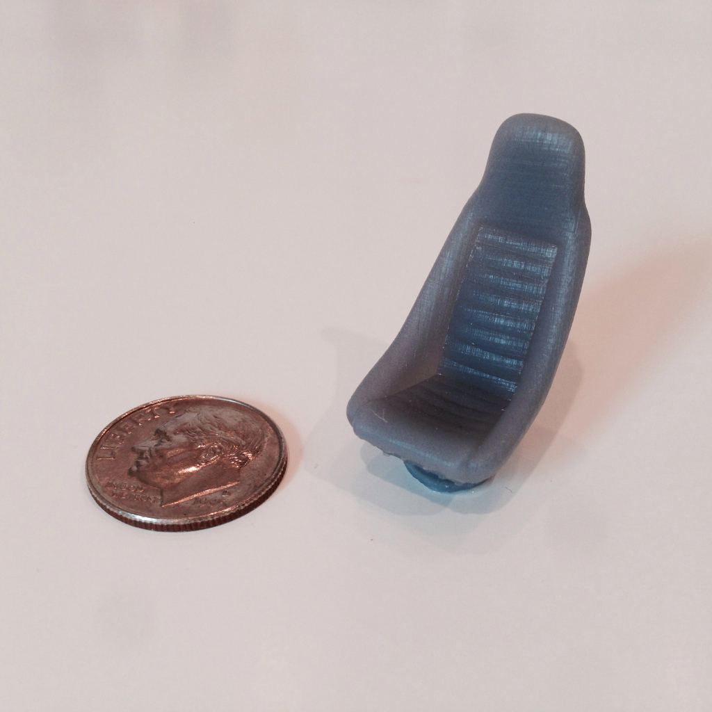

Boom. 4 ½ hours on the bed and I have a tiny (1/35th scale) seat!
Still needs to cure and a bit of clean-up. But for a first test of the new toy, I'm pretty stoked!
