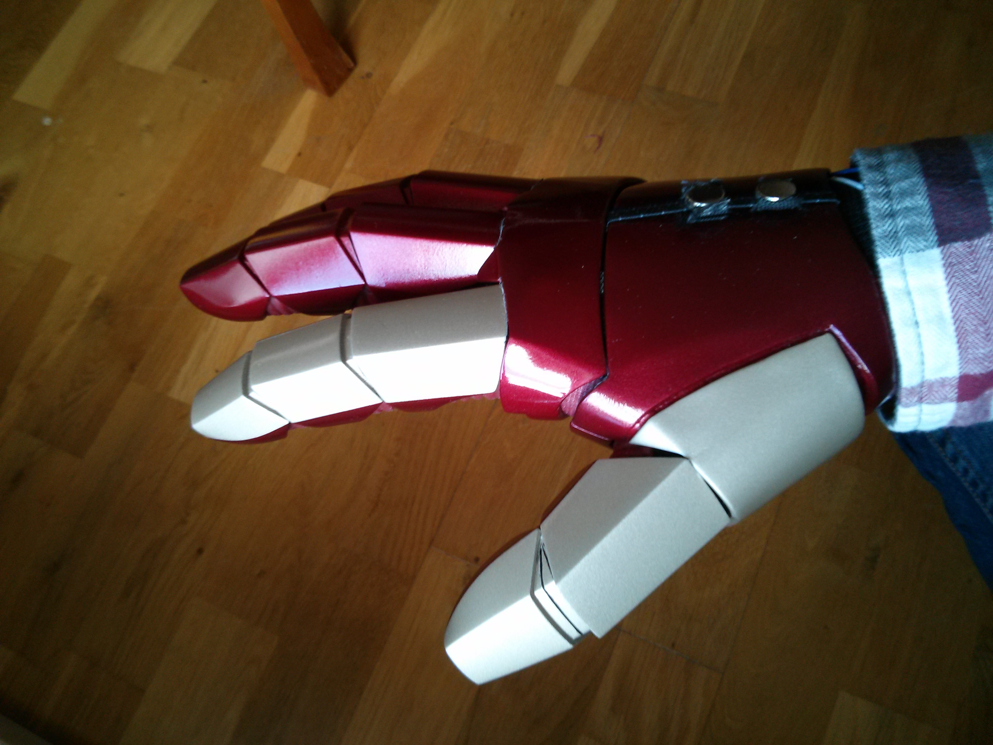

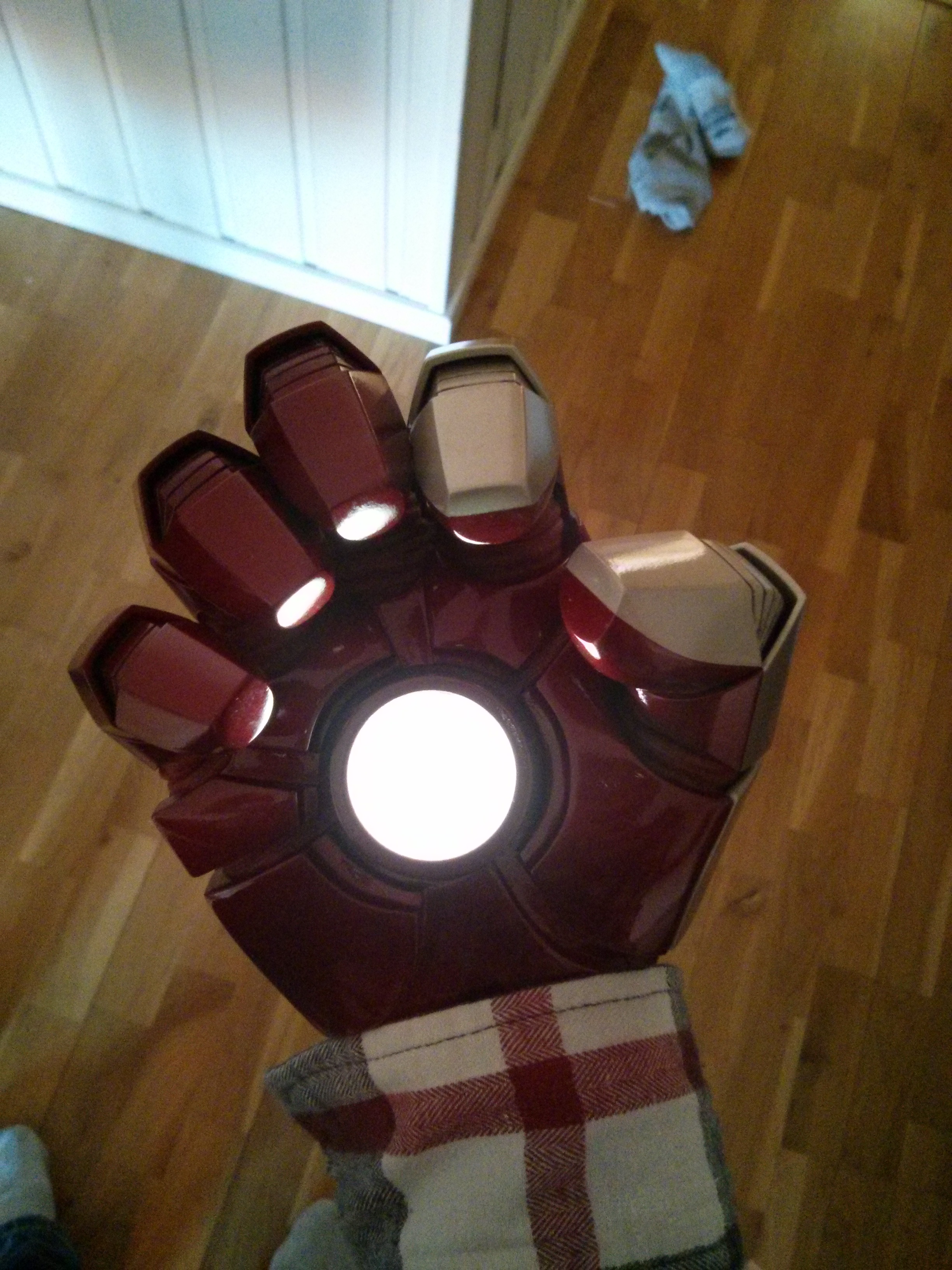

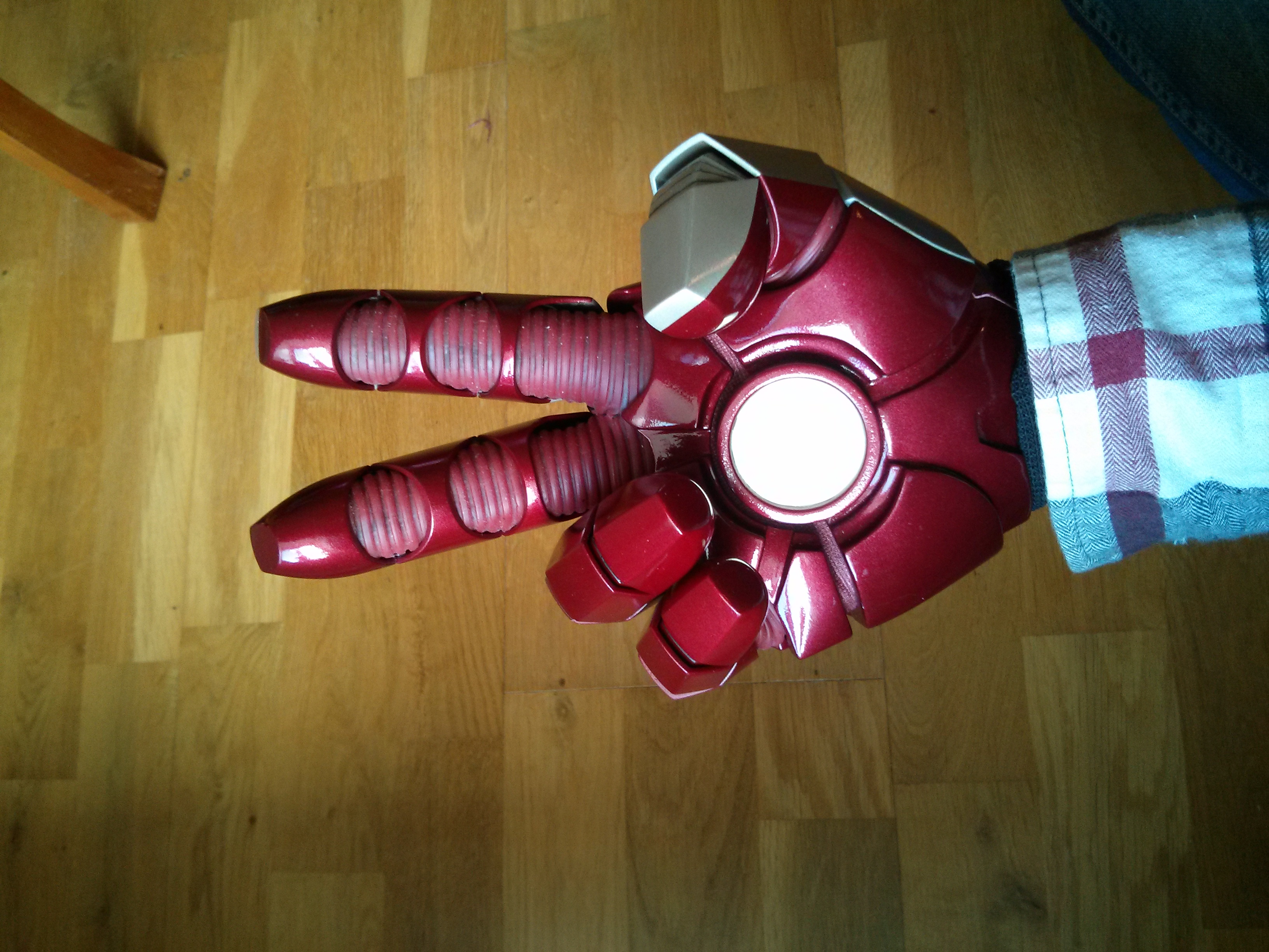

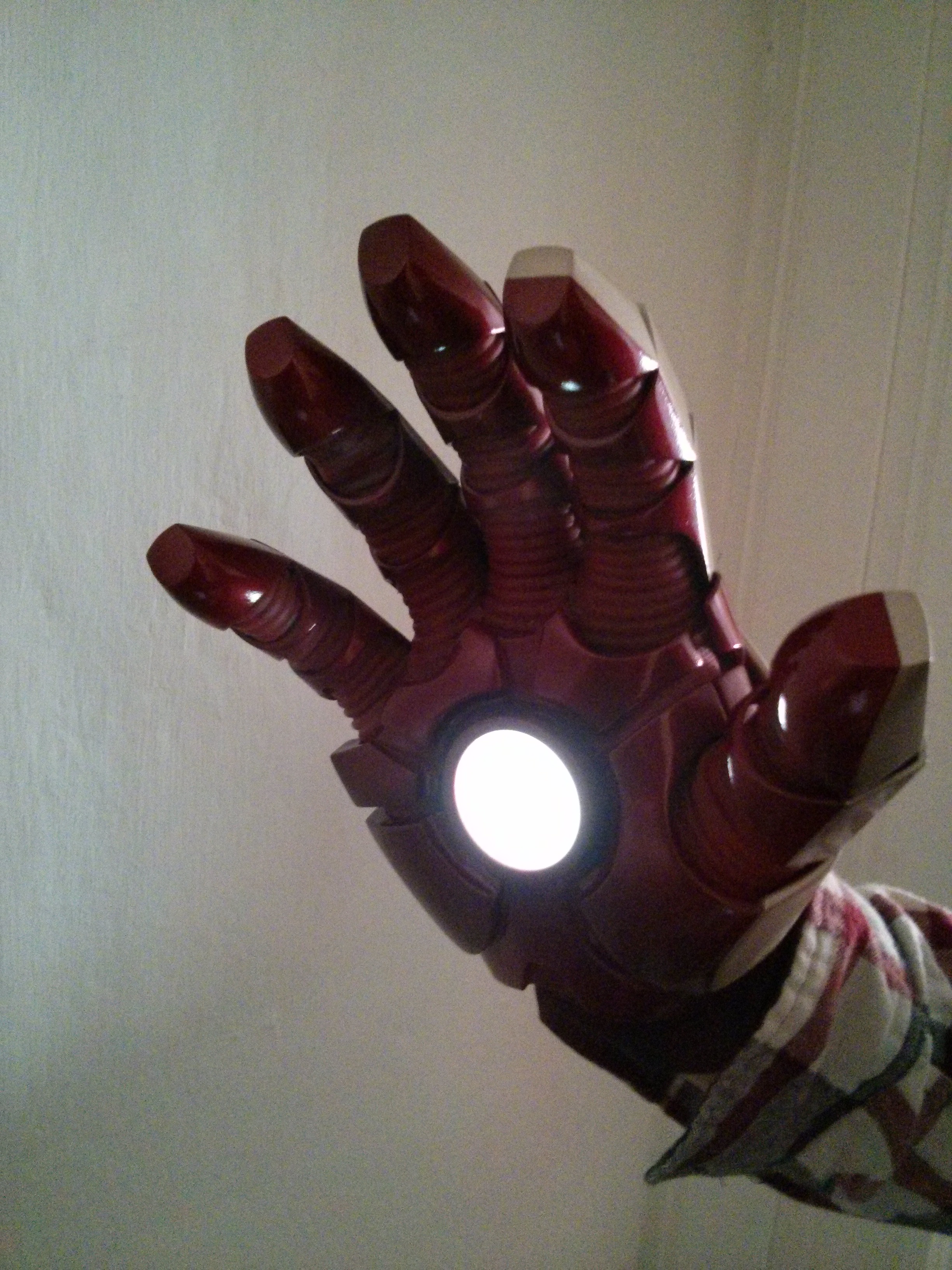

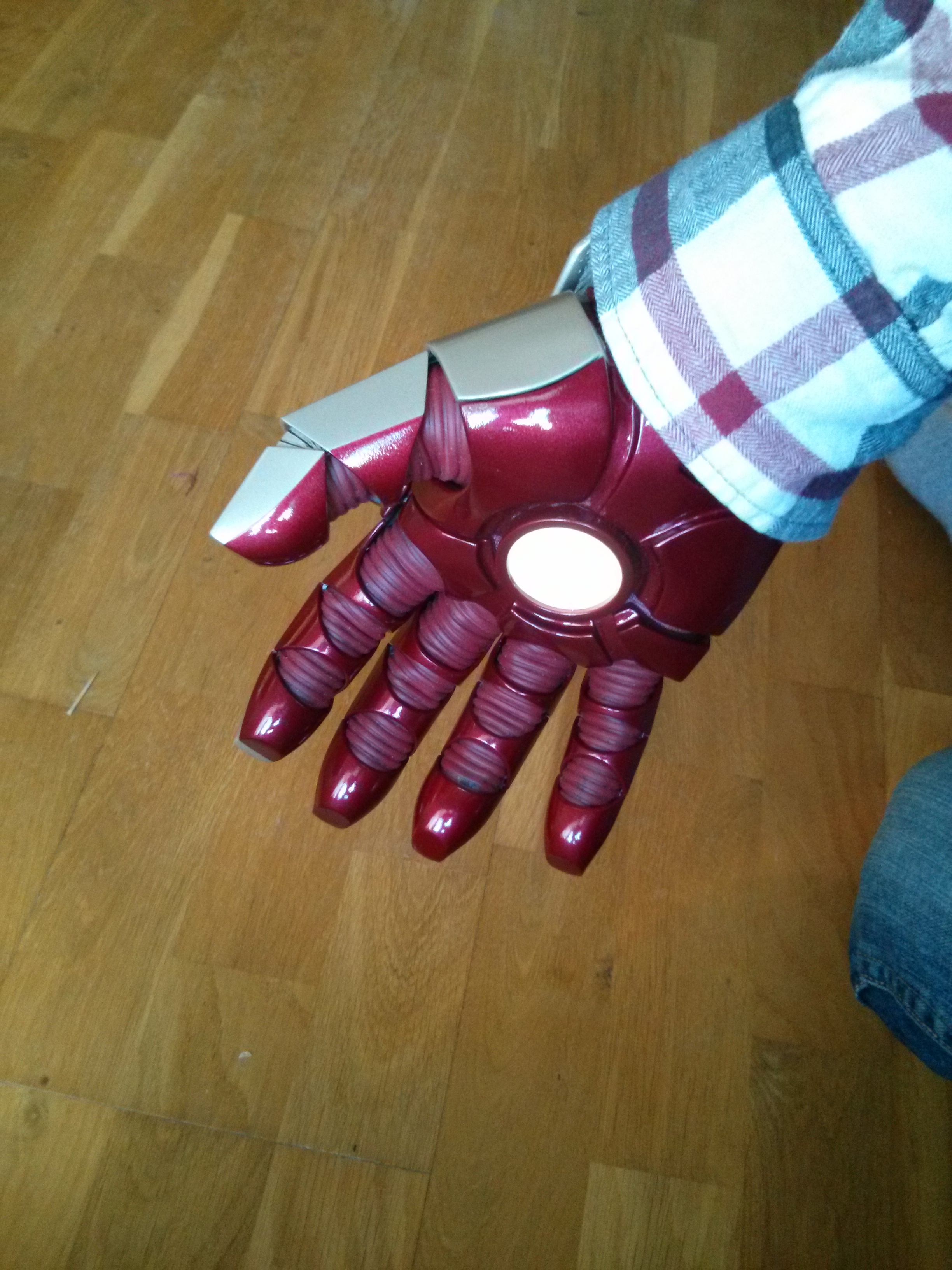

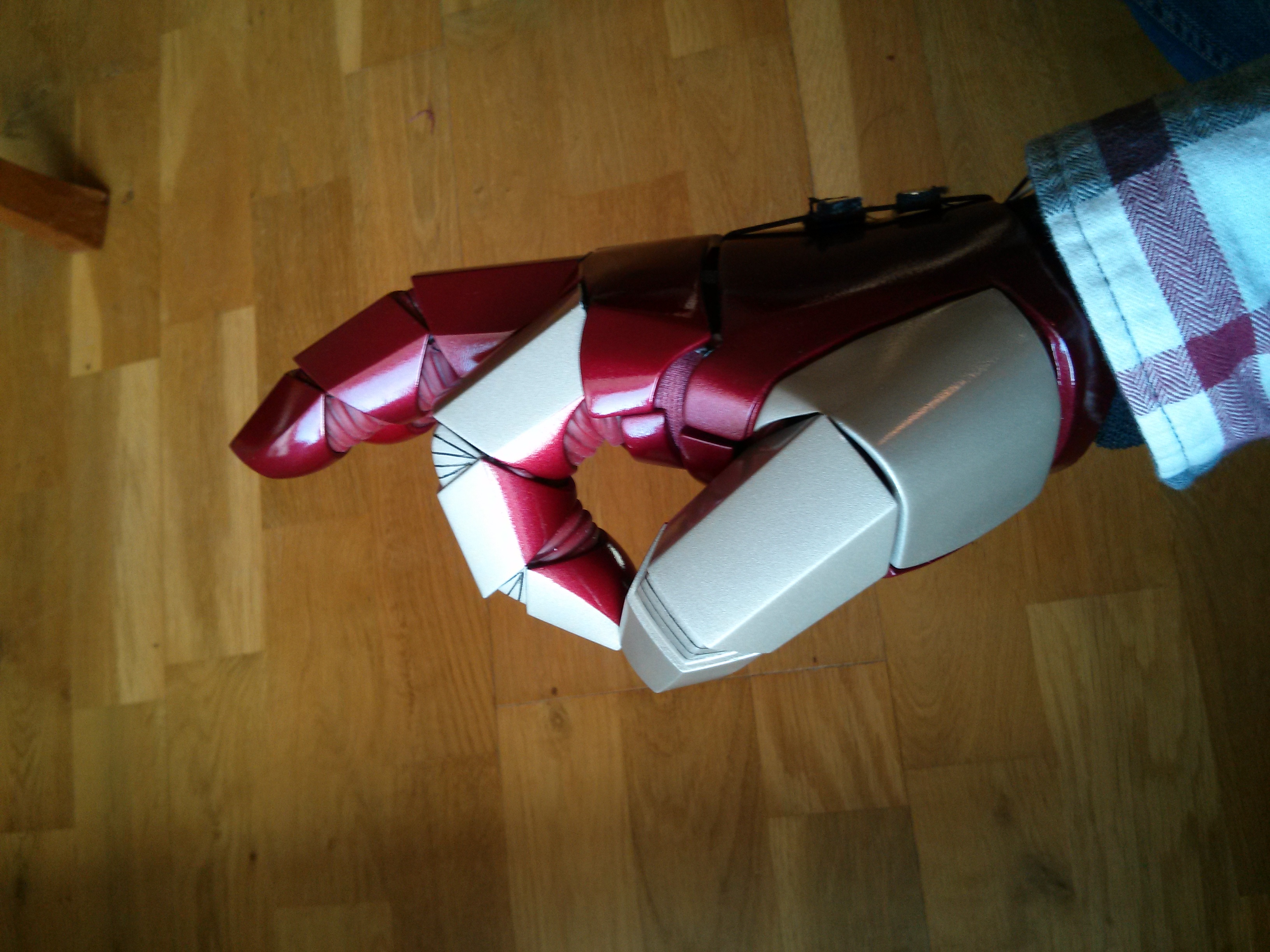

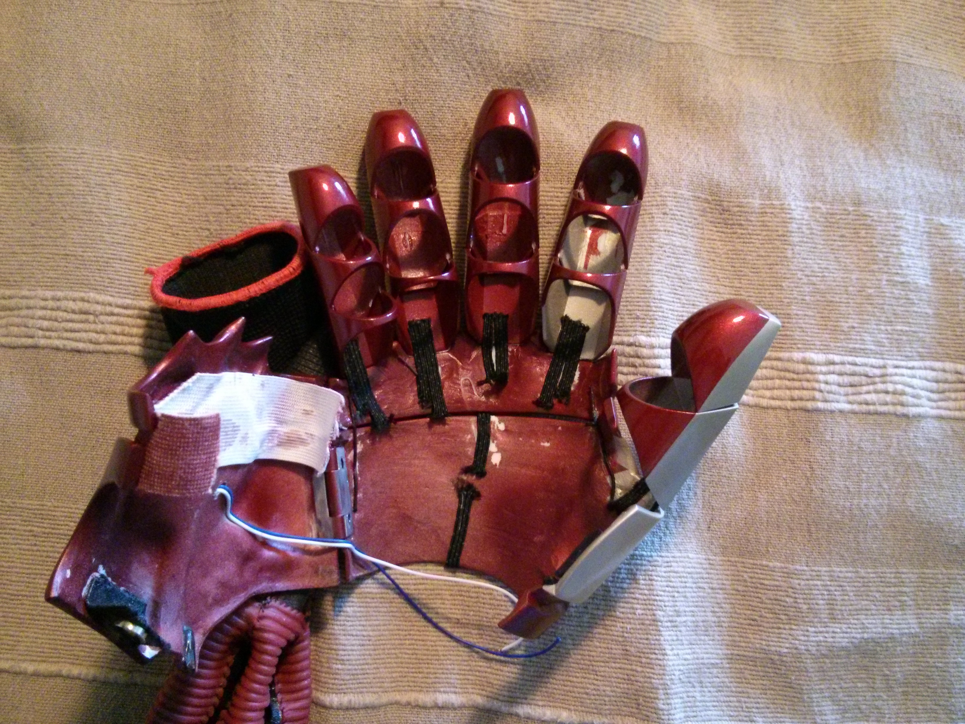

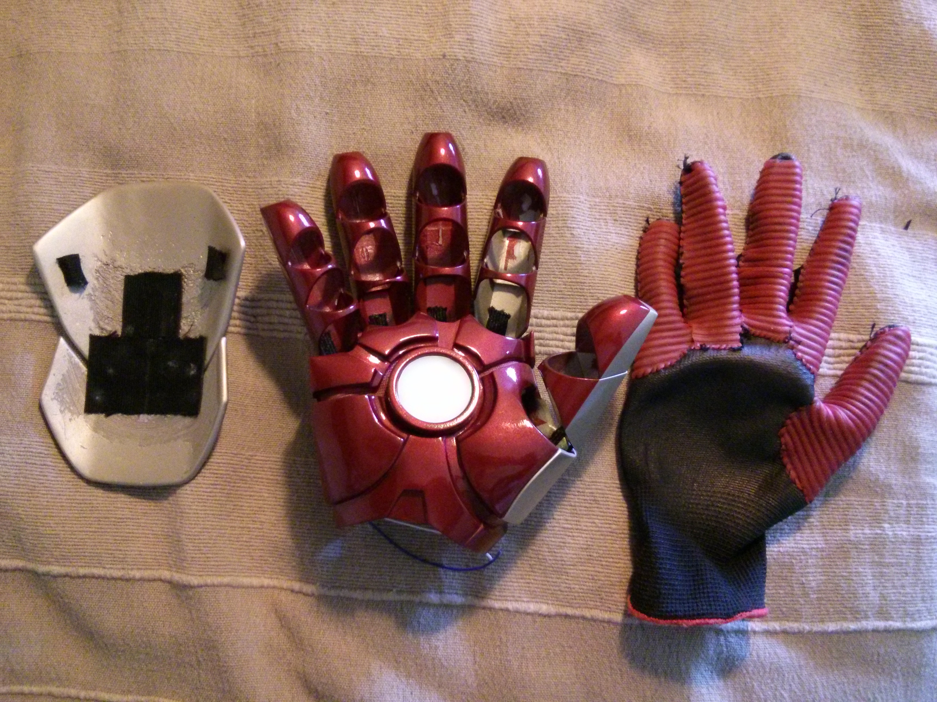

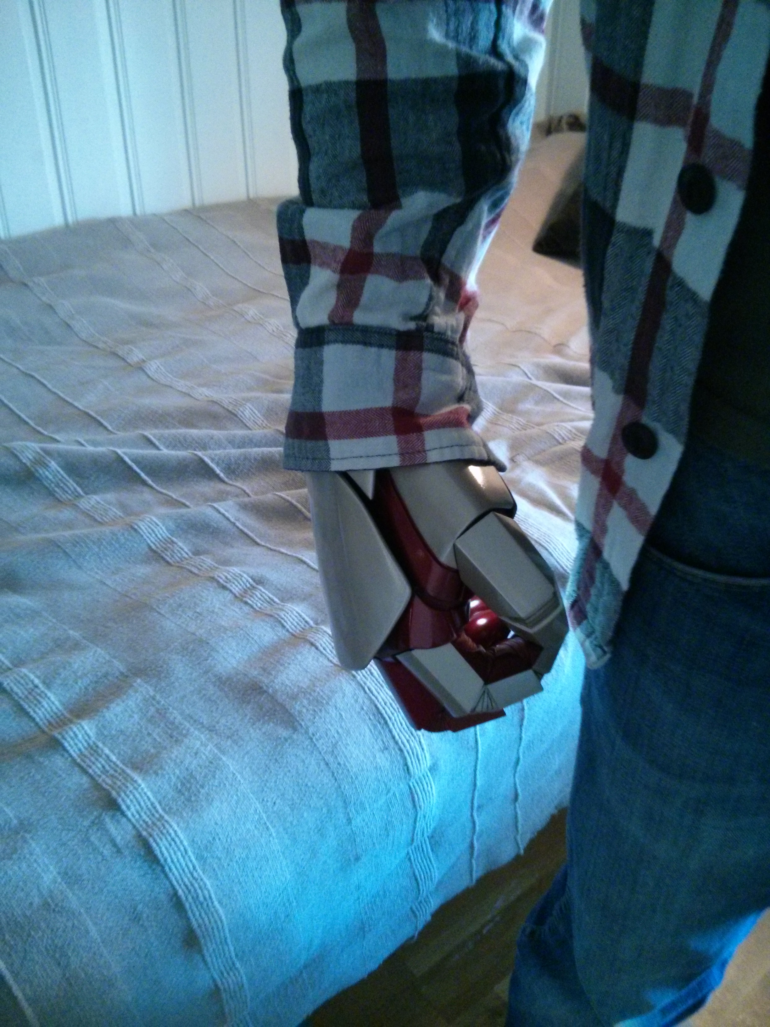

There we go!
Finished the last details less than an hour before before I had to go, but it's done :D
View attachment 177536View attachment 177537View attachment 177540View attachment 177541View attachment 177547View attachment 177548View attachment 177550View attachment 177545View attachment 177544View attachment 177543View attachment 177553View attachment 177555View attachment 177556
As for the movie, I liked it. Some unexpected twists as well :)
I'll add the STL-files for the fingers soon if anyone wants to print their own set

Also, what is the rubber you used for the fingers on the under glove?
Re: My go at creating an accurately articulated Iron Man glove (helmet on hold)
Where did you get your repulsor light and how bright is it? Thanks
I got them from eBay: 2012 Cold White G4 SMD 3582 Lamp Light Car Bulb 12V Pin Brand New 24 LED Hot | eBay
They are pretty bright, but it's tricky to diffuse the light enough to not see the individual LEDs.
Very nice work, well done, I wonder what type of glue you did use?
Thanks!
Superglue for the elastics and epoxy for the finger joints.
I used Smoot-On's Dragon Skin silicone brushed onto a ribbed mold. The pieces were then sewn onto a cotton glove.

Wow! Your hand looks amazing and part of it is the paint, which looks great. Do you mind me asking what method/color you used?
Re: Completed!My go at creating an Iron Man glove (helmet on hold)
Would you be interested in selling a set a 3d printed hands?
Sorry.
I'll have to say no atm.
It takes quite a bit of time rescaling every piece, orient them for print etc. which I don't have :(
However, the finger models are available on the second page in this thread.
Thanks!
I used touch-up spray paint from a budget automotive store. Toyota Mica Red Met. and Volvo Lunar Gold.

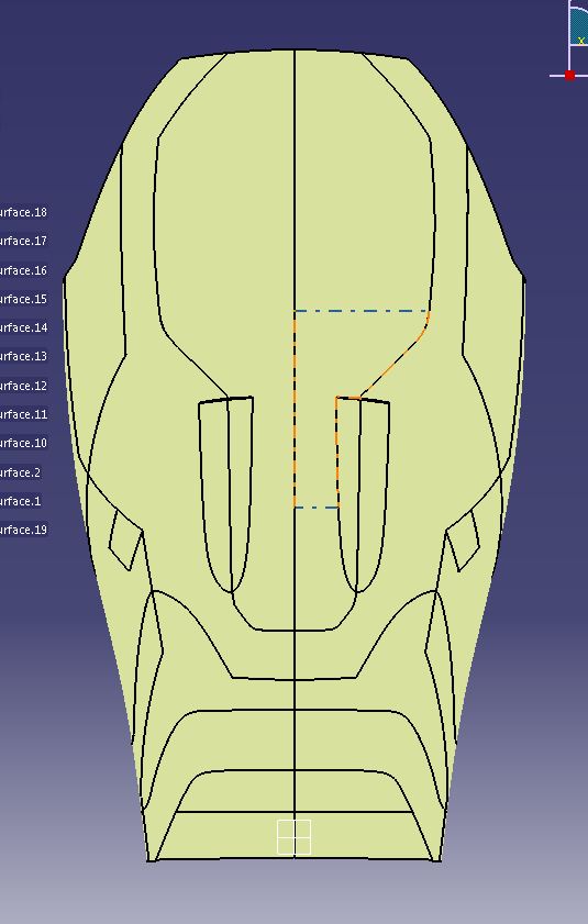

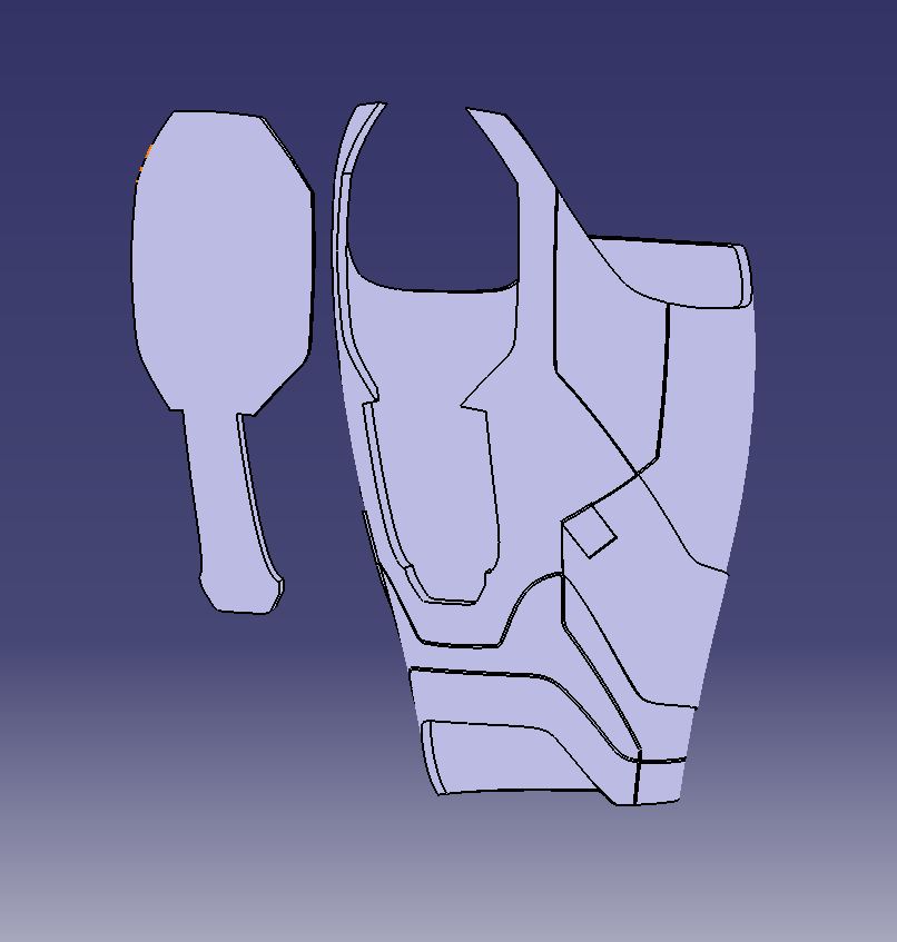

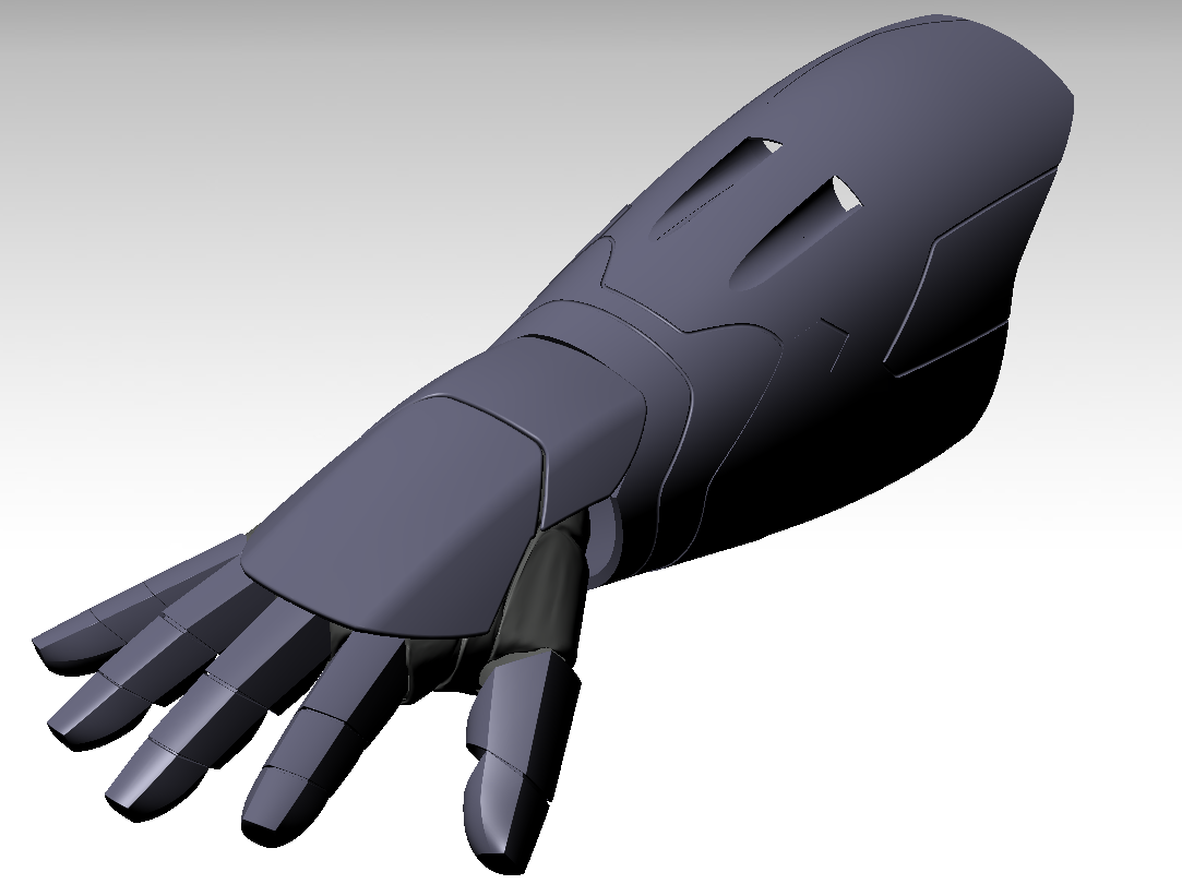

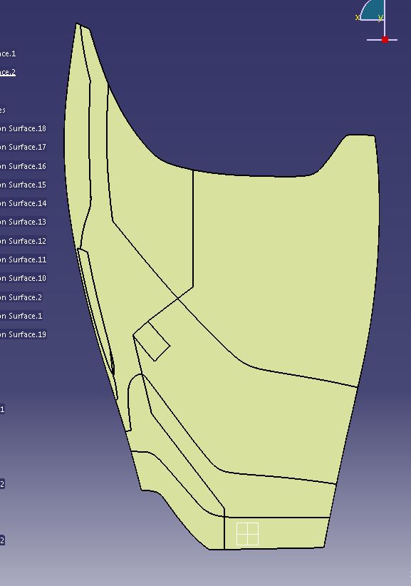

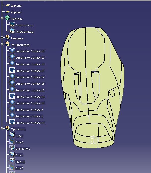

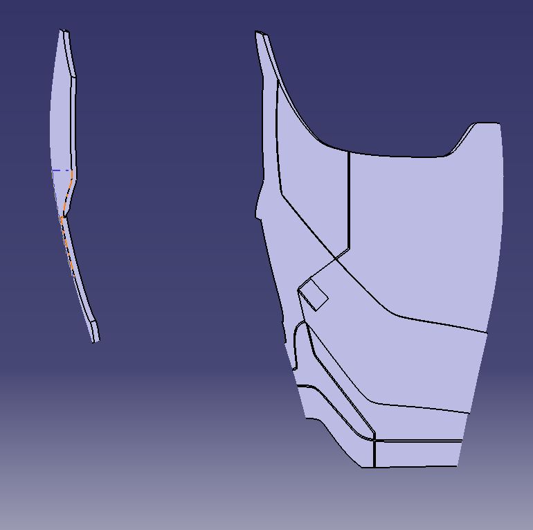

I decided to continue to work my way up the arm today :)
The outer forearm piece is taking shape.
I'm still considering to add the removable hatch and internal details. Still some work to do in that area.
This was made entirely from reference pictures, so any feedback on how to improve it is appreciated
