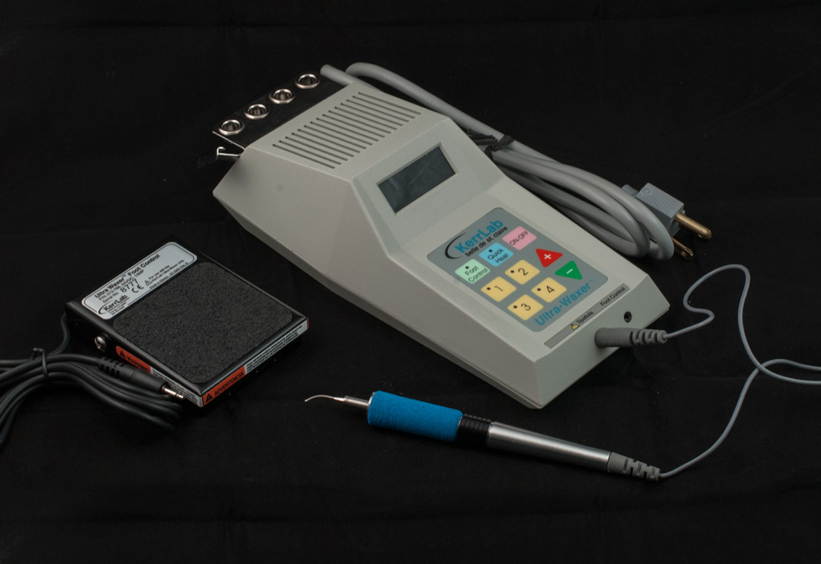

is something else. Its call a Finish product, because you can pour it, use it like clay, and at room temperature its like plastic, so its a finish product. The downside to it: It smell like melted plastic when you work with it in high temperature and you need hot tools like Kerrlab Ultra-waxer to carve into it when you return on a room temperature sculpt.

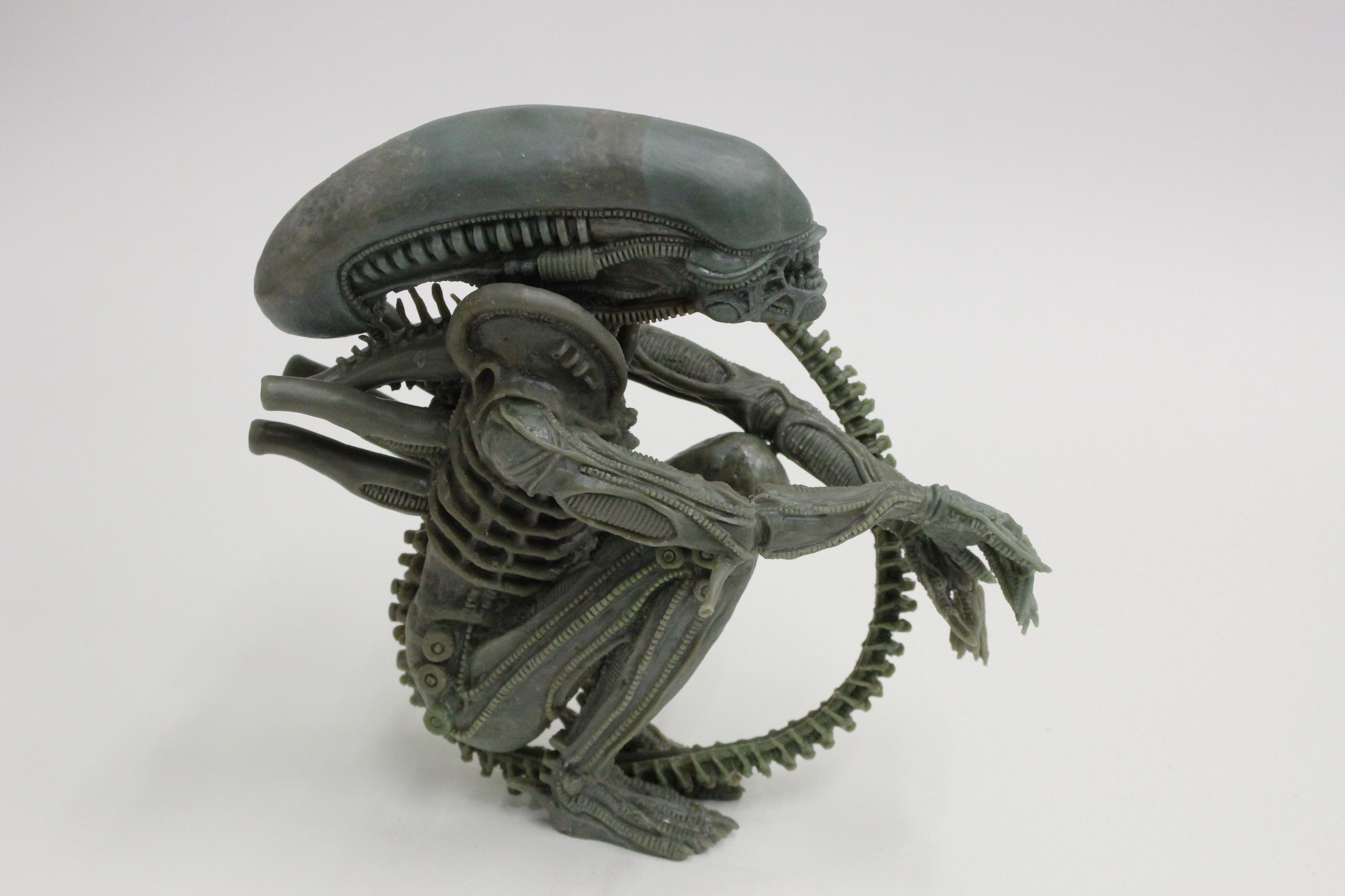

heres an alien, I sculpted in wax a while ago...
