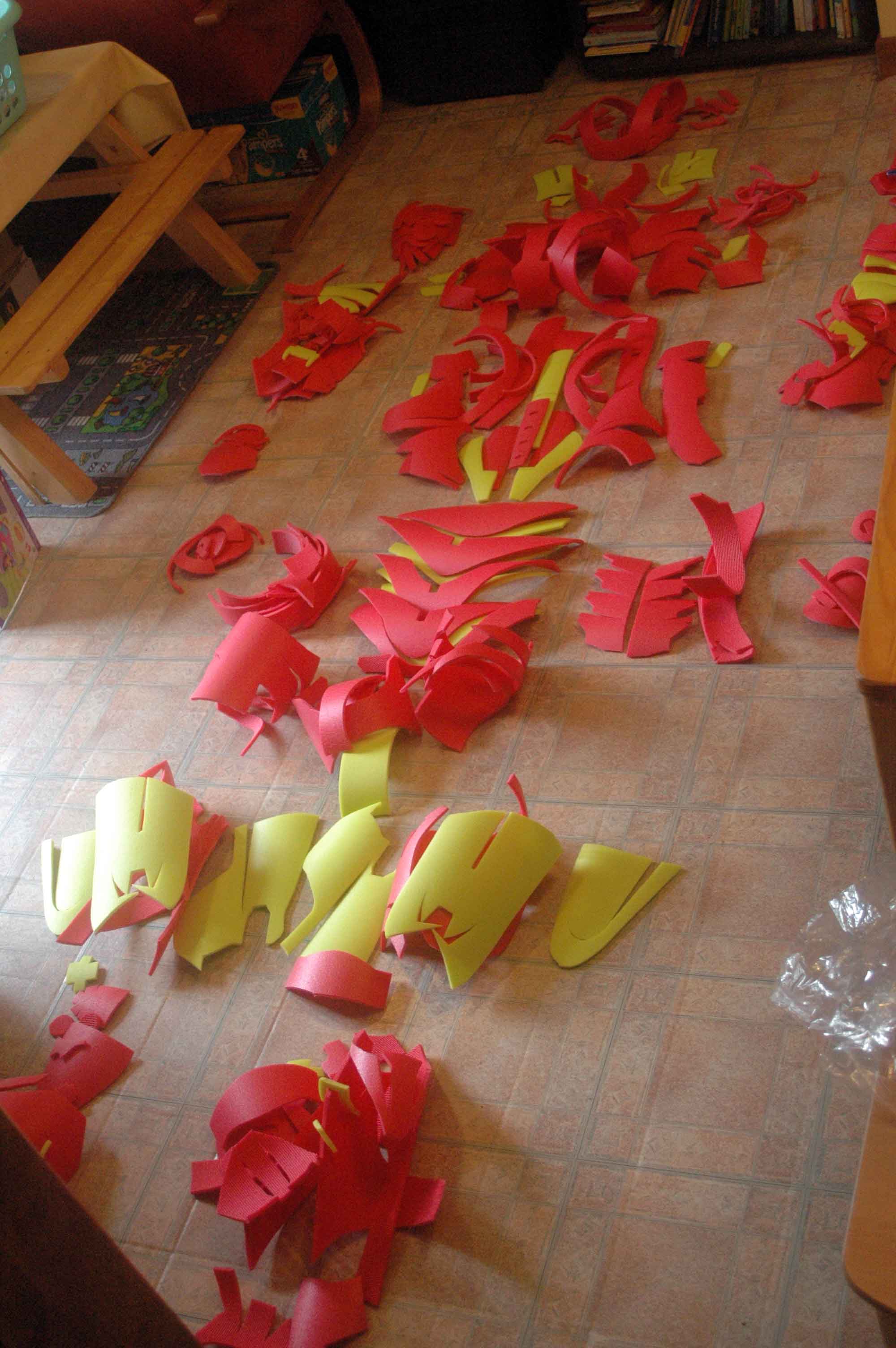

It's a chance, because it's also the cheapest I could find.
But in return, since it's provided in rolls, every piece I cut up always wants to spring back to its rolled shape. As a result I have to cut each piece in the way of the width or the heigh of the roll, but never in slantwise or the final armor part is distorded. The same problem for symetrical parts : the same foam piece for both leg for example must be cutted out in the same way, or your legs are not strictly identic.
It leads to an incredible amount of waisted foam.

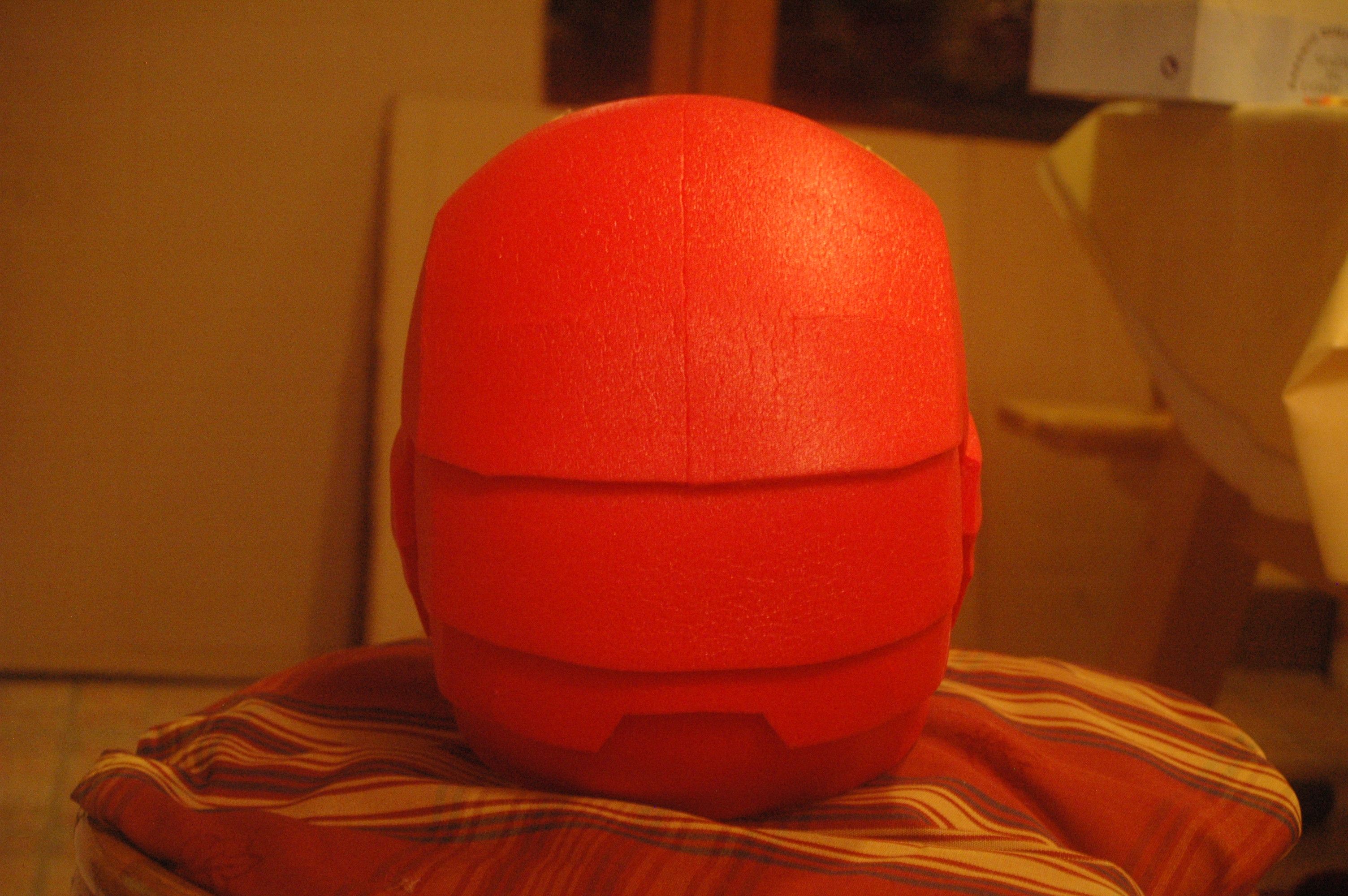

Re: FOAM speed-building files'n'tricks : Sharkhead IM helmet

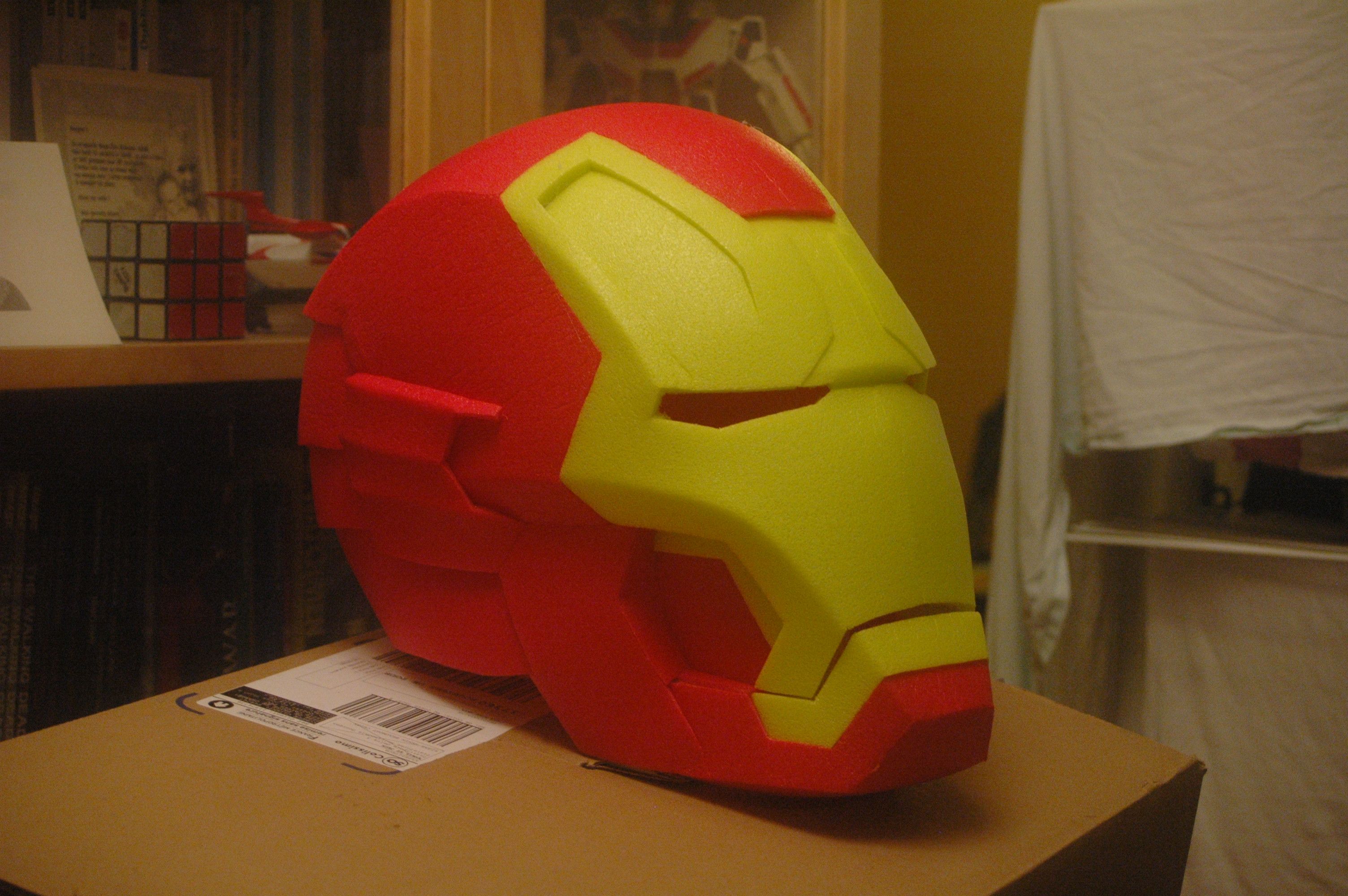

Damn that Iron Man lid is incredibly fantastic considering it's made of foam.

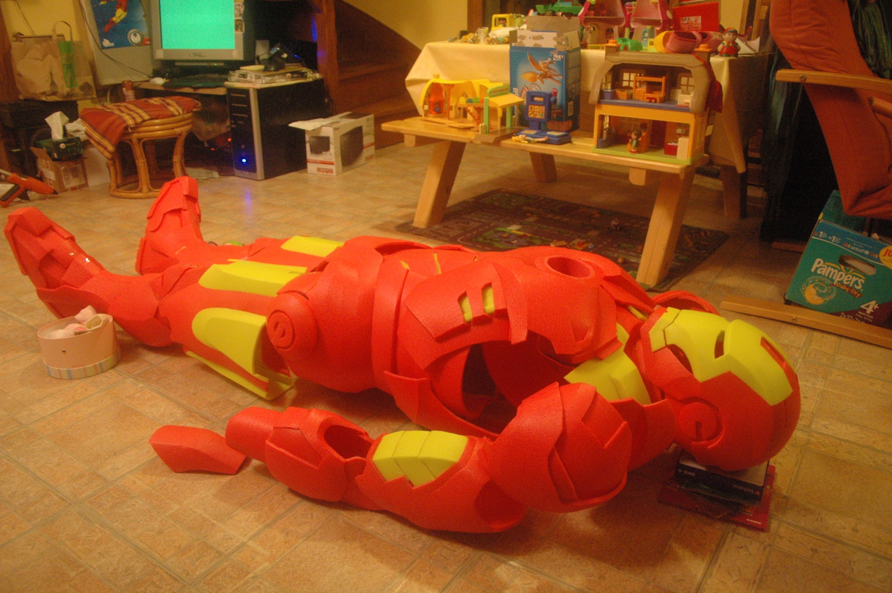

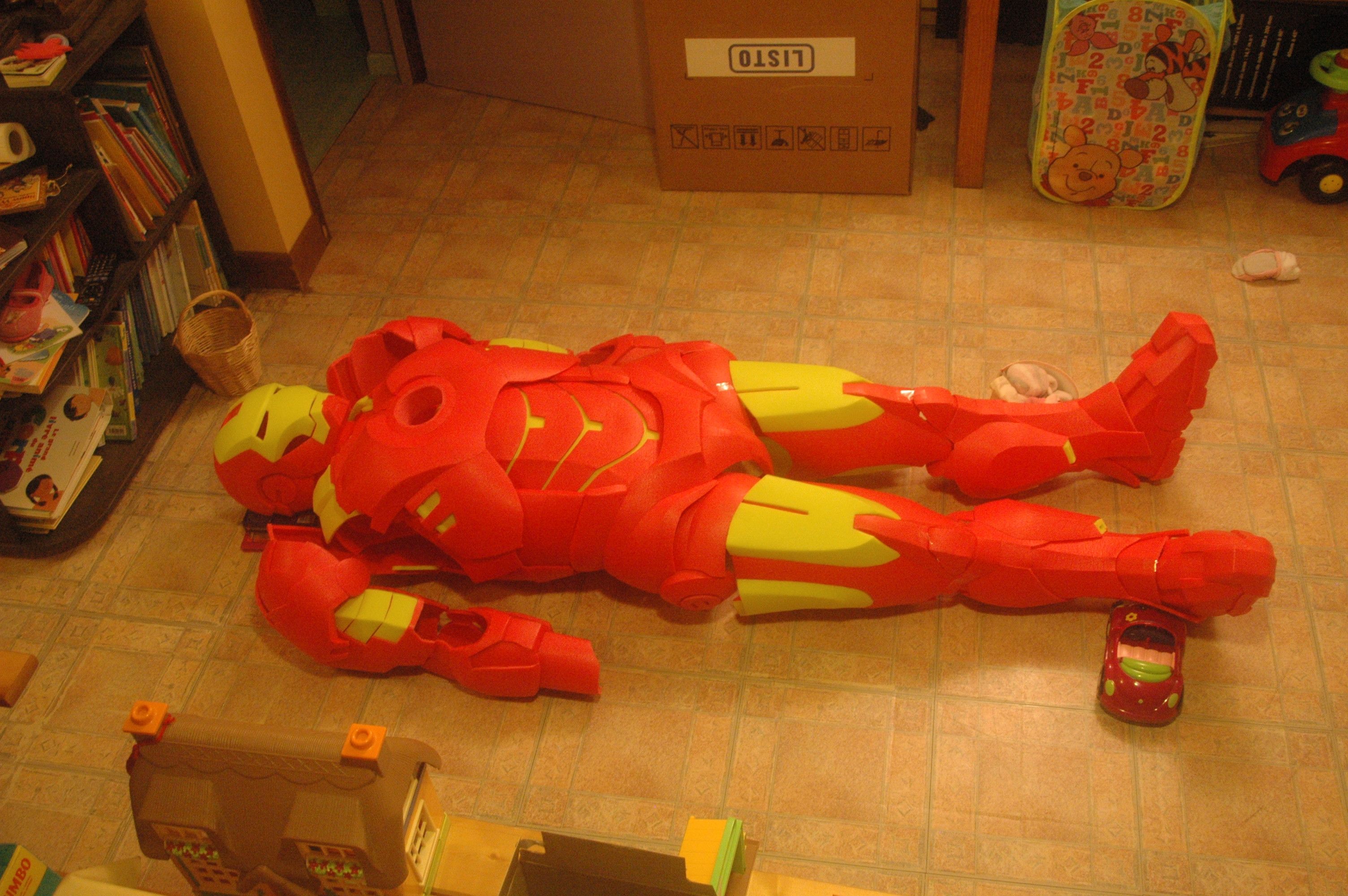

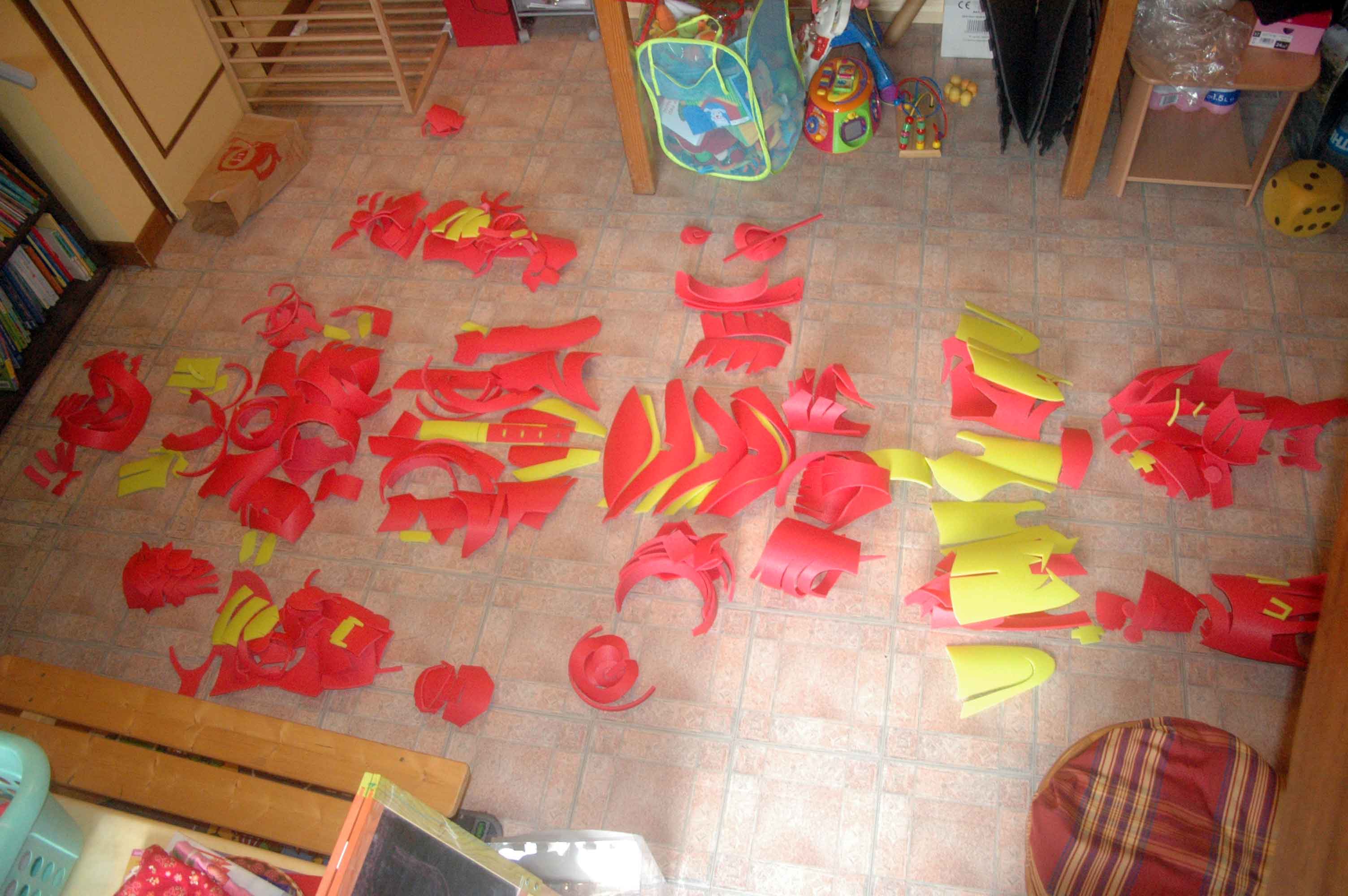

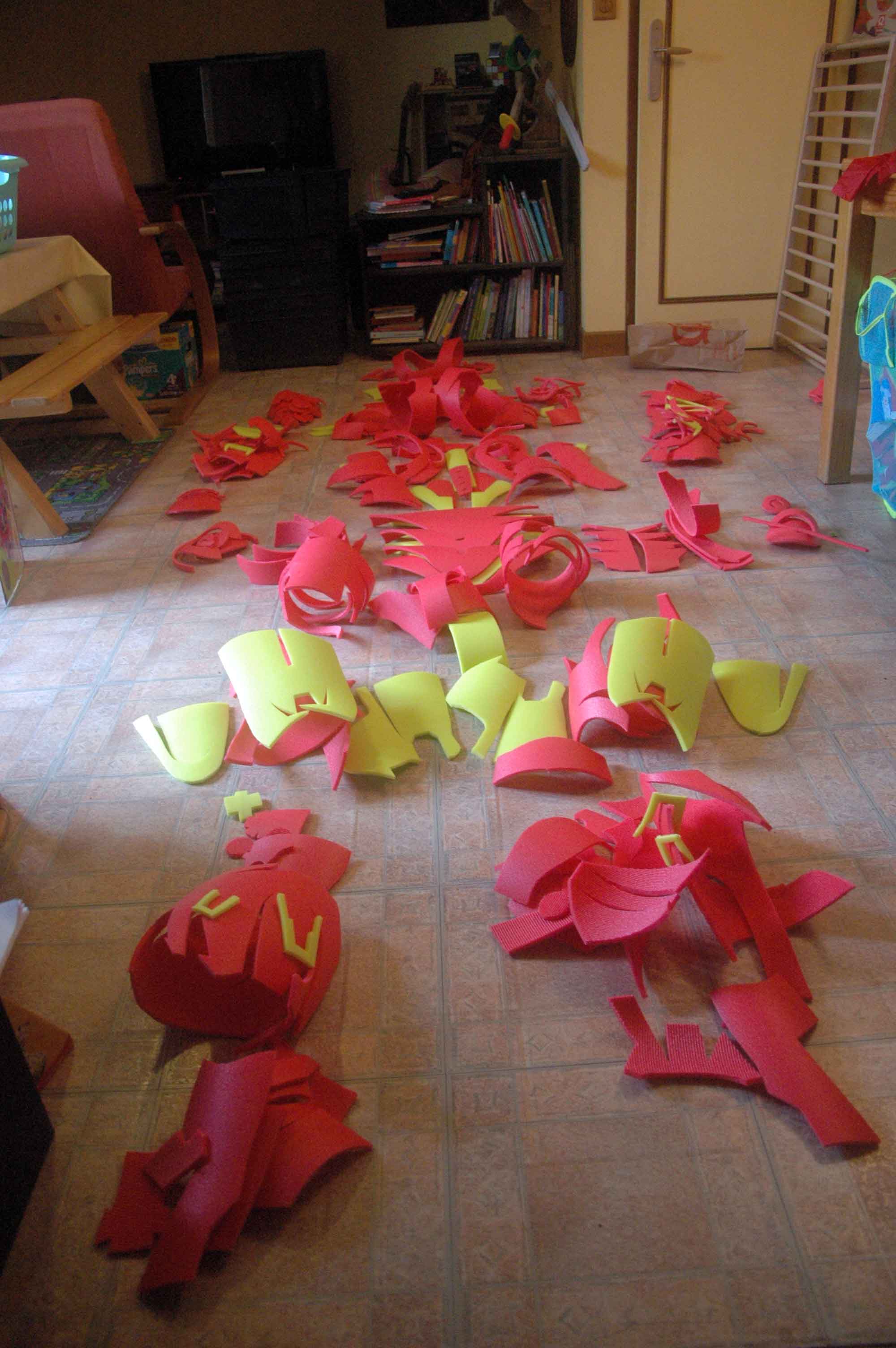

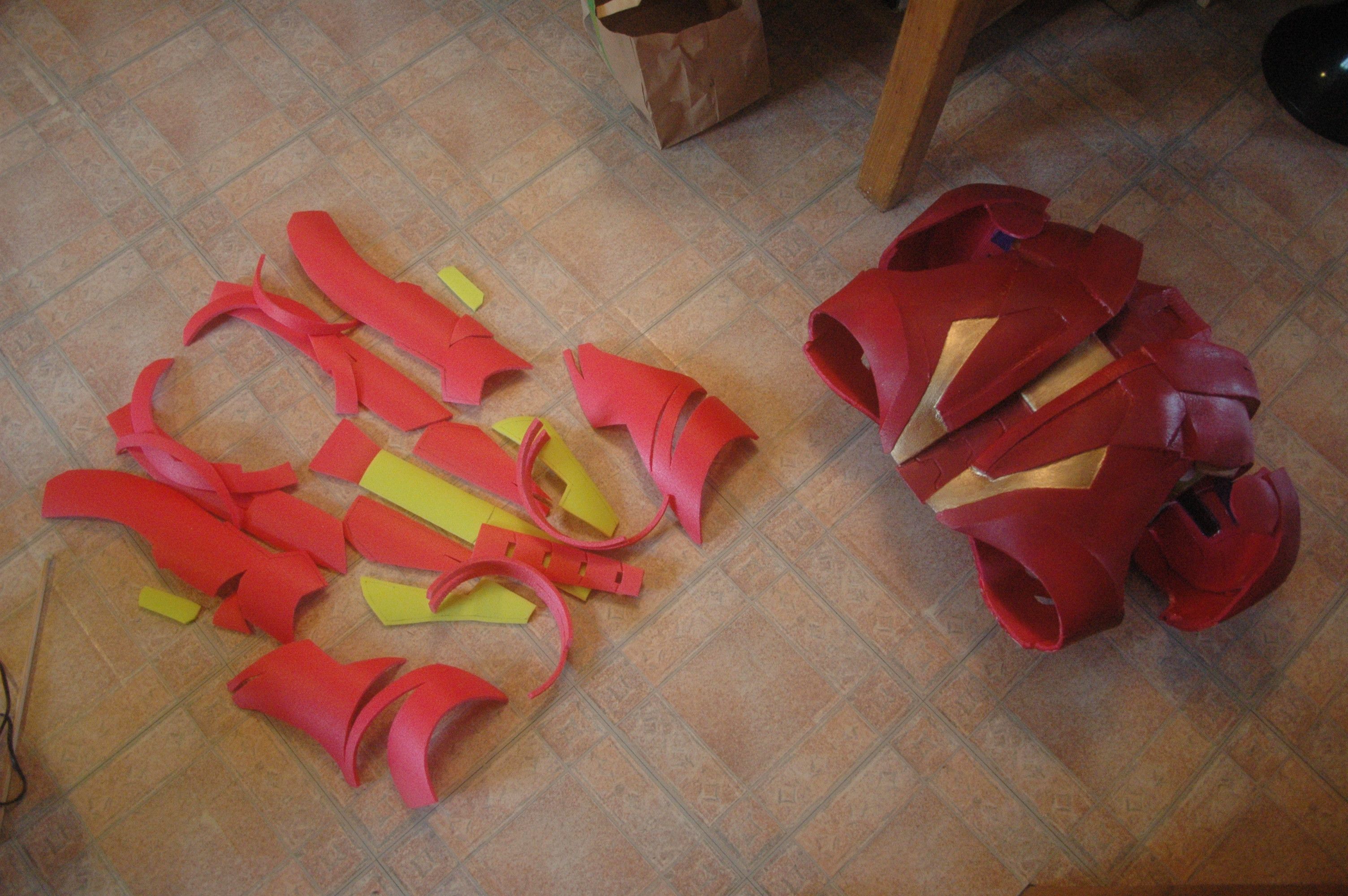

... The full suit is complete and will be parceled soon, I'll take pics before packing it.
From 288 foam pieces...
...to a full markIV suit :

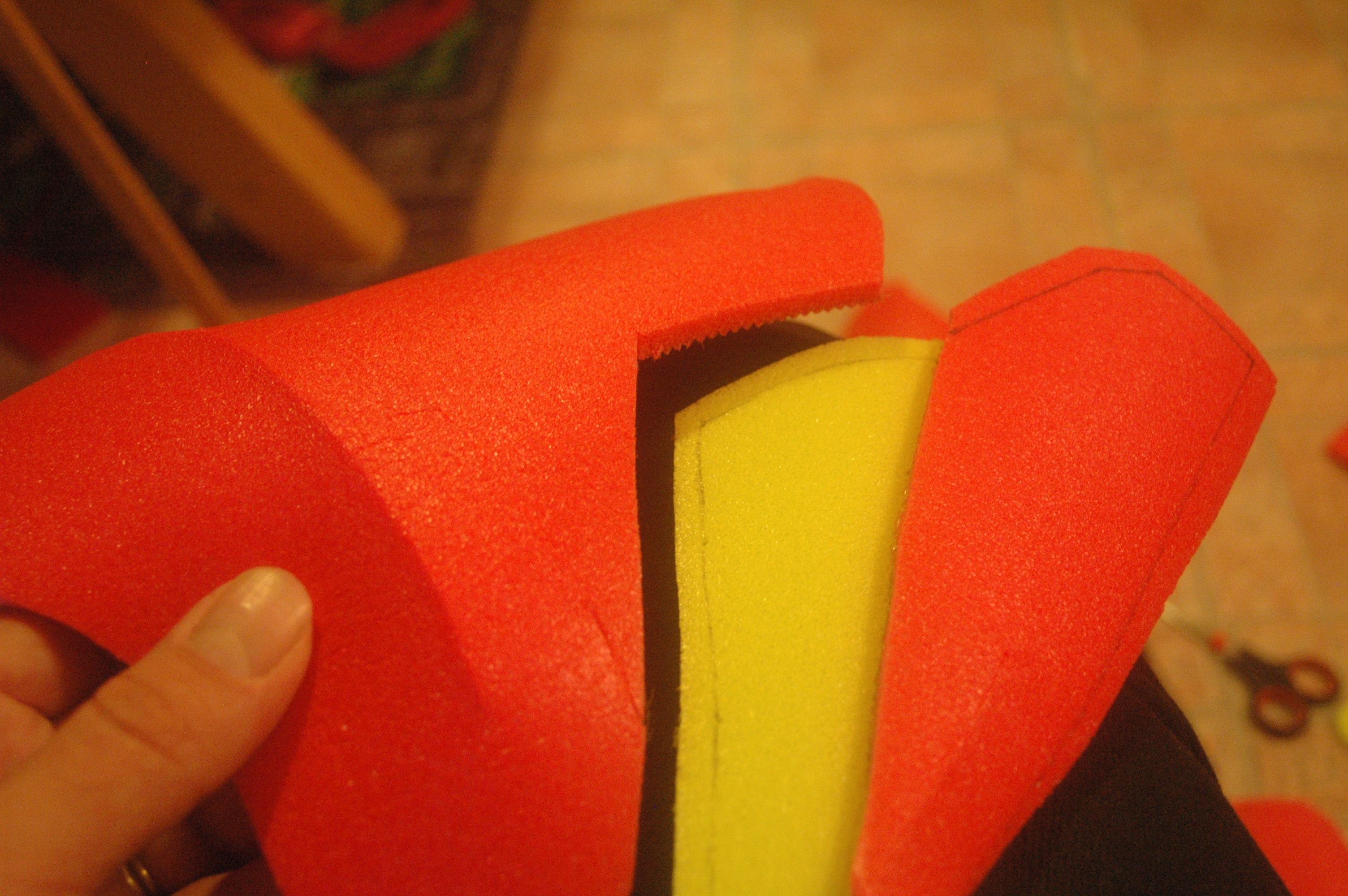

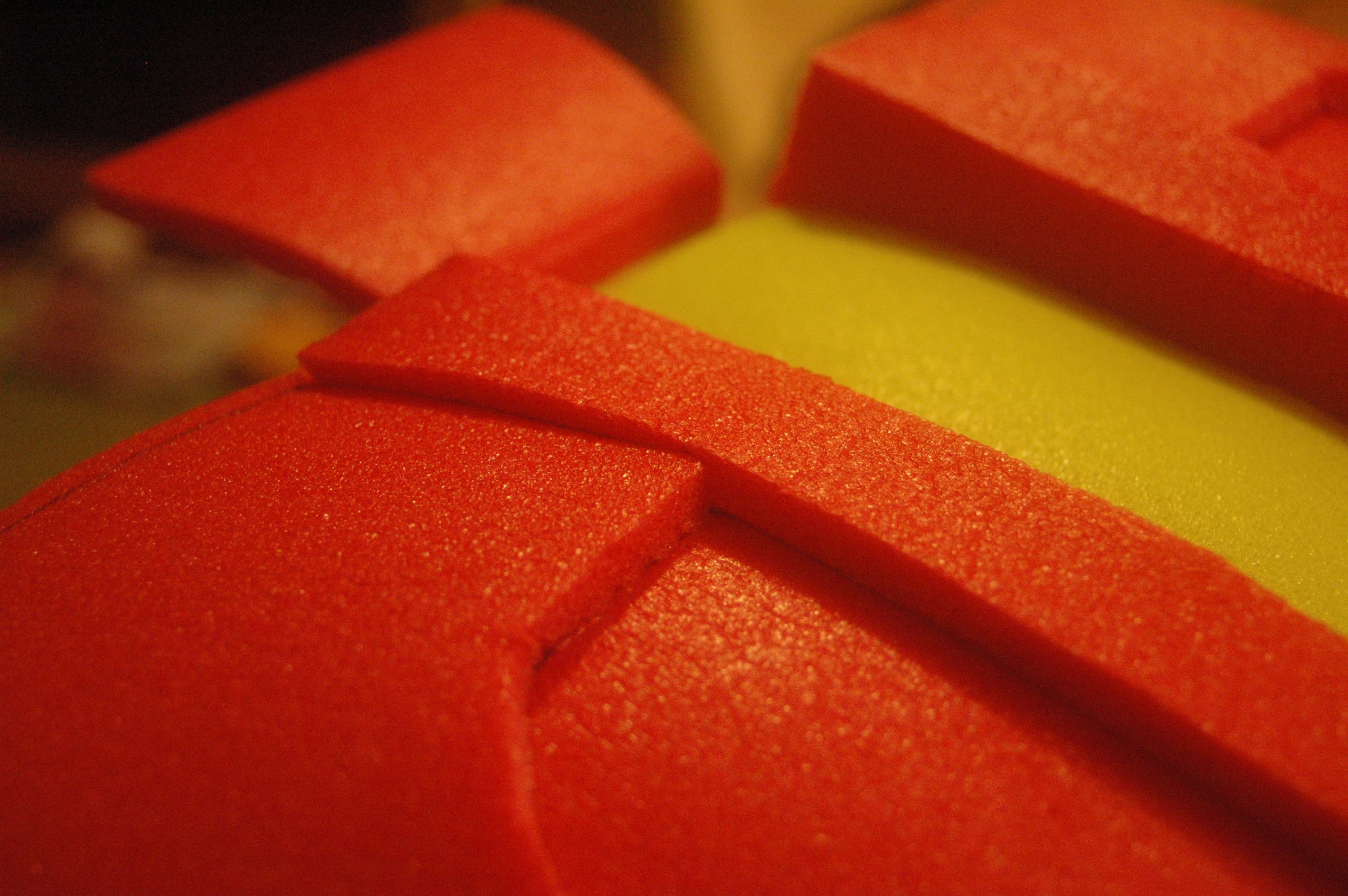

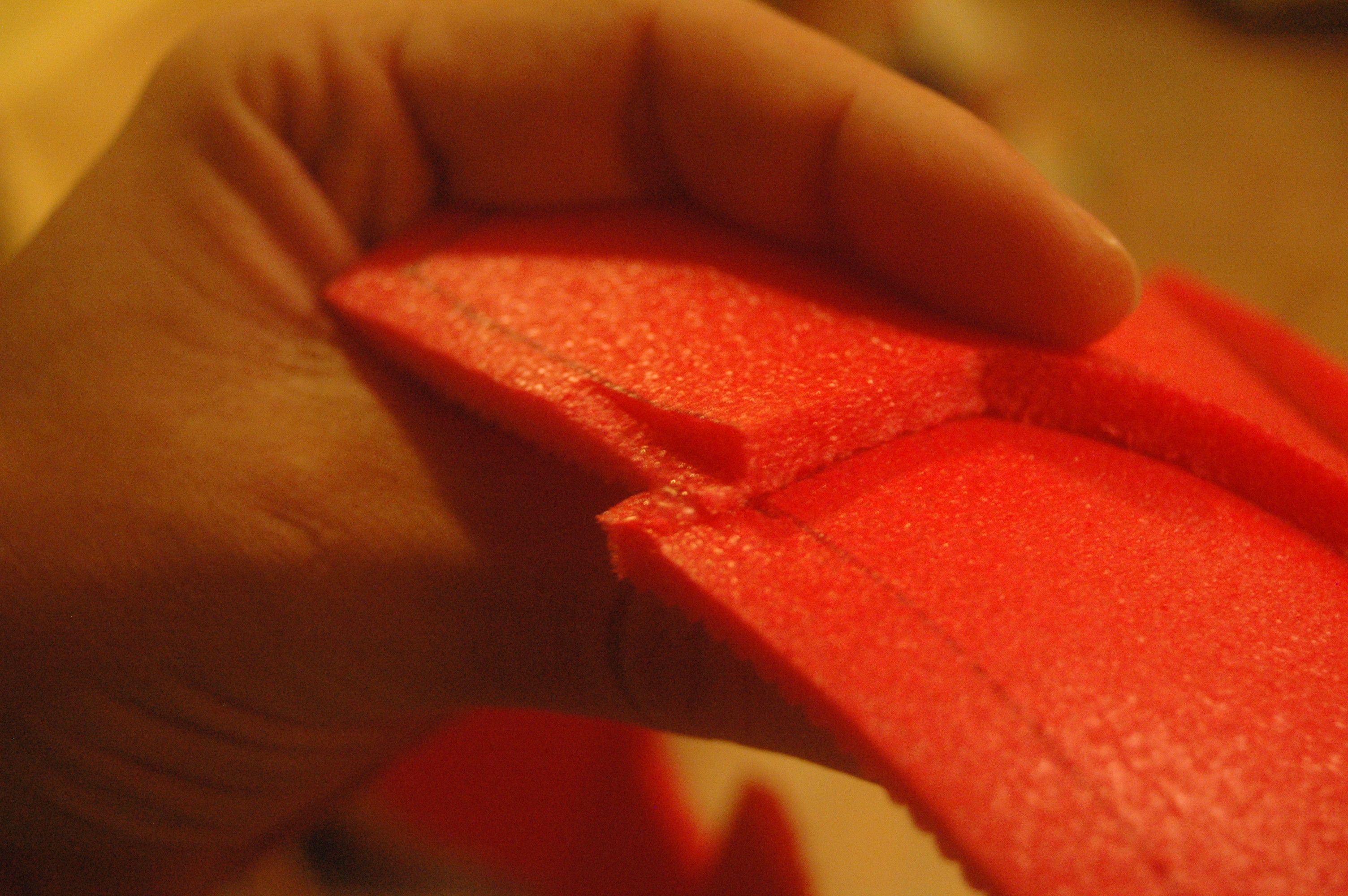

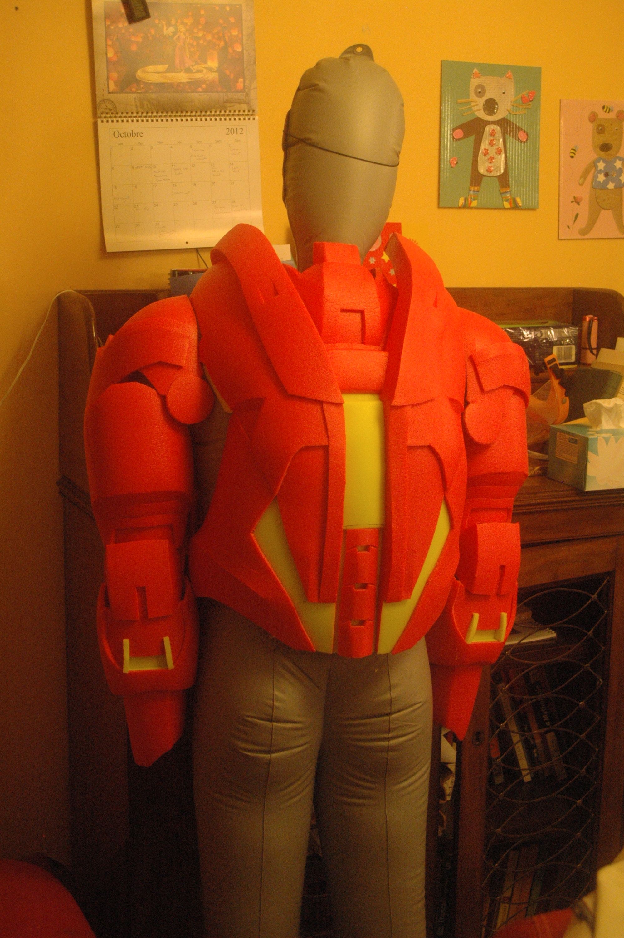

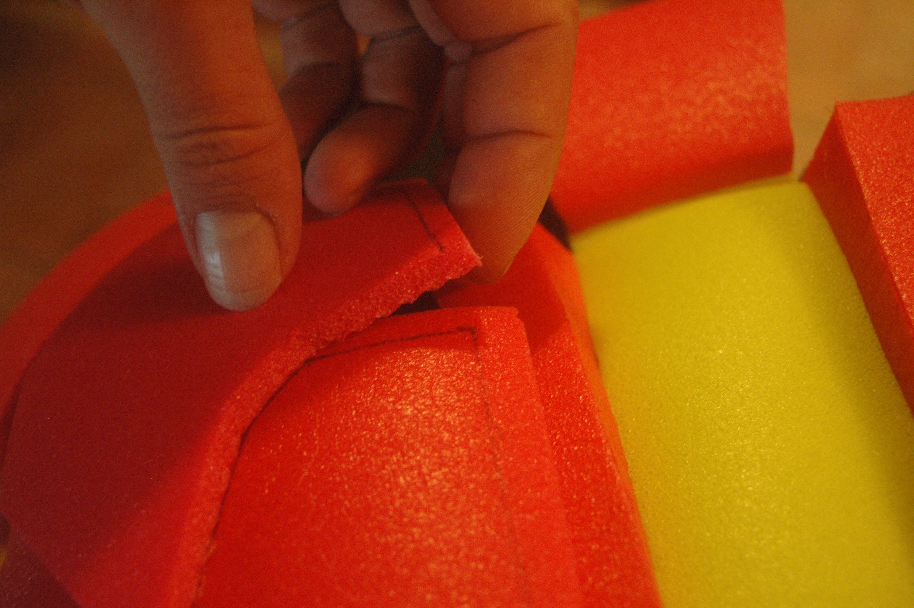

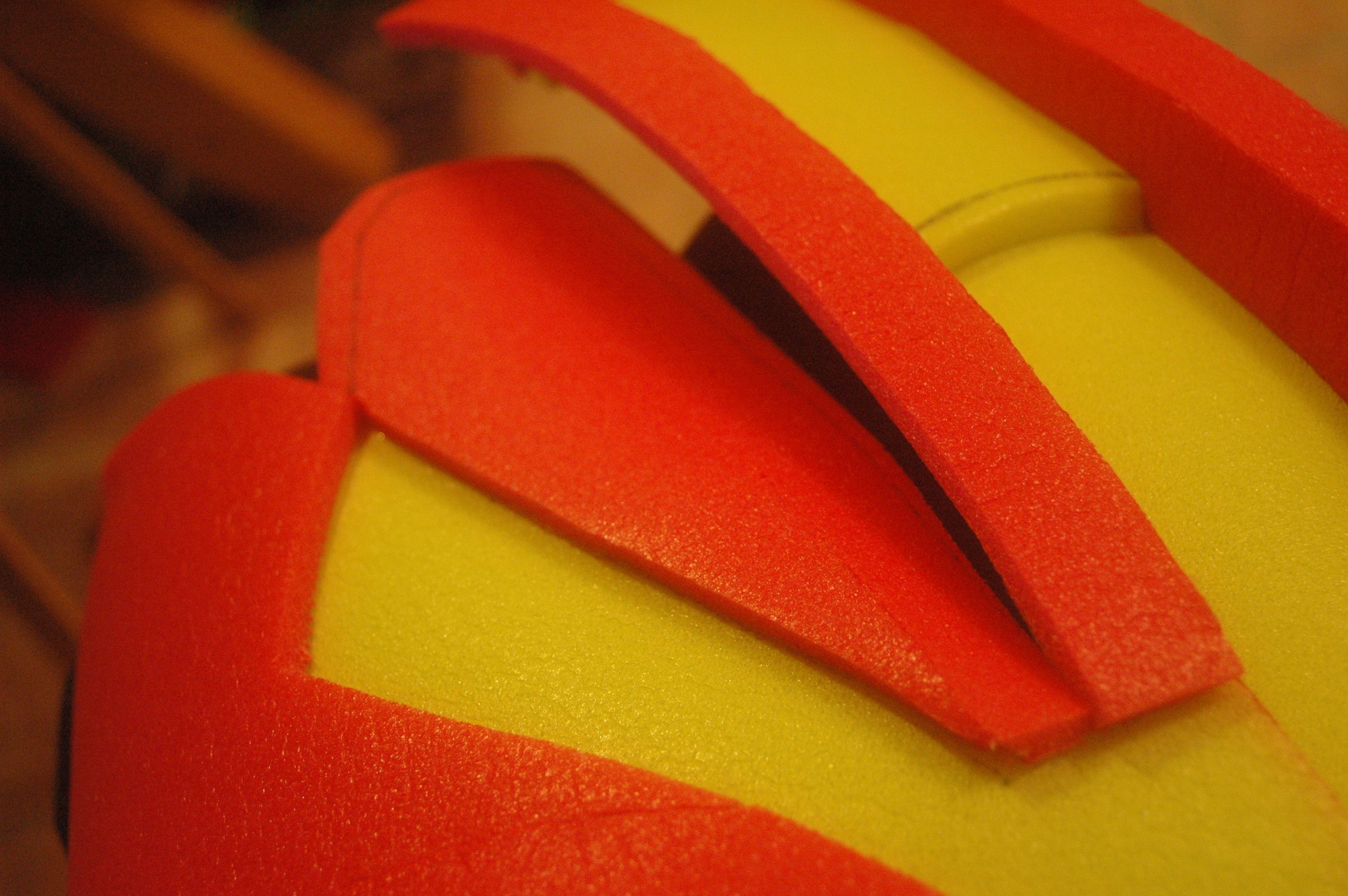

And here are some close'ups of the way I use the overlaps to build quite cleanly most of a suit's parts. Here, a back part.

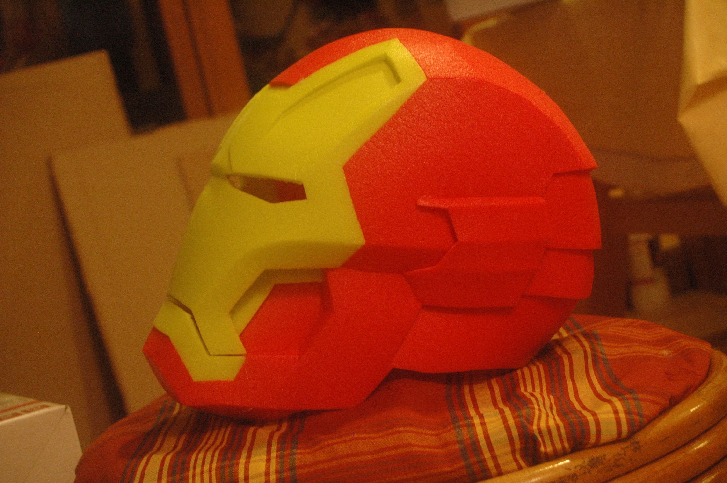

Hi Mr Tallpirate, thanks for the feedback :)
1- My helmet allow me to put my head inside without removing anything, since I haven't glued the line between the front of the ear and the back of the jaw. I only have to splay it in two so my head can slip inside. When releasing it holds back its shape.
But the helmet shown above is not sized for me, and anyway it has been buit on demand in a single solidary part in order to be molded and casted. So are the boots, the neck, and all other parts we can't wear without cutting them somewhere.

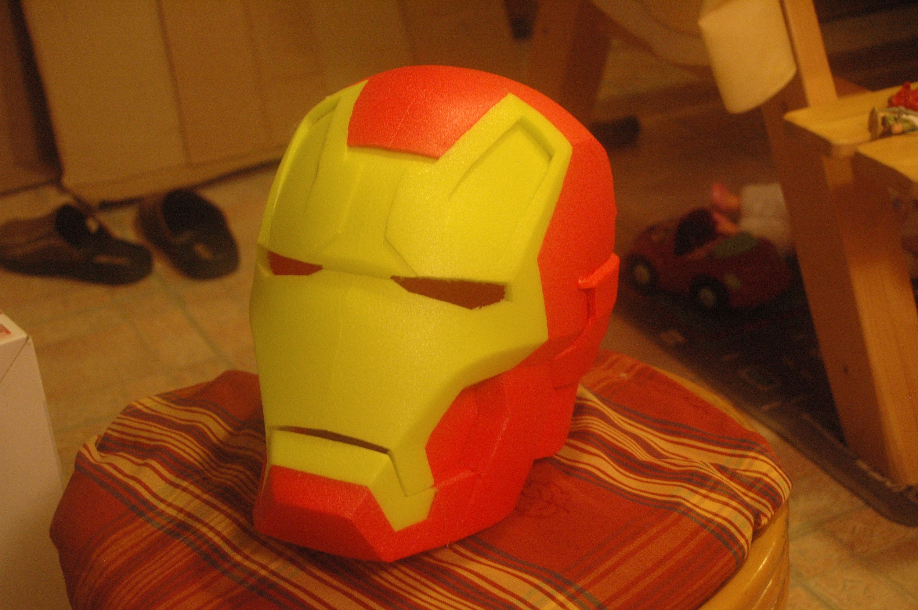

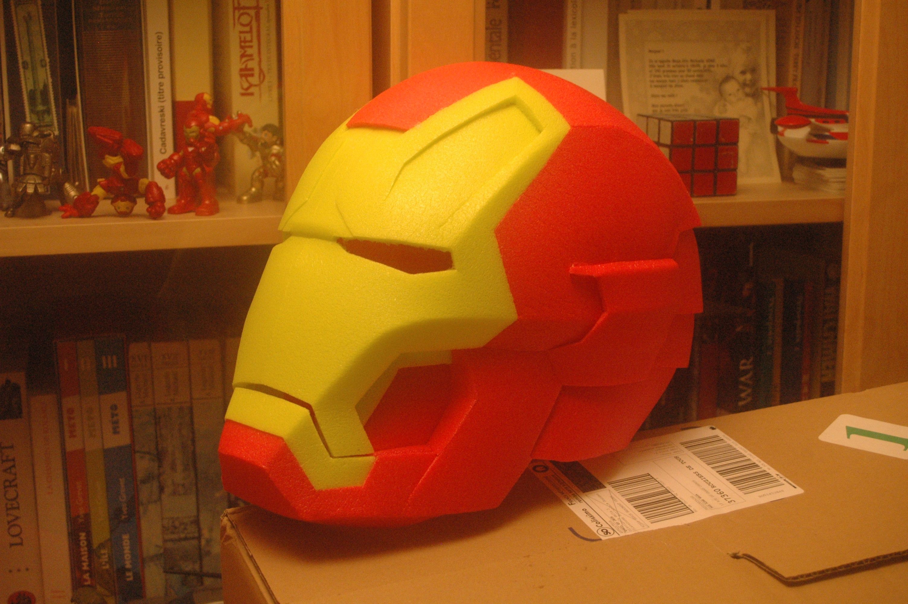

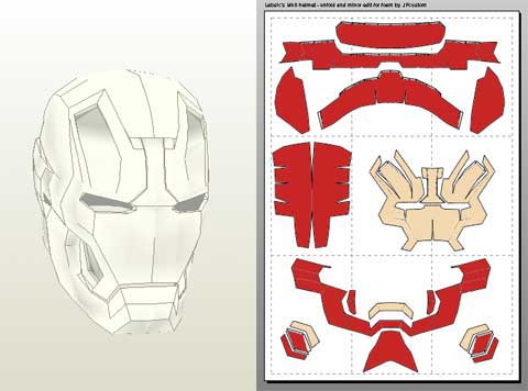

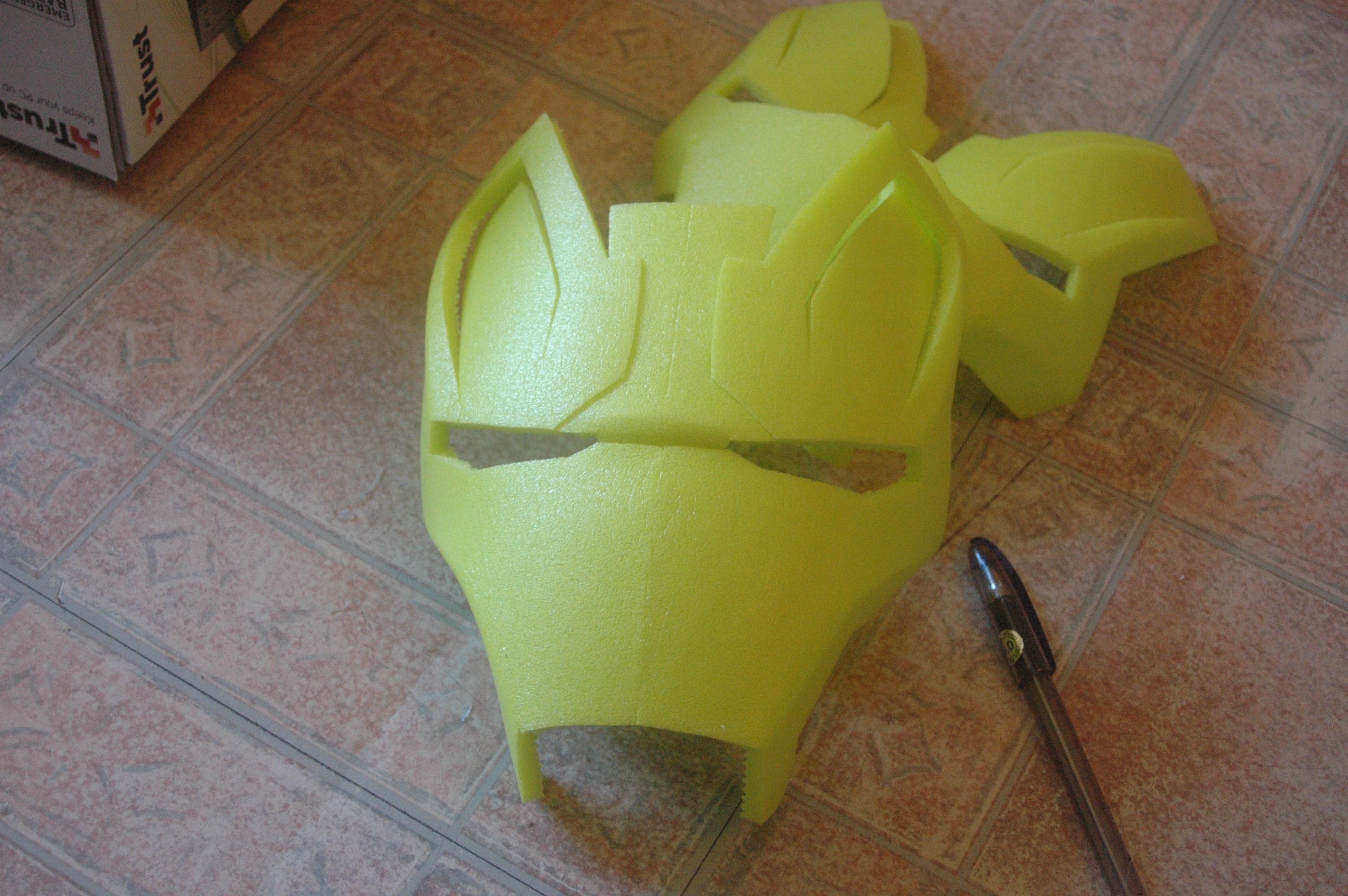

Pics of today's try at an unfold/build of a mkVIII helmet.
(I've removed this wip pdo. You'll find the final *.pdo file few posts below...)
Can anyone tell me whose model it seams to be, so I can add name and credit ?
Edit : ok, found. Thank you guys.

Re: FOAM speed-building files'n'tricks : #mk8 IM helmet
Thanks. It appears it's basically Labsic's model. I'll have to perform some minor edits to make it more foam-friendly before releasing a definitive *.pdo.
I don't want anyone to be upset, but in my opinion I find its global shape closer to the 'real' one than skylu3Design's attempt, which for its part may seem rounder and somehow more freestyle. I'll have a go to it too later.
