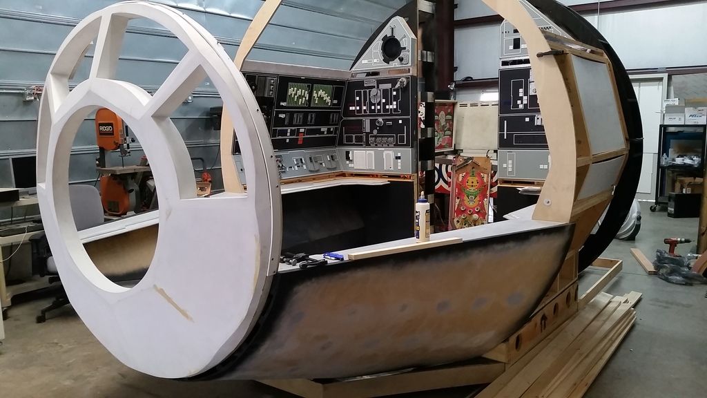

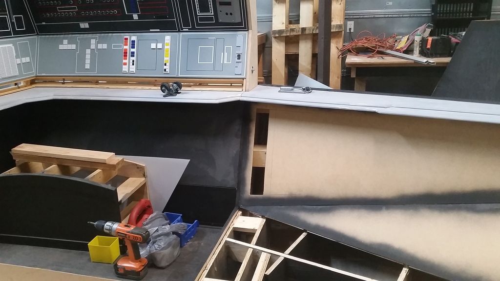

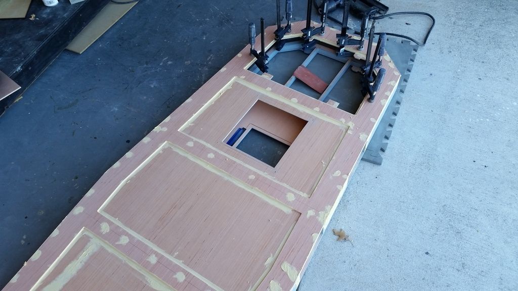

I stopped by the warehouse after work and made some forward progress on the nose!

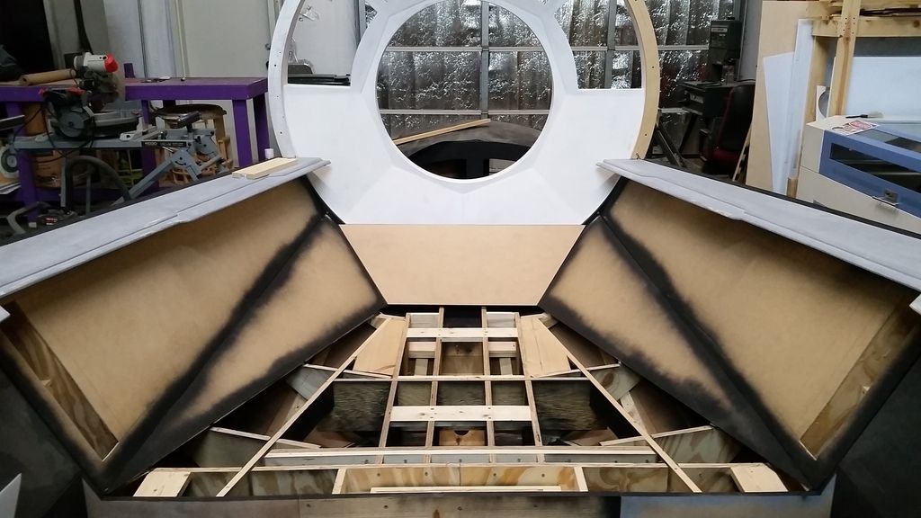

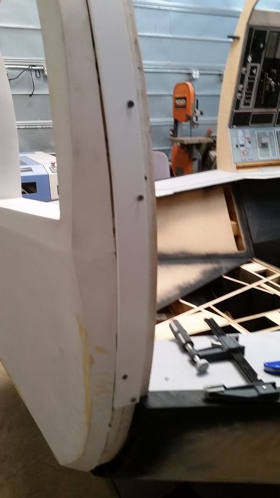

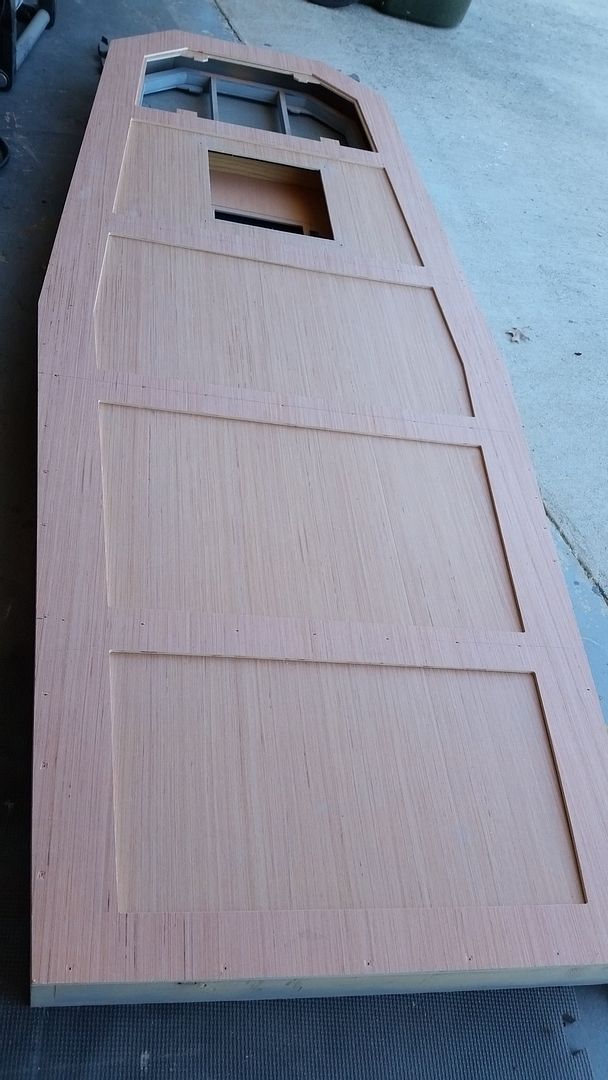

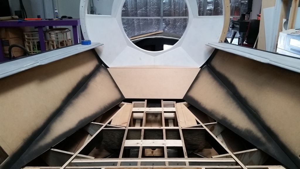

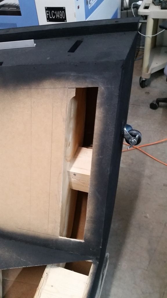

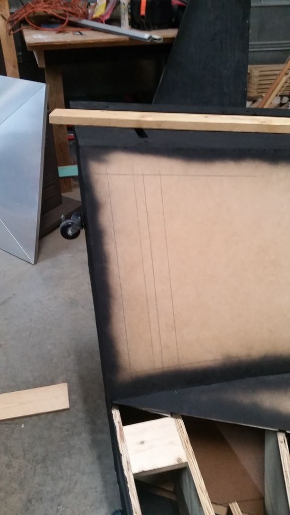

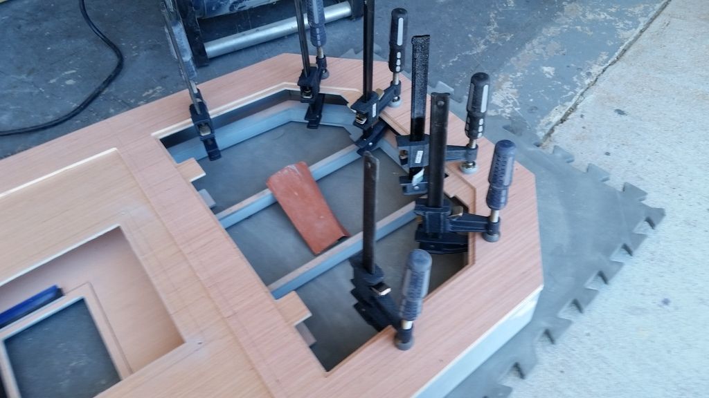

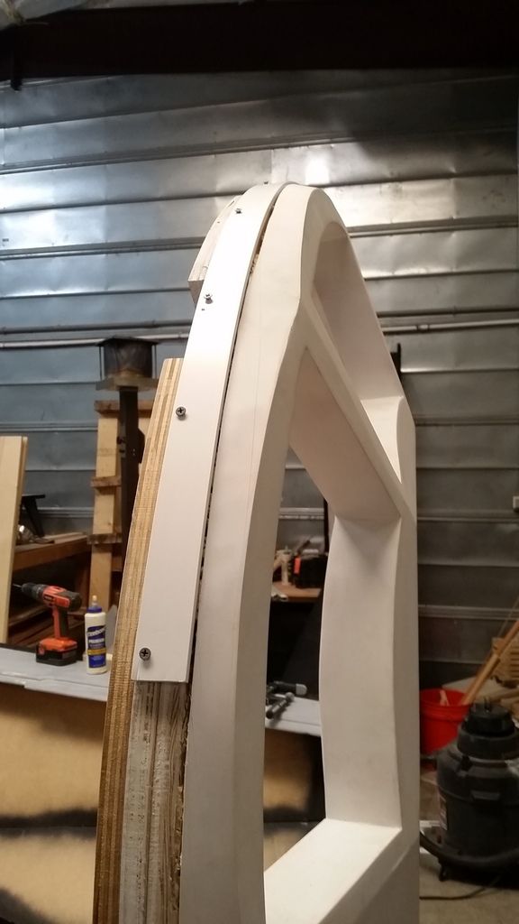

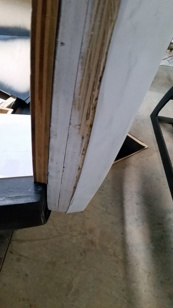

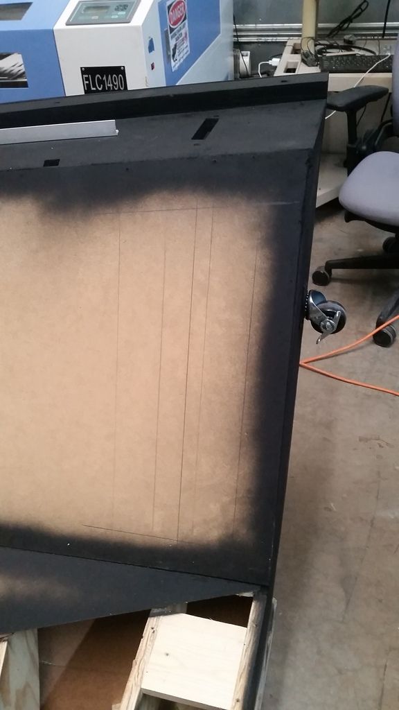

Instead of cutting holes on the outside of the nose to marry up the nose and body, it actually made sense to create removable panels on the inside! Marking up the material to remove
Cutting away the material
I'll design a panel that will screw into place to cover the hole

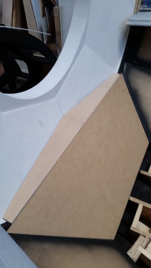

I then married up the nose and body!
I then put the window back on!
As you can see, the added material will help with the Volvo Panels. However, this also means (which i was already aware) I HAVE to now add material to the window so the nose and window marry up together
I have to create a cover piece that will hide this hole between the window and the new panel I created
Can't have that!

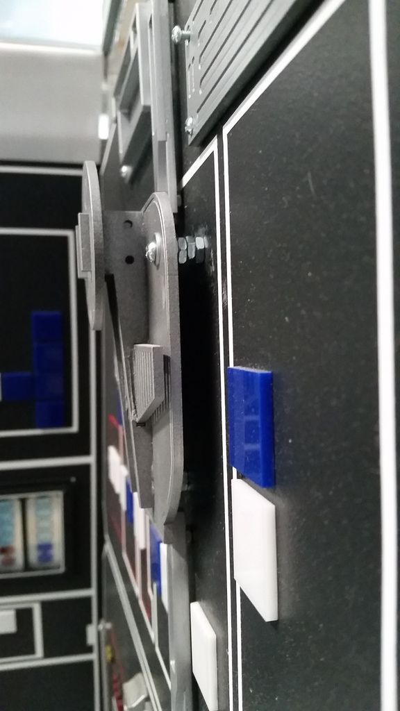

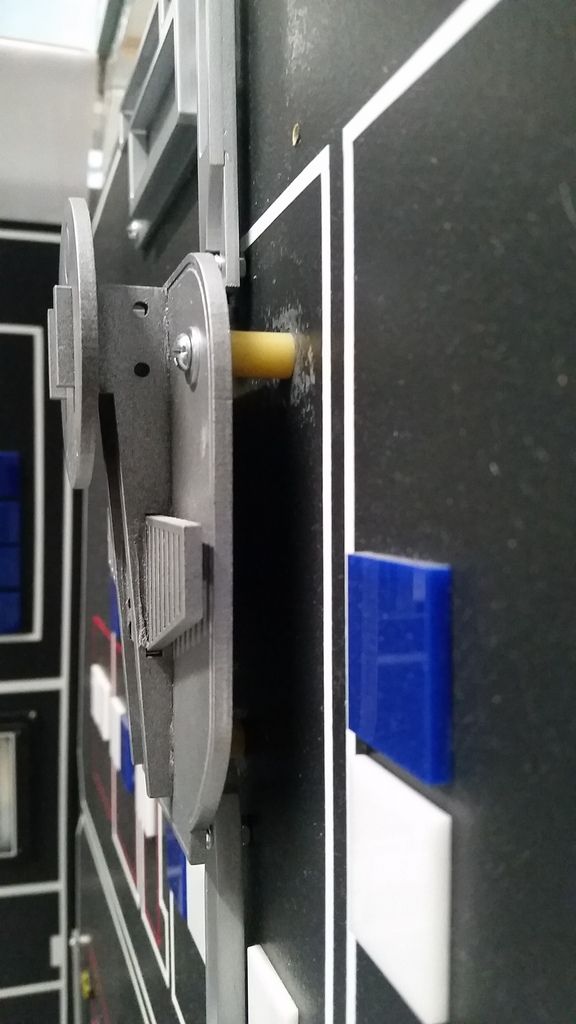

I remounted these greeblies but had to make them stand off the panel so everything fit
I'm going to cut some acrylic donuts in place of the nuts

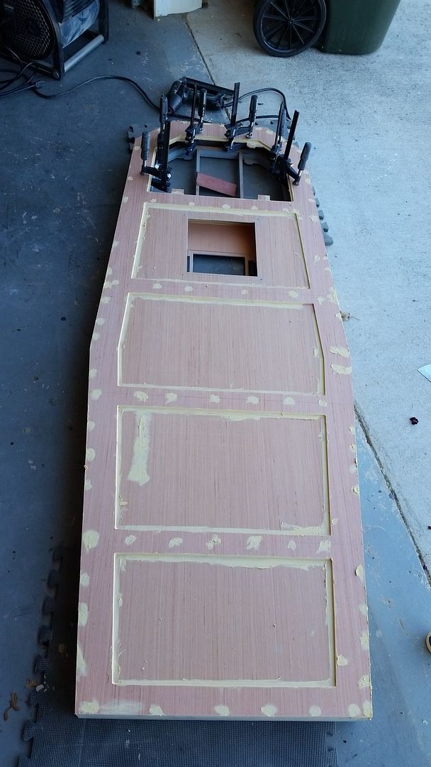

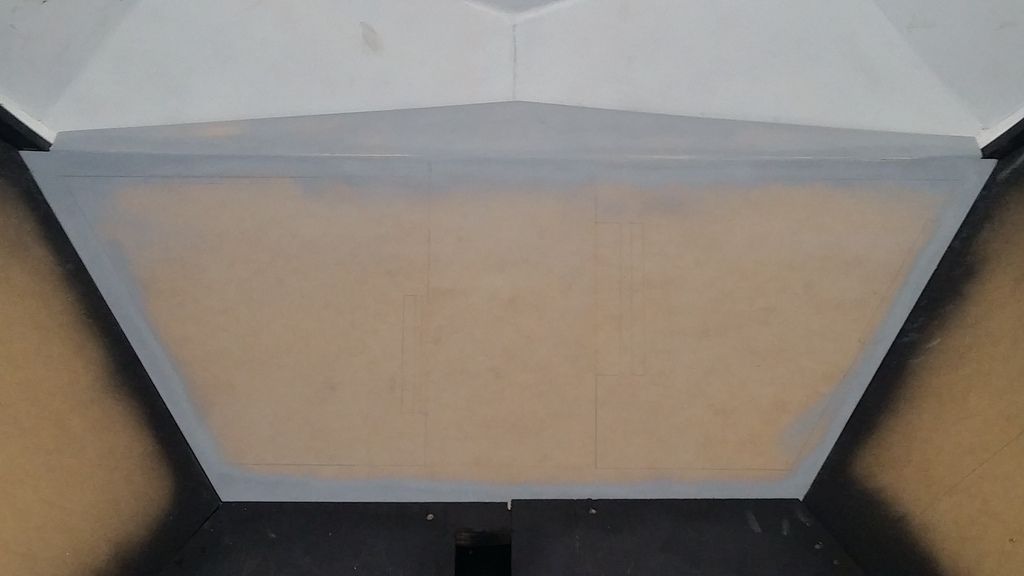

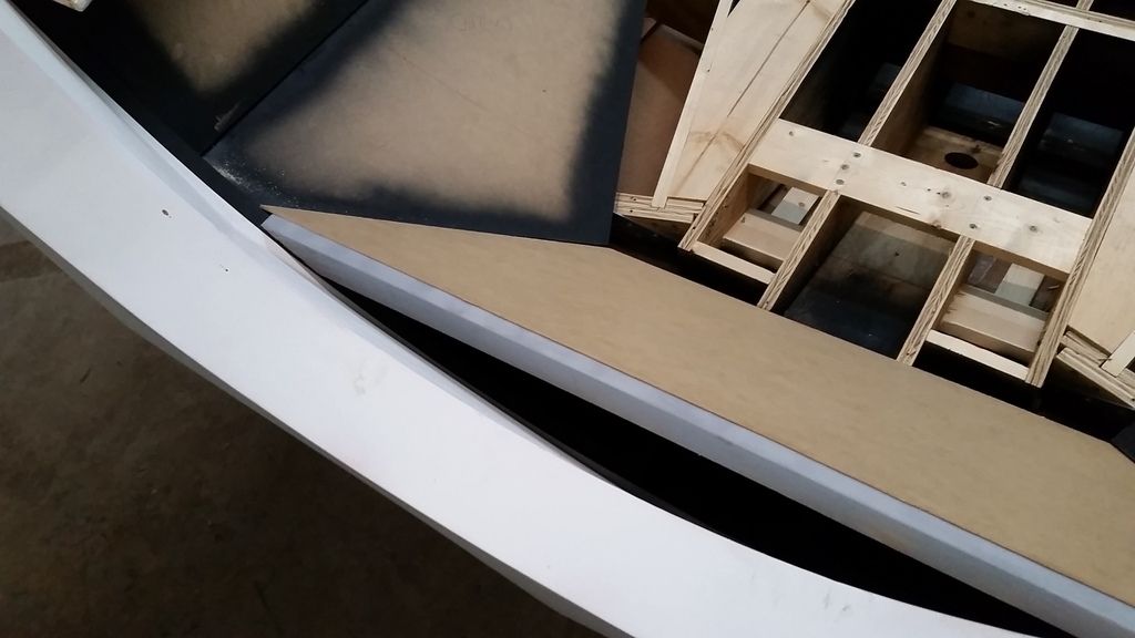

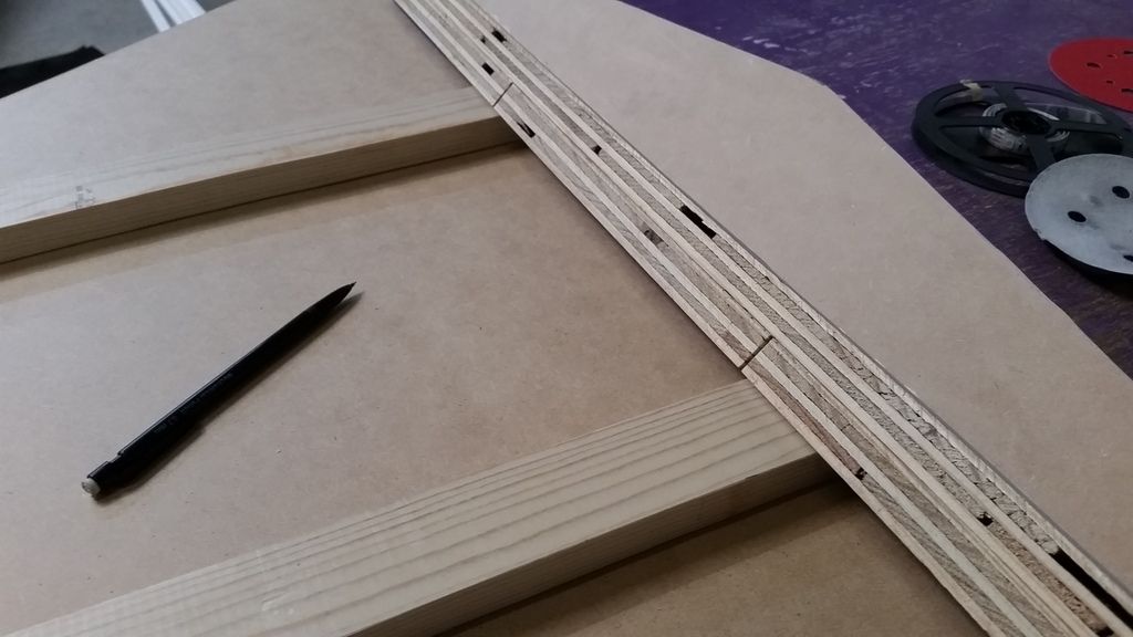

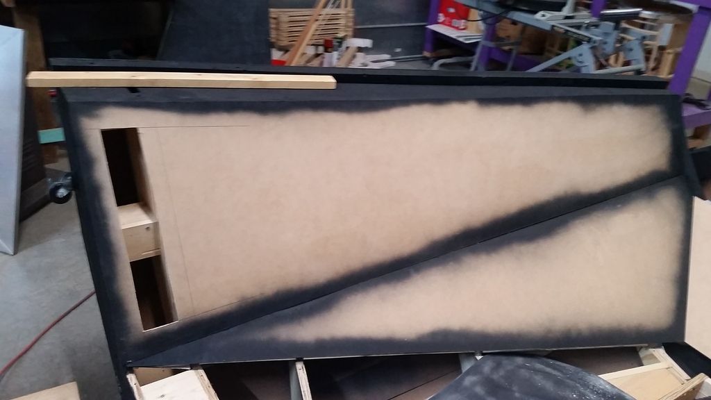

Work on the interior nose panel continues

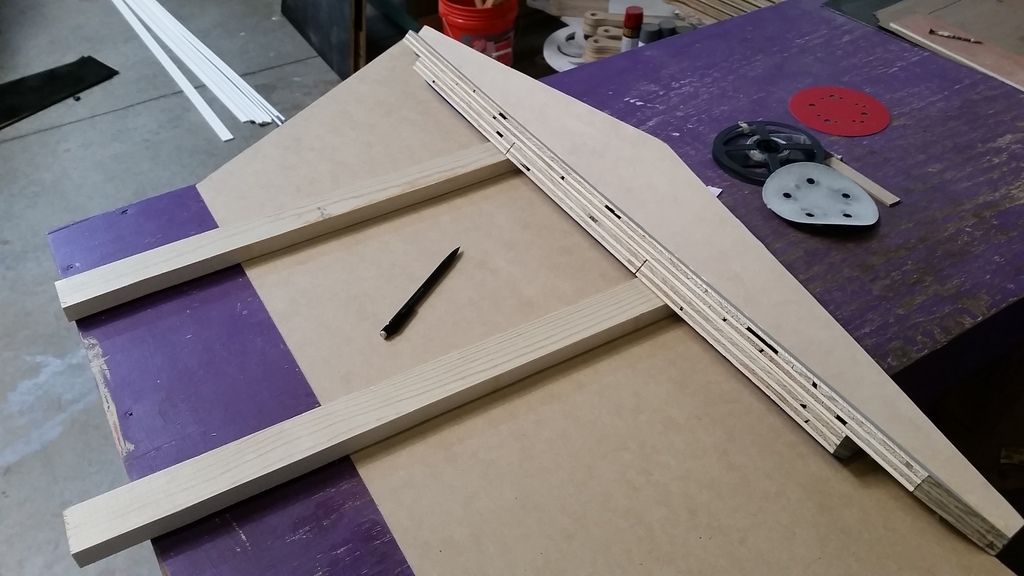

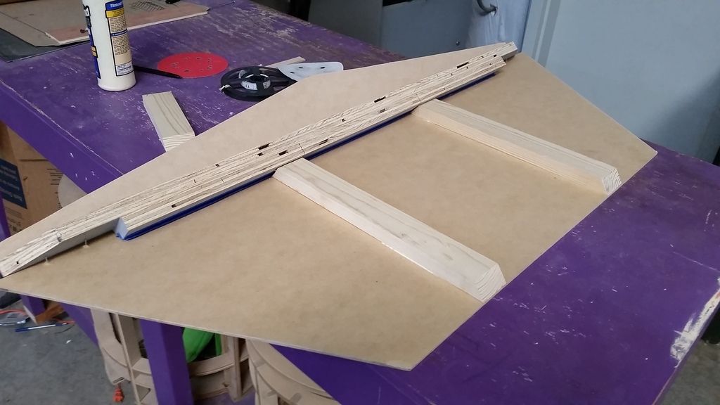

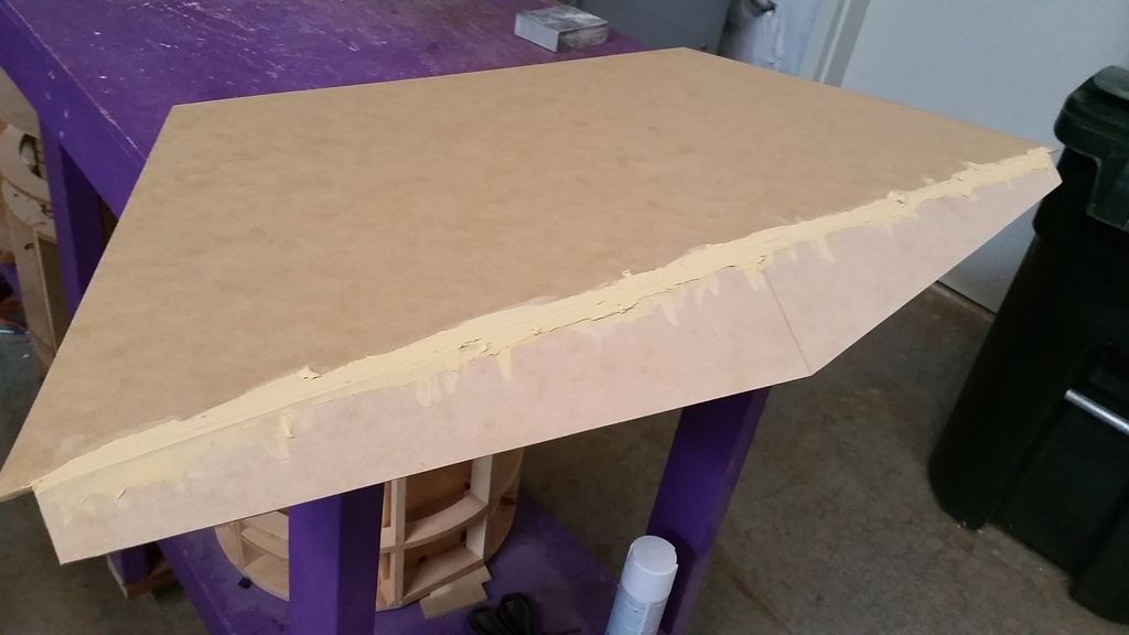

I then cut these support pieces for the underside

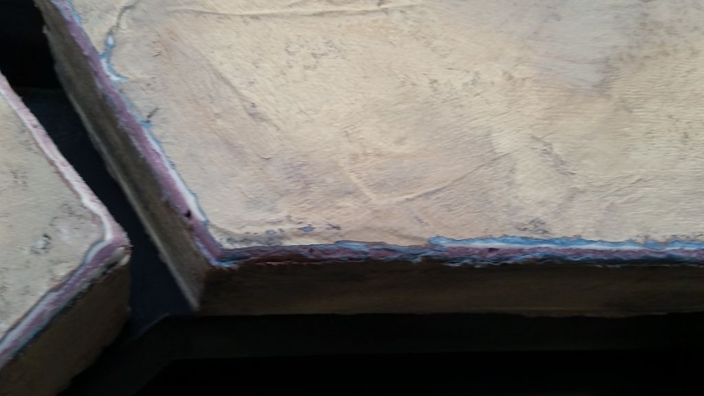

I then added filler and get the first sanding out of the way today

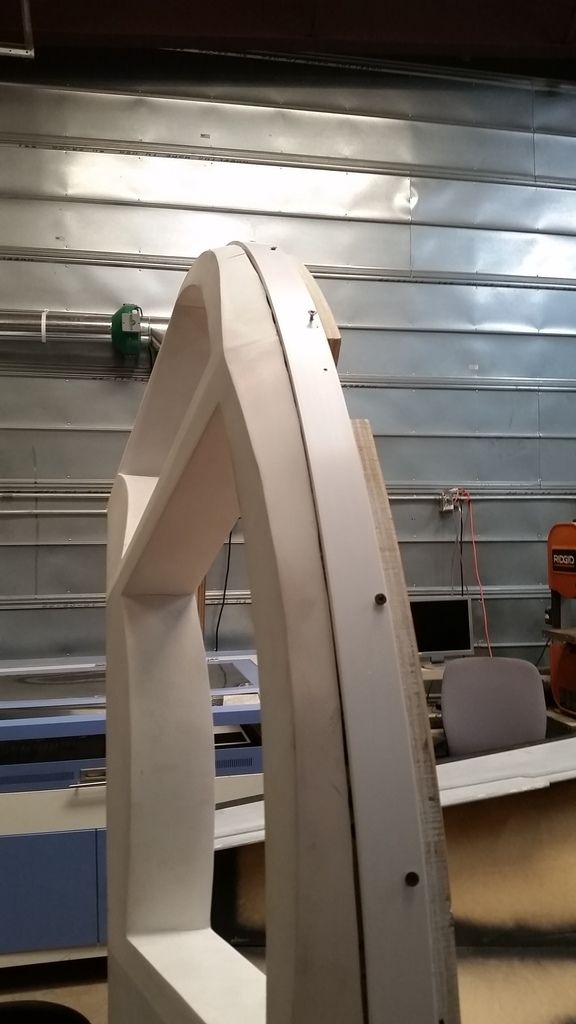

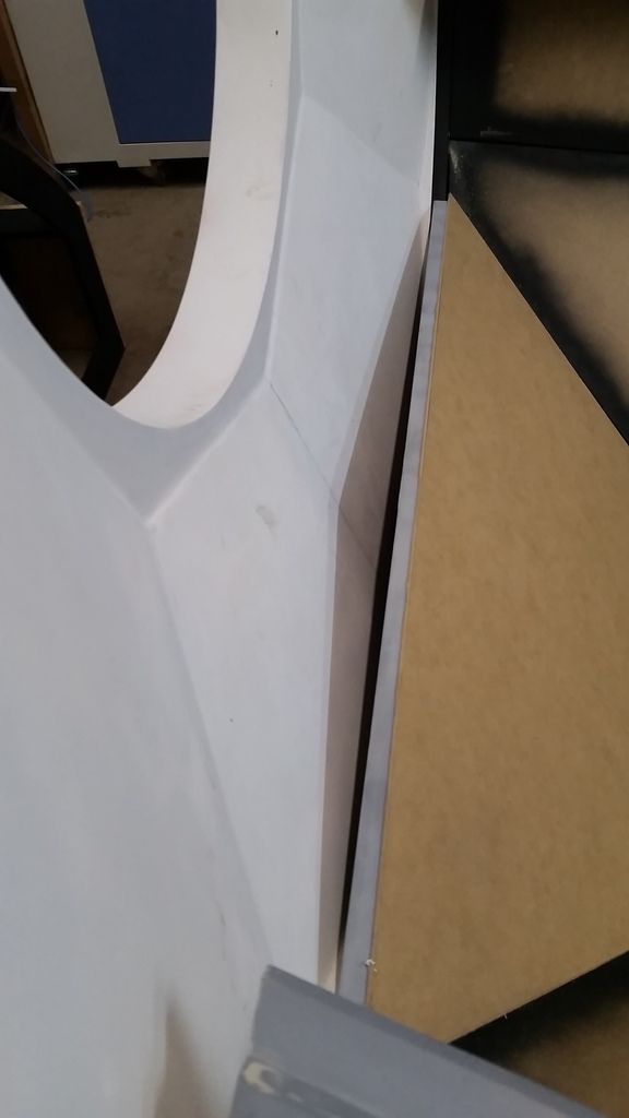

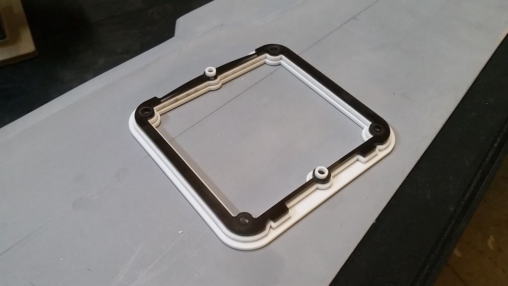

Started work on the front window transition area
This part is going to be interesting

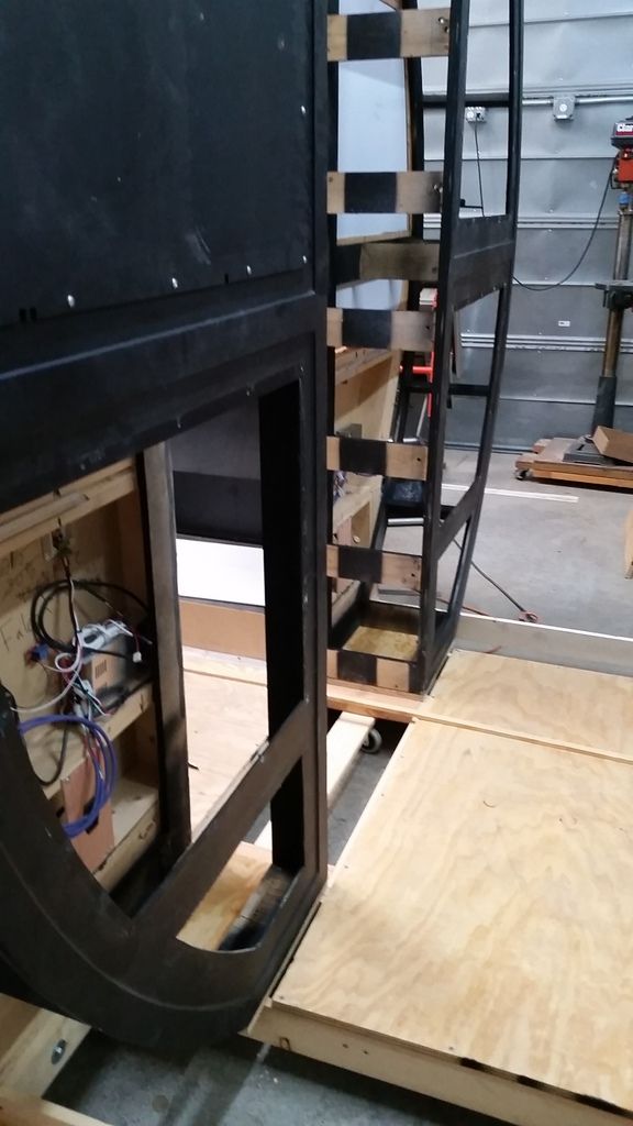

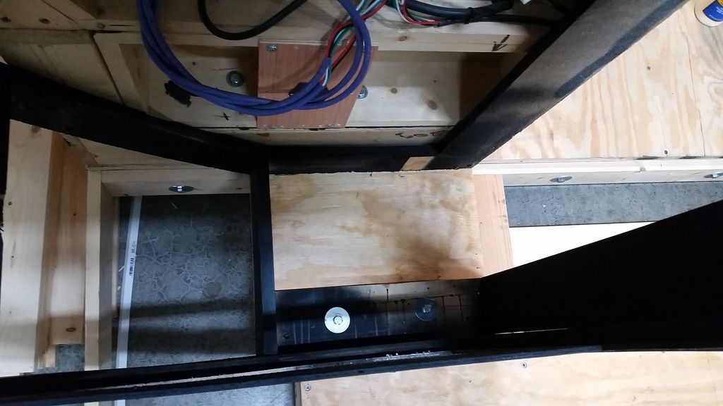

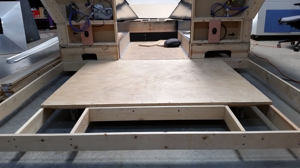

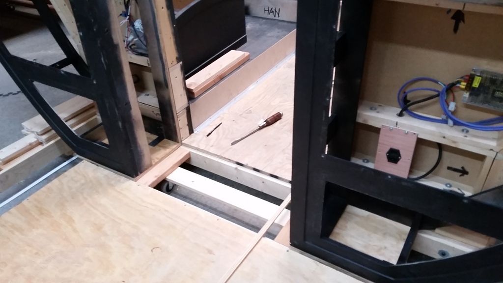

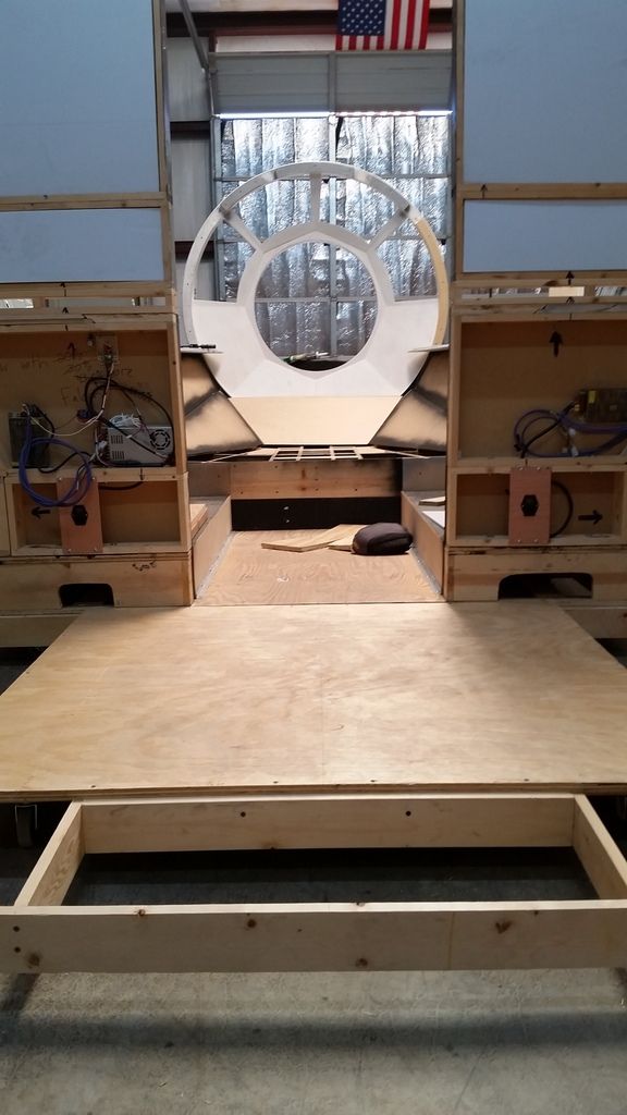

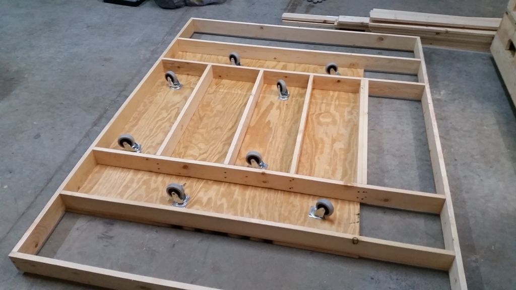

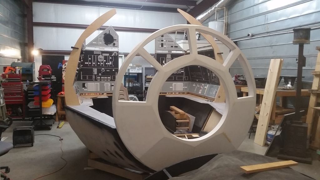

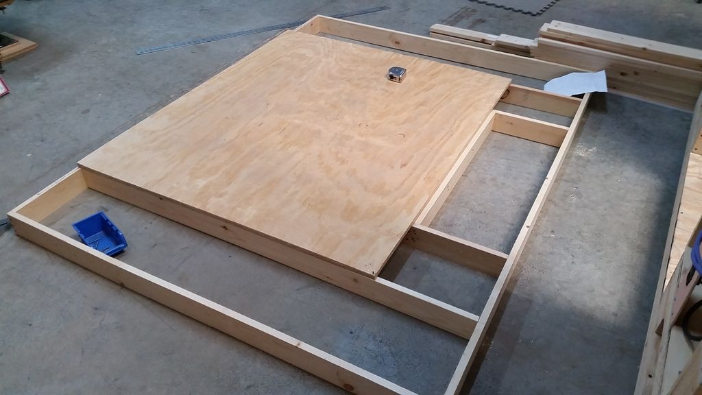

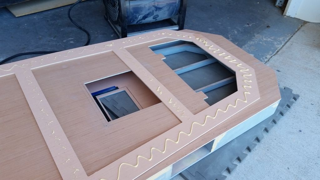

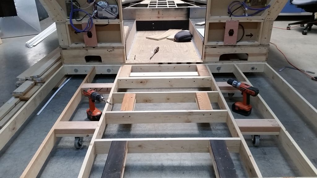

And then finally... the new corridor platform is closer to being finished

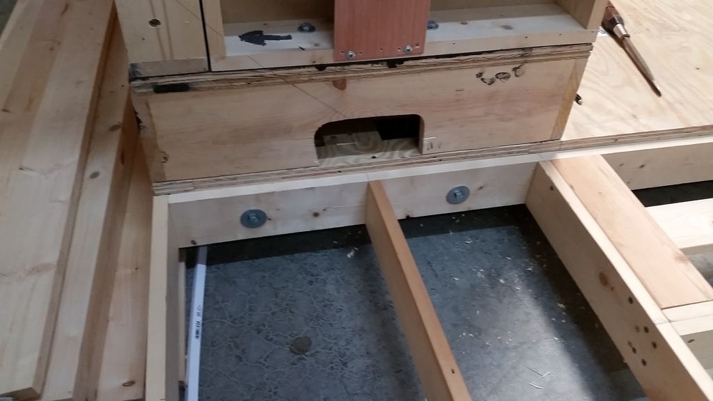

Caster placement
Done

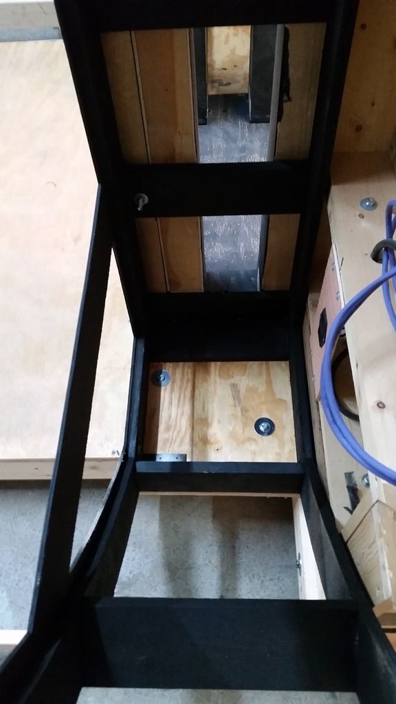

Adding some reinforcement

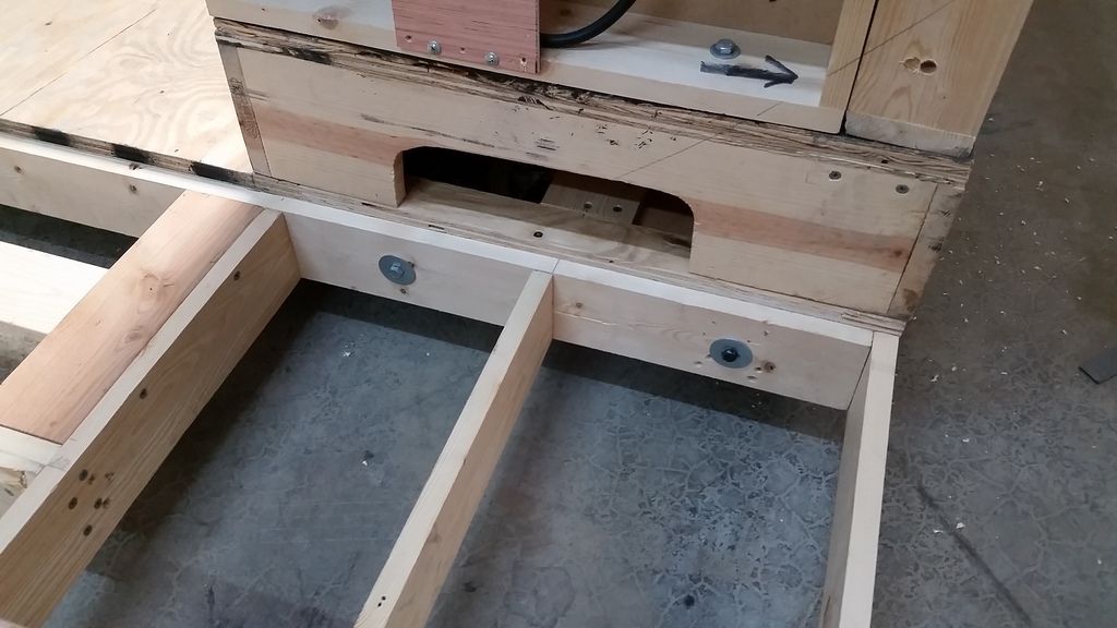

Bolting to the main body platform

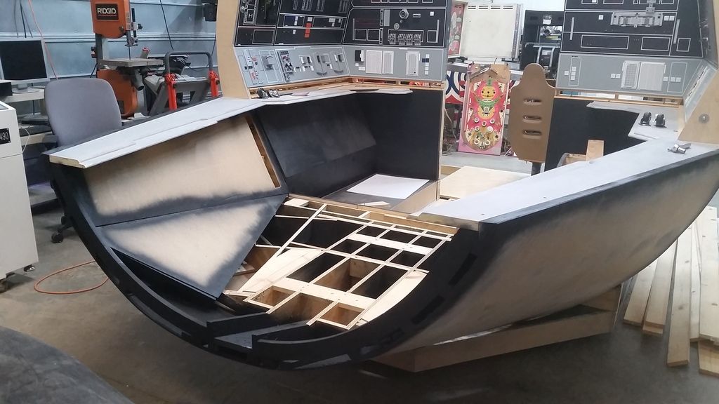

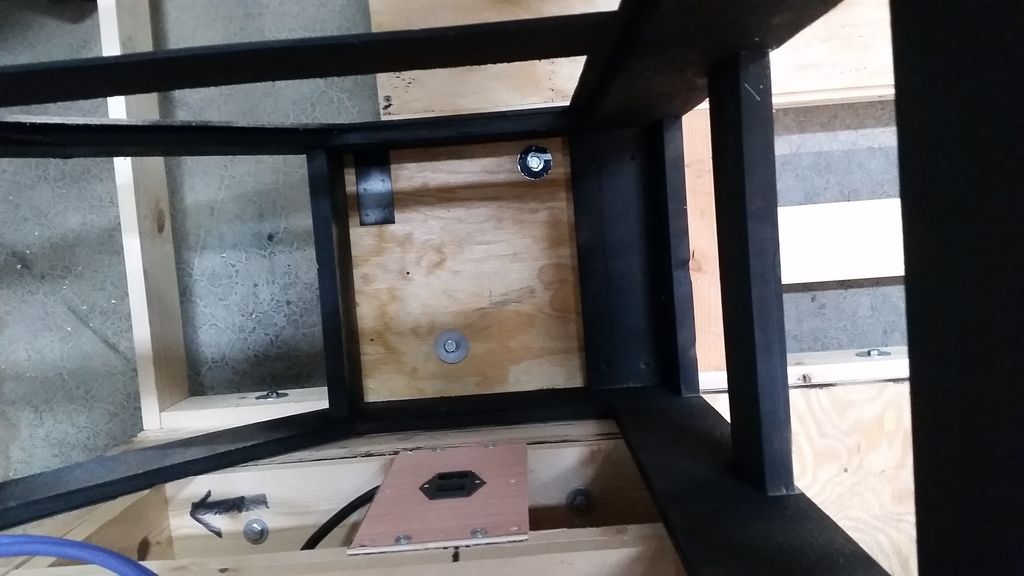

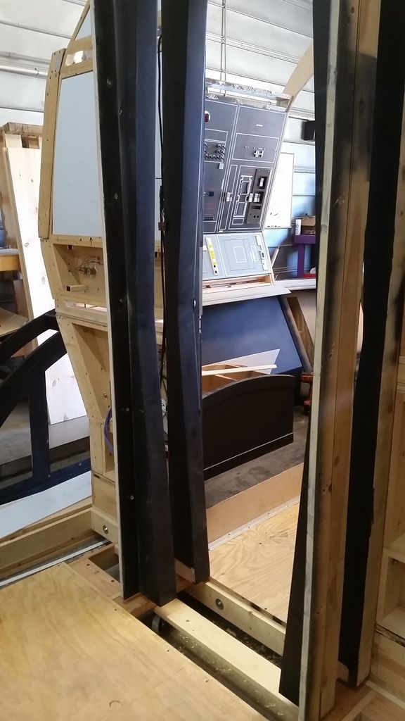

Finding final placement of the cockpit entrance panels
Bolts added - looking down into Han's side

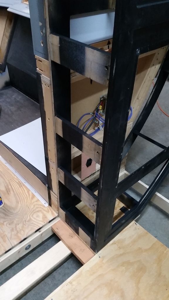

Chewies Side - photo is upside down

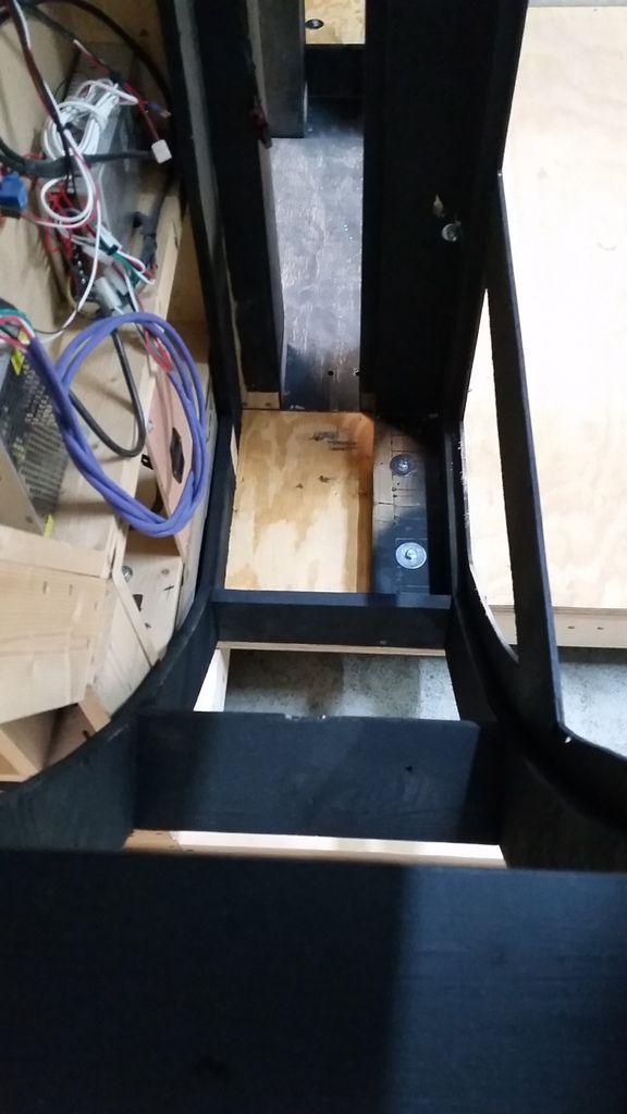

Han's side
Chewie
And this is where we are!

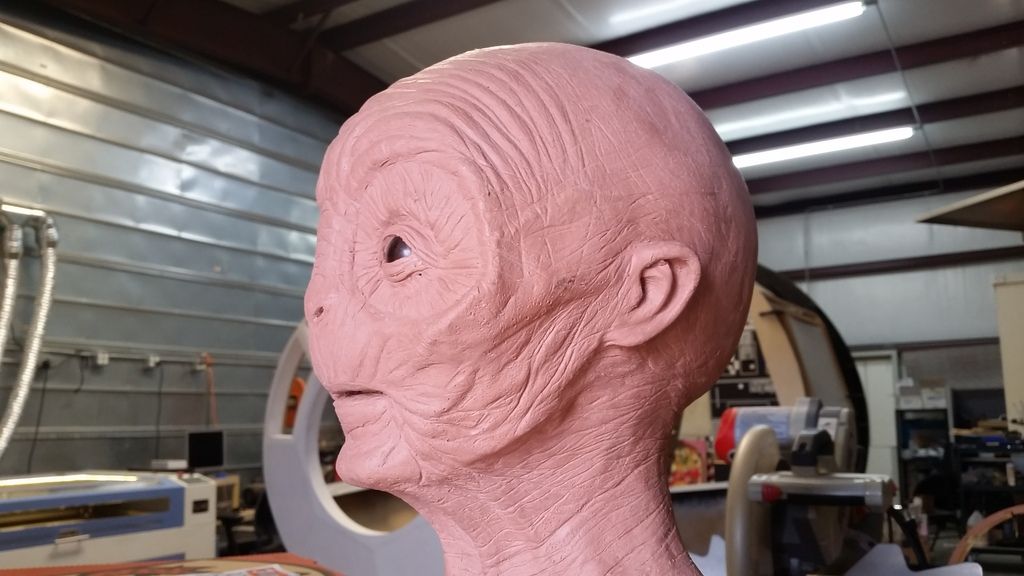

A brief detour... Daniel stopped by with one of his buddies who is faithfully recreating a 1:1 scale Maz mask! Brilliant!

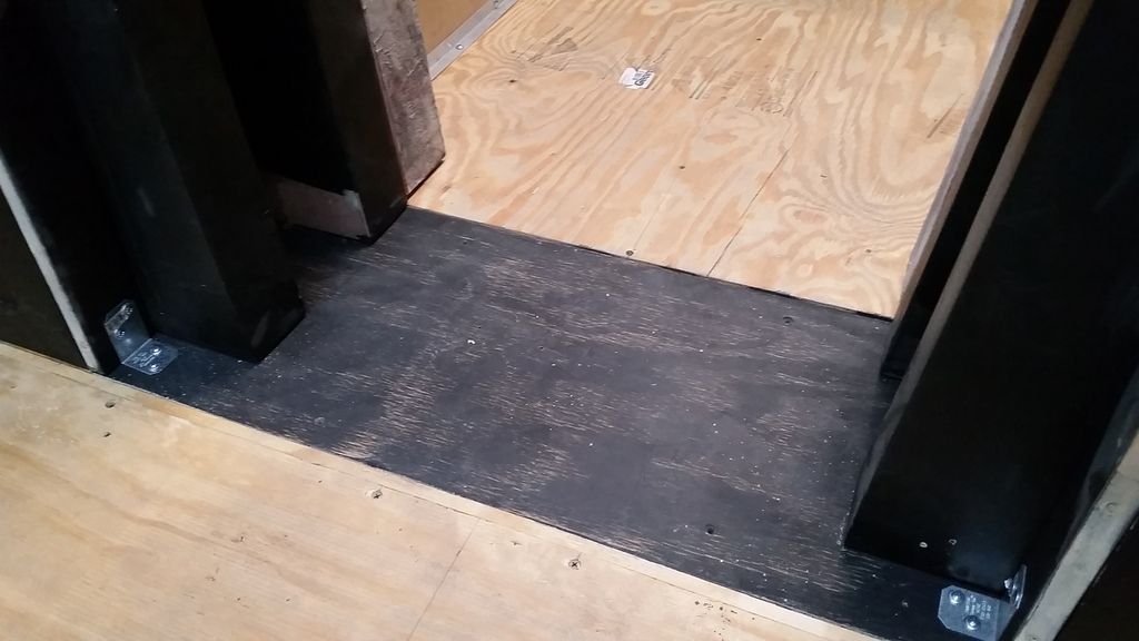

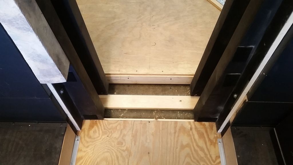

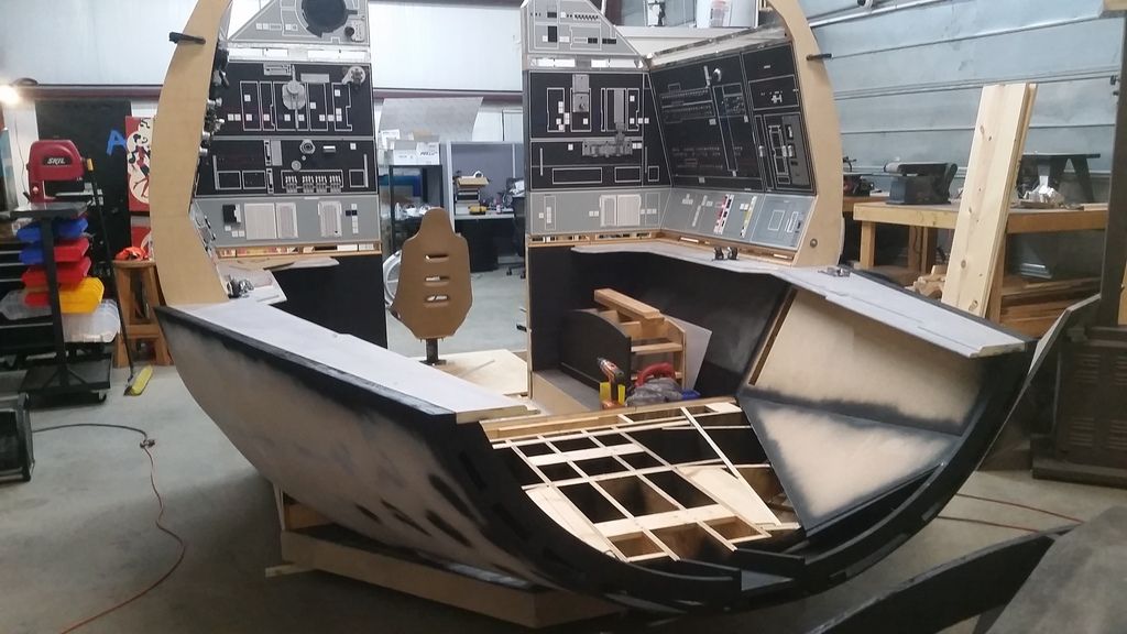

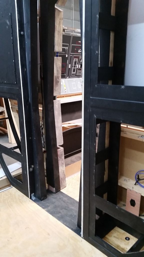

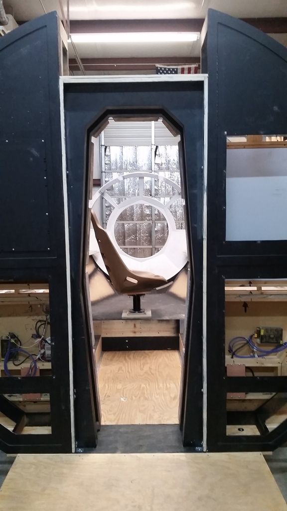

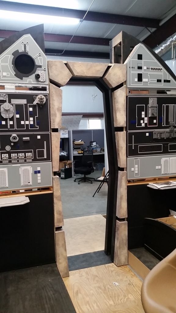

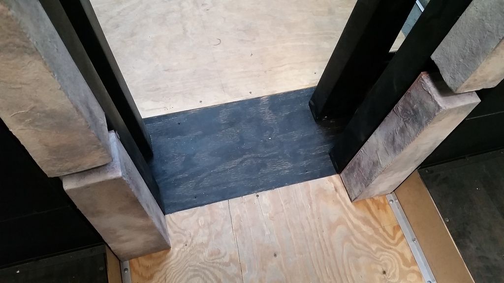

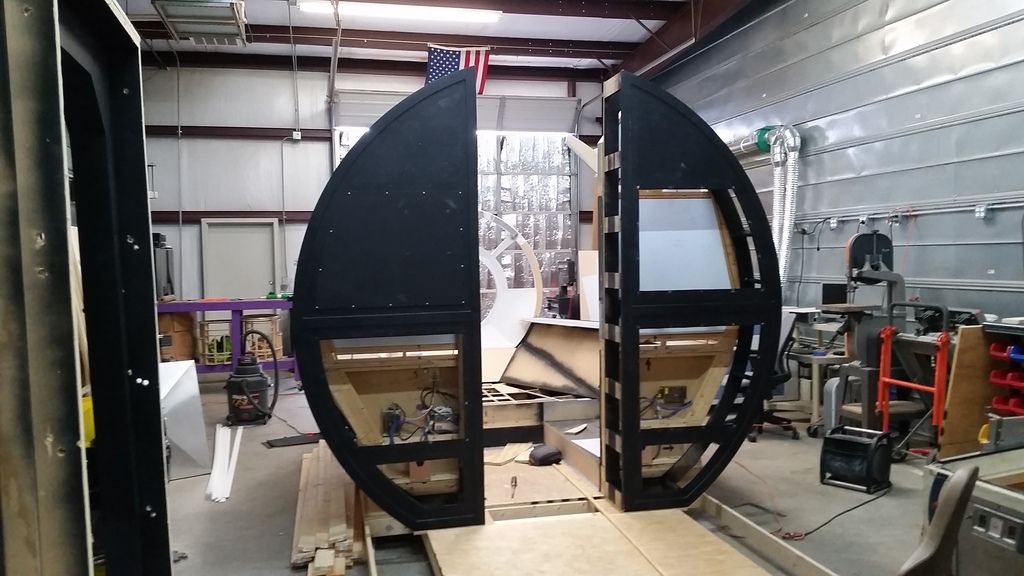

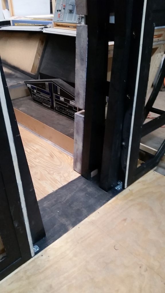

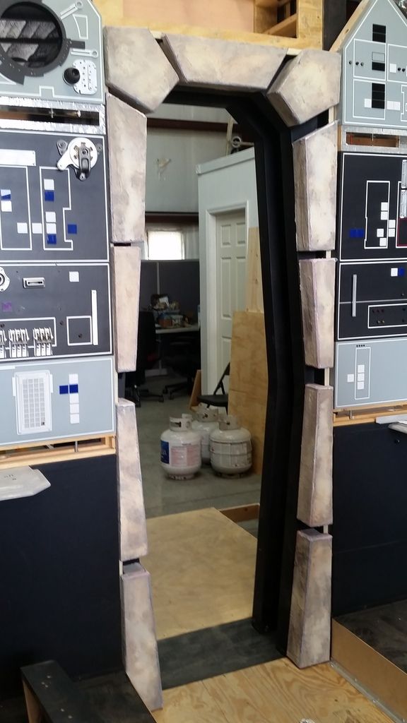

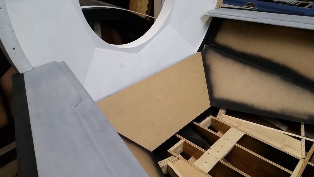

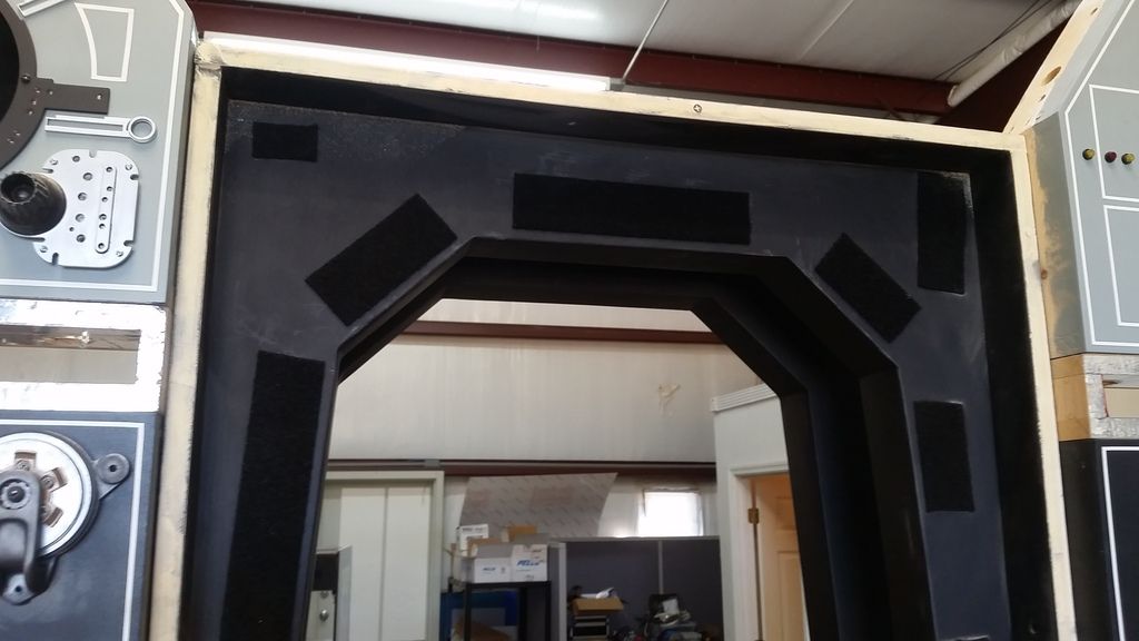

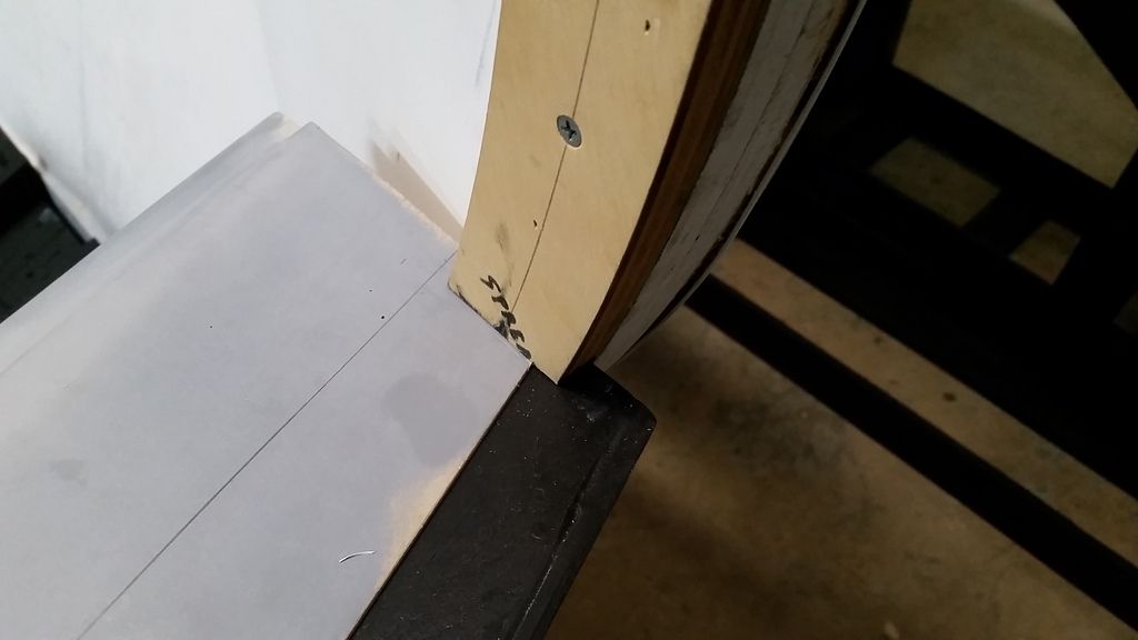

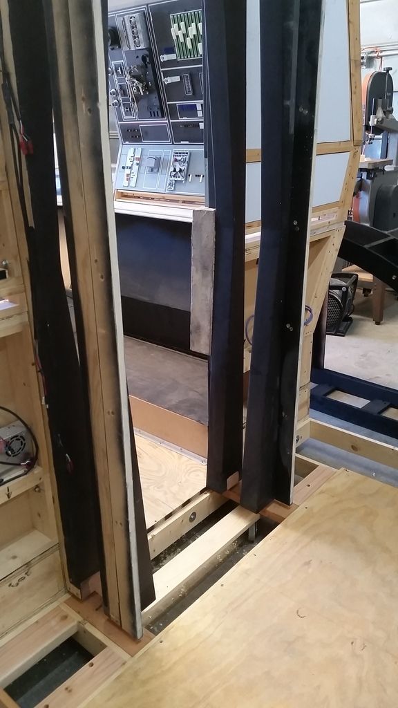

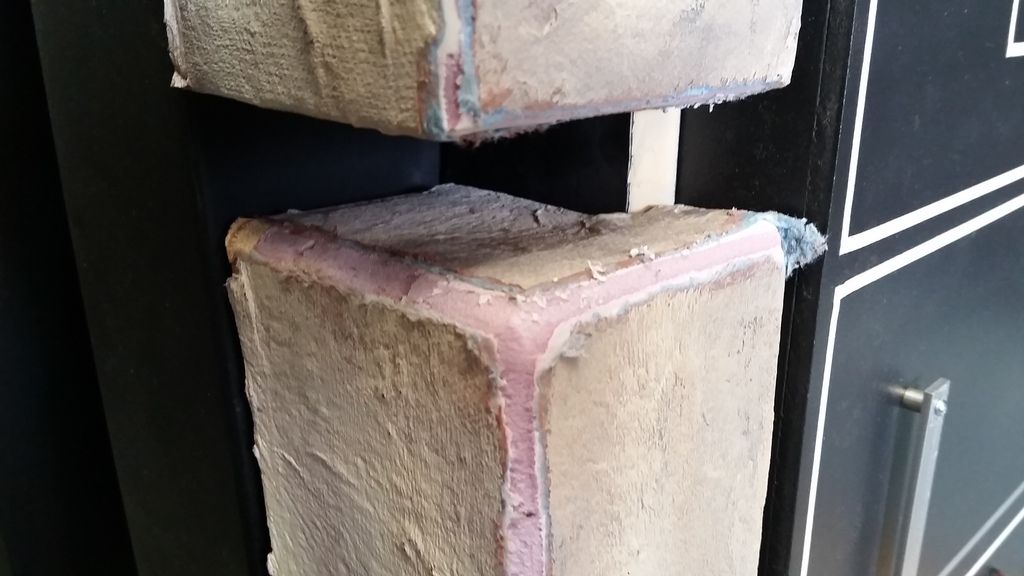

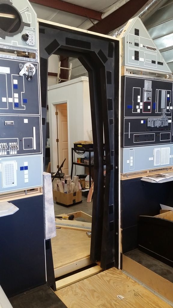

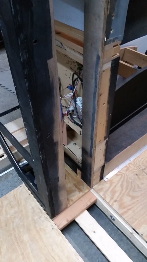

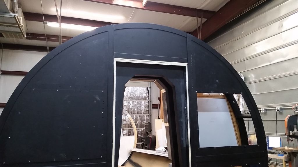

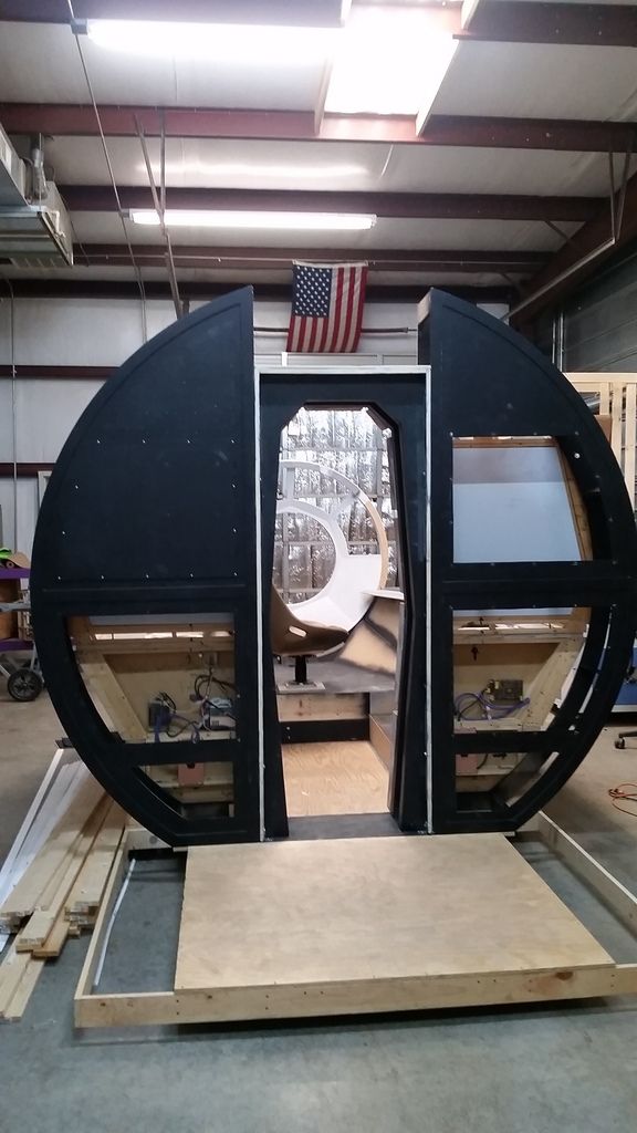

On to the cockpit... I was able to finally mount the door frame!

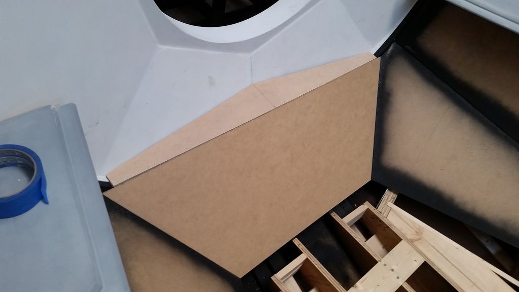

One more little platform to go!

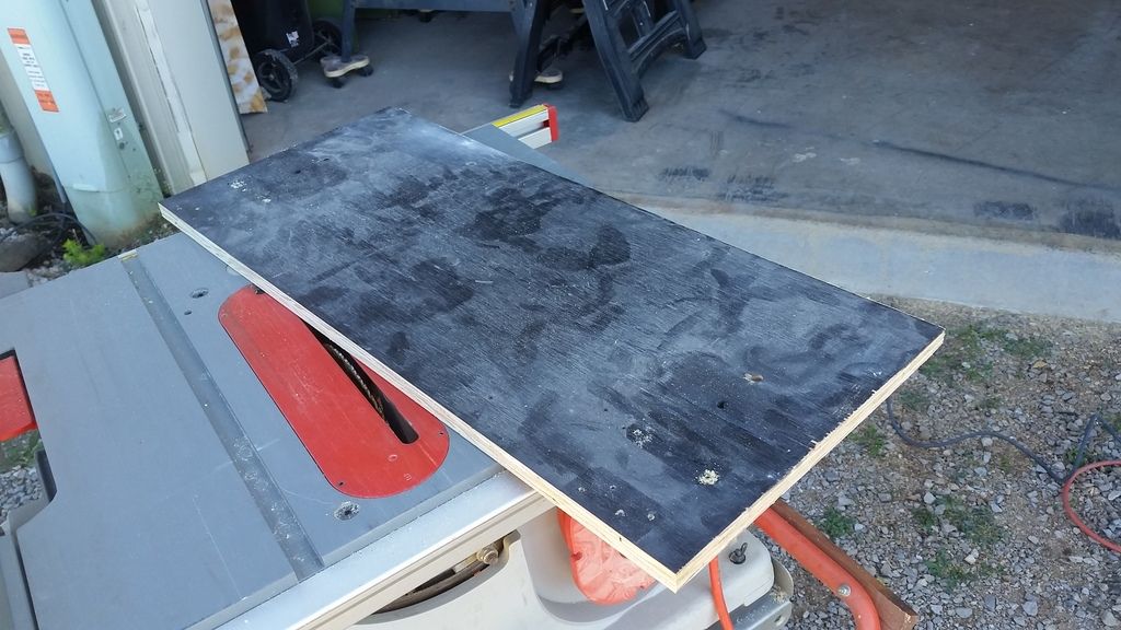

I ripped this last piece!
And it fit perfectly!
Still some work to do around the edges of the door frame but that hurdle is now behind us!
Han side looking down
Chewie side

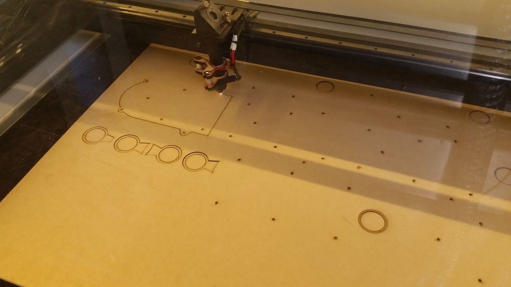

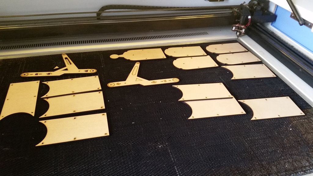

And here is the BEST and most mind numbing part of Sunday afternoon... the laser cutter works. All the hoops we jumped through, the roadblocks, hurdles, etc... it was nothing more than dirty connections on the board. Daniel removed the new controller board and replaced the old one just to see if it would work. It worked perfectly... :facepalm
Now we're back in business! :)

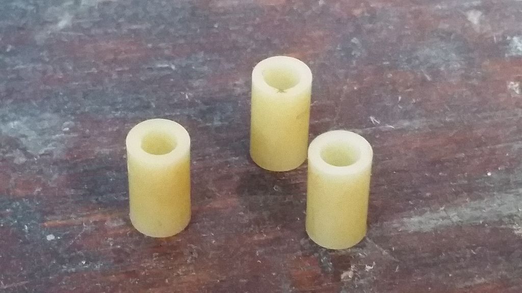

Wouldn't it be simpler to just use a small bit of plastic tube? That would save weight (well, a few grams worth at least) as well.
Hey FF,
I actually found a great substitute! Huntsville Scott, who rebuilds, restores and designs his own arcade and pinball machines (he also shares the warehouse with us), found a few small plastic tubes I could use while taking apart an old arcade cabinet - they are perfect. So I can knock that task off the list! :)

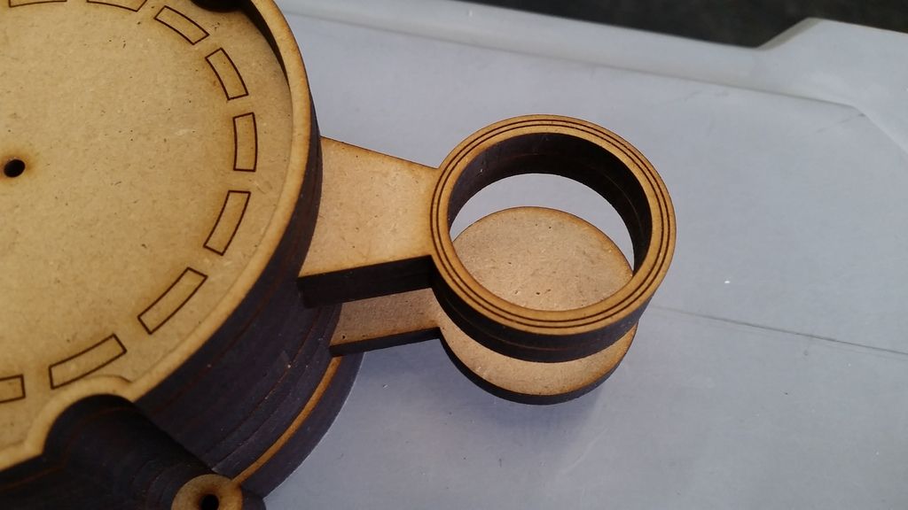

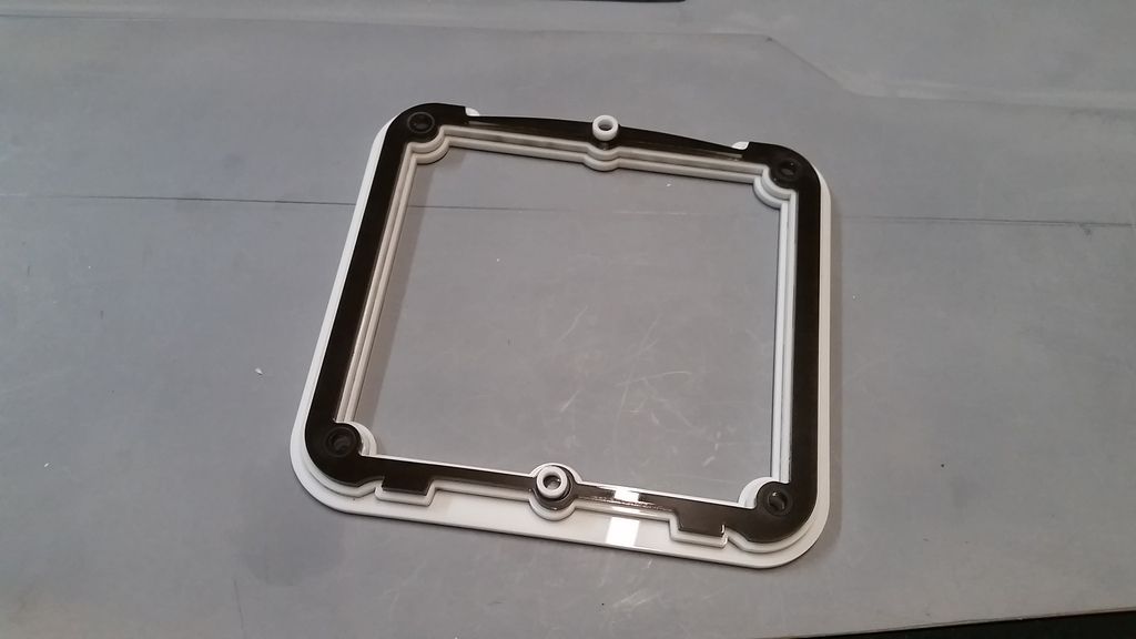

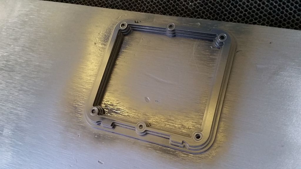

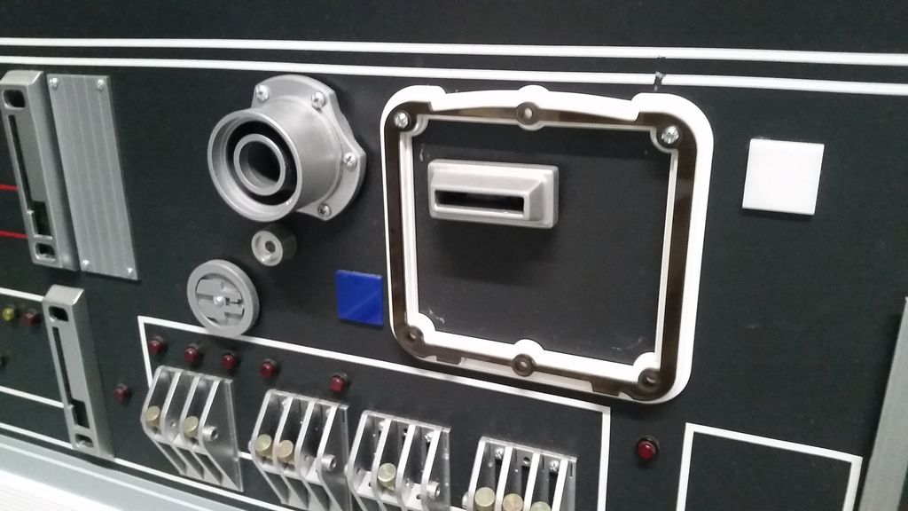

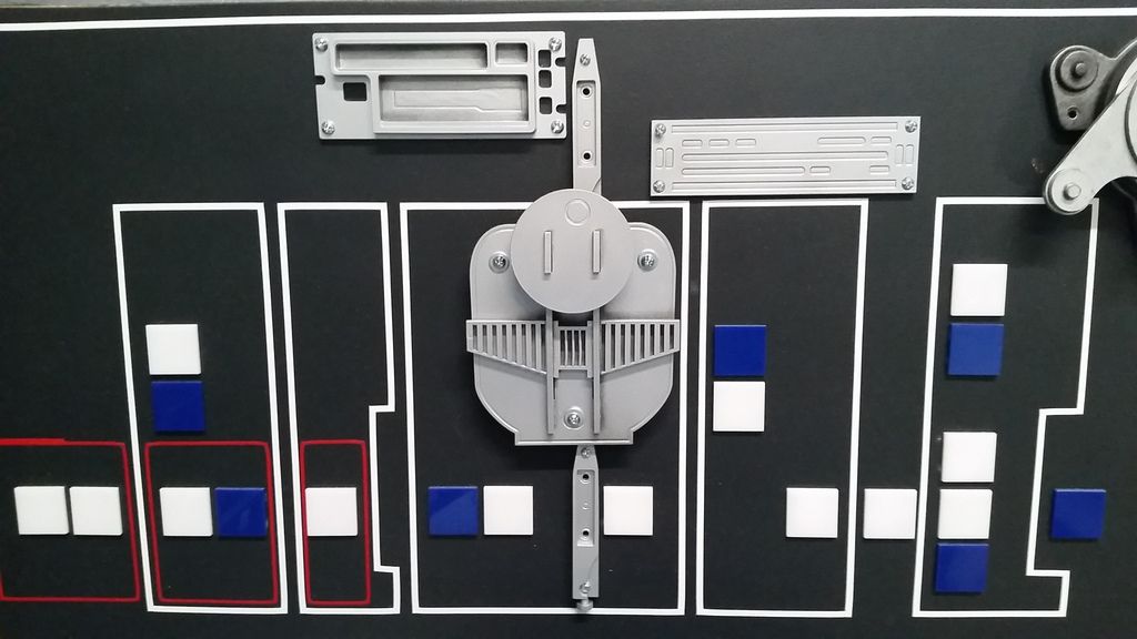

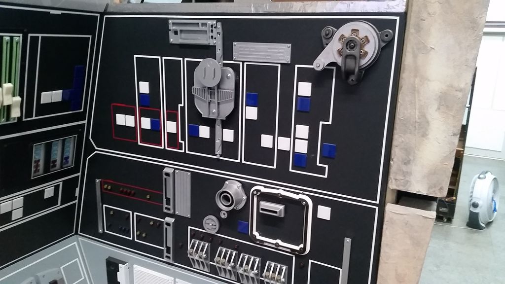

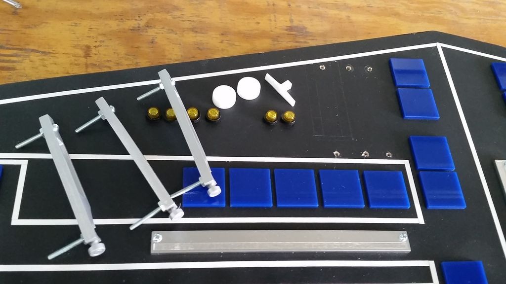

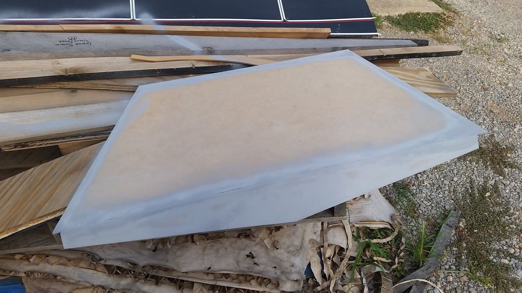

Finally updated and cut this greeblie
Uh oh!

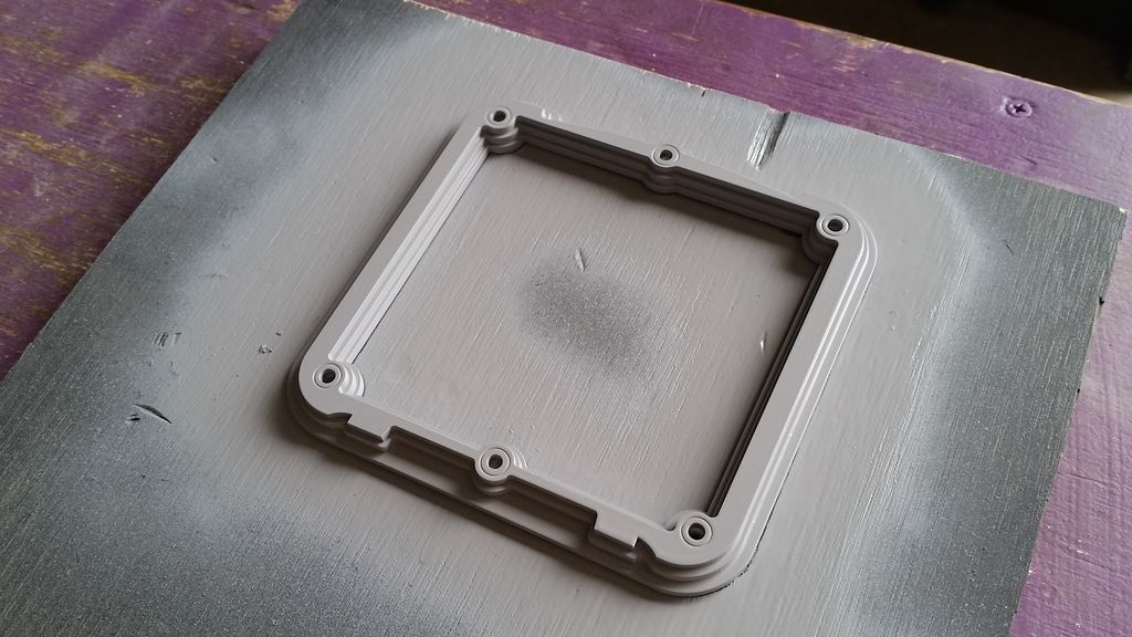

Primed
Painted black and awaiting the traditional silver
Those standoffs I mentioned last week

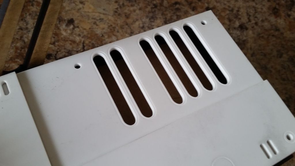

These look much better than the pile of nuts I put in place. Just need to paint silver

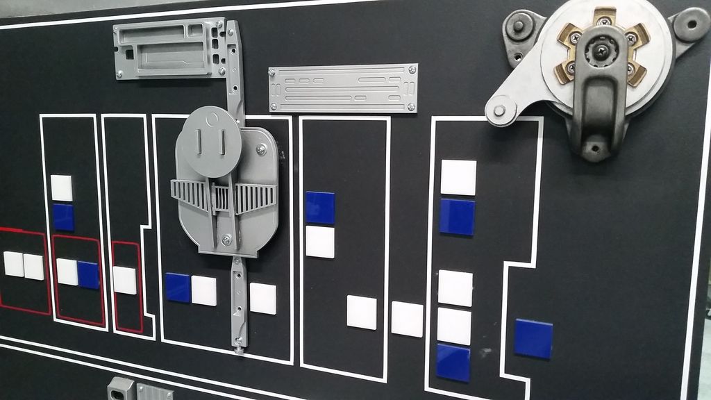

One of my fav panels! :)

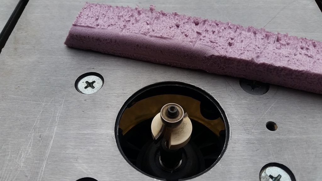

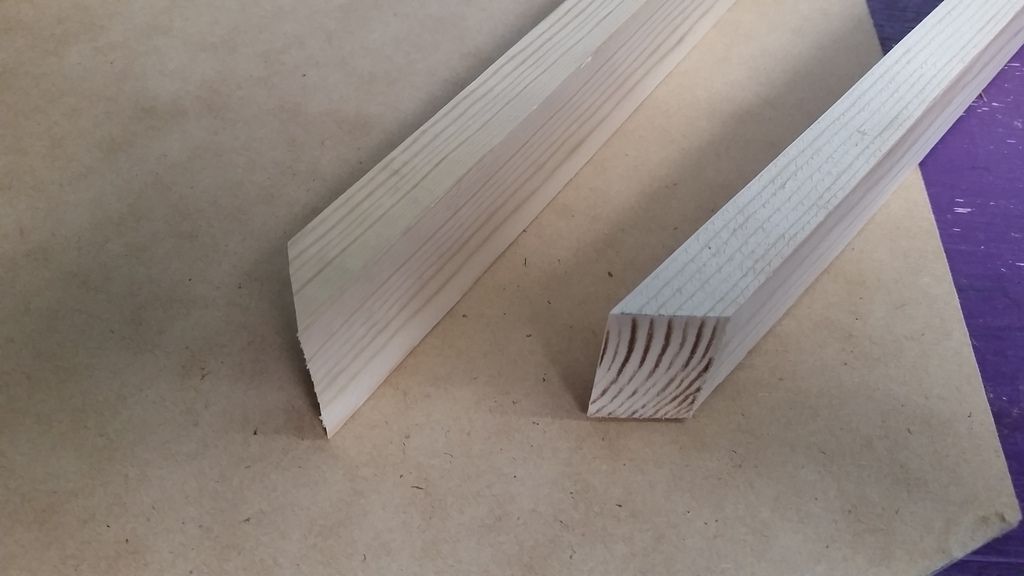

I then routed the edges of the door pads to allow for a more graceful curve - practice piece
Before
The router didn't remove as much material as I would have liked in most areas
Nice rounded edge

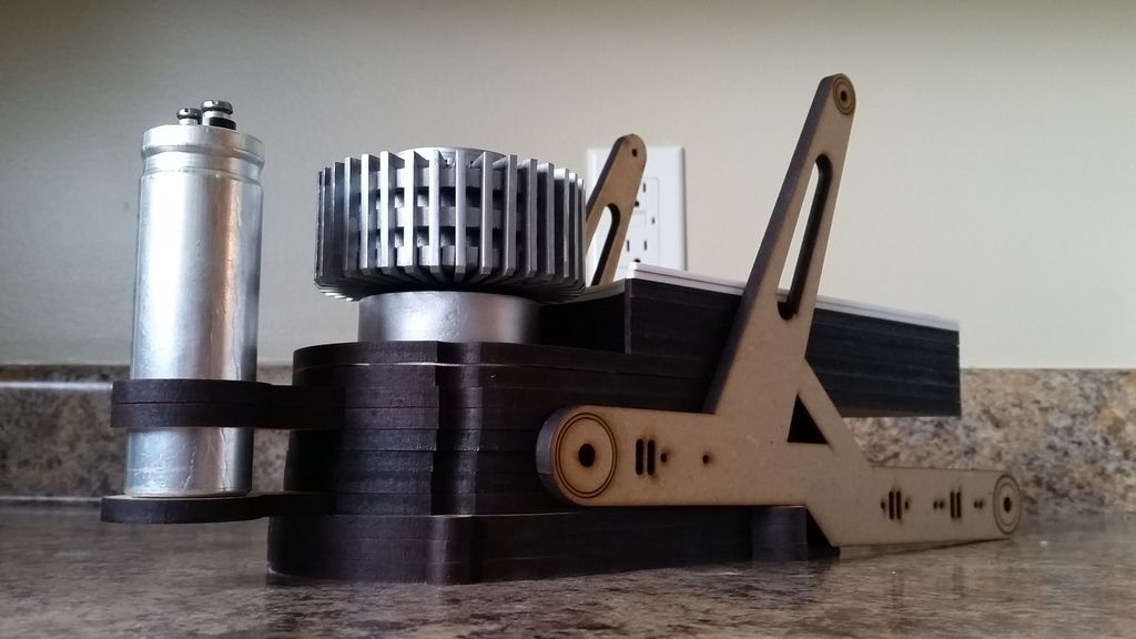

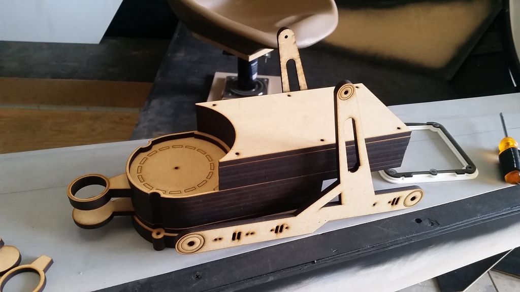

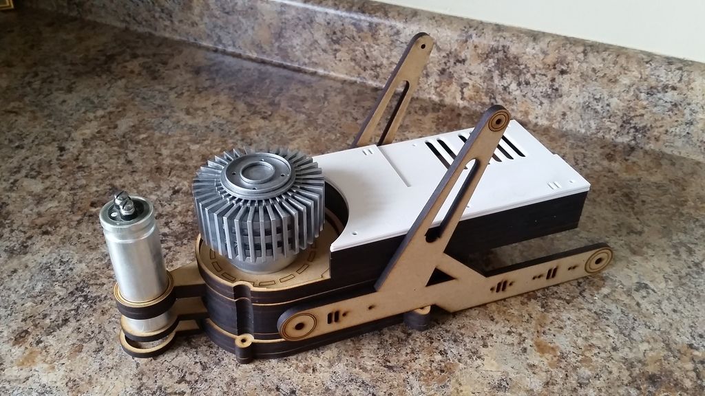

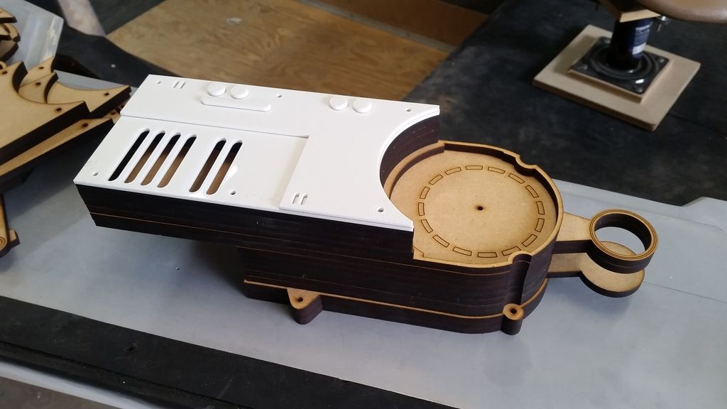

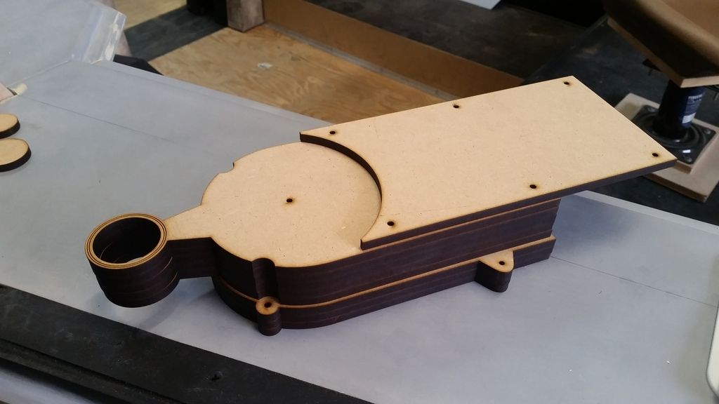

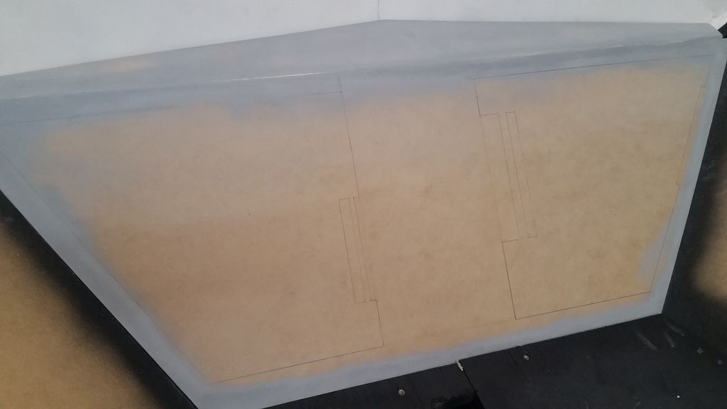

I'm reworking this greeblie pack

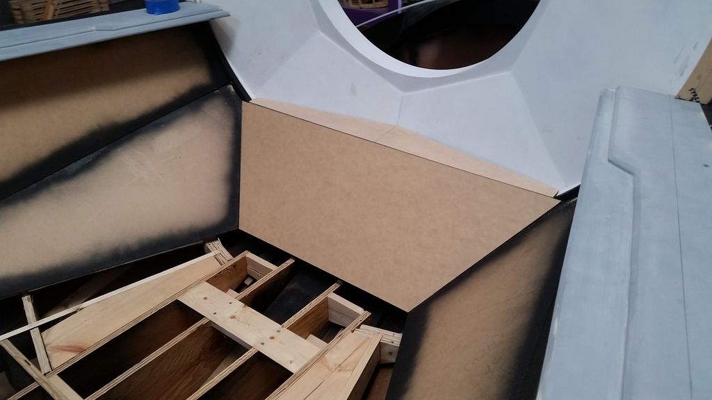

More work on the foot well panel
After painting I think I'm going to add some pinstripes

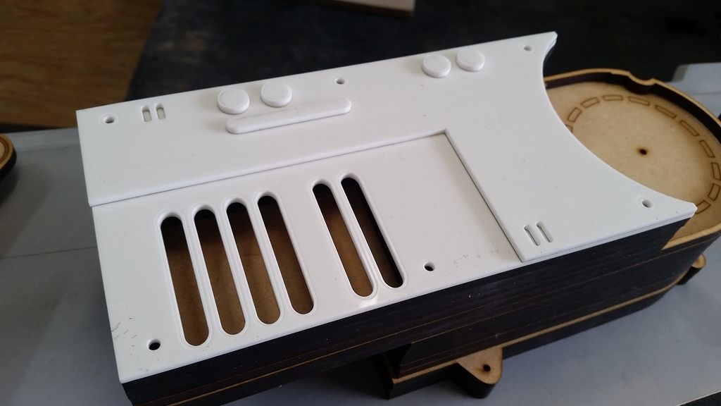

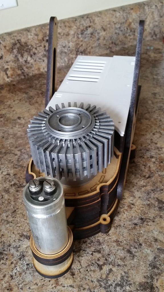

The foot well panel will have a few greeblies mounted to include this one I designed... Laser Cutter Works!
Getting closer to the actual shape and design
Acrylic top
When I got home I dry fit everything to see how it would look... hmmmmmmm
It looks like a big grasshopper!
I don't think I like it... What do you guys think?
