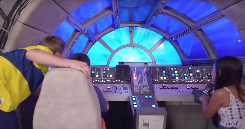

We were on display at the Huntsville Space and Rocket Center for a little over a month during the premiere and showing of EPVII - it was amazing! The guests and followers of the build were AWESOME! We're back at the house now. It is nice to have her back home but we do miss all the room and talking to all the guests.
