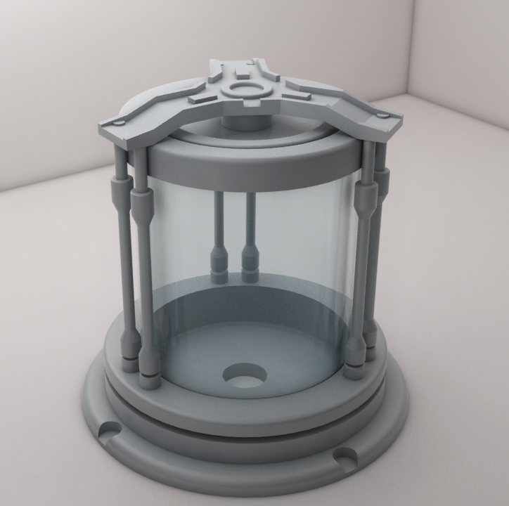

The canister is VERY odd. I dont know the diameter of the actual canister and I was limited to the size diam acrylic tube I could buy. With that, I ordered a 4" diam tube. That's what I have to work with. As a result I have to compromise a few things in order to make everything fit and work together. I know... I'm not thrilled with it either!

Hi Sofa,
After watching the preview for the disney behind the scene special, I was able to do a quick 3D mockup of the center armrest canister --
I am hoping that this might give you a few ideas for your project and if you want I can send you the 3D file if you think you may need it --
Thanks
Oslm
