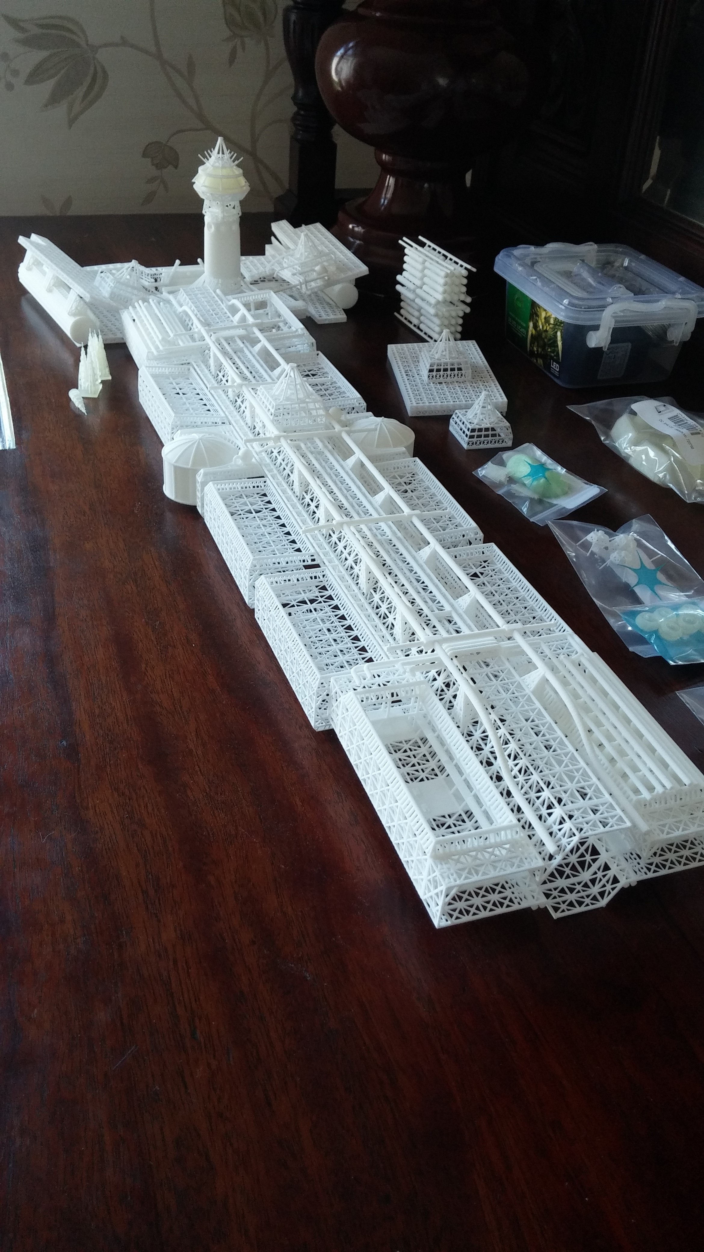

And today I received my laser cut armature. All the way from Las Vegas, USA! Very happy with what I received. Looks like a 3d jigsaw, should be fun putting it together.....
Nothing for the bow yet. I havent got that far.I've still got most of the bow and the top spine to get before I even look at the bow section.If memory serves right,nearly all that section iN the movie was blacked out,apart from the small windows and docking tube,so a cut perspex block might do for that.Cut,drilled and sprayed. Have to get the bow parts first and take measurements before doing anything though.
Rome was'nt built in a day,after all.
I have received all the tanks, all in perfect condition:)
But, for the power drum tanks can't I figure out whether the solid end of the cylinder is the top or the bottom.
I also received the main engine nozzles and I have no clue how to install them in the core pieces without cutting something in the core part.

I received my latest crop of parts and all but 2 came out great; the observatory antenna base and the lower command spire. I think both are usable with some work.
Oh sod. Mine was going to be WSF but I can't recall if I ordered one or not, or if it was another print fail right now. At least the sprues seemed to work - my first attempt was much worse looking than this, if that's any consolation!
The observatory antenna base they said said they printed one (I ordered 2 but either were unable or didn't want to print the second because they did not think it would survive shipping). It almost did survive the shipping but the base sprue did not support the long legs radially so they twisted around the base and 2 broke off.
(Cartman) God...DEMMIT!!!! (/Cartman). That's crush damage, I'd be almost certain. Too much vertical pressure. Oh that's crazy, they shouldn't have packaged it in a way that would allow for that. OK...I'll sprue the legs too.
A couple of the rod broke as shown and I think replacing them with ABS or brass rod shouldn't be to difficult. Two things concern me about this piece 1. the legs do not go all the way to the bottom of the dome. Is this correct?
No. There is a slight rim on the dome base part but the legs should at least reach that. This could be resin shrinkage, I guess? I don't recall it being a problem on my failed WSF print but will have to dig it out of storage and check. (Not easy right now, half the house is in the shed.)
The other is attaching this to the upper spire (which showed up perfect). How are the two supposed to be attached to each other. AT first I thought there would be a hole in the base of the upper to slide the upper point into. But the bottom of the upper is flat. The only thing I can think of is to drill a hole in the bottom of the upper either big enough to fit the tip of the lower or smaller to insert a piece of wire between them.
I'm afraid that part is a bit of a cheat. I more or less just used the rod as a sprue for the antennas - for mine, I'll snip them off it and slide them over a hollow brass rod, so that I can have at least one of the red nav lights represented by fibre-optic. But if you want to you can build it from the part as supplied. Printing it this way just saves a little bit of cost.

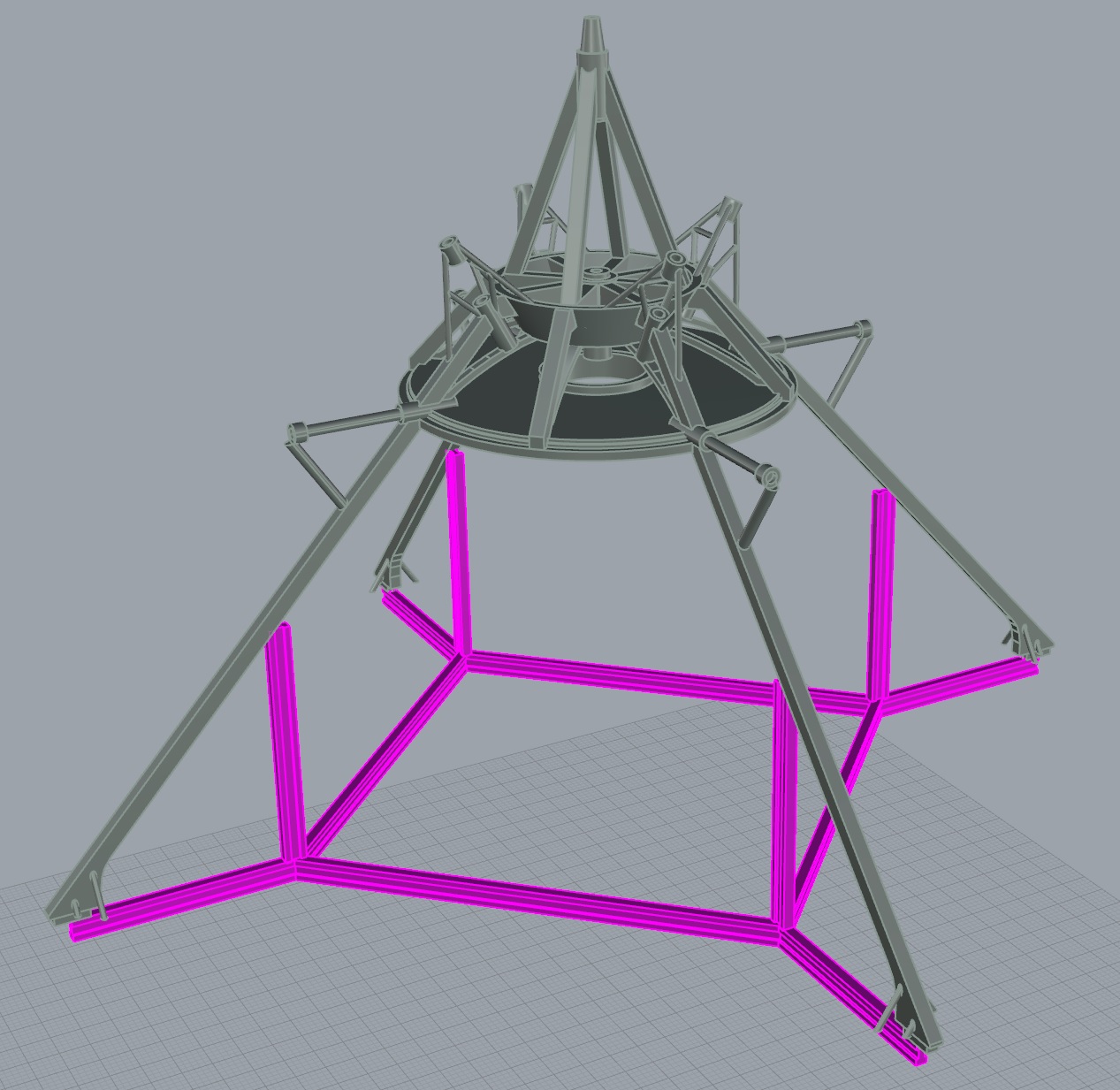

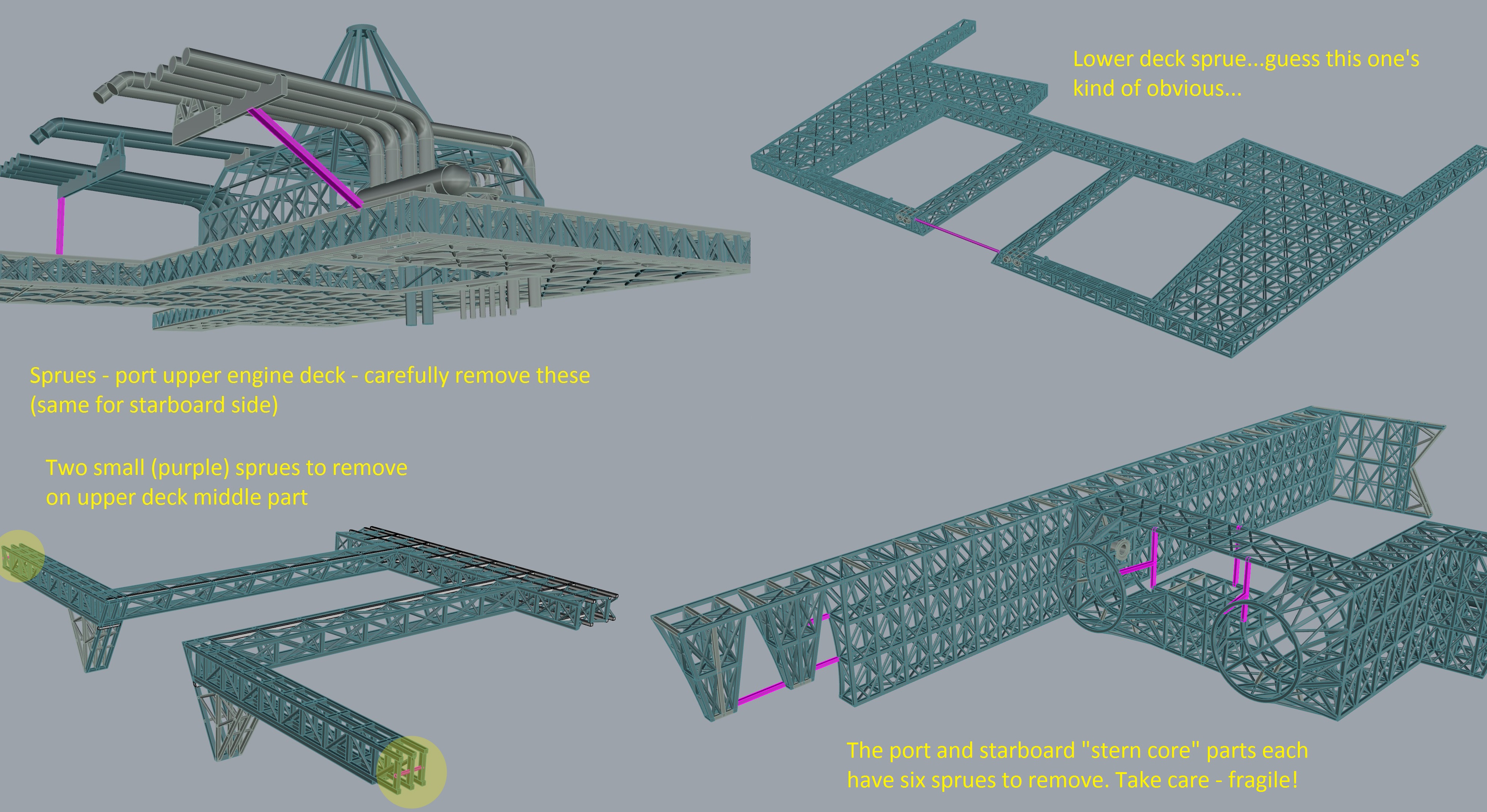

Sprues for the stern deck parts.
Edit - also, uploaded a more sprued-up version of the antenna frame.

The observatory antenna frame was not crushed vertically, 1/2 was twisted around the base. But if they had put it in the inner box like a couple of other parts I'm pretty sure it would have arrived just fine.
I've changed the observatory antenna frame. Little bit of extra spruing, hopefully that will be enough. My last copies were ******d too, so I needed to do this for myself. But in my case, they'd managed to smash the small antenna mounts rather than the main legs. I don't think there's any way to really protect against this, unless SW returns to better packaging quality.
Every upload is treated as a new file. You can 'update' a given part with a new version, but the system resets everything if you do - for production purposes it is considered brand-new, never tried.
