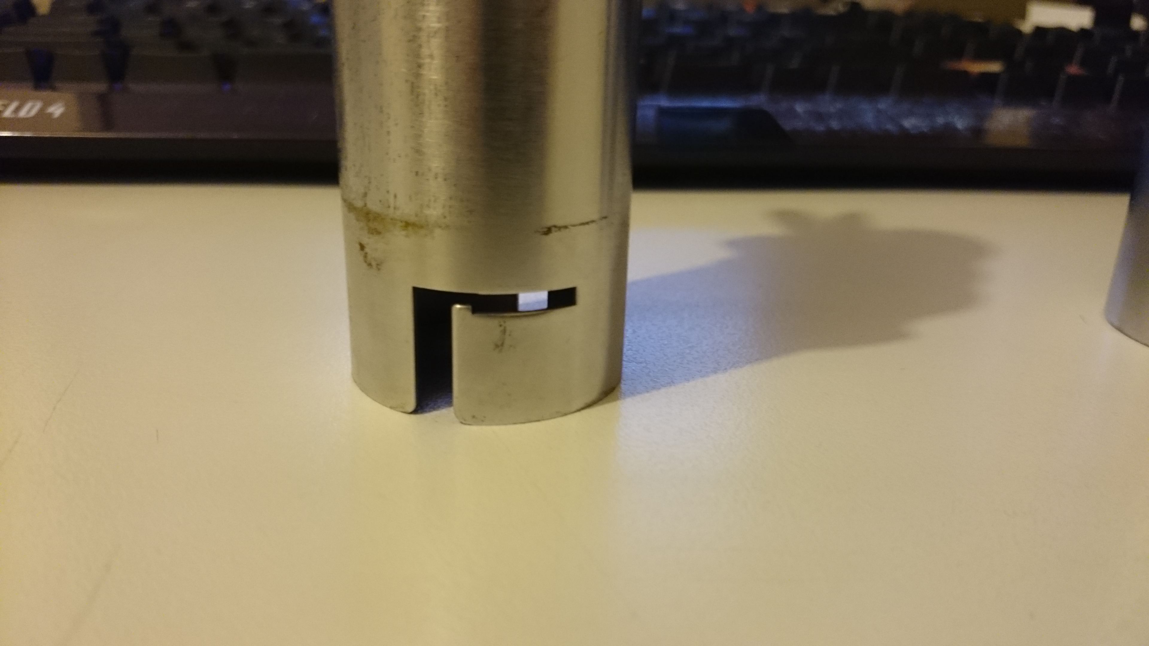

Quick HUGE favor for anyone who owns a vintage 3 cell, or a non-2.0 replica...
I've scoured this thread in search of a picture or two of a 3 cell without its clamp on, to no avail. I'm in the middle of making a replica mostly based upon Ant's Graflex replica and the Reflex prototype blueprints, with the exception that I've made it in 2 parts, in the same vein as the genuine article.
Now that I have both parts I can't for the life of me figure out how they lock in together without overlapping lopsidedness.
Any help would be greatly appreciated!! Thank you all

Thanks partner. I'm actually trying to get a pic of the top and bottom pieces locked together without the clamp on. Sorry that wasn't clear. I'm not that good with my wordspeak.

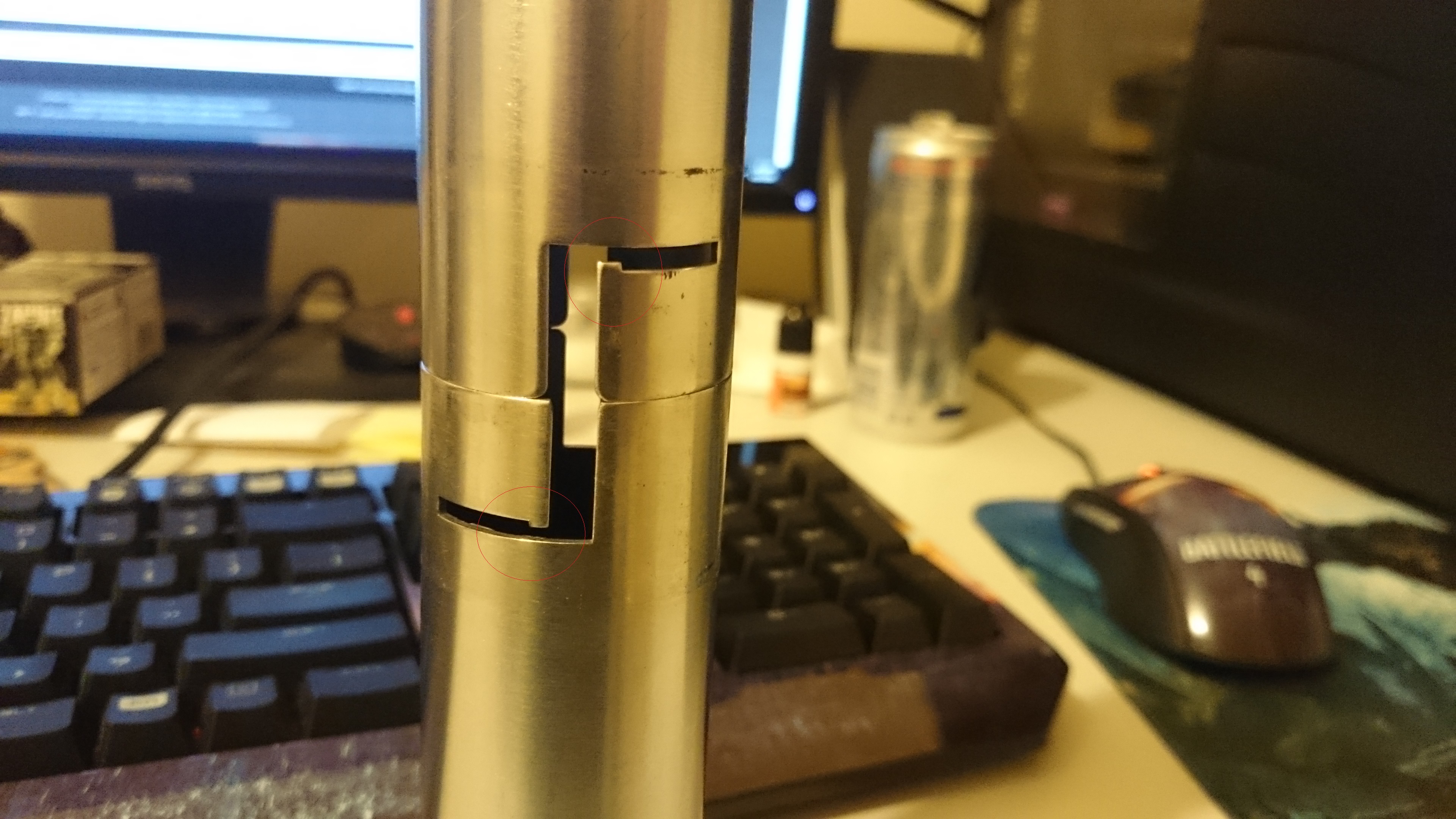

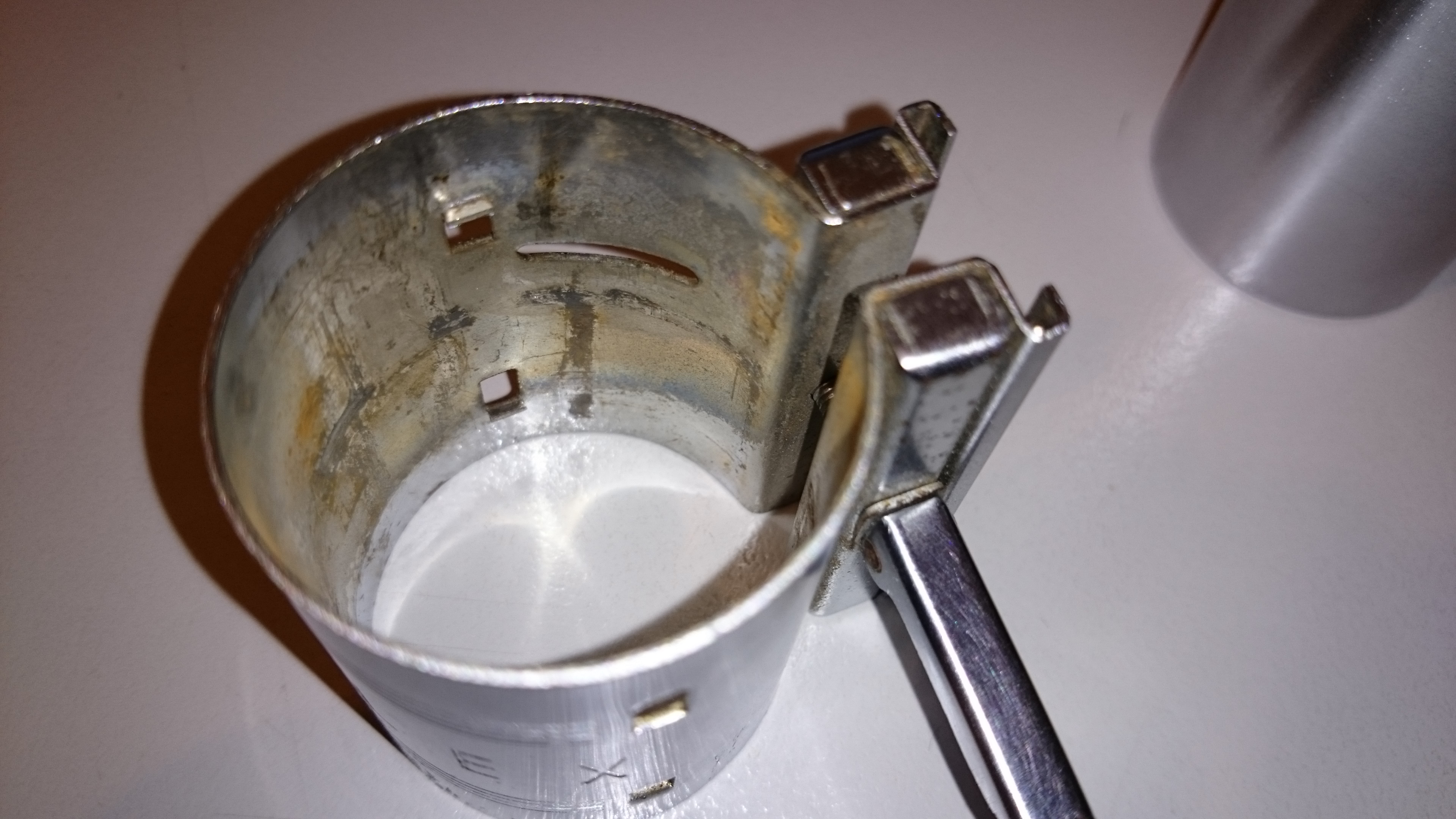

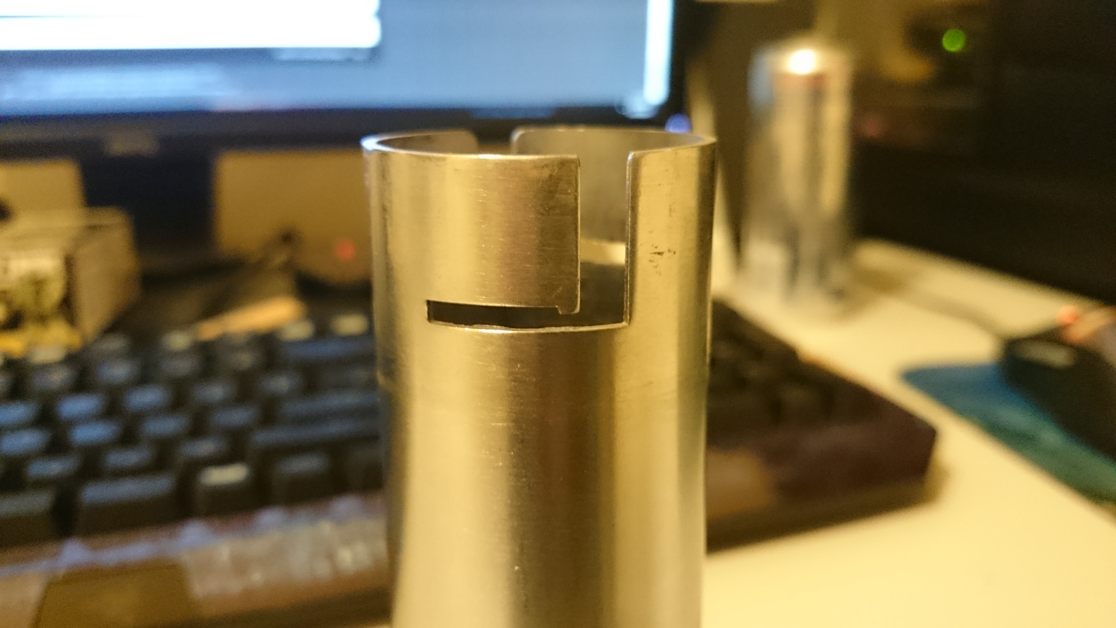

if I understood your question correctly, then the top and bottom piece actually lock themselves to the clamp, rather than to each other
here's a pic w/o the clamp, there is no lock mechanism at all, one slight touch and they will fall apart:
look closely to the........ canals (can't remember the proper word for it) in both top and bottom, you will see a slightly raised "notch", that is the thing that is locking the top and bottom piece to the clamp.
lol no probs
Brilliant! This was just a case of mistaken identity then, since I've never been in arms reach of a genuine 3 cell I always assumed the two pieces locked together prior to the clamp being placed on.
My eyes are now open! Thank you so much
EDIT: okay so the notches are something I did not include when doing my dremel work. Will have to work on that. Plus when I make my clamp it will really need the interior tabs, haha
