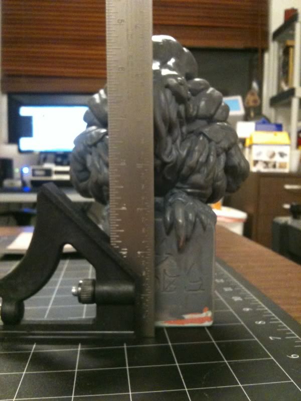

I was getting to mold the beast last night and of course I instead decided to fix a few things before.

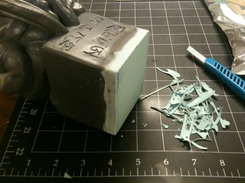

When set onto a flat surface the sculpture feels like it tilted to the right slighty. After checking the "squareness" of the base the bottom face proved to be off on the right side by a 1/16 of an inch or so which caused the small but noticeable tilt.
To fix this a made a puddle of body filler the size of the base right next to a 1/16 thick piece of styrene which the right edge of the base would rest on. The filler would harden and give me my newly corrected and level base.
I then smeared on some more filler to fill out the edges so I could then sand it back to it's proper edge shape.
Here's all the excess filler sliced of while the glop is in it's midway "rubbery" phase.
I then sanded it it out and filled in any little holes or hard edges with red glazing putty to create a seamless fix.

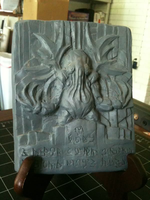

Getting back into the Cthulhu project.
Here's a couple of sketches made for the tablet/ bas relief-

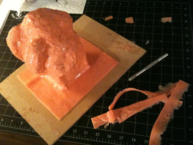

My first silicon mold is finished!
I love the way it looks at this stage!
Cthulhu has claimed his first victim!

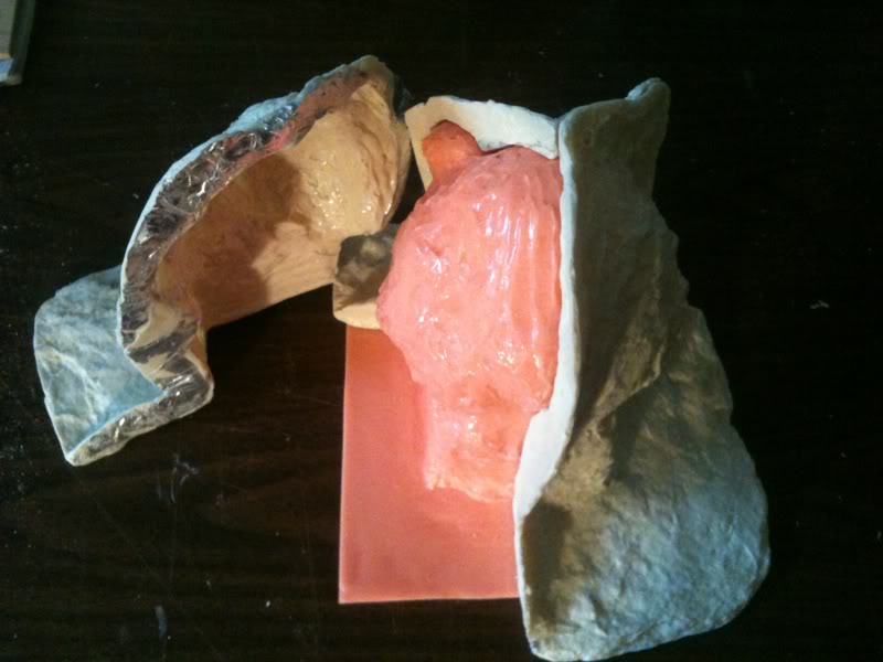

Peeling off the hot glue blob that held it down to the board.
It was stuck down firmly enough that a part of the original sculpt started to pop off when pried off. Not bad though.

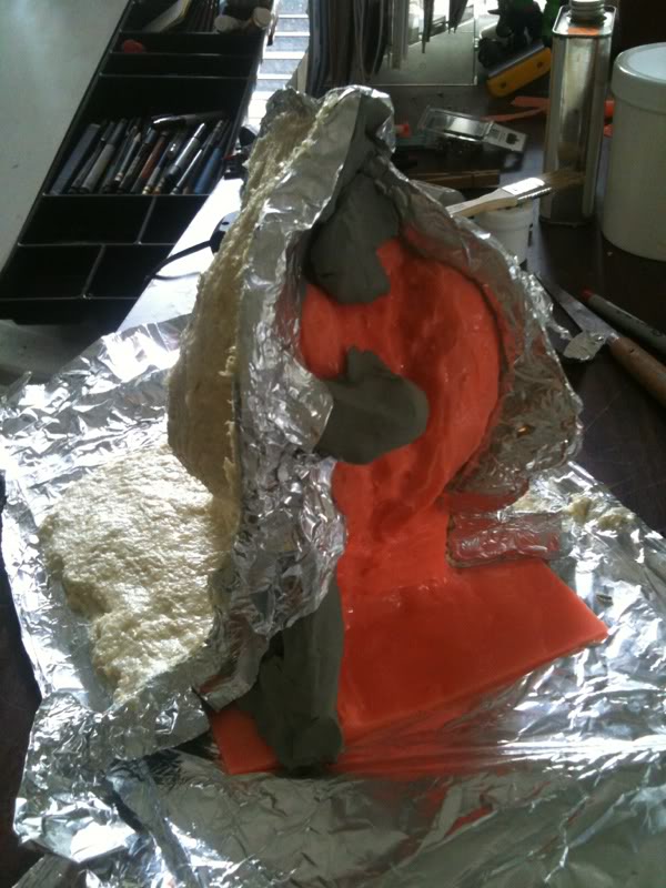

Building the mother mold with plasti-paste.
Mold porn!

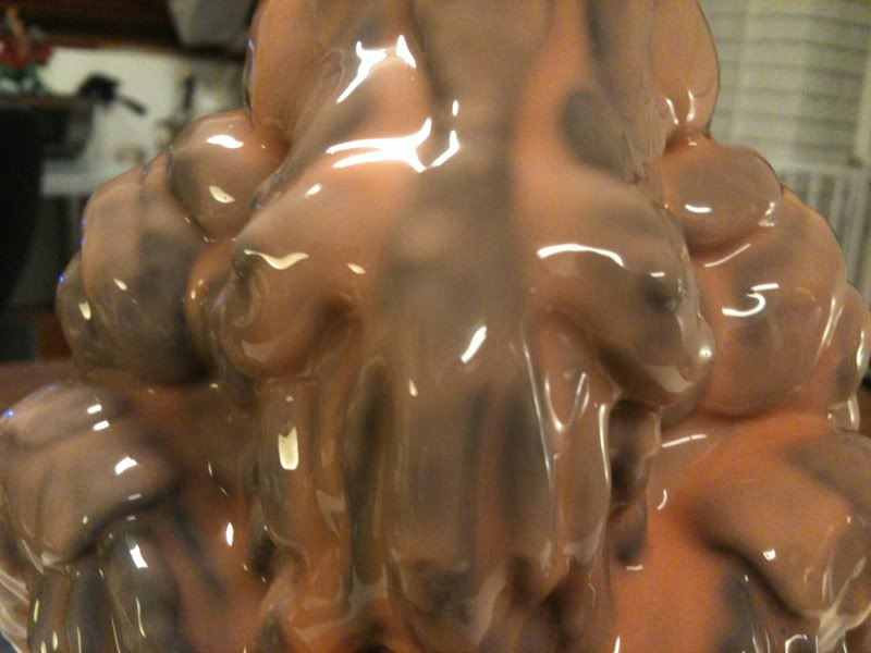

Poured up my first resin castings tonight with much success.
Learning a lot going through this process. The casts are pretty clean over all. I used Steve Neill's baby powder trick on the first casting and I think it definitely reduced the bubbles compared to the other two. The are a couple bubbles in the silicon mold in a couple deep wrinkles but the result resin balls pop off pretty easily with an exacto.
These castings will be mainly be used for paint tests.
Next I'll try tinting some resin and see if I can get a green/black swirl effect in the actual material and might even try some translucent material. Also want to try casting in cement to get the weight and cold feel of a real stone statue.
Also want to try casting with marble dust in the resin to make it colder to the touch as well. I remember reading something about that a while back when first researching the project.
I'm looking forward to making a new mold as well. There are two areas in the tips of elbows where air bubbles are getting trapped when they try to rise to the top. Tilting the mold a little bit reduces them a good amount but it's still annoying. I desire perfect castings! After I wear out the mold with these tests, the next one will be two part with proper vent tubes in those spots.
