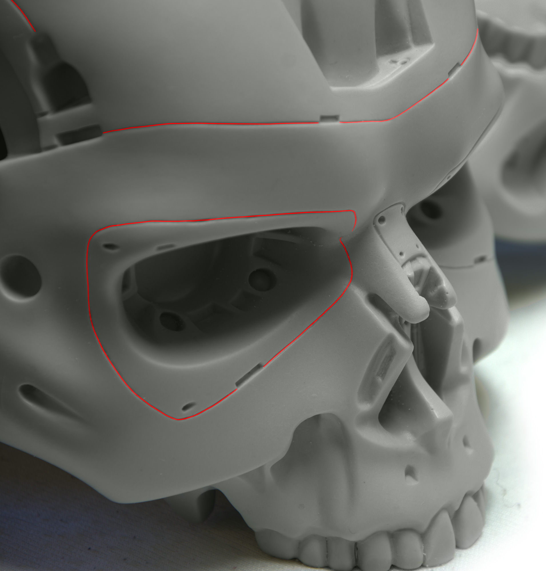

Have to ask, what is your tool of choice for refining details like these lines:
Tack så mycket! :D Det börjar likna nåt nu! ;)
Yeah, it does make it feel much more "complete".
Well I use a couple of steps for creating and refining the lines.
1. Draw the line if it is not already there,
2. Get the dremel tool out - and use a fine pointy drill and carve the line out.
3. Cover the freshly carved line completely with fine putty, then use a sculpting tool (I use a pointy sculpting spatula) to redraw the line in the putty, as "smooth" as you possibly can.
4. Sand away the excess putty once it is dry.
5. If the line is still jagged or uneven, use a razor and adjust the parts you don't like, then repeat steps 3 and 4. :)

Here's a new update where I took KingBeezz's advice regarding some issues on the jaw.
I made it slimmer, but I'll sand it down even further on the right side(our left) to get it more straight.
I redid the curvature on the left side of the jaw, following the details to make it more streamlined, and I added the tiny "box" and hole behind the piston connector.
On the right side of the jaw I redid the curve moving along the details on the side.
For the overall appearance I reduced the height in the back of the jaw, getting a smoother and rounder transition from the back of the jaw towards the chin.
