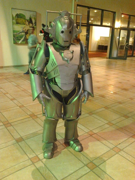

Made from your pattern, wondersquid! Thank you so much, I made a lot of Whovians happy here in germany :D

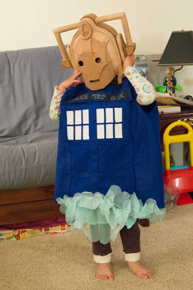

Would it matter if I assembled the templates out of cardboard instead of foam?
Shouldn't, but they do require compound curves, so you may have to dart the patterns more in areas. Show me what you do, I'd love to see how it works, or doesn't in cardboard.

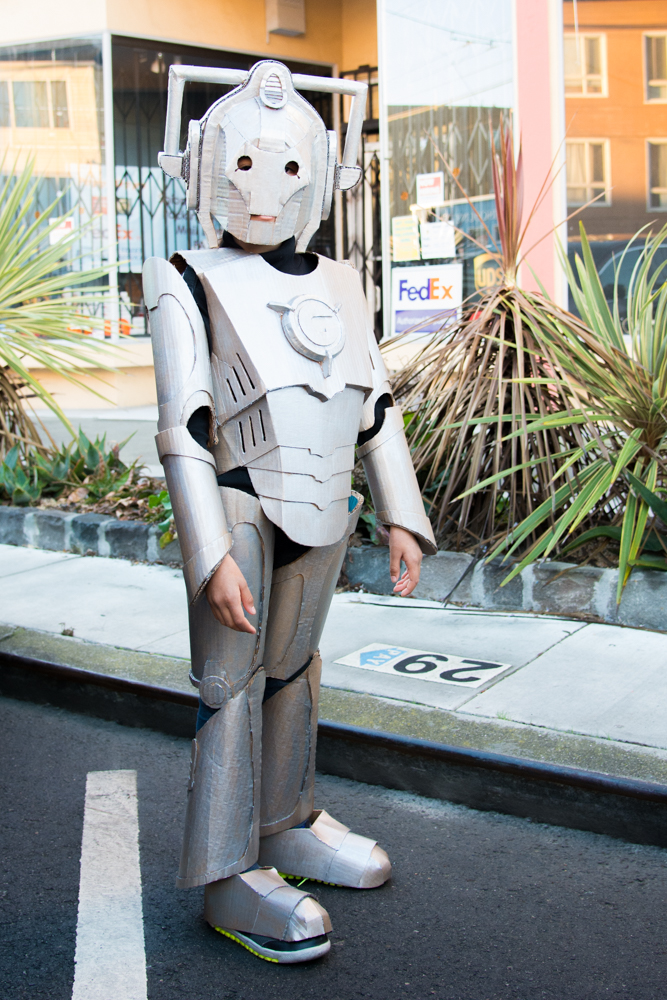

Thank you for having your plans!! I bought and printed them for my 6 year old daughter at 63% (enough to fit the letter size sheet). The head parts were pritted at 75% on legal size paper but the center head ridge was too narrow for her so I printed that at 80% and stretched the face out to attach to it :D.
The whole thing was made from cardboard!! So those who are looking to build it out of cardboard instead of foam, it is doable. It was a lot of work though because for all the curves, I scored the inside paper layer of the cardboard (where the corrugated part is not attached to the outside facing paper) so it was bendable. Sometimes, I had to score the paper at an angle offset from the lines of the corrugated cardboard so it would bend a bit more. I also made the handles wrapping kraft paper onto dowels.
My 3 year old wanted to have one too so I scaled the head to 63% for her. She also wanted to be a princess, so I didn't bother to make the body suit haha.
