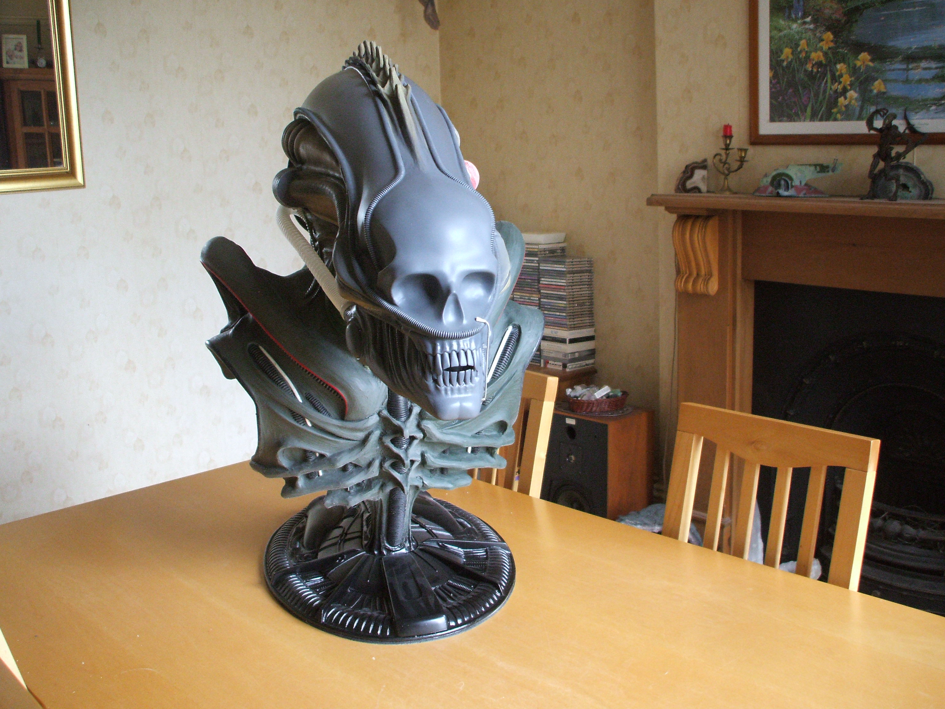

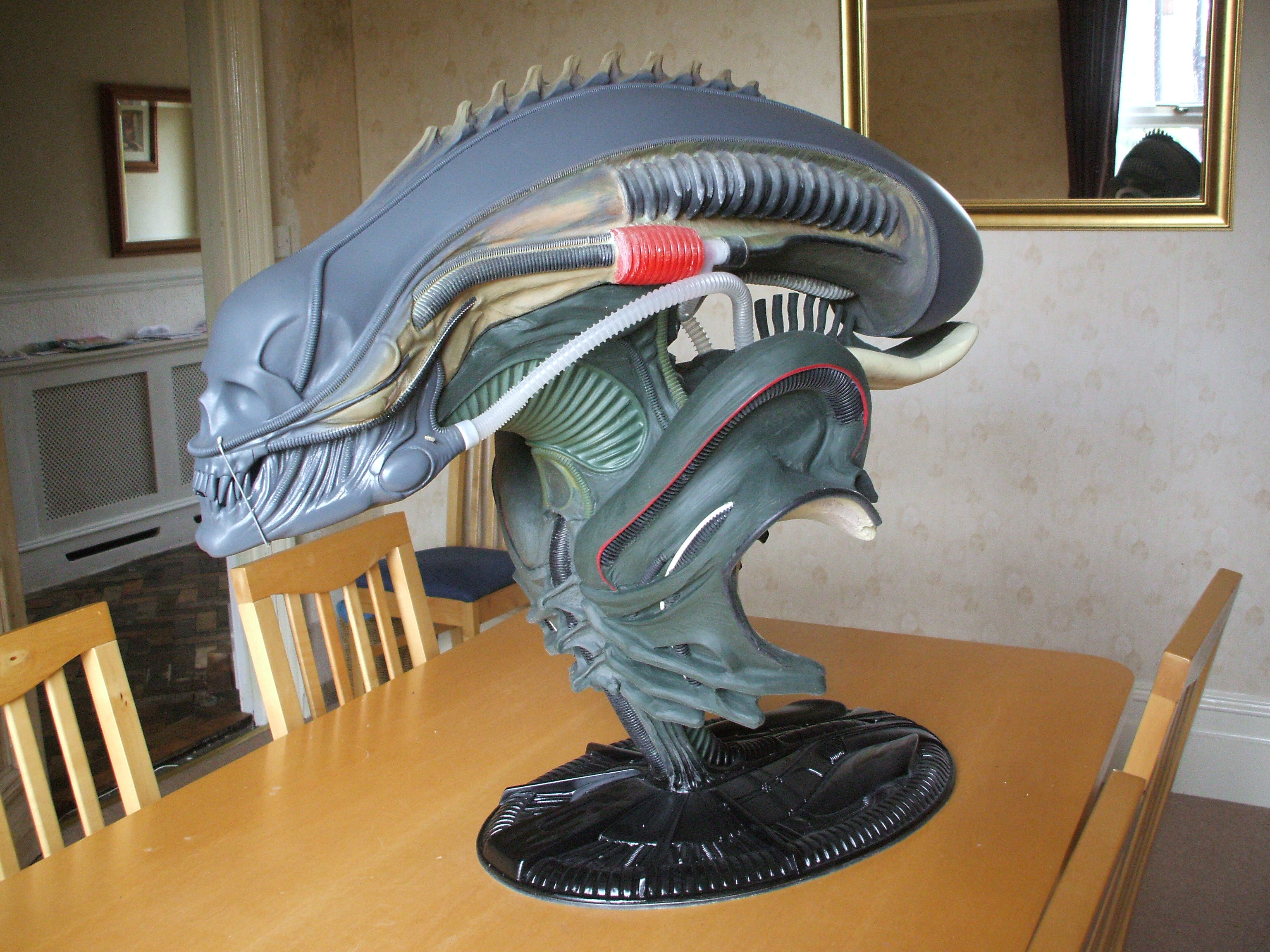

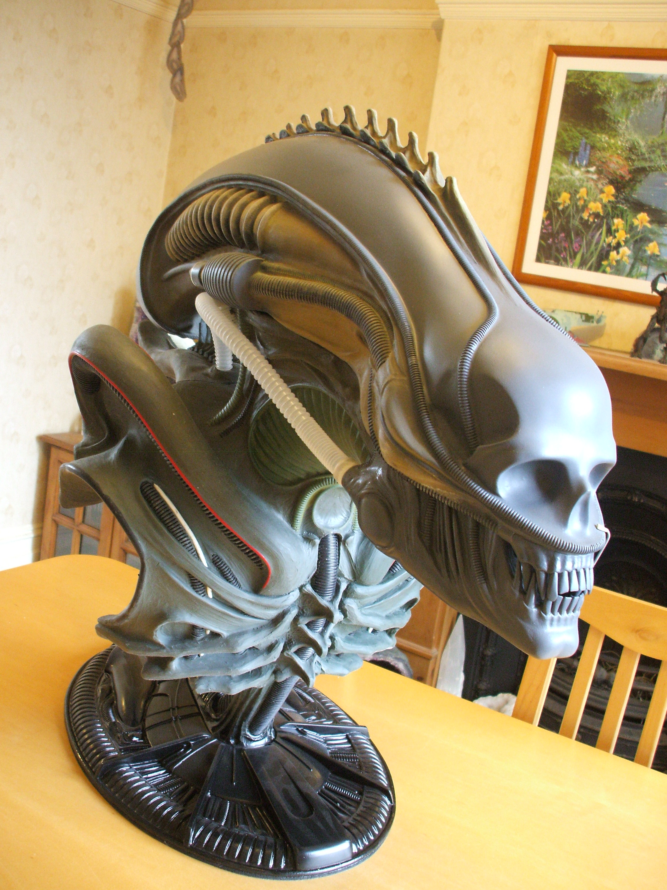

All the hard bits of the head are pretty much done (painted grey) & I can now go back to sculpting the clay (soft bits) :)
He's Back on the dinning room table & I shall be getting stuck into the sculpting again in the morning.
On his right hand side I've just got to go over the surface of the clay & re-texture it, on his left hand side I've got to re-shape the clay in a few places, add some detail & then texture that whole side.
I've also got to tidy up his head spines as they've recieved some knocks & I've got to make the rear most spines to continue on from the ones that are there now.
My Julia took some pics of him this morning:
She's warming too him a bit I think :)
