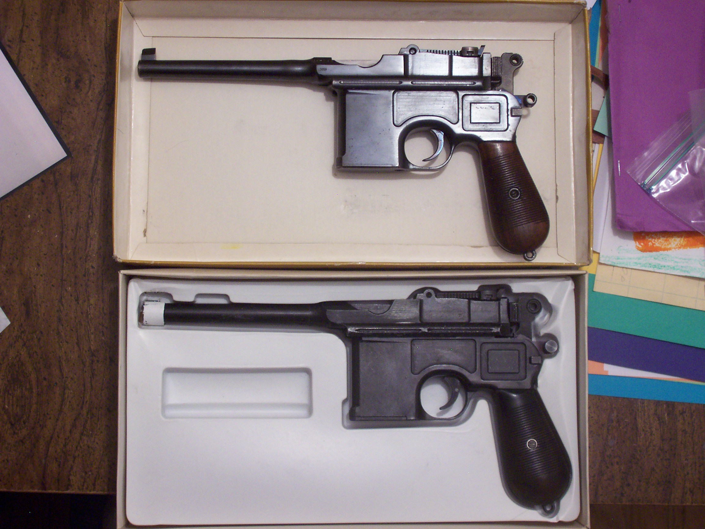

I have a real Broomhandle Mauser (top), an MGC Mauser and a Micrometer so I'll be happy to help out as best I can.
That's great! Your Mauser would be an awesome source for more accurate measurements. Thanks! :thumbsup
If you can manage to figure up any or all of the measurements in this picture, that would be just great!

Here's what I have so far. Measurements off the C96:
Measurements off the MGC:
The MGC is amazingly close in some dimensions and very different in others. The differences could be chalked up to the specific pistol that MGC copied. I've owned two C96 Mausers and the parts were not universally interchangeable between them either.

Hi Dcarty,
The top number from the top of the receiver to the inside top of the chamber is important. If you can, try not to measure the slot for the extractor but try to get the caliperto sit flat inside the chamber measure from there to the top of the tapered section of the receiver.
Also if you can get a measurement from the top of the receiver to the bottom of the upper receiver but not in the recess as show in my previous post.
Thanks so much for your help!
Re: ANH Hero DL-44 Barrel Discussion
Also a measurement of the width of the top of the tapered receiver top for comparison if you can.

My Denix measurements.
Very close to real!
From my measurements if the bore is just 1.mm higher the round barrel is as possible as the flat.
I think the only way to really tell how the prop was really made is to "see" the bottom of the barrel either from the SW HERO or the Naked Runner.
