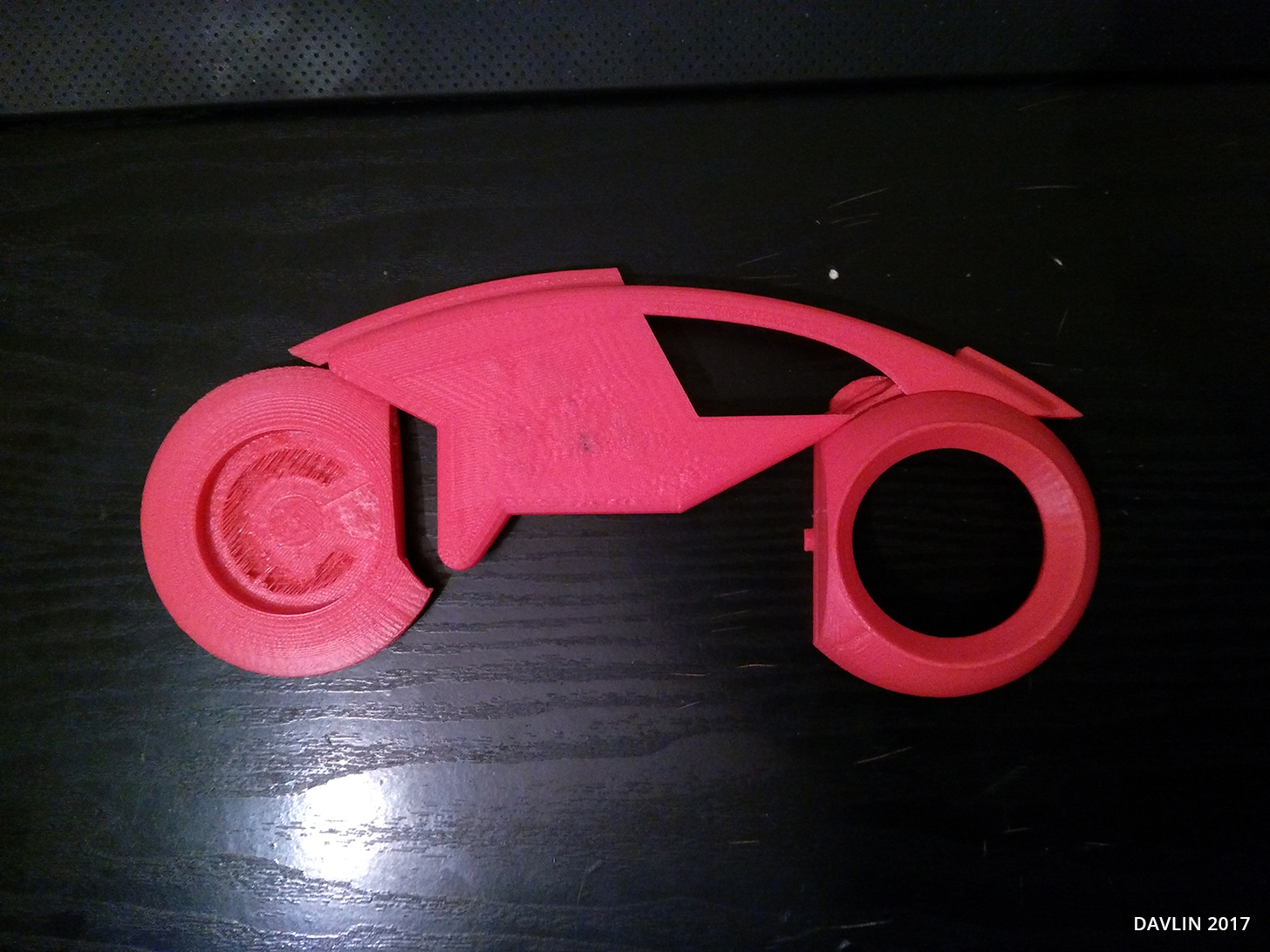

The Lightcycle project is back on tracks. 3D printers have evolved tremendously since 2011 and things are now possible in a way I couldn't have dreamed it when I modeled the Lightcycle back in 2010... I also have access to some awesome tools now, like a laser cutter. The old Shapeways-printed, 12 cm-long prototype have been sent to a friend so he can build it while I couldn't, guess what happened ? Never saw it again. So I starting from zero, but things are exciting. :)
Parts are being printed on a Makerbot Replicator 2x. I have a limited access to the 3D printer, so I can only print two big pieces per week. Layers' thickness is 0.2 millimeter, which is plenty enough for a good start. The whole lightcycle, without the light trail or the stand, will be 25 centimeters long. Parts are printed on the original parts' color, so painting it may be a breeze.
For now, I have the red part from the wheels and the red part of the hull. Here's a photo to give you guys an idea.
What's next ? Well, the light grey parts. Can't wait to get all the pieces for a first dry assembly !
