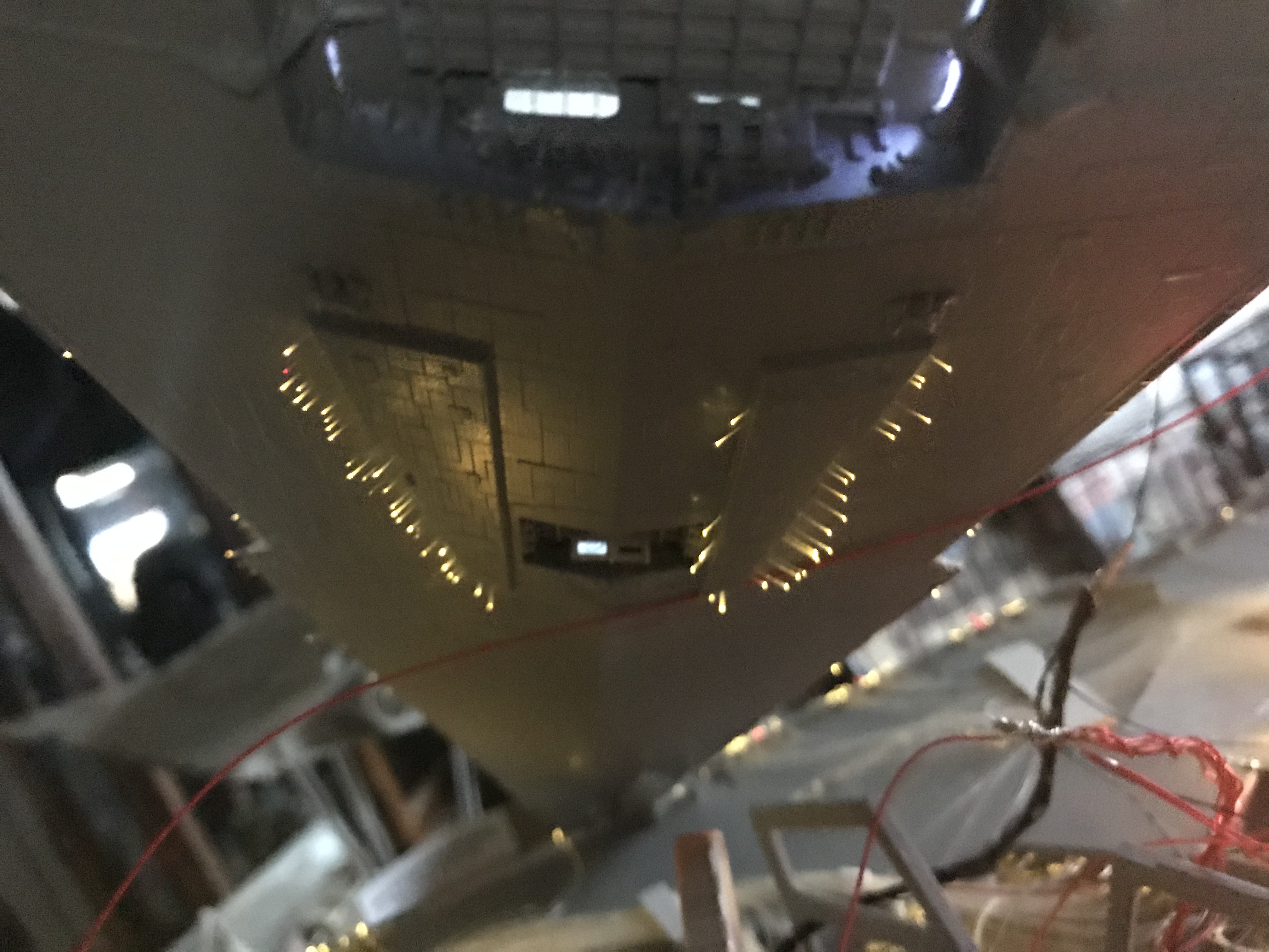

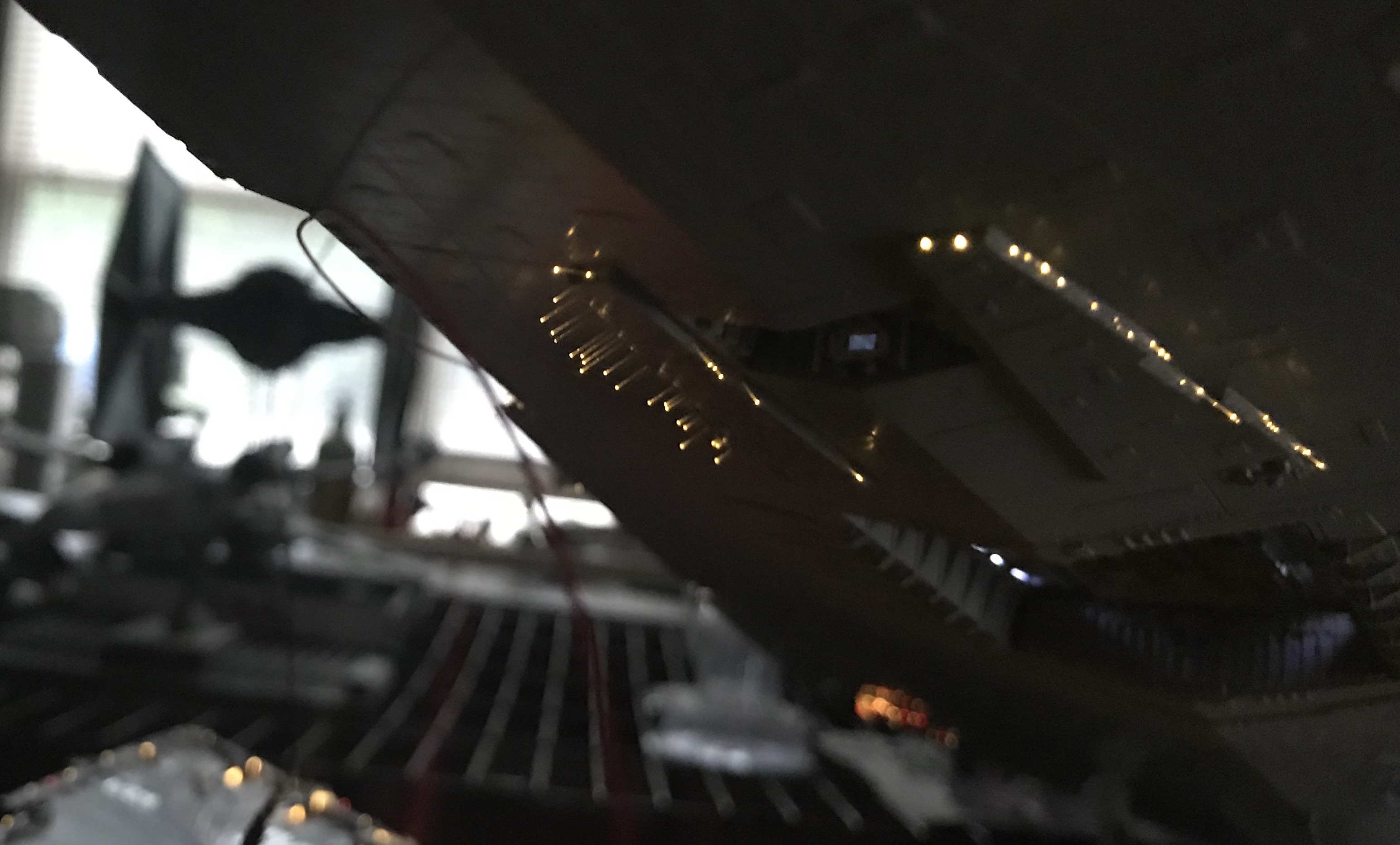

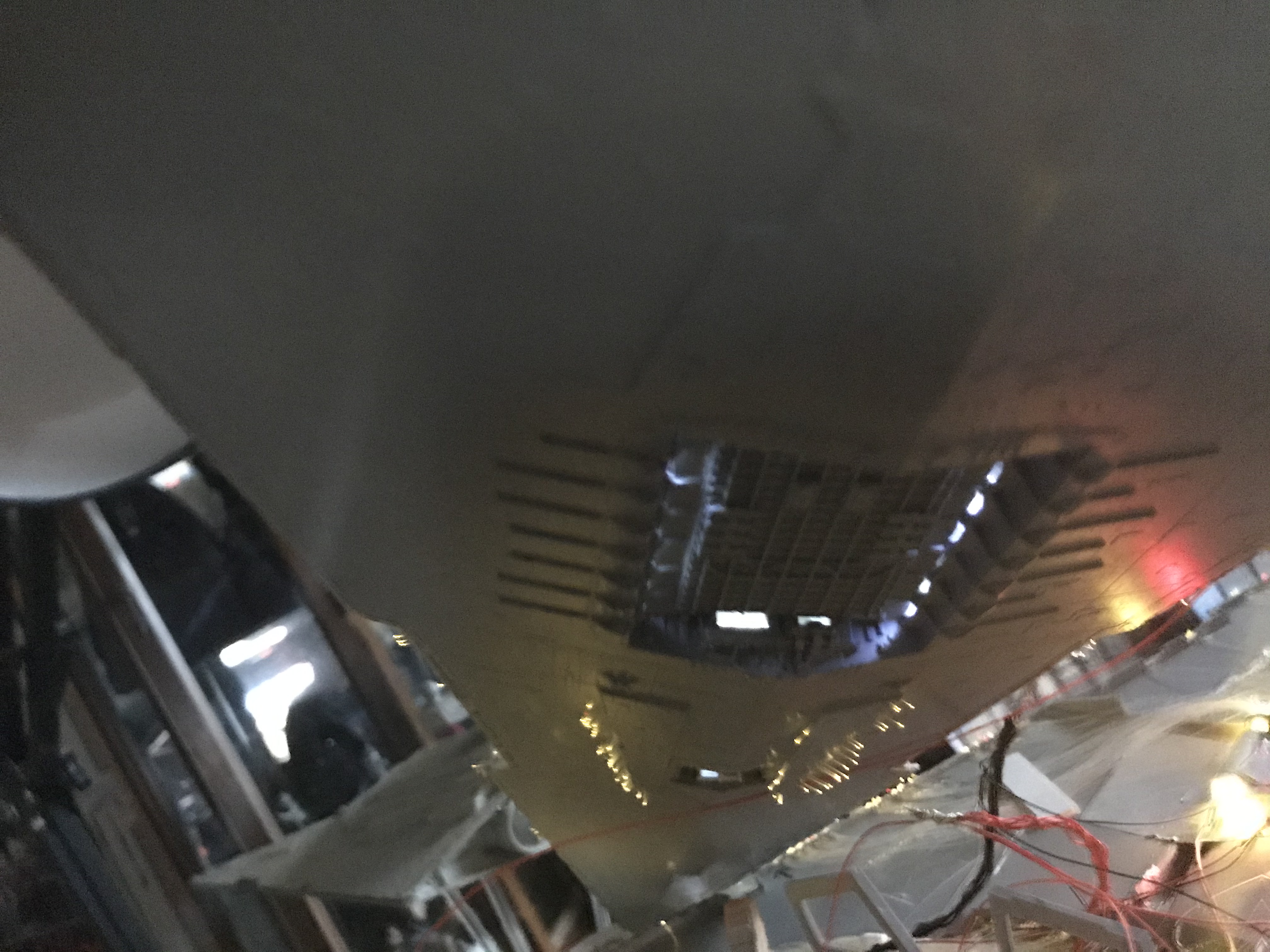

Been awhile - and isolation helped me to find time to work on this one again. I am getting nearer to final wiring. It's messy and I had to cut my teeth on soldering and the wiring both. Almost overlooked the bridge section and fibered that up, ran wire and LEDs and added some more greeblies to the bottom of it, as I added lighting to the underside to mimic some of what we saw in Empire. Beginning to see a bit of light at the end of the tunnel in terms of completing the lighting portion. Then I have the arduous task of masking so I can begin priming both the inside for light blocking and the first coat of primer sometime hopefully in the next few weeks.
Wires From Hell2.jpg Underside Bridge 3.jpg Underside Bridge 2.jpg Underside Bridge 1.jpg Underside Bridge lit 1.jpg Underside Bridge lit 2.jpg Underside Bridge lit 3.jpg

Fastidiously epic work as always mate , and still so very inspiring !
Out of curiosity , if you could approximate the number of hours it’s taken just to get to this stage ( the finish line is just over there !:p ) - could / would you share please ?

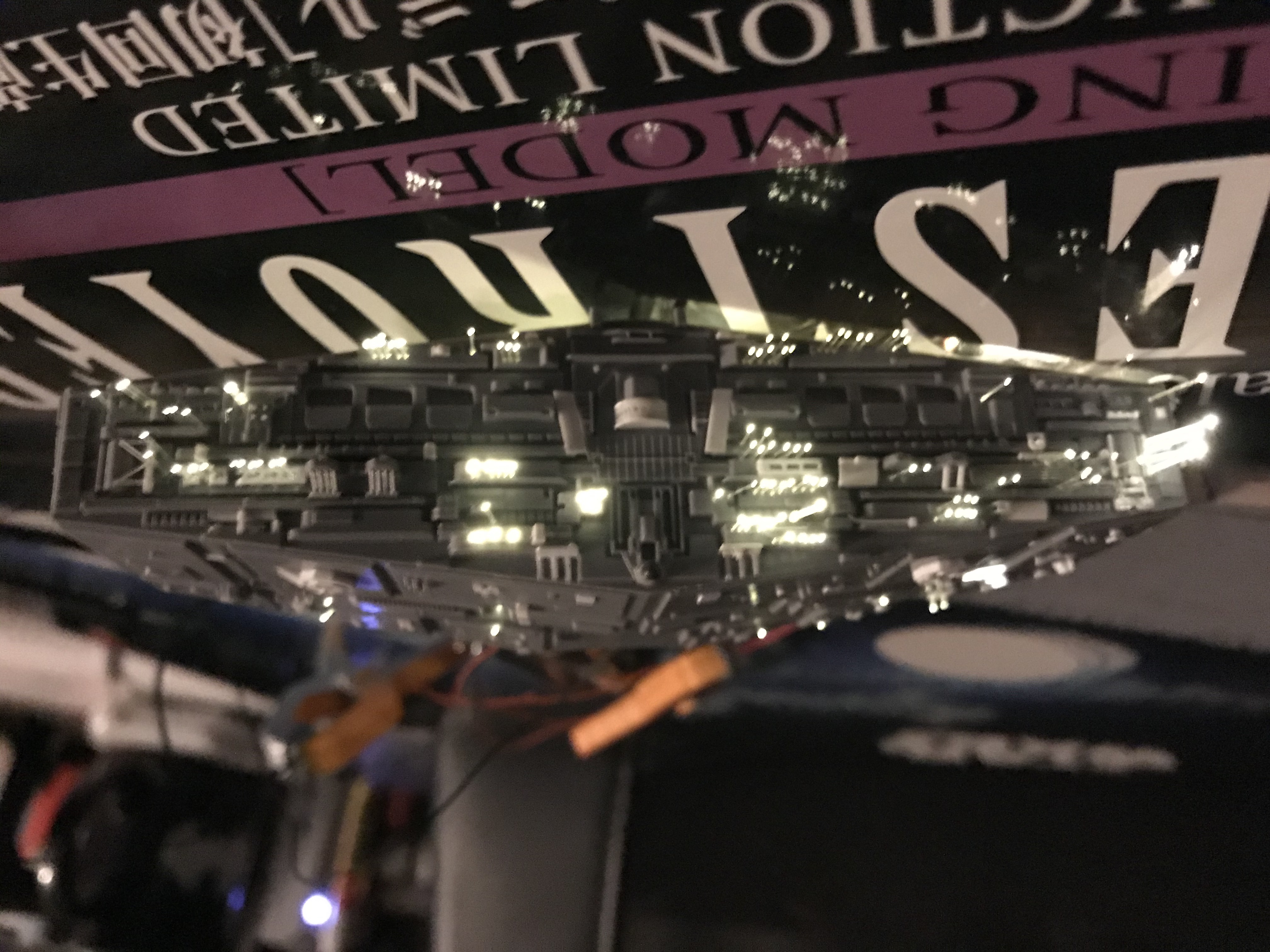

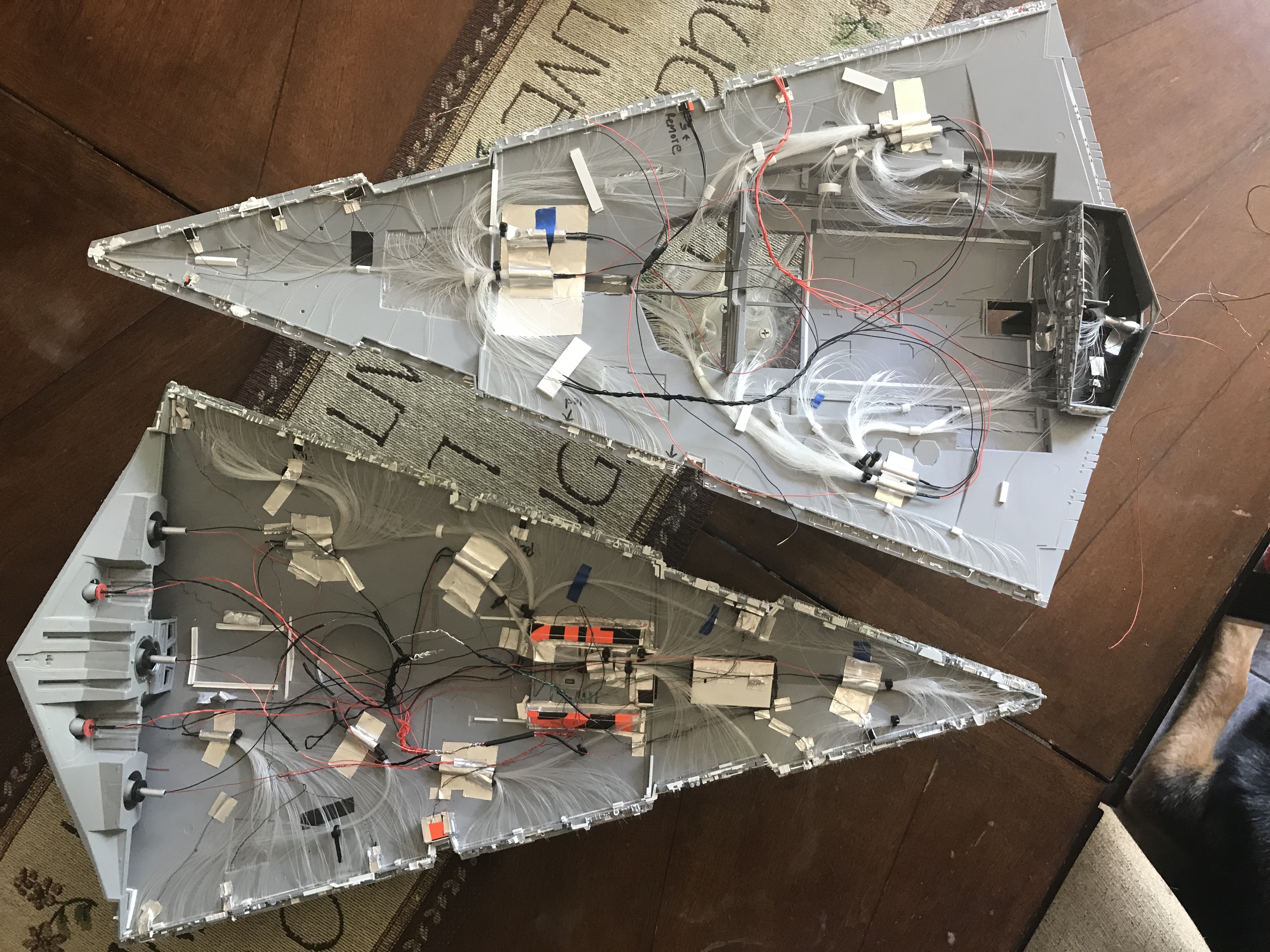

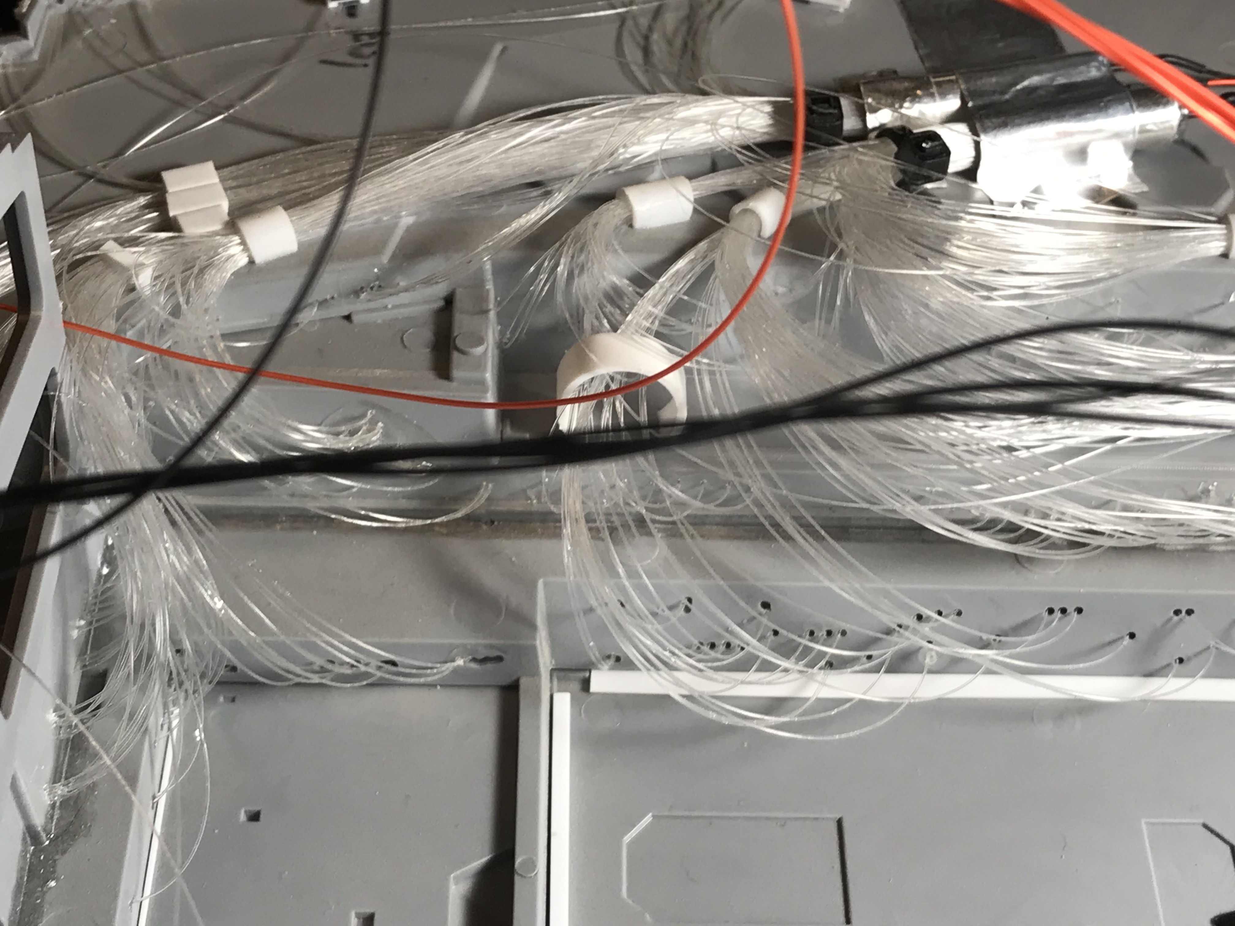

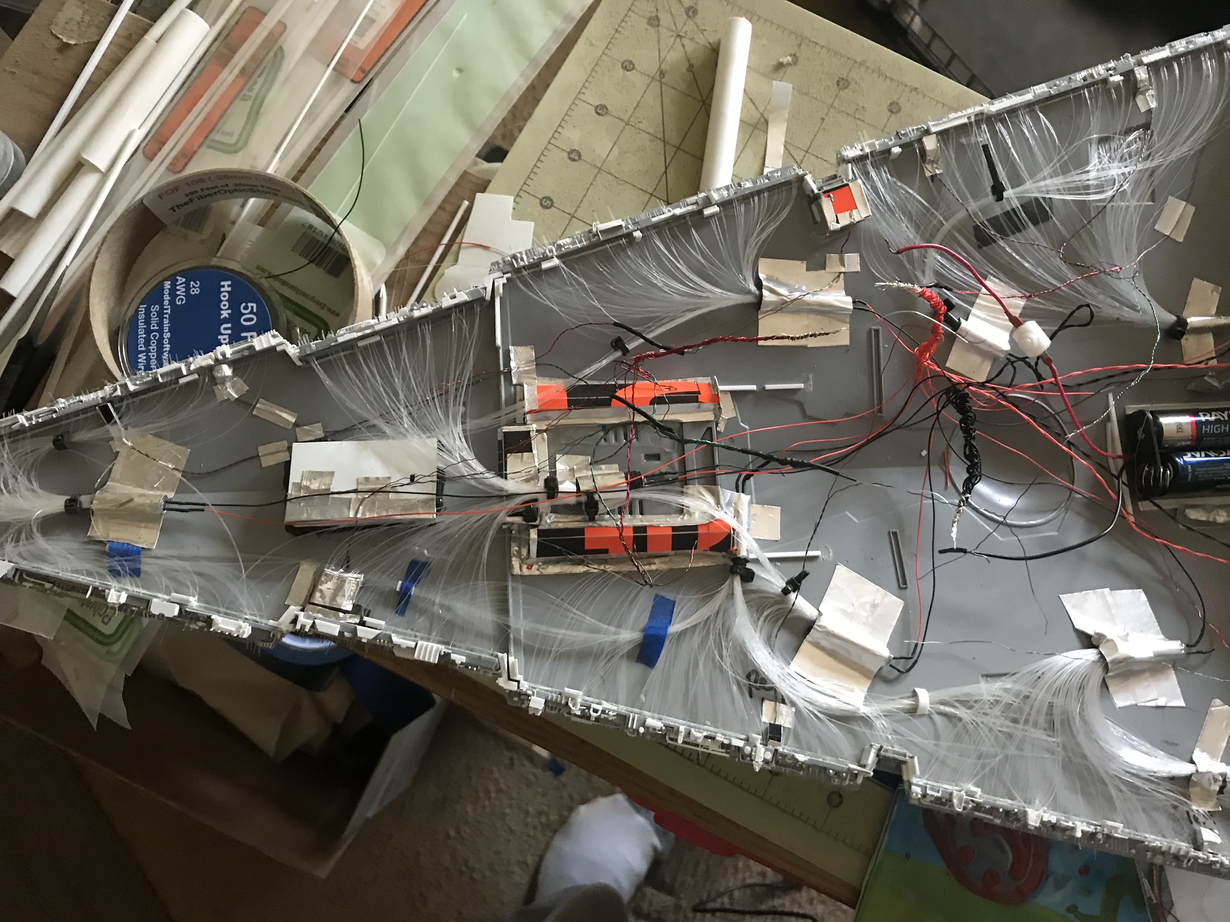

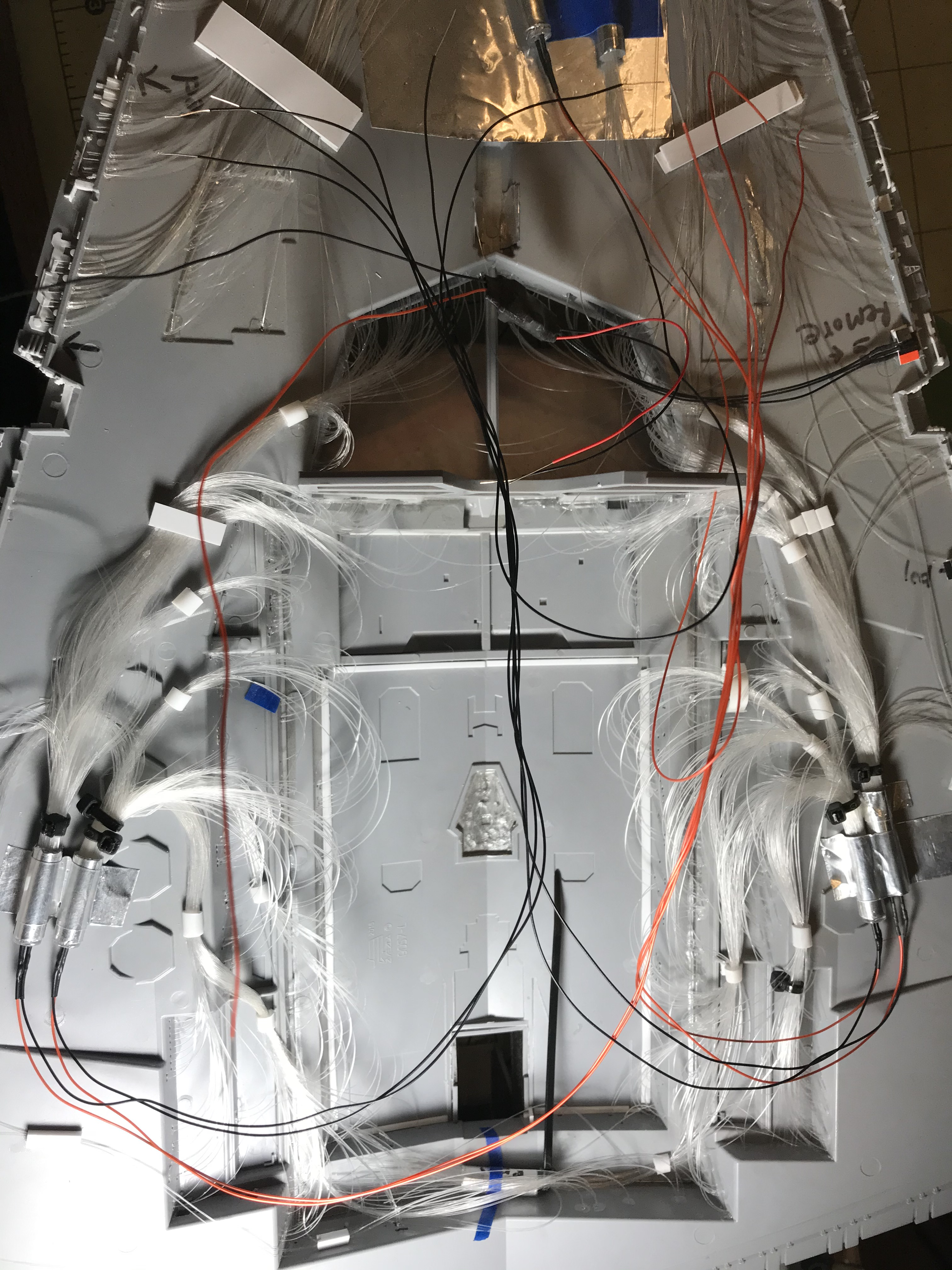

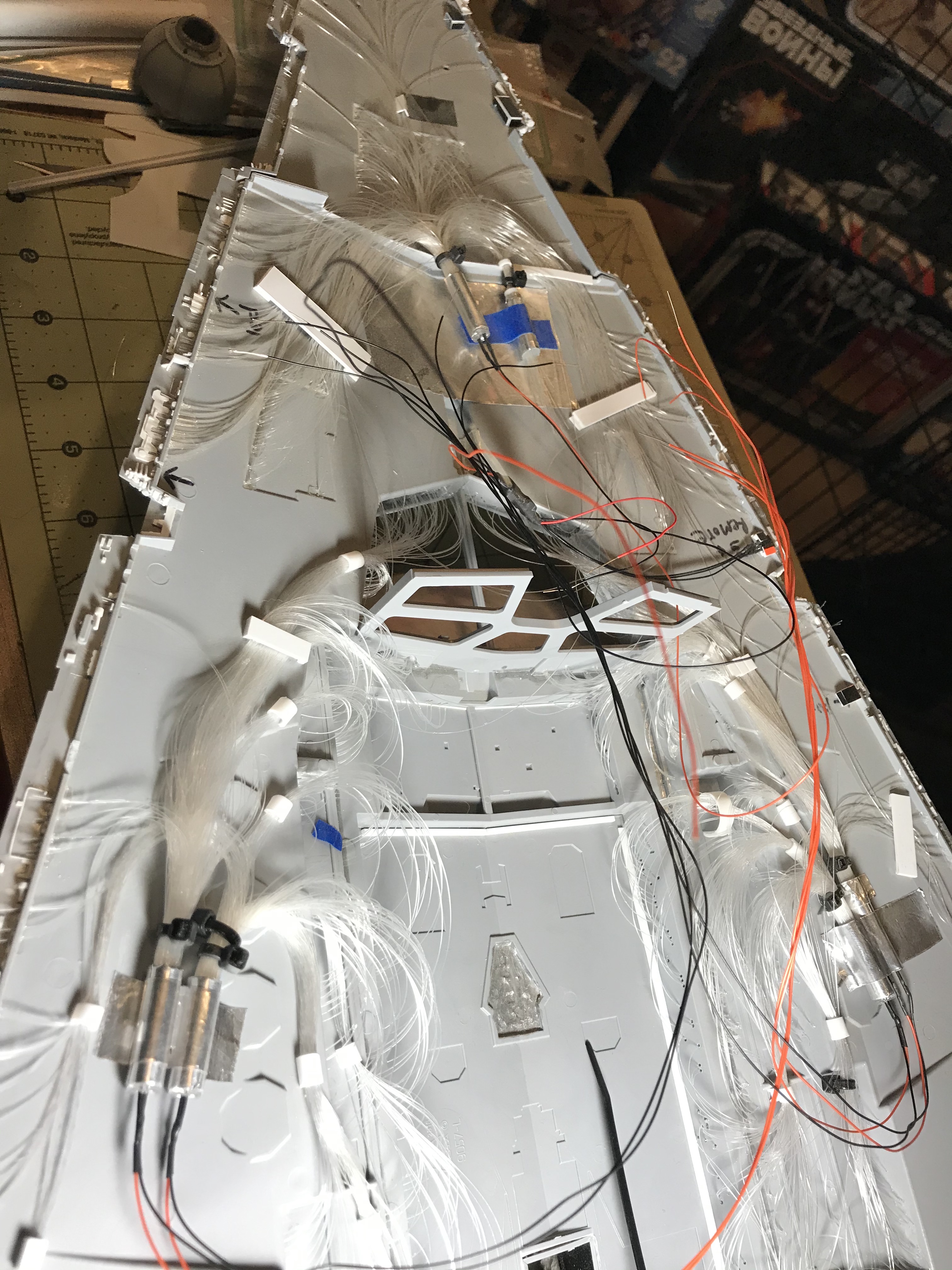

Fiber is done. Wiring and LED placement with remote is mostly done. I still have to create an umbilical to attach the top and bottom halves to the remote sensor which then goes to the internal battery pack, which is not shown on this shot because I accidentally destroyed the first 3 volt pack in a near total disaster a couple of weeks ago. It melted when a positive and negative wire were touching that I did not notice when moving stuff around to solder other connections. I noticed wisps of smoke coming up out of the model after I shut off my iron - and promptly investigated what it was that could be smoking. Hot wires led to a melting battery pack and I had remove it from the inside of the model out of fear the batteries themselves would explode. It was so hot I had to use a pair of long tweezers to get it out. No damage to the plastic on the model thankfully - just the battery pack was destroyed. A near disaster averted. Ordered another AA battery pack with switch. The learning curve is not one I am relishing.
But the birdsnest of fiber and wires is not pretty on the inside - but it works, so I am happy.

How many strands of FO did you end up with? Mine was just over 1400

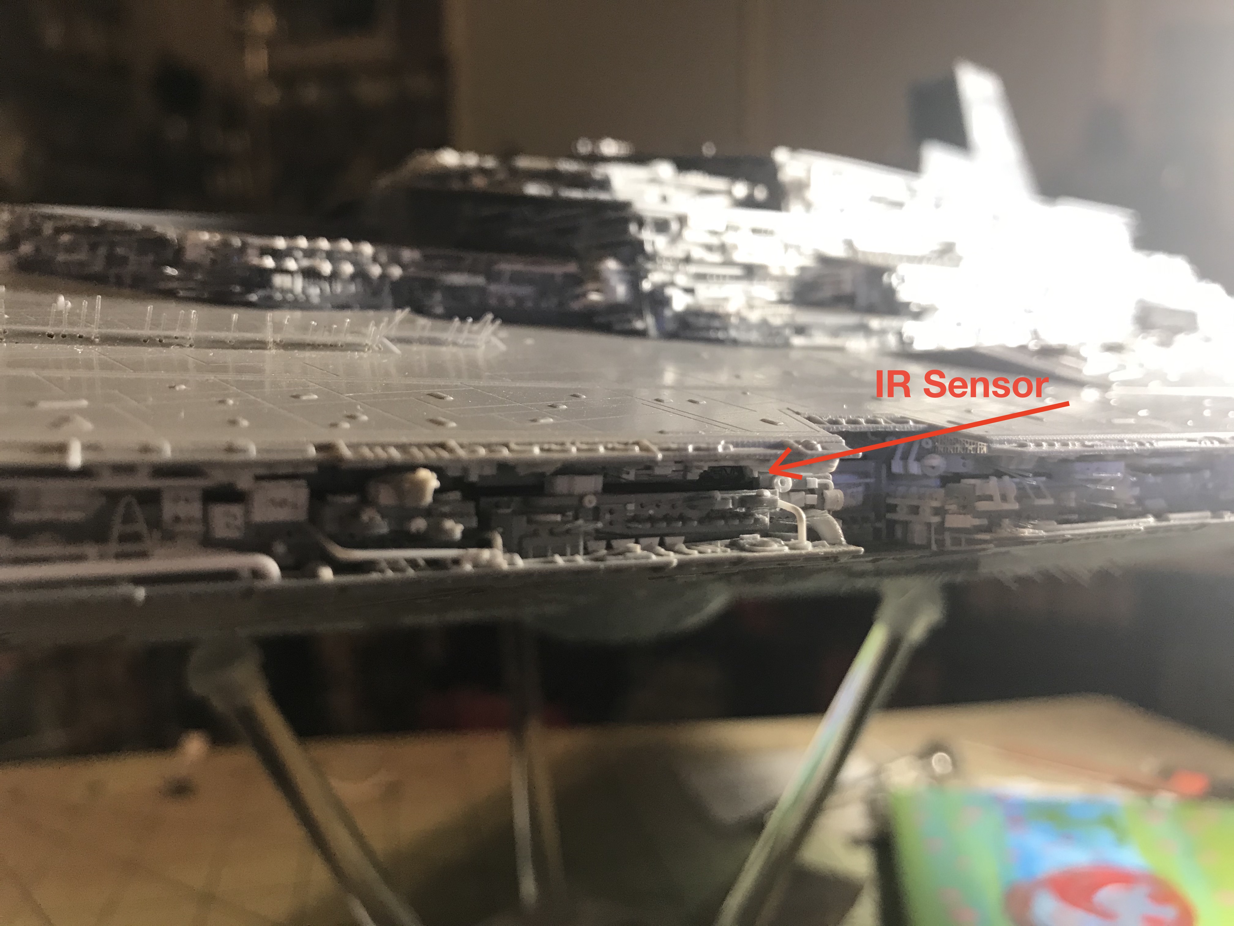

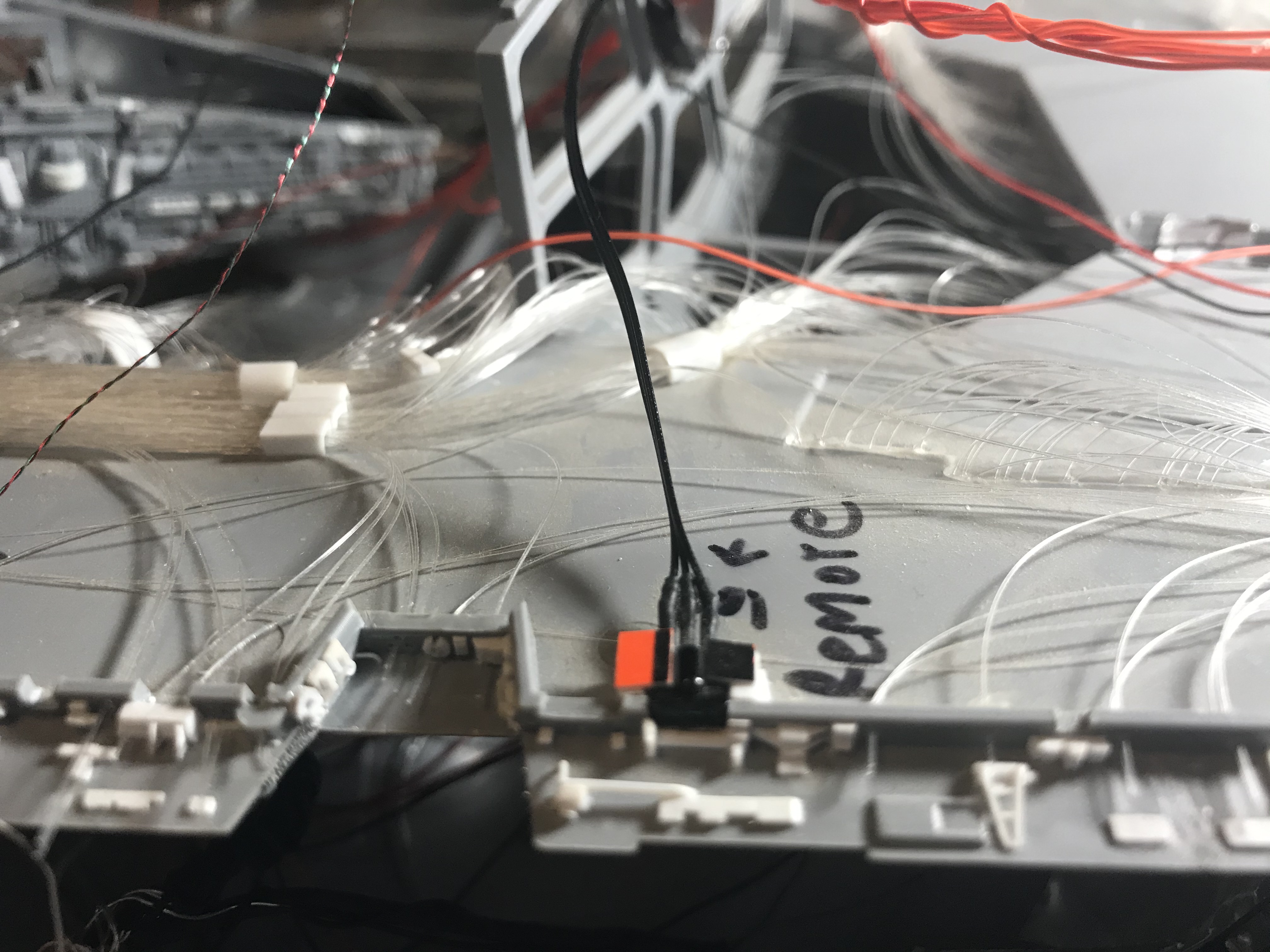

I had drilled probably close to 2500 .030 mm holes and went through a little over 800 feet of .025 mm fiber. I have 48 LEDs total inside. I have multiple tubes for the fiber with .5 mm LEDs at the ends and 16 pico LEDs in warm white for trench floodlights and another 12 pico LEDs in cool white for the trench and underside landing bays.
Someone mentioned on another thread that using an IR remote to light the Bandai 1/5000 was how they wanted to set that build up. I am doing similarly with this one. Internally battery powered with an IR remote sensor stashed into the trench greeblies.

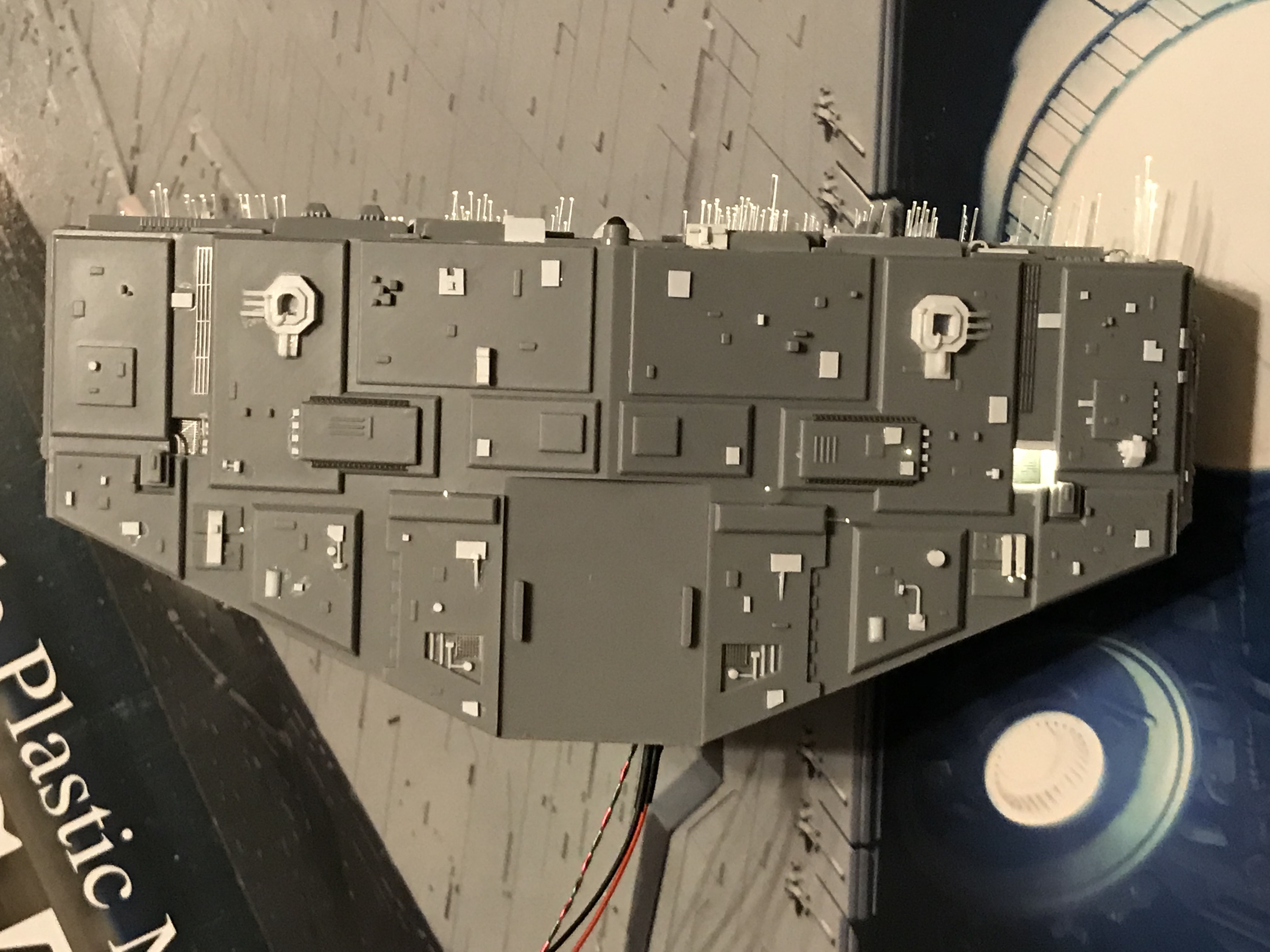

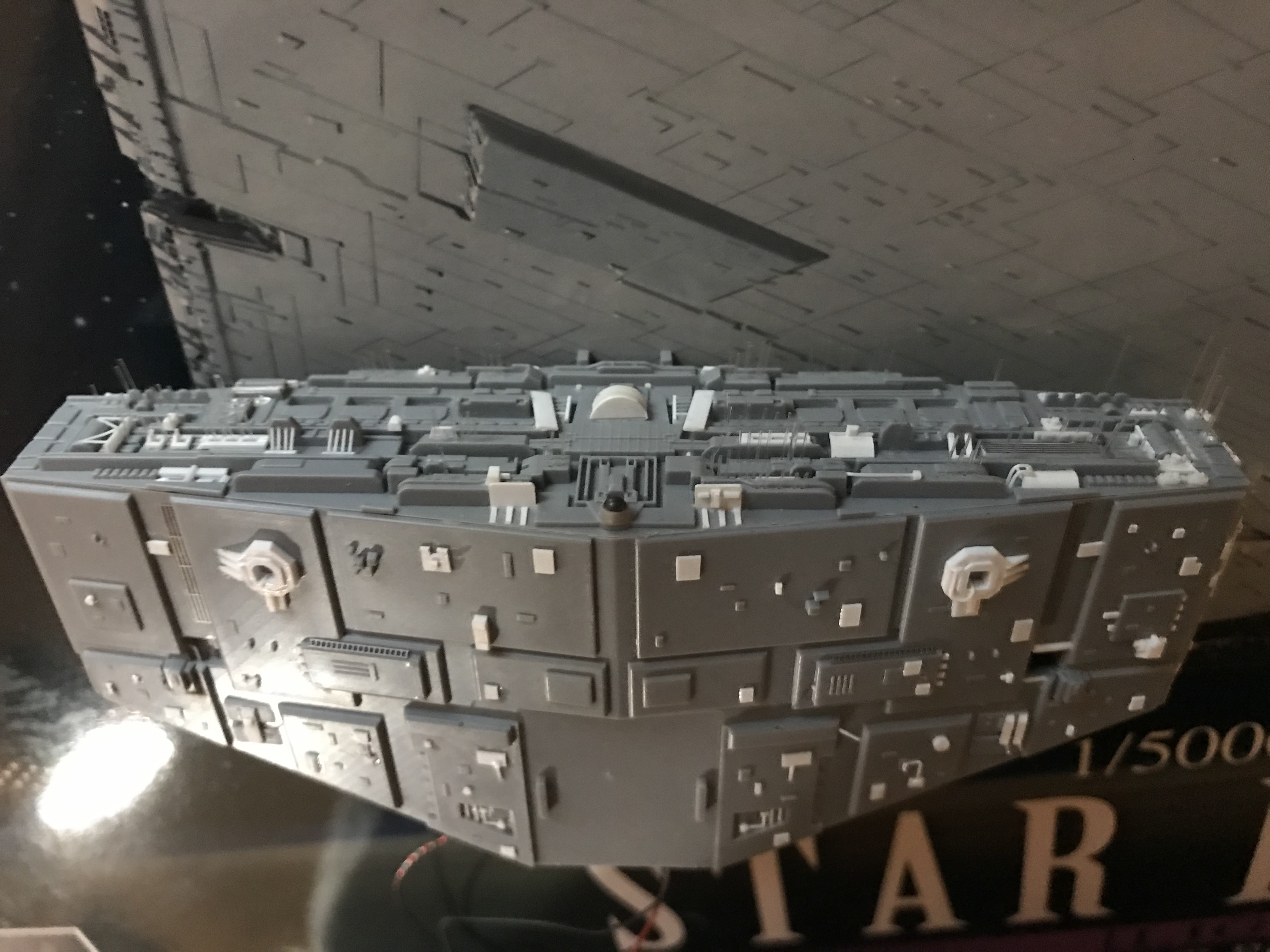

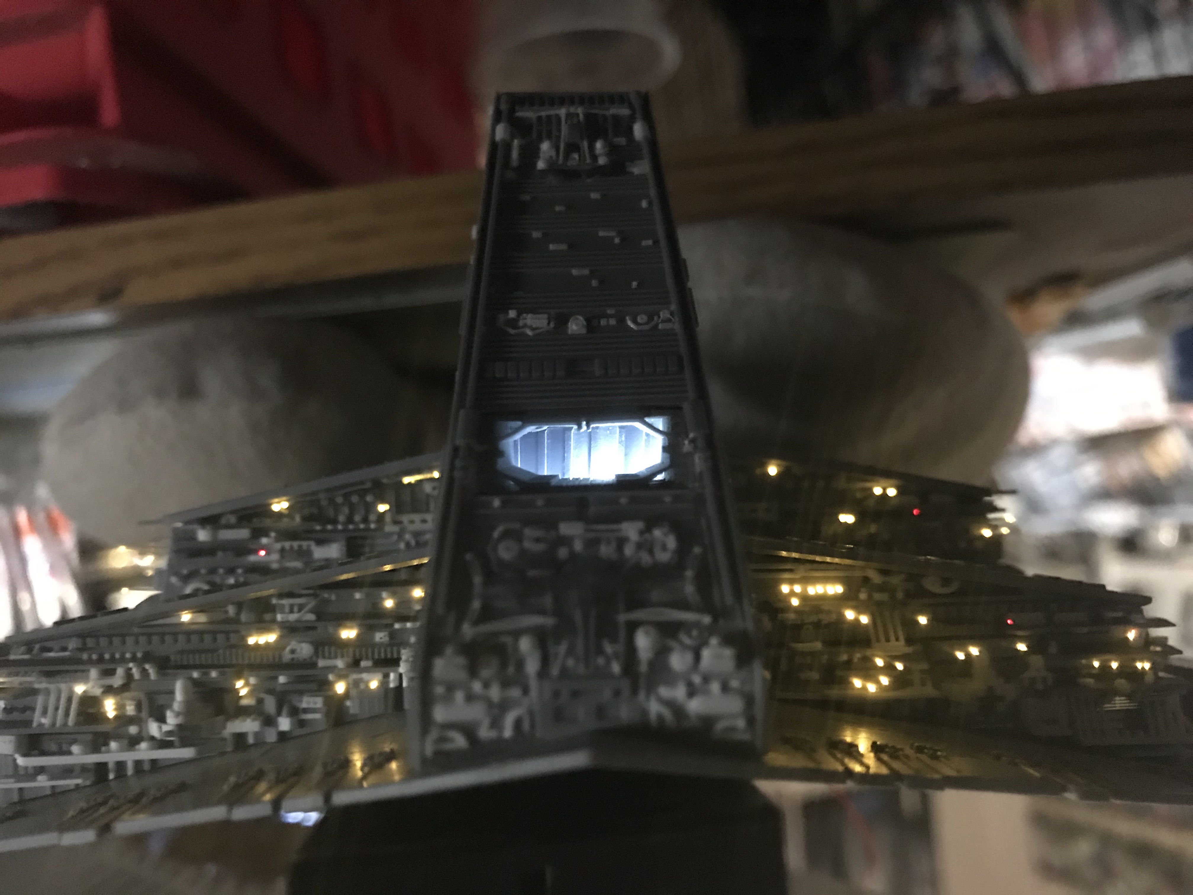

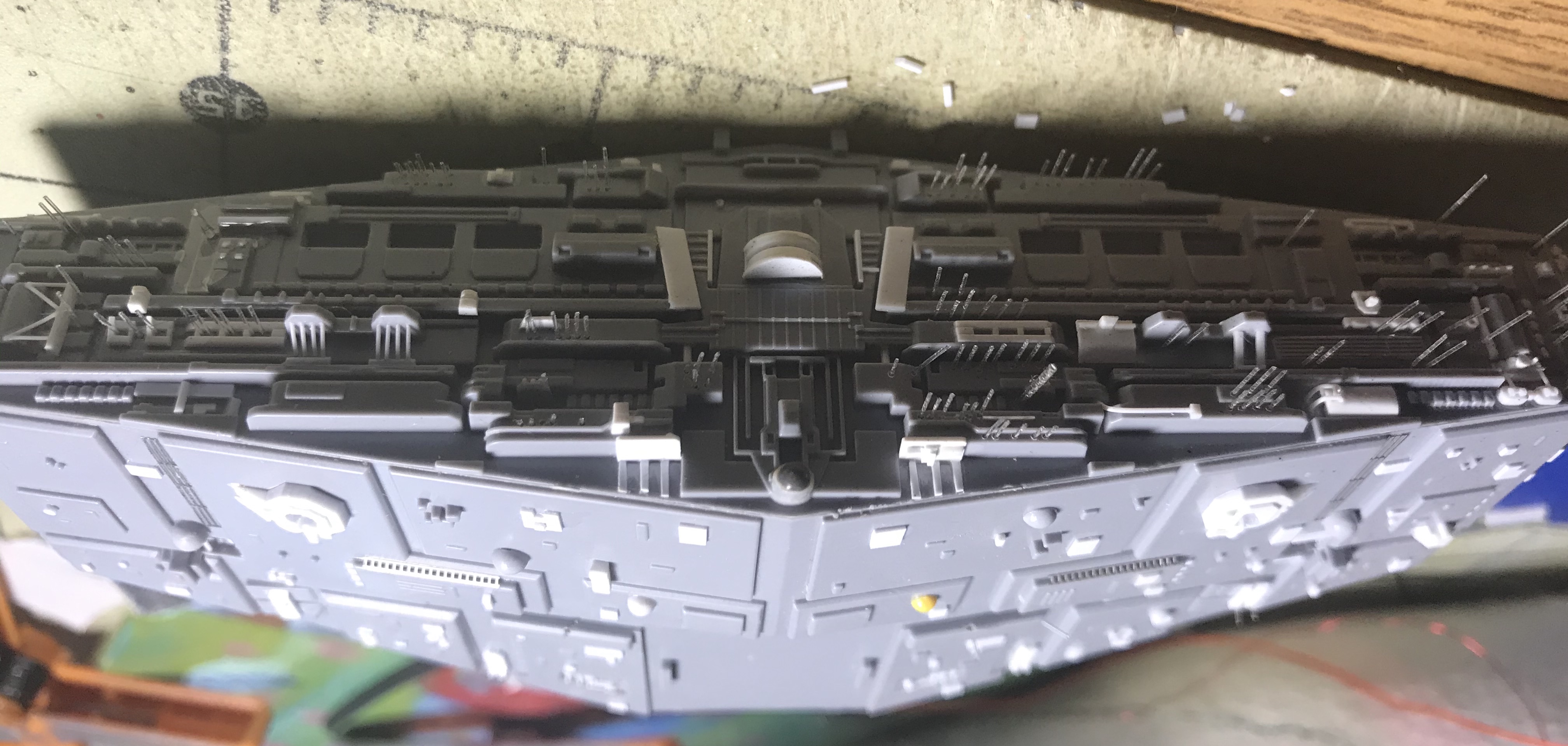

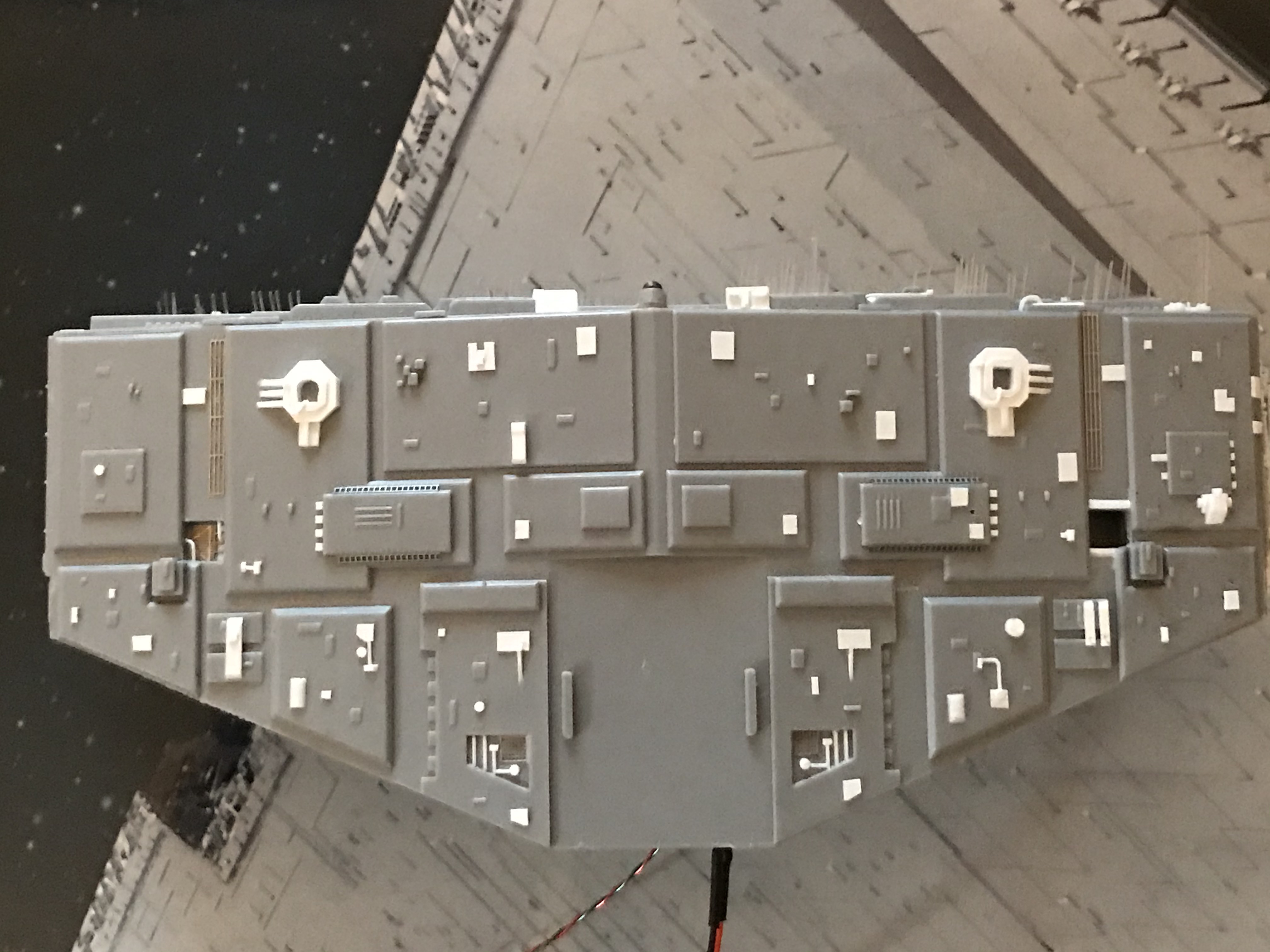

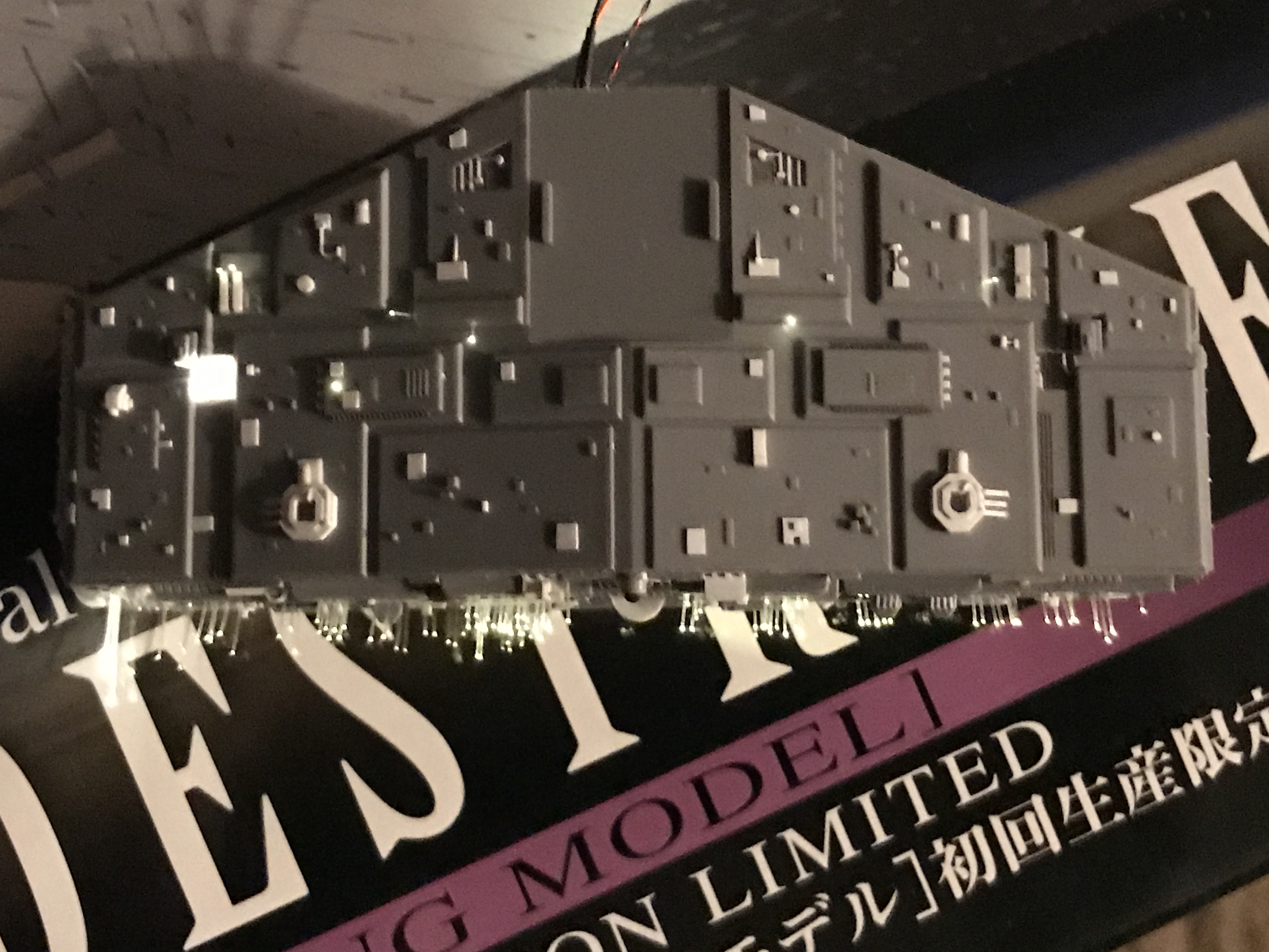

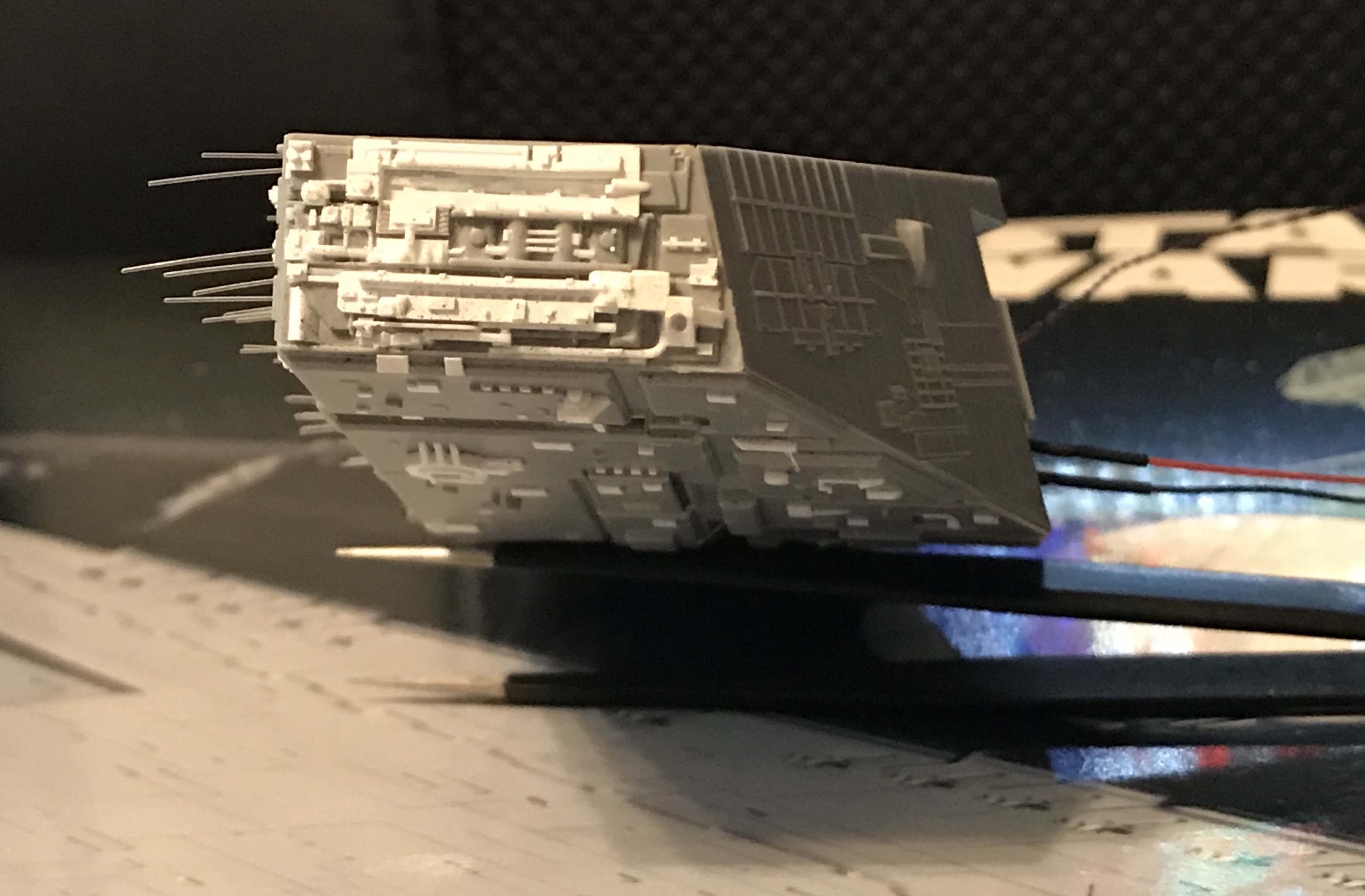

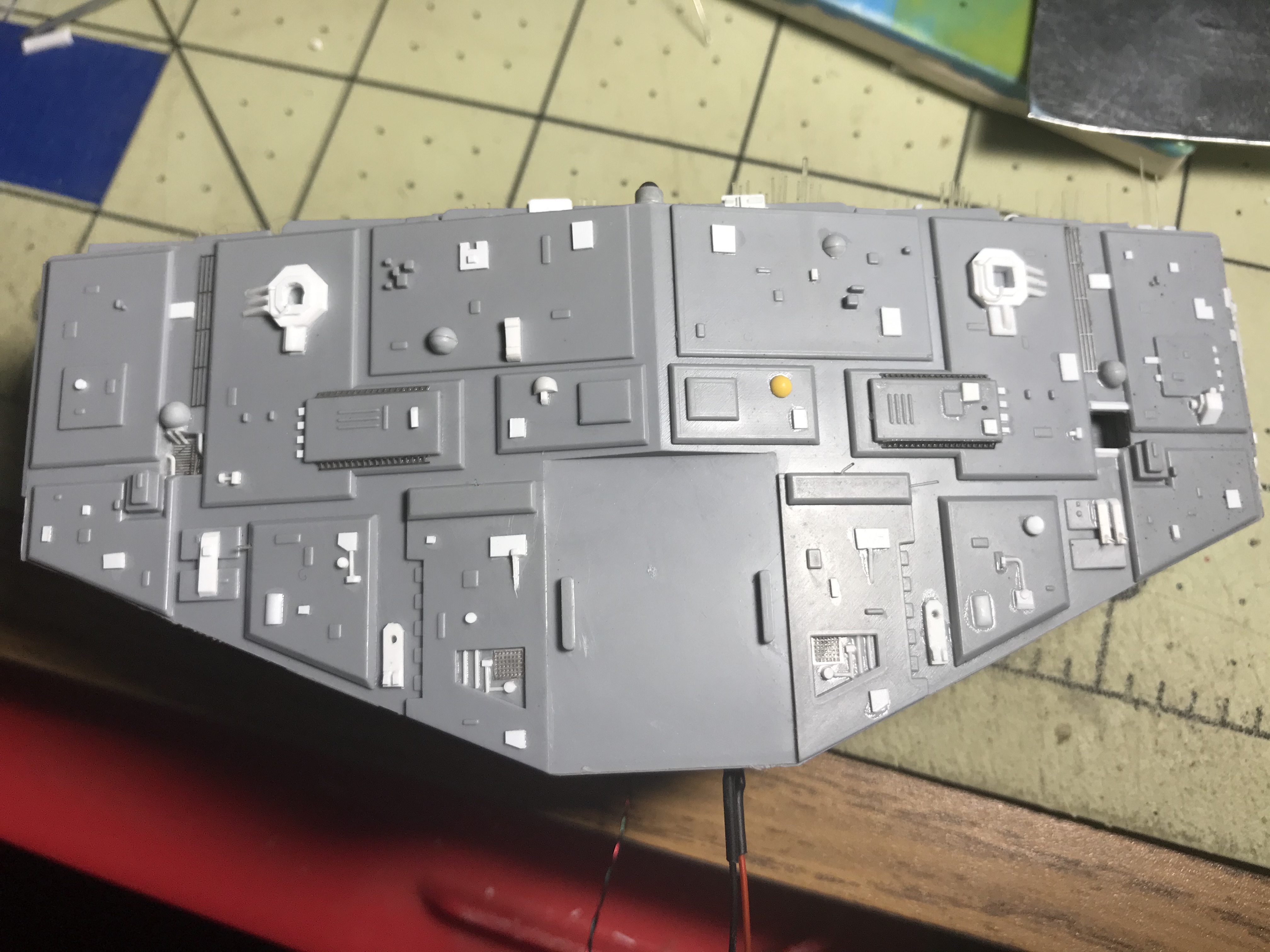

Finishing the fiber and wiring inside the Bridge Tower, I decided that the details on the underside are a bit sparse, so I added some FLIR and DRADIS spheres and some more greeblies to break up the smoothness of the bare kit. Given I had carved in a lit recessed bay underside as seen in Empire when Vader's fleet is first seen, I thought it needed a bit more details.

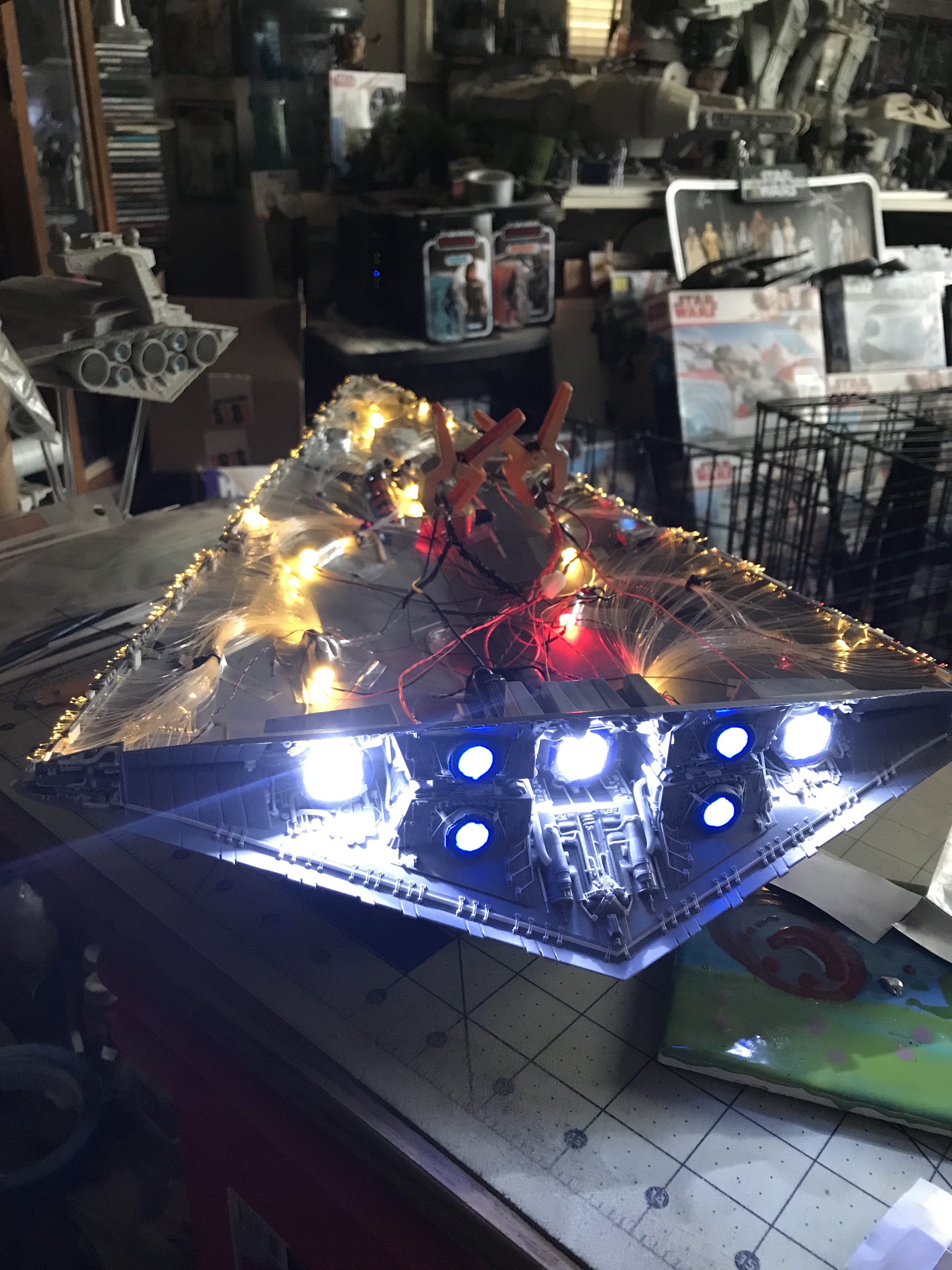

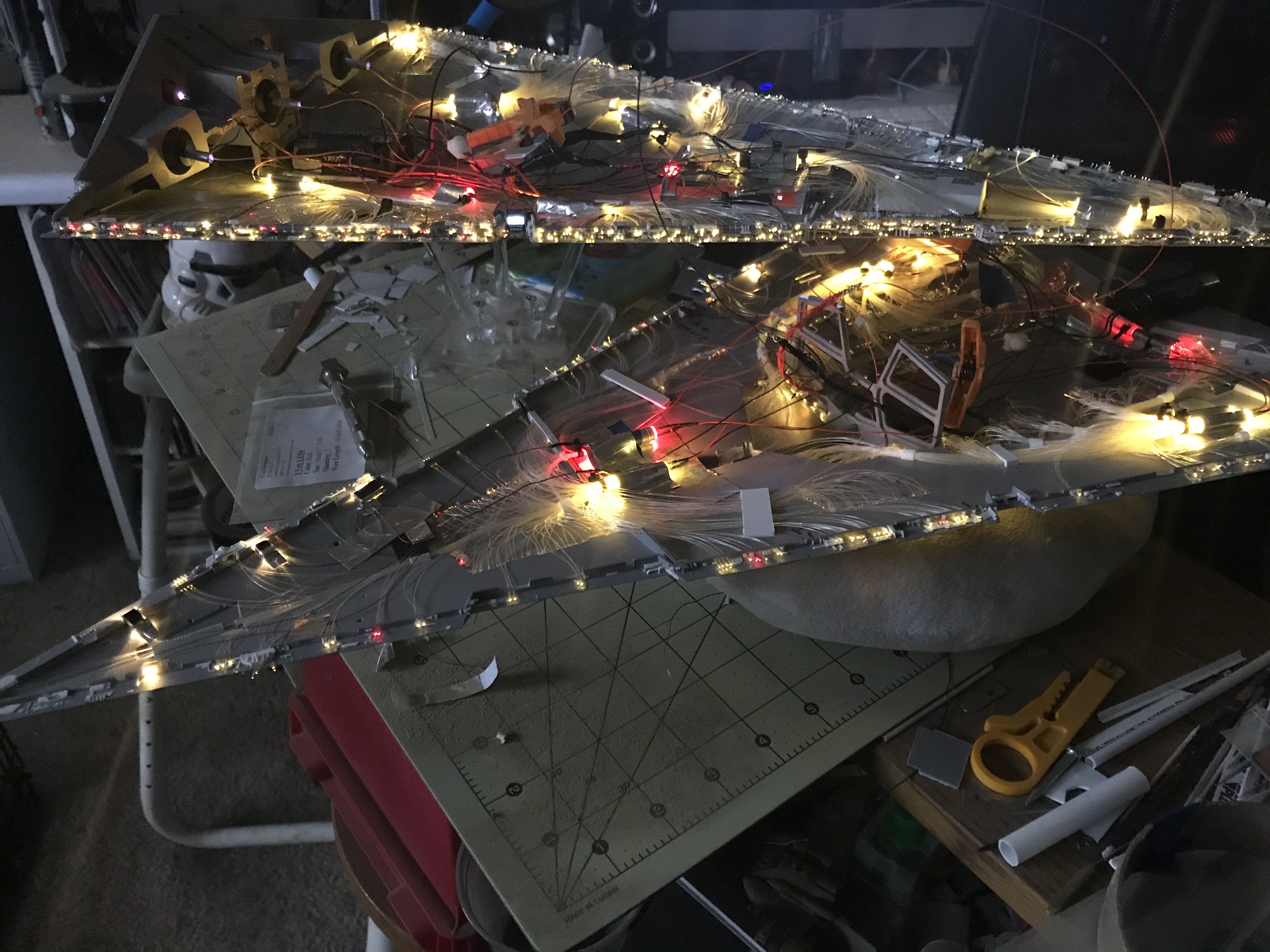

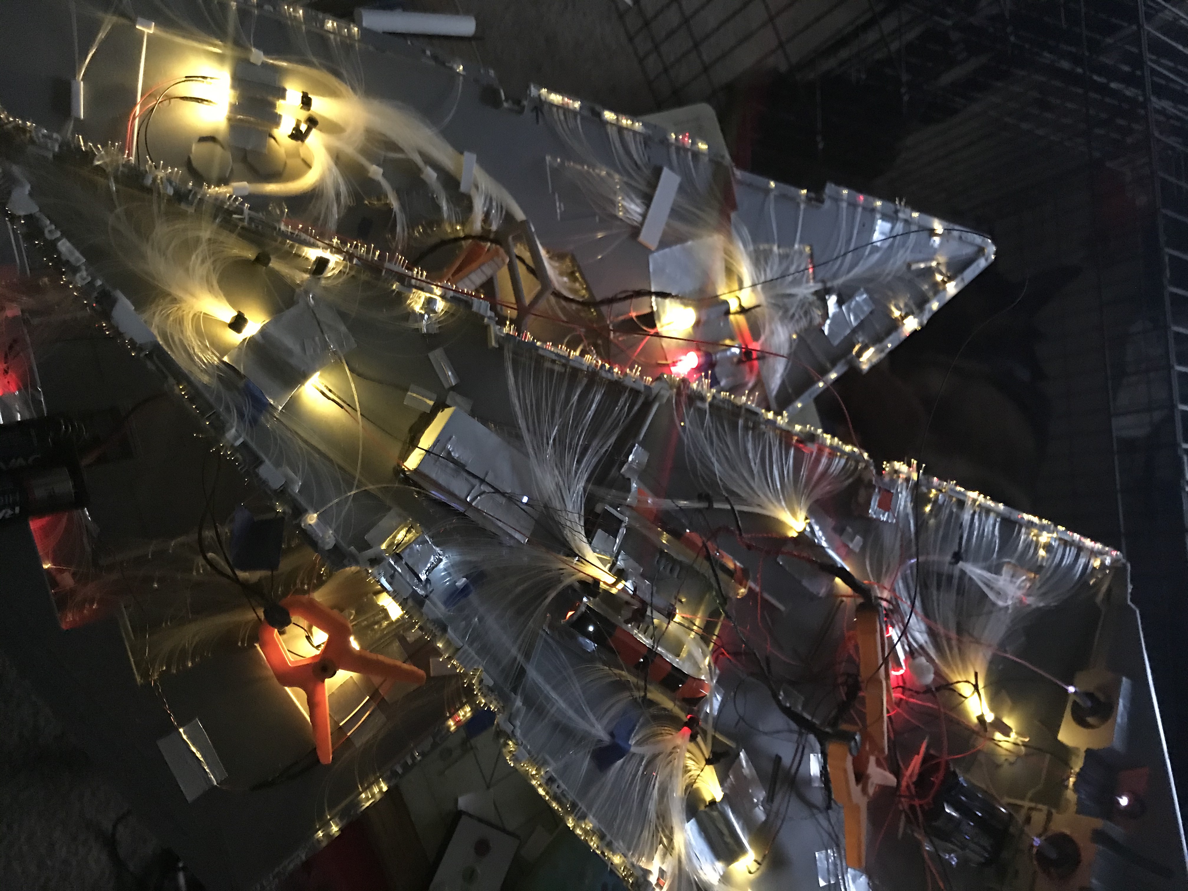

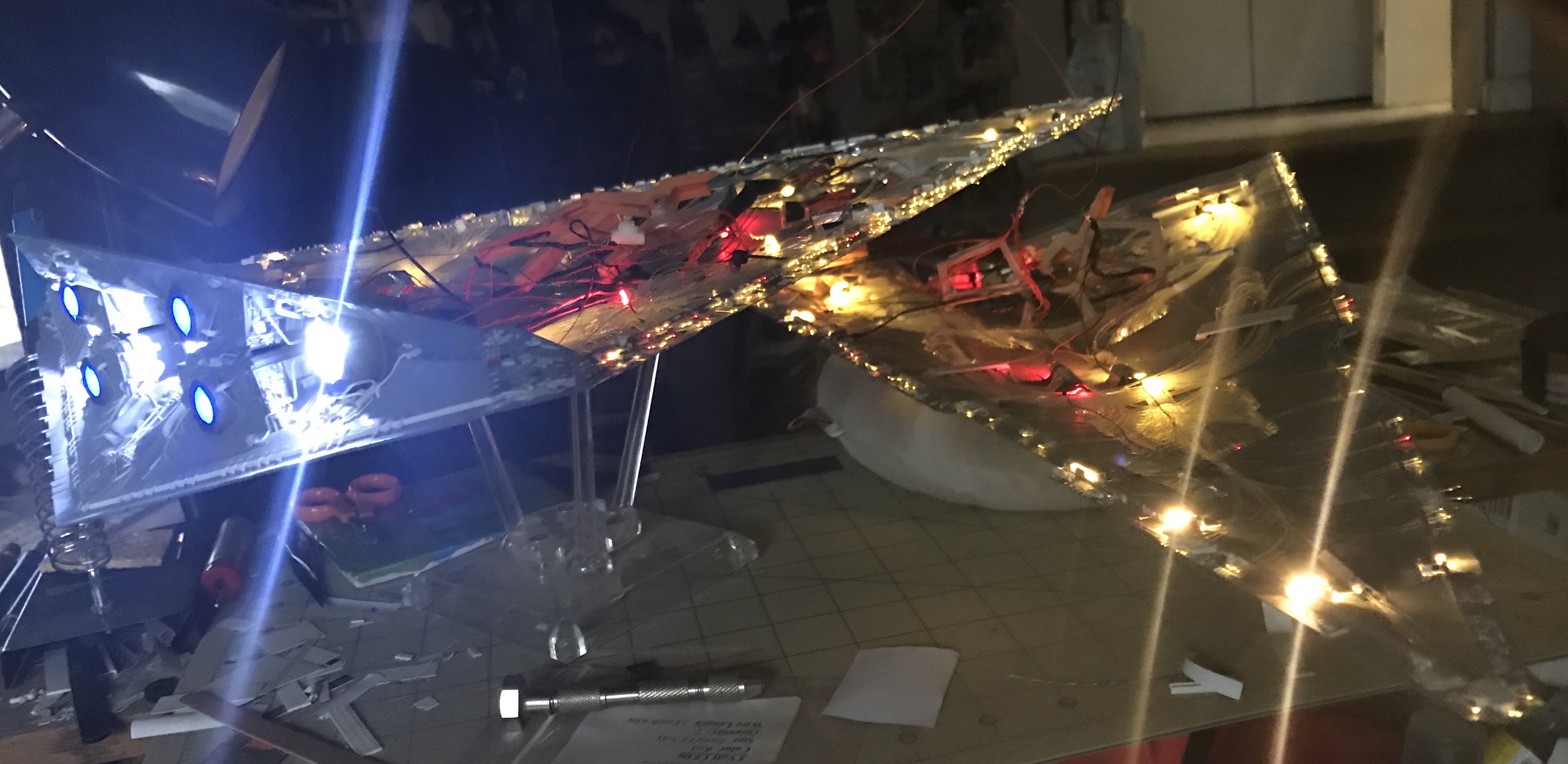

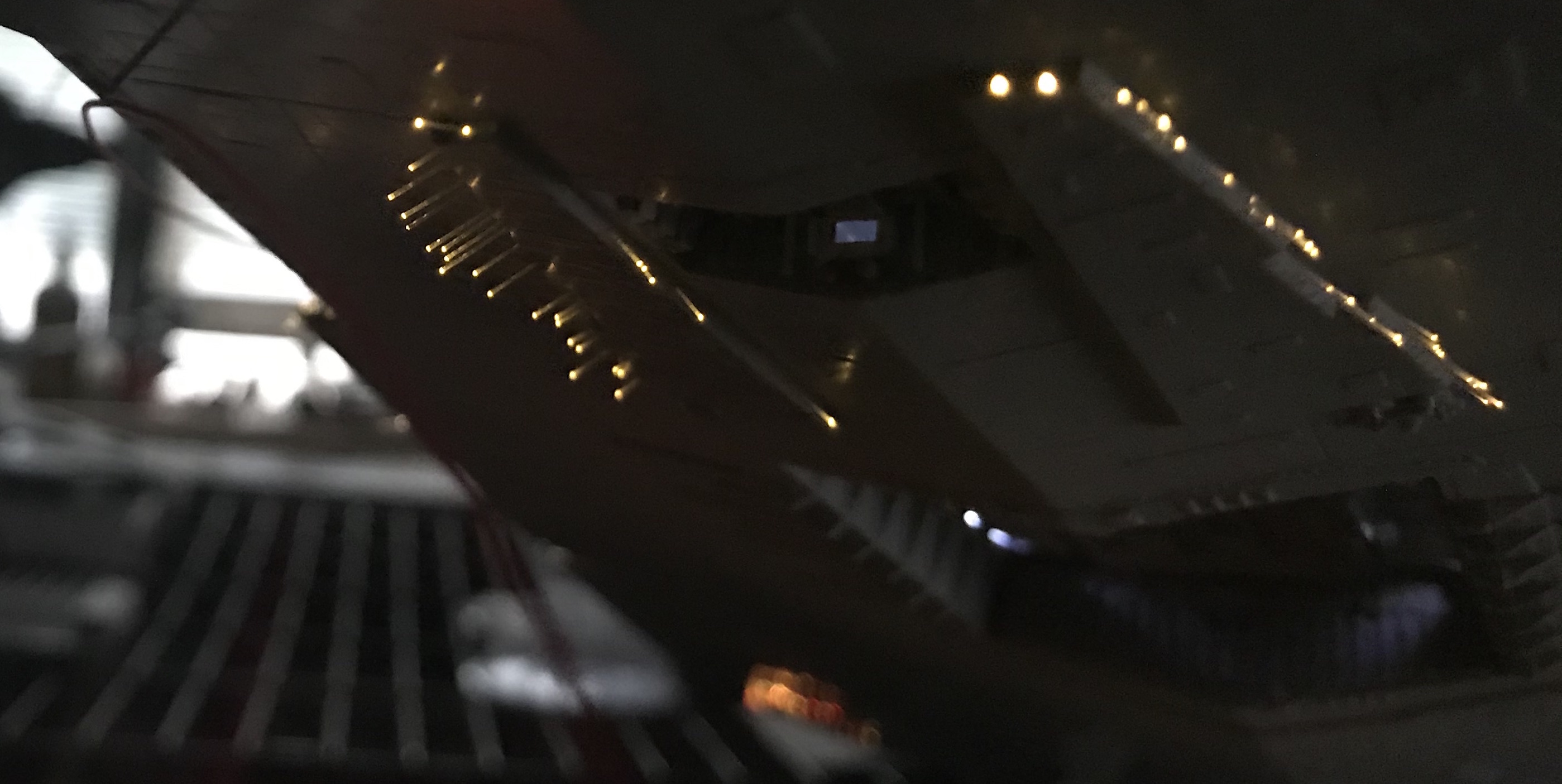

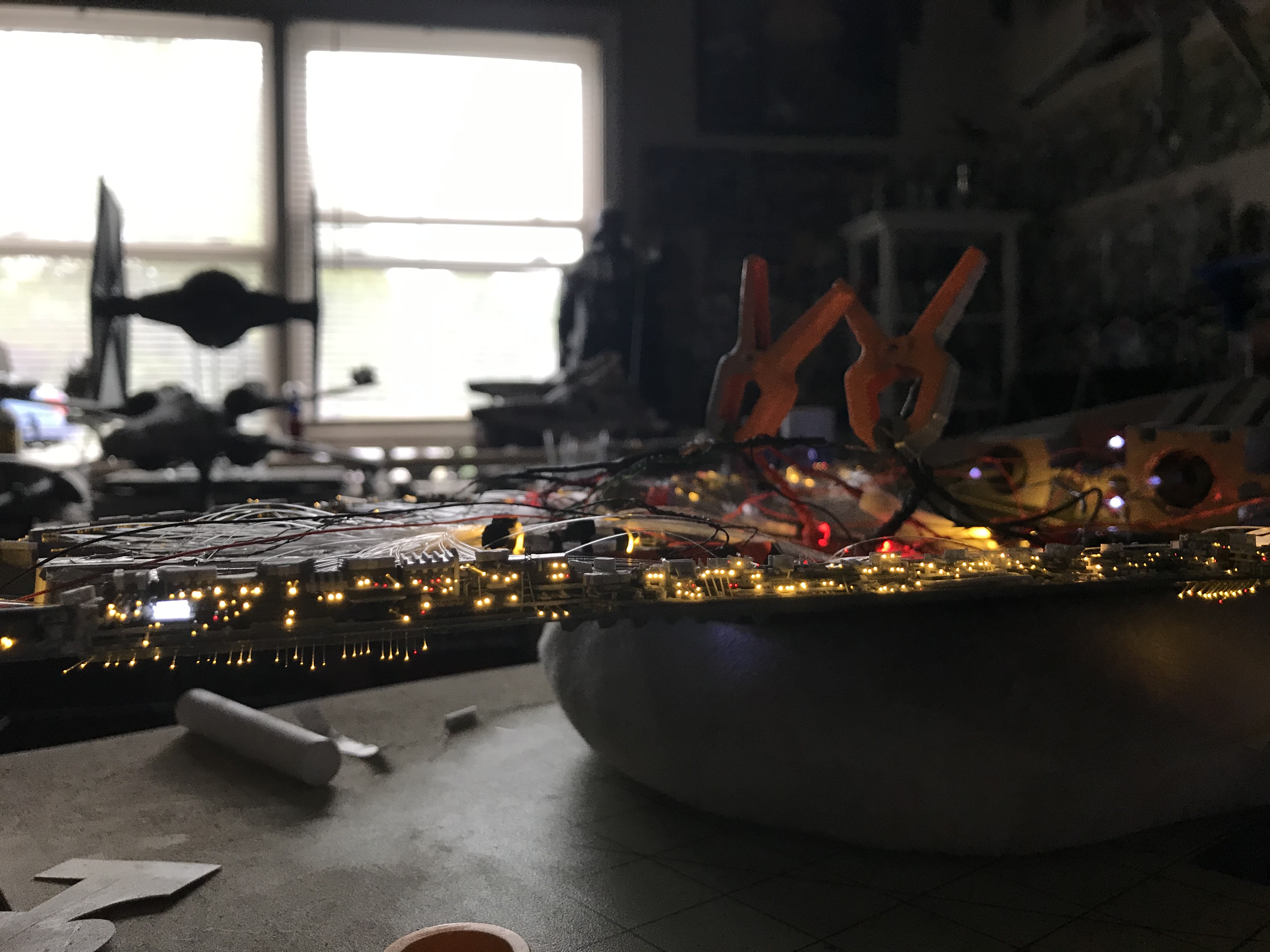

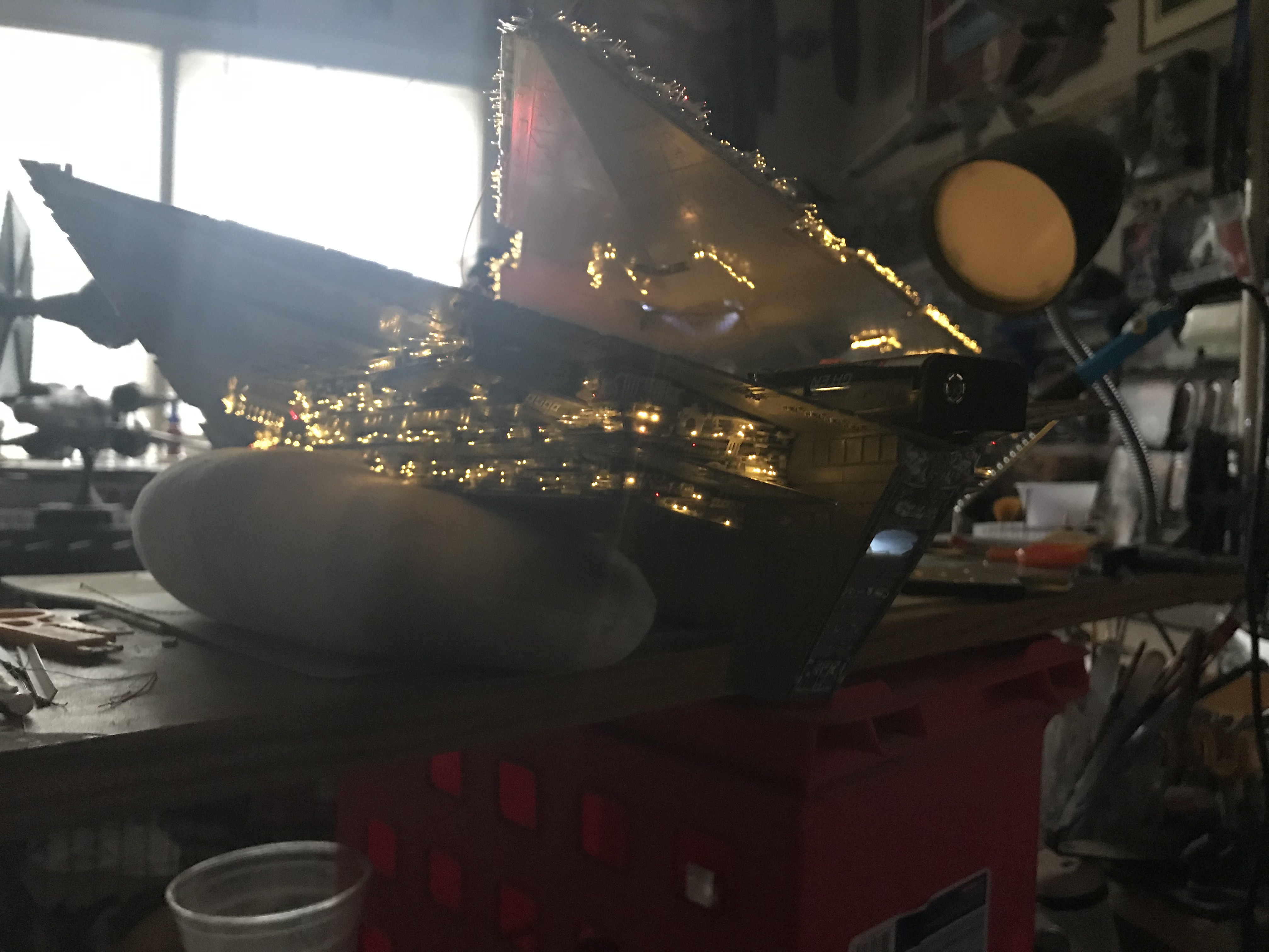

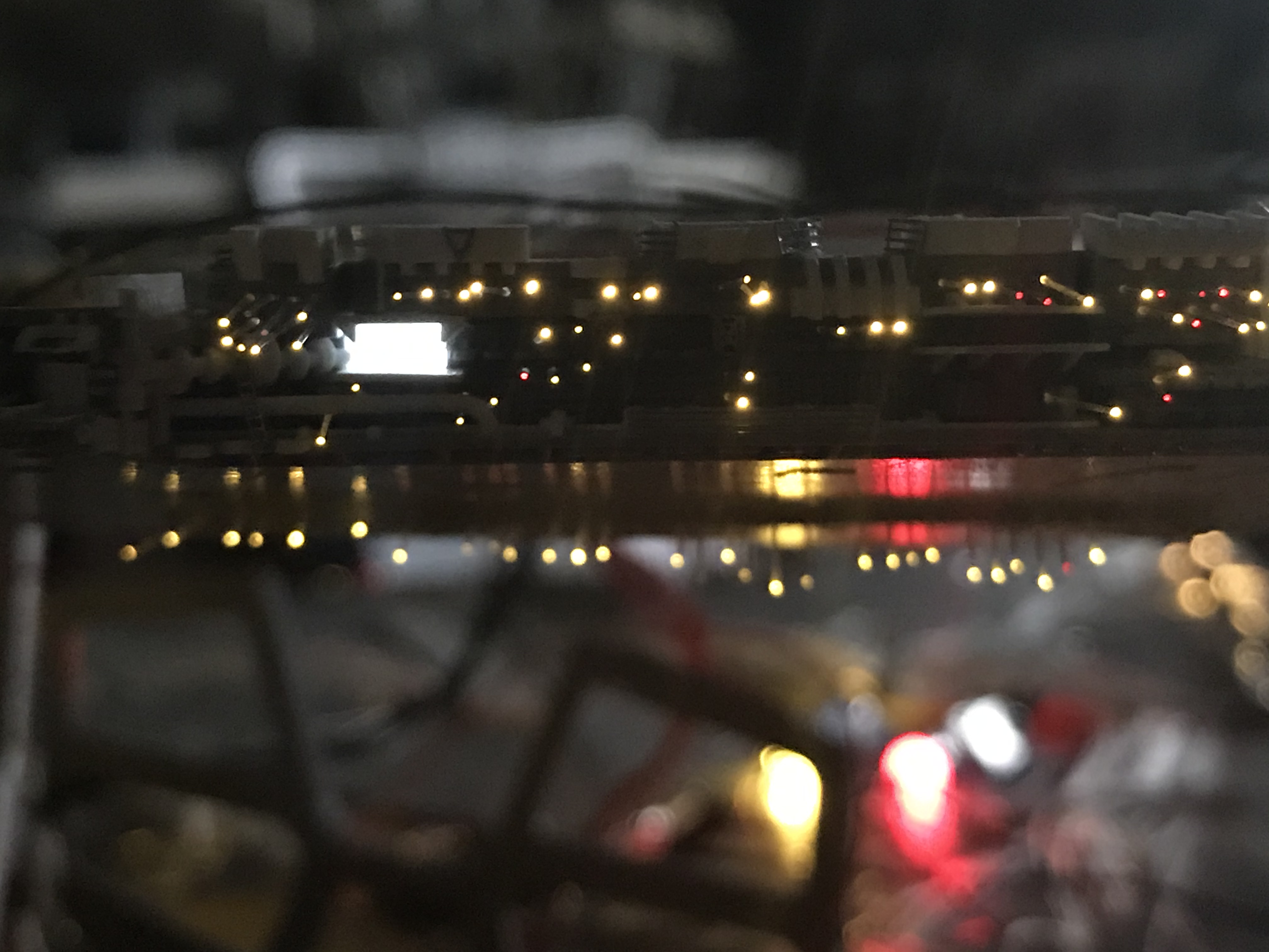

FINAL LIGHT TEST.
All fiber and wiring inside both halves top and bottom hulls are finished, and with the remote hooked up to test the 52 LEDs I have inside the vessel, I temp-hooked up the umbilicals from the top half to the bottom half power supply and fired up the remote - and WALA! I have all LEDs now functioning and lit.
Now... FINALLY - onto masking for her first coat of primer sometime next week. I have decided to prime the model in separate halves so I can properly airbrush primer so as not to opaque-out details in the trenches and bays. I'll then assemble the top to the bottom and add the Bridge Tower before I spray her first thin topcoat of base hull color.
After 3 years, I am finally seeing some light.... literally, at the end of the very long tunnel of tedium.
Final Light Test4.jpg Final Light Test3.jpg Final Light Test2.jpg Final Light Test1.jpg LitBays2.jpg LitBays1.jpg LitBays3.jpg LitChute.jpg
