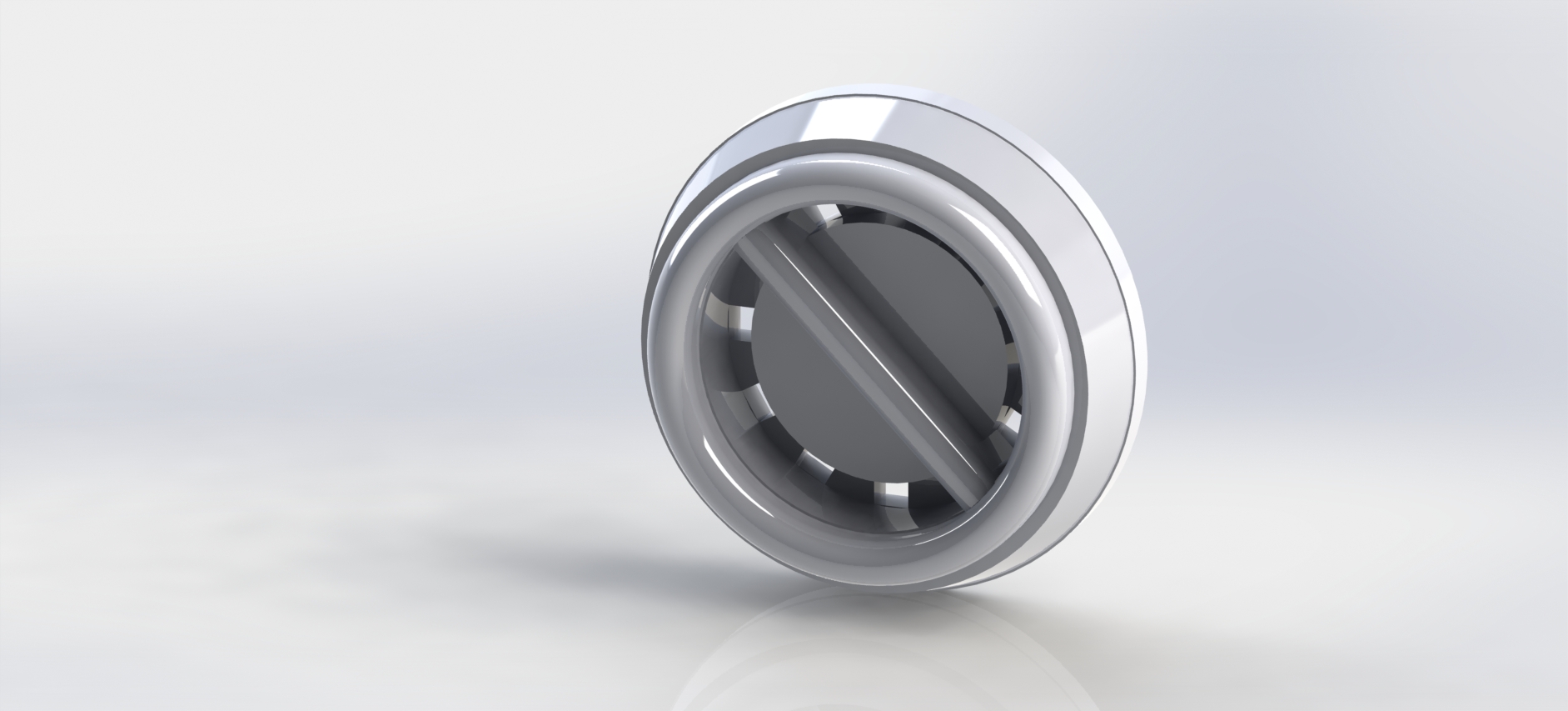

Here's my (very) idealized version of one of the side greeblies. Not too happy with it. May start over from scratch.

Thanks.

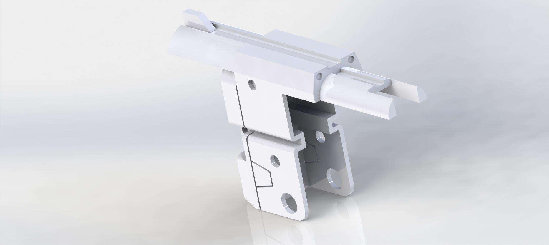

Progress report: Got most of the base of the front end hollowed out. I took the Enfield barrel apart, and I think I can simply re-mount the metal innards in my new front end, without having to rebuild the front end from scratch. That'll make the front half more of a conversion kit, which means I'll be happy not to have to take a hacksaw to the Enfield barrel. Also got the Zeiram gun barrel hollowed out in preparation for 3D printing. I'll need to extend the inner barrel to meet the cylinder, but I can figure that out with a new assembly. Still have yet to make plugs and holes to mount the front, bottom 'barrel' and greeblies. Upon reflection, I'm still going to need a solid part for the top break latching mechanism, so maybe the front end base is not as done as I thought it was...
... And I need to source some screws...
Here's a render of the new, hollow front end. Still working on it.
