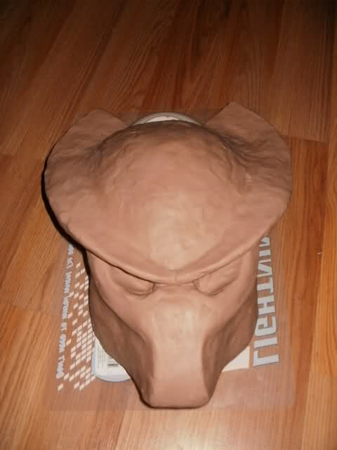

That said, here's what I did:

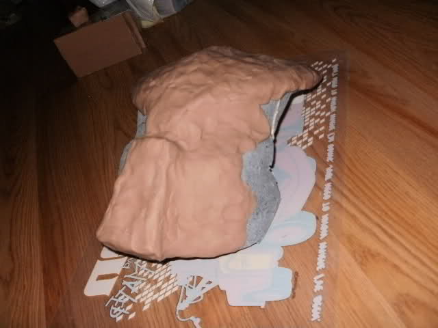

I had a pepakura build on the wall I dind't really like too much but it fit nicely over my head
so I started laying clay on it and smoothing it together.
The goal at this stage was complete 1/4 inch(ish) coverage and only a very basic feel of the shape I want.

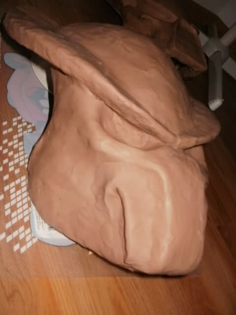

I then reworked the dome a bit since the shape of the armature was nothing like what I wanted for the new bio
and I added some flares to get a feel for the right direction.
I lowered the the flares' angle and reworked the proximal corner of the browes.
The eyes weren't quite what I wanted so I changed them to a slightly more almond(ish) shape and smaller size.
I later decided the flares could still use lowring but not in placement.
They're getting built on the inner edged where they attach to the dome so they can have a decline as opposed to the incline you see on my other 2 sculpts.
Next I plan on finishing the flare reworking and giving some more character to the currently 2D looking mouthguard.

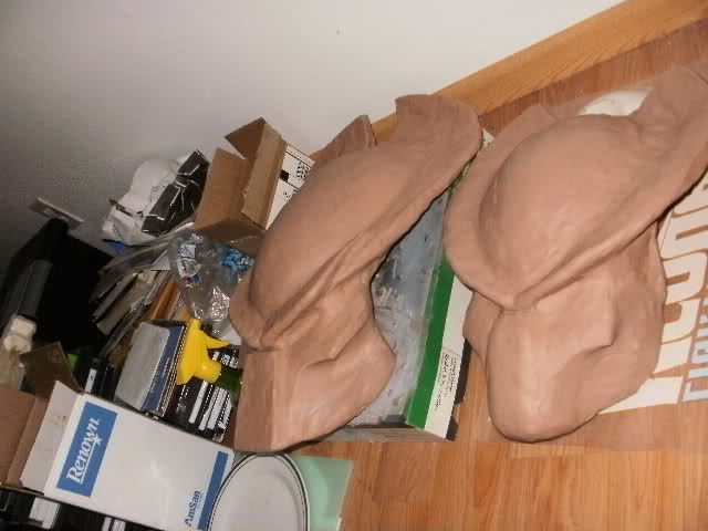

If you like this, my other 2 are here: http://www.thehunter...__fromsearch__1
I appreciate feedback on the direction of any of these.

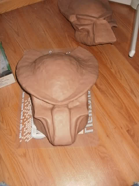

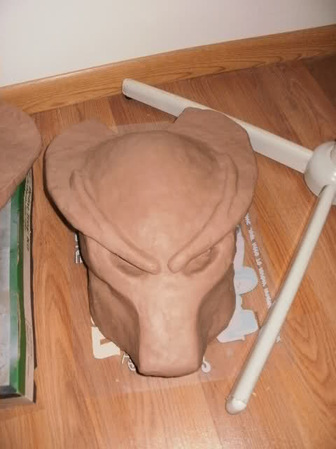

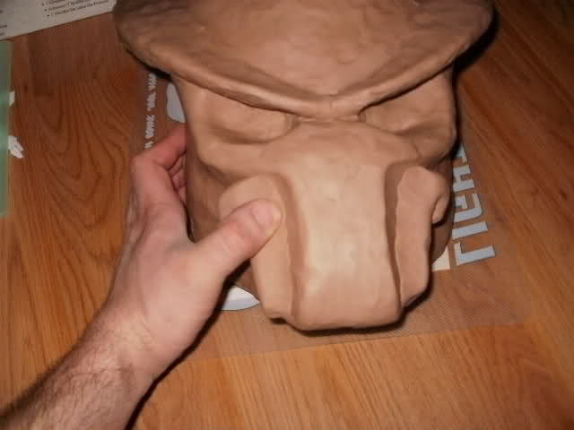

Alright, I've done 2 big changes and when I say big, I mean almost totally rebuilding some areas I wasn't happy with.
The first was the flares. I didnt like the placement so I cut them almost completely off and repositioned them lower down the dome and filled the missing areas afterward.
Notice the change in brow angle.
While I was at it, I decided to build the mouthguard forward a bit so I could thin it down as my armature was wider than the look I wanted.
A couple days went by then I decided to go with a similar look to my other 2 with the pointy cheekbones (apparently becoming my signature)
and a different mouthguard look.
Here I'm making theye sockets deeper and lower.

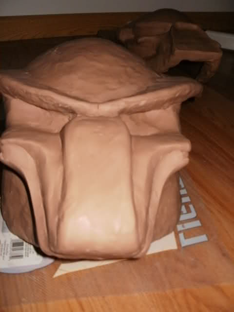

Next I've smoothed them out a bit and am making the line down the cheek to the teeth.
I'll show the progress step by step from adding the material to smoothing in to changing the shape.
Next I'm making the cheeks pointy and adding a cnd vertical line behind the 1st.
I may or may not keep it.
This goes to prove one of my popints made last week. Don't be afraid of ruining it with your changes.
You can't make it better without changing it and if you make it worse, you'll get practice fixing it.
Remember YOU got it to a point and YOU can ALWAYS bring it back to a similar point if need be.
Just keep a practice sculpt or pictures of your progress for reference.
Fayne
Hmmmm. Maybe I should flatten the 2nd line down a lot especially at the top and curve the cheek points down, soften the point and fill-in the undercut just a bit.
Oh another tip while I'm thinking about it. Use both hands in the same way at the same time whenever possible to keep it from losing too much symmetry.
I rub the clay a little to warm the area for a few seconds then push from 1/64 to 1/4 inch thick areas at a time. I move less per pass when I'm just resmoothing it. After it's in position and warm, I push from different angles, sometimes blocking the other side with another finger or hand so things go into position then I lightly smooth it out and let it sit to harden at room temperature and get some strength before I rework anything near the area.
Fayne

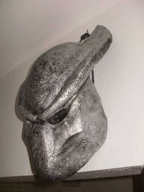

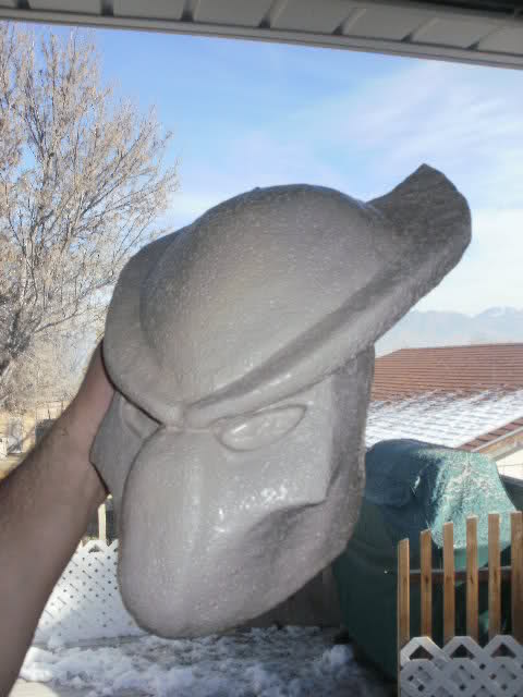

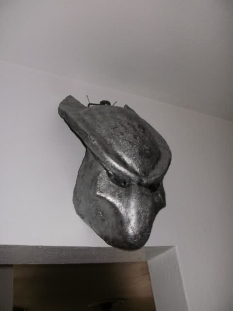

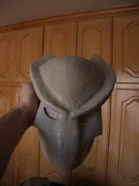

It's time for an update as well.
I've made the mold and mothermold though no pics were taken durring the process as I could't wait for an assistant and don't like the idea of getting resin on my camera.
Before the pics, here's what's happened since the last update, in order.
I got a small set of styluses from Reuel's art supply for around $3.
They're also used for embossing.
I smoothed most of the sculpture but decided I liked the slightly variable thickness and roughlly tooled look of the flares.
I roughly smoothed the dome but kept some of the tooled look. The logic here was she's been on many hunts and the helmet is weathered.
I opted for no cracks or battle damage on her, but is it because she hunts smaller prey or she's just that good of a hunter and has experienced few losses and no defeats. I made a point, when compared to my other bios (not finished), that she have a smaller less protruding brow, less mass, thinner overall shape, smaller cheeks with less boning, less sunken eyes, and small mouthguard without the trapezoidal shape and large bottom area that makes others look so masculine.
Although her eyes are set closer to the surface, I made a point of digging the sockets very deep for an easy guide when cutting them out and less margin for error.
Once I was happy with the overall shape, Which I changed many many many times, I tapped and poked the surface with the styluses somewhat randomly for hours. It seemed like forever and I felt like my wrists were going to fall off by the time she was done. Also note that every so often I'd texture an area only to lighly smooth it and retexture to add depth and variety to the piece. You'll notice the lack of lasers. I thought she'd be cool with the visual confirmation portion of her tracking system intigrated with the cannon. This doesn't (necessarily) mean I'll make such a cannon but it helped to keep her shape very thin and feminine which was part of the purpose of this one. Now onto the pics of the rough pull I did this morning.
