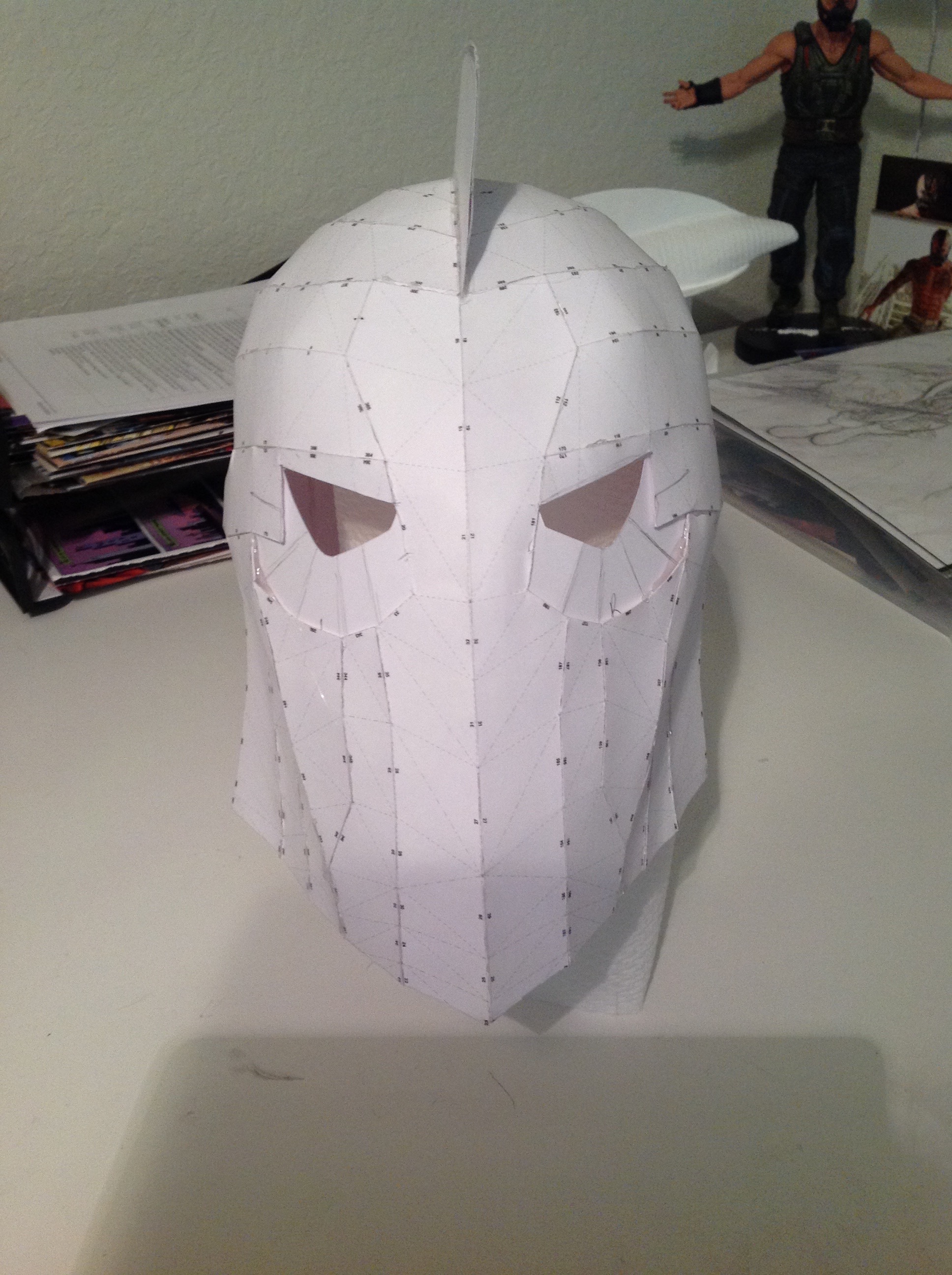

The first thing I started with was the helmet. It’s one of the most crucial parts of the costume and I figured it would take the longest. I decided pepakura was the way to go so I downloaded just about every pep file of the helmet I could get my hands on. I started by making Dung0beetle’s Helmet of Fate but it was way too small and I wasn’t in love with some aspects of it so I decided to forgo scaling it up and instead turned to a JFCustom pep that was moved by Blaxmyth. This thing ended up being huge (maybe it fits larger, masculine heads?) but it was something I could work with. I decided to do some major edits to the helmet starting with cutting off a lot of the front and back which were just too long for my face. The eyes were well below where my eyes actually are and they were a bit big for my taste so they got an edit. The mohawk part was now to big for the helmet so it was cut down a bit. Finally I played with the cheeks some to give them a nice flare.
Of course now it was time to do the fiberglassing. I got a bit heavy handed with my initial coats of fiberglass and the helmet warped in some areas. I didn’t notice until it came time to do the Bondo but I was able to fill those areas in with a bit more Bondo and with the way this costume works no-one will be able to see it. It’s definitely something I’ll be more careful with in the future. Sanding and applying Bondo was obviously the most time consuming step. As I said earlier, I had hoped to have this costume done long before now but I had to stop working on it for almost a year because my degree program was so involved. Anyhow, now that I’ve graduated I’ve had plenty of time to start working on it again. I finally got the shape right and then proceeded the prime and fill in small spots with filler putty. I swear I’ve gone through four or five cans of primer just building it up and sanding it down. I hope that’s normal. I had a lot of problems with the primer coming out really gritty and rough and I’m not sure what the problem is there.

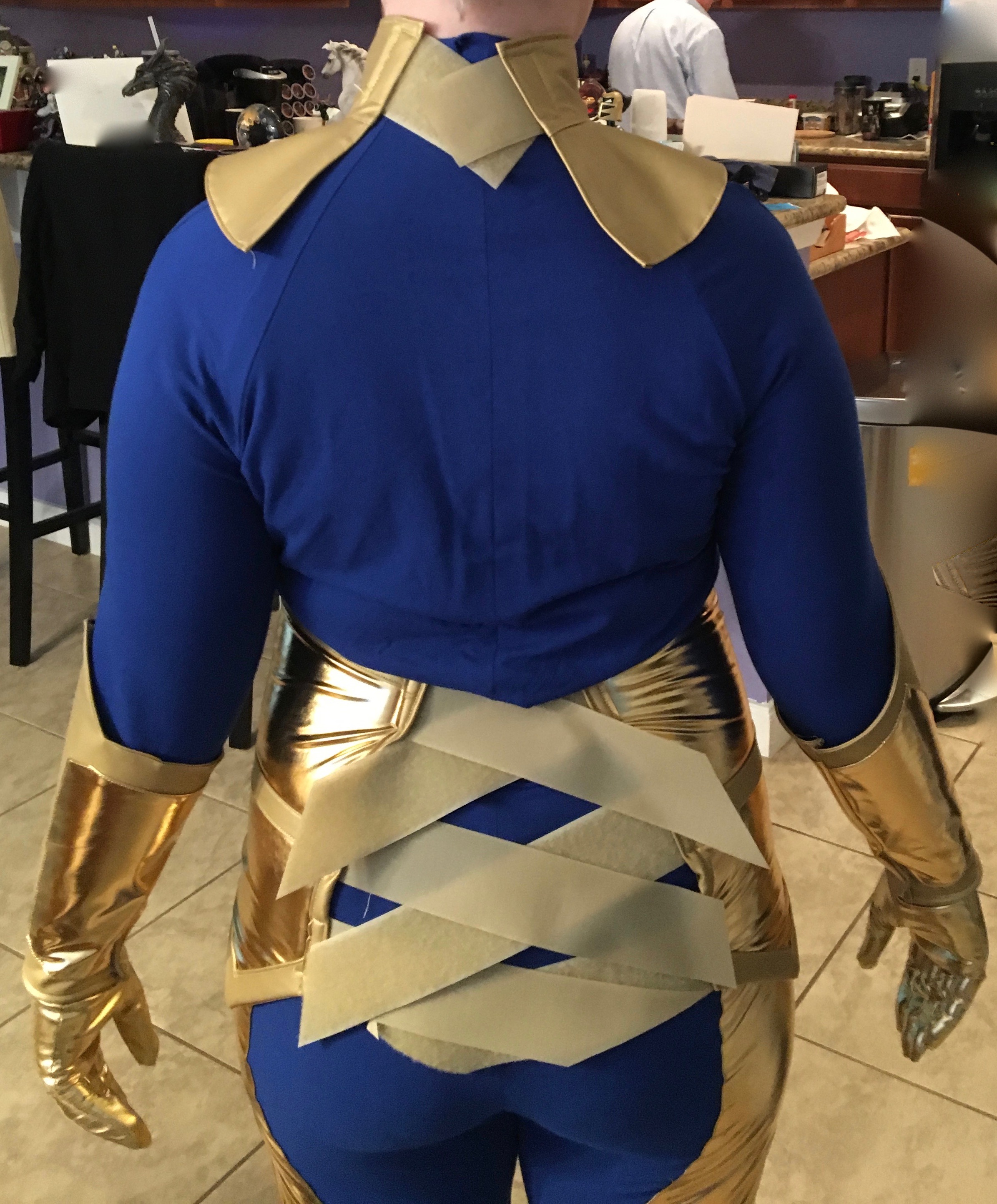

I originally was looking into morph suits for my body suit but I still don’t understand how they expect girls to go to the restroom in those and I didn’t want to take off everything every time I had to go. Unfortunately they don’t make two piece body suits (that I saw, if they do please let me know) so we had to start from scratch. I originally bought a beautiful dark blue black fabric and we made a shirt and leggings. Unfortunately, the patterns we used weren’t fitting correctly and the fabric was far too thick and didn’t feel like it would breath. We ended up picking up a bamboo fabric and new patterns and these worked much better. We altered the leggings so that the waist would come up higher so that it would be covered by the belt. Stirrups were added to both leggings and shirt to keep the fabric from bunching up. Gold fabric was sewn to the leggings (I’m honestly not sure what you would call these pieces but they do appear attached to the legs in the show).
Obviously there was no pattern for the belt so I drew up some rough sketches of the belt on paper and then proceeded to wrap myself in plastic wrap and duct tape and using a sharpie I drew out my right front half knowing that the belt was symmetrical and I didn’t need to worry about the back because it would be covered by my cape. My mom was able to interpret all of these drawings and my duct tape monstrosity and make a pattern that she then quilted (again the interface was used to give the belt some thickness). Originally she wanted to use fabric all the way around the belt but I was a bit worried about the heat and I knew that neither of the gold fabrics breath very well so I suggested we velcro the back up and she created an amazing velcro corset that can be tightened. It worked out really well and gave a nice hourglass shape.
The chest piece was actually made from a leftover pattern from a shirt interface that happened to be the perfect size and shape. I drew up some sketches of how it should look and what lines should be where and just like with the belt, we ended up putting velcro straps in the back so my neck could breath.
The gloves and gauntlets were a bit tricky. I knew I wanted these as separate pieces so I could take the gloves off without having to take off the gauntlets. My mother tried to make the gloves three times but the patterns we bought weren’t fitting properly so she ended up buying a pair of cheap gold gloves online that somehow matched perfectly to the gold we already had (fyi, by the end of the con a lot of the gold had rubbed off the gloves leaving yellow spots everywhere). The gauntlets were made by wrapping plastic wrap and duct tape around my arm and drawing the pattern with sharpie. My mother used this to create a pattern. She used cording around the wrist to create that edged bevel. We put velcro near my wrists to close up the gauntlets.
For the shoes, we used laceless sneakers for a base and a boot cover pattern from a super girl costume. The same stiff fabric interface from the collar was used in the front of the legs to keep them standing up straight. The top back of the boot covers have elastic in them to keep them up and attached to my legs. Cording was added to the bottom of the boot covers so they could be pulled tight around the shoes. Industrial velcro was then added in three strips to the bottoms to keep the covers from coming up.
A lot of velcro and fabric tape was used to hold everything together but I suspect this happens in a lot of costumes. The medallions on the chest and belt were actually tap light covers that I spray painted and glued on.
