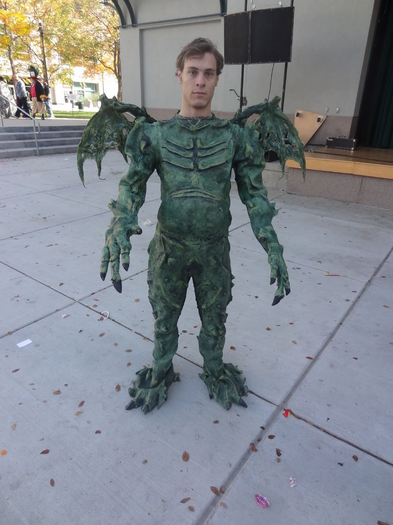

In August, I researched for the best budget-friendly way to sculpt body pieces and make molds for a full-body latex suit. About $300 and 4 weeks of construction later, I came out with this:

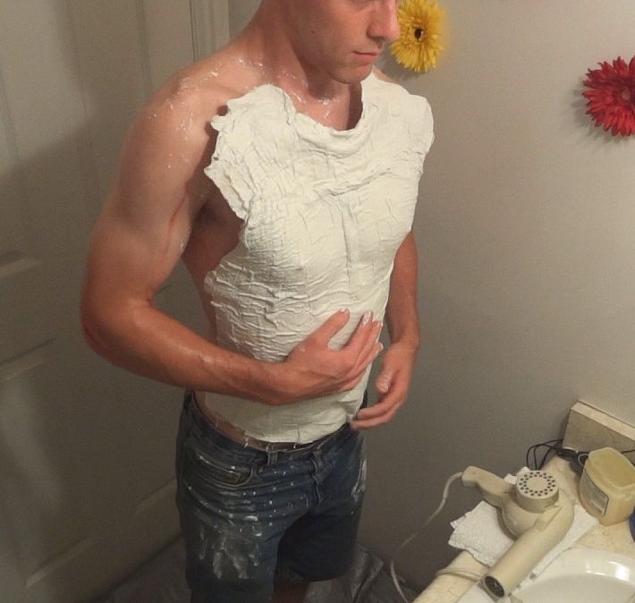

I began by making body forms for sculpting. Considering the size and weight of the body that would have to be made, I created separate pieces for the torso, head, legs, feet, and arms. I molded my body shapes on my own body with plaster strips. This was a quick way to build structures that would be strong, and also be hollow on the inside. I slathered Vaseline on my torso and put plaster strips on the front half to mold it. I couldn't really reach the back half of my torso, so I put the front half onto a duct-tape mannequin, then covered the back with plaster strips. After it was dry, I cut the sides to remove the mold, and then sealed the cuts to make it one whole piece. Then finishing by reinforcing with more plaster strips, and also joint compound. I repeated this process for my arms, legs, and also my feet. I would have stilts on my feet, so I molded my feet while wearing the stilts to preserve that shape.

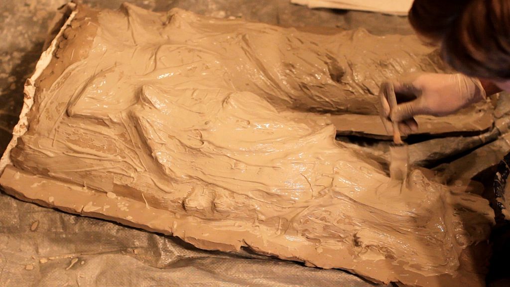

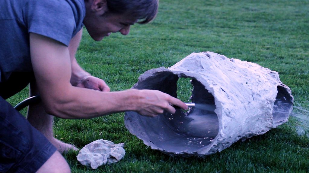

I wanted to make the molding process as easy as possible for these pieces, so I wanted to think more out-of-the-box to save some time and money. For something this shape, I was able to make a one-piece mold. I brushed on the initial beauty coat, then built up more thickness, and also added pieces of a cut-up cloth canvas to give it more strength. A few hours later, ready for de-molding. The plaster body form came out easily, but the clay, not so much. It took me several hours to empty all the clay out of the mold. I used my fingers, a toothbrush, a rag, a scratch pad, a knife, wooden spoons, a paintbrush, a garden hose, sculpting tools, a towel, and a toilet brush. A lot of work, but would give me good ideas for future molds. Every piece I molded would present its own unique challenges.

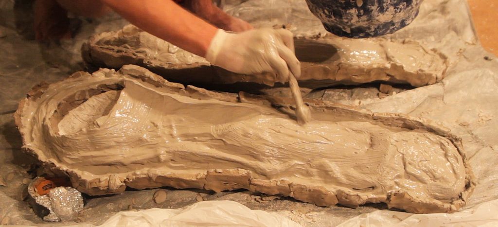

More sculpting on the legs, more random designing. I kind of got bored with the legs after a while, and just got to a point where I said "eh, that's good enough" and for the sake of saving time, decided I was done. For the legs, I took the time to make a dividing wall, ready for a 2-piece mold. And for easier release of the clay, I added some Vaseline and baby powder onto the sculpt. I covered the first half in plaster. Flipped it over and sculpted the back side. Lubed up the edges of the plaster walls with Vaseline for a release, and I was ready to go. Molded the back side. Then prying the two halves apart. Or not. The plaster I put on the back side dripped over the front side, drying hard and "locking" the two halves together. So I was stuck with a one piece mold. But de-molding wasn't too bad; with the Vaseline and baby powder, the clay came out fairly easily this time.

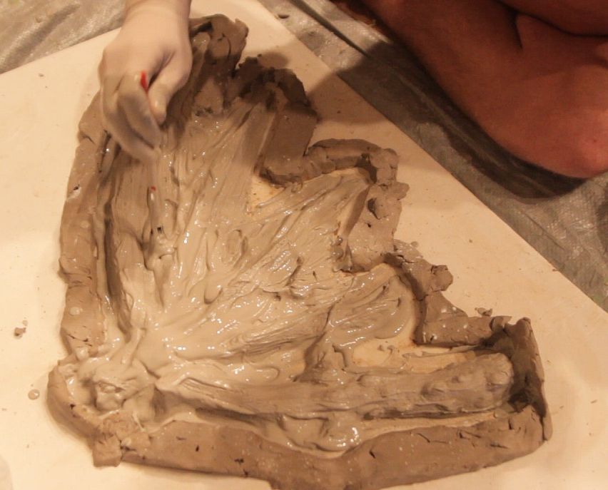

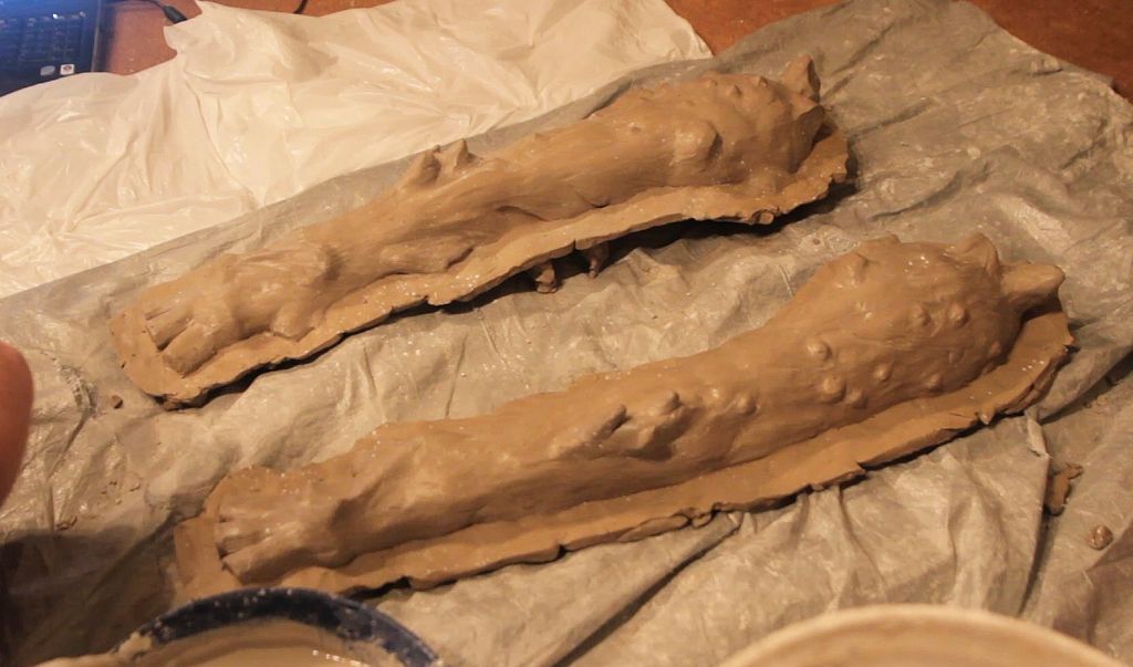

Onto the arms. More clay, more sculpting. To simplify, I decided that I would sculpt and mold the fingers separately. Since the arm only had one open hole on the shoulder end, a 2-part mold was required. I was finally going to make a successful 2-piece mold. I built the dividing wall, and laid the plaster. Added some cloth pieces to reinforce and thicken the edges of the mold. So far so good. Onto the other side. I added a clay retaining wall to keep the plaster inside the edges. Then came the separation; prying the mold halves apart by wedging in screwdrivers. The molds came apart, but not without problems; one of the halves had cracked pieces that fell out. I had to glue some pieces back together, and add extra plaster to reinforce. The molds didn't fit together too well either, as they were slightly bent from the prying. I added some clay around the edges of the seam to help them seal together.

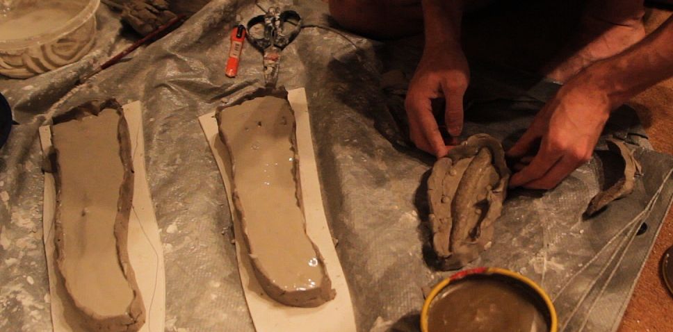

For the fingers and tentacles, I sculpted 3 different designs and made 2-part molds. It was much easier to make dividing walls and 2-part molds for the smaller objects. For the wings, I decided to sculpt only one wing (to simplify and use less plaster), and do it in halves; I sculpted half of the design on a foam board, and molded it. Then flipped it over, removing the foam board, and sculpting up to the plaster edge line to build up the other half. Then I molded that side to finish with a 2-part mold.

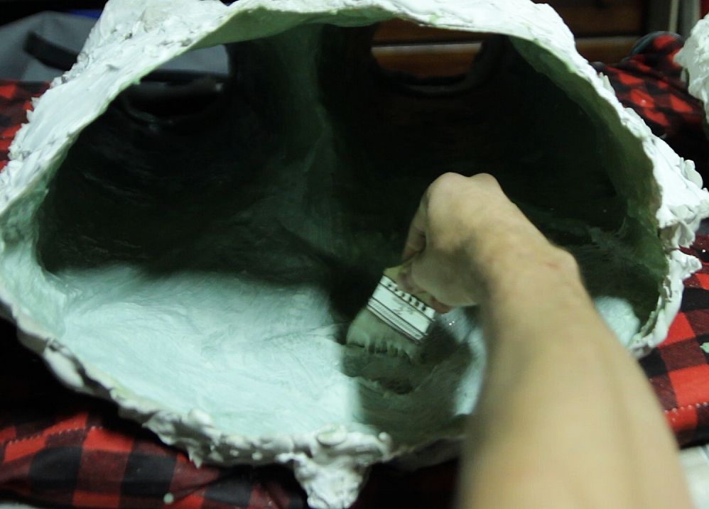

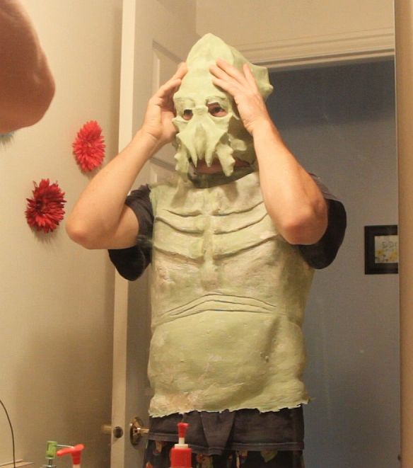

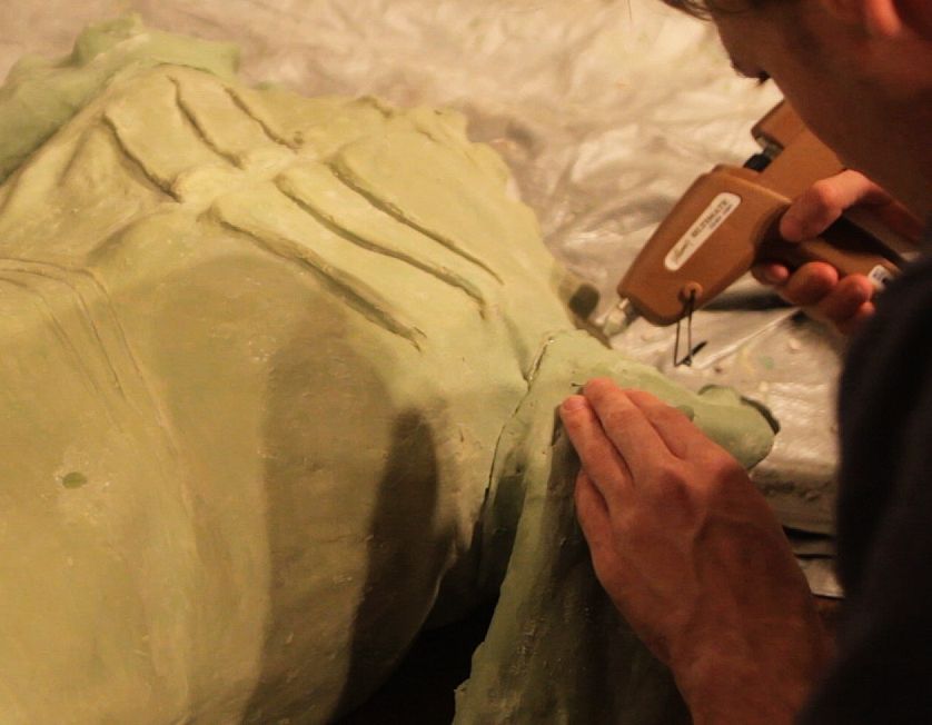

The latex casting was a fairly simple process. Brushing latex inside the larger molds, building up multiple layers to a good thickness. I colored the latex green for a good base color. Smaller molds, such as the tentacles and fingers, were filled with latex and then drained, leaving a build-up of latex on the walls. The wings were a bit different; I built up about 6 or 7 layers on each side, then put some fresh latex in, and joined the halves together. After it dried, I was able pull out a whole wing. After pulling the latex pieces out, I'd wash them and scrub them clean. For pieces cast from 2-part molds, there was extra flashing around the edge that I'd buff off with a rotary tool with a soft polishing bit.
To connect the body pieces together, I used hot glue for the initial bond, and then sealed the edges with latex. For the most part, the seams look pretty smooth. To keep the wings stiff, I added a wire from a coat hanger down the length of it, and had a piece of PVC pipe at the end with elbow pieces on the ends leaving two open sockets. This made the wings easy to add and remove; just slip them into holes in the suit, attach the sockets together, and zip up the back.

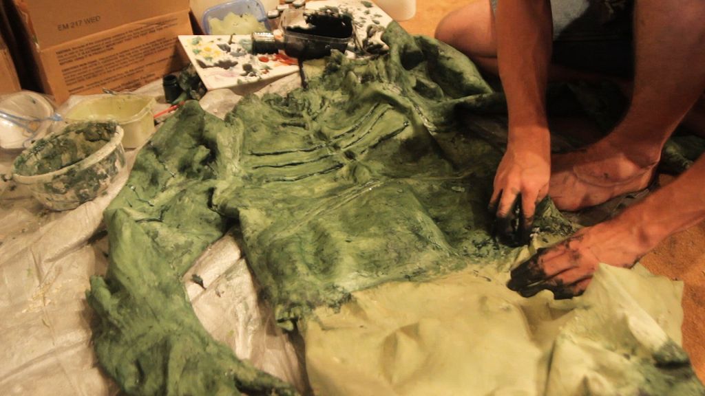

Most of the suit was painted with dark green washes. I'd paint on a thick layer, then get it wet, and wipe most of the paint off with a paper towel, leaving paint in all the small details. I also built up highlights and shadows with lighter and darker shades of green. I made eyes using clear plastic pieces from the packaging of a cheap dollar-store yo-yo. I kept the pupils clear (so I could see out of them), and then super-glued them on. After the painting was done, I sealed the costume with clear Plasti Dip spray.
Putting on the suit was simple; stepping into the legs, and pull the waist up, slip the arms into the sleeves, have another person zip up the zipper and put on the wings and head. I went to a few local events. It was a scary costume apparently; several small children ran away from me. Ultimately I had an end product that was, honestly, not quite as high quality as I had hoped, but I did learn a lot and it may encourage me to do better work in the future.
