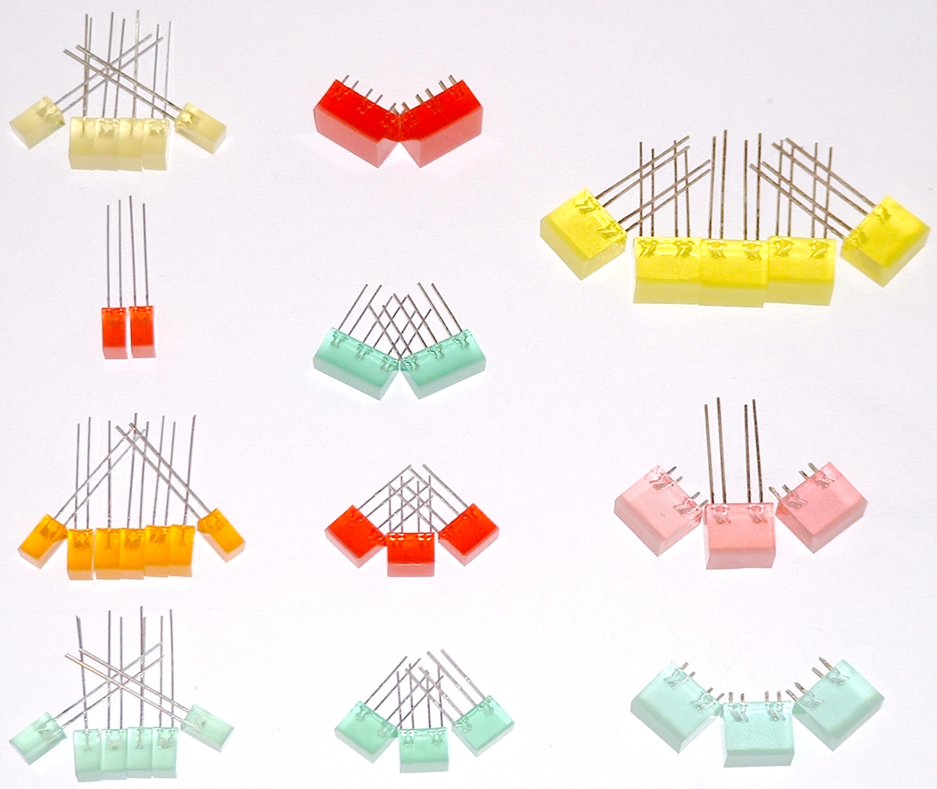

My LED collection so far.
The left column is all 5 mm x 5 mm square, single-chip LEDs. The yellow, green and red are for the back of the prop. Four orange will be used to make the 10 mm x 10 mm square on the front side in the upper right area, because I couldn't find a 10 mm x 10 mm 4-chip LED in this color (apparently neither could the makers of at least one of the original heroes -- in the Mark Dickson photo one of the emitters is rotated 90 degrees relative to the other three, something which could never happen in a production-line manufactured 4-chip part). Two orange will go in the upper left area between two red 10 mm x 5 mm 2-chip LEDs, again because I couldn't find a 10 mm x 5 mm 2-chip LED in this color. One orange will go in the back (behind the blue acrylic near the left side, because orange is the color on the front side in that location).
The middle column are all current-production LEDs that are close to the correct styles but not quite exact -- the LED dice are spaced on 6 mm centers instead of 4.5 or 5 mm like the originals. One of the red 6-chip LEDs will be ground into the ramp shape, to mount over the upper edge of the battery. I'm considering making an "idealized" version of the prop that doesn't exactly match any of the known hero versions, and if I do that, I'll probably cut the other red 6-chip LED down to 4 chips and 10 mm x 10 mm square, to mount over the center of the battery (instead of the square of red fluorescent acrylic), as shown in the Gene Crowell prop photo. The green 3-chip 16 mm x 5 mm bars are for the top center area, but I only have these two so far, out of five that the prop needs. I could build up fakes from clusters of 5 mm x 5 mm LEDs if necessary but I think that the extra glue planes might show too much. If you're reading this far you probably already know where the red 10 mm x 5 mm units go. I might use the green 10 mm x 5 mm units in a cluster to make that odd-shaped green area near the upper left, if I can't get a 6-die 16 mm x 10 mm unit in green.
The right column are what I have so far of the correct large 14 mm x 7 mm 2-chip light bars that make up all of the largest LED clusters on the front of the prop. I still need a bunch more of these. All in the photo are tested and working. I haven't encountered the problems mentioned elsewhere of some units being duds when new, or of being reversed polarity, although I have found some half-dead green ones (not shown) which were pulled from a circuit that drove them at 35 mA in a hot enclosure. They're only rated to 30 mA at standard room temperature, so it's amazing that only two dies were dead, from the handful of LEDs that I pulled from that circuit. I have noticed one apparent design issue, though. The yellow units I have are much dimmer than any of the other LEDs in this collection, even though they are new old stock, so I'll have to drive them at their 30 mA maximum, then calibrate all the others in the prop to the same brightness by reducing their current.
Although I have obtained a few more since posting the above photo, I still need some more of these HTF LEDs. Please see my WTB post in Classifieds; I'm confident somebody here has some or has an idea where some may be found -- possibly extras from a handlink build (whether completed, abandoned, or changed tactics and decided not to use the original-style LEDs). I can even use some that are dead, or have one dead die, because I have a way to near-invisibly repair them (the 14 mm x 7 mm 2-chip style).
New development: I may have found someone who can replicate the obsolete LEDs in "small" quantities of at least 500 pieces ("small" is with respect to mainstream manufacturers, who typically won't even talk to you for less than 10,000 pieces) for around $1.25 each. Since the prop uses up to 29 of the 14 mm x 7 mm 2-die style, depending on exactly which version is replicated, this means a minimum of 18 replicas to meet his minimum quantity. If the interest level is high enough, it may be feasible to have him make some of the less-common styles in the prop, such as the green 3-die style at top center (5 per prop).
Is there enough interest here to go ahead with an order from him, assuming his work is of high enough quality? I don't believe I would be producing such a prop run myself, but I could supply the LEDs at my cost to anyone who wants to produce a run or even just build a 1-off replica for himself. If you are interested, please reply with how many props' worth of LEDs you think you would want. Note that I would supply ONLY the custom LEDs; any other LEDs for the prop such as the still-available 5 mm x 5 mm square single-chip and 10 mm x 5 mm 2-chip types would be your own responsibility.
If there are enough responses here, I will get a Premium membership and post an INT thread in the appropriate forum.
EDIT: Stand by, please... it's starting to look like his "production" method won't be any better than I or any other one of us could make ourselves. I'll get back here with more details as I learn them.
From the rest of my conversation with the person mentioned above, it seems that his plan was to take existing water-clear LEDs which emit the correct wavelengths and intensities, and grind their lenses flat, then cast them into tinted epoxy molds of the correct dimensions. Because of the mix of tinted and untinted materials, this would leave each die visibly surrounded by a clear cylinder. Since there are close-up shots in the series in which the LED reflectors and leadframes can be seen, I find this method unacceptable. When I asked him if he could get functional but unencapsulated leadframes, he didn't directly answer "yes" or "no", but merely said that he could do anything I wanted though it would cost more money. Since his price is already higher than what I could make myself, I think that will be the end of the discussion. I can make them better too, since I know where to get LEDs that are close to the correct pale tint density, so they will be much less noticeable when double-encapsulated.

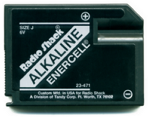

On another note, today I found one of these in my mailbox:
It's quite dead, unsurprising considering it's at least 13 years old -- I believe this label style was last made circa 2001. I'm still looking for one with the correct Duracell label. Does anyone know of any other brands/styles that were used? (Screenshot please!)
