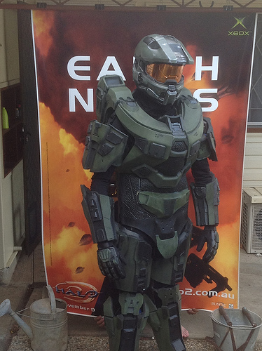

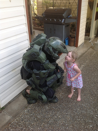

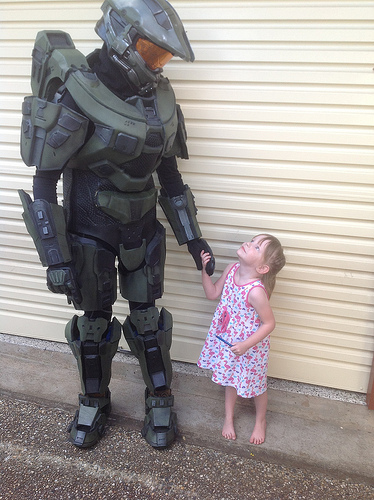

here is my proof pic of the finished suit:
Untitled
and a few others:
