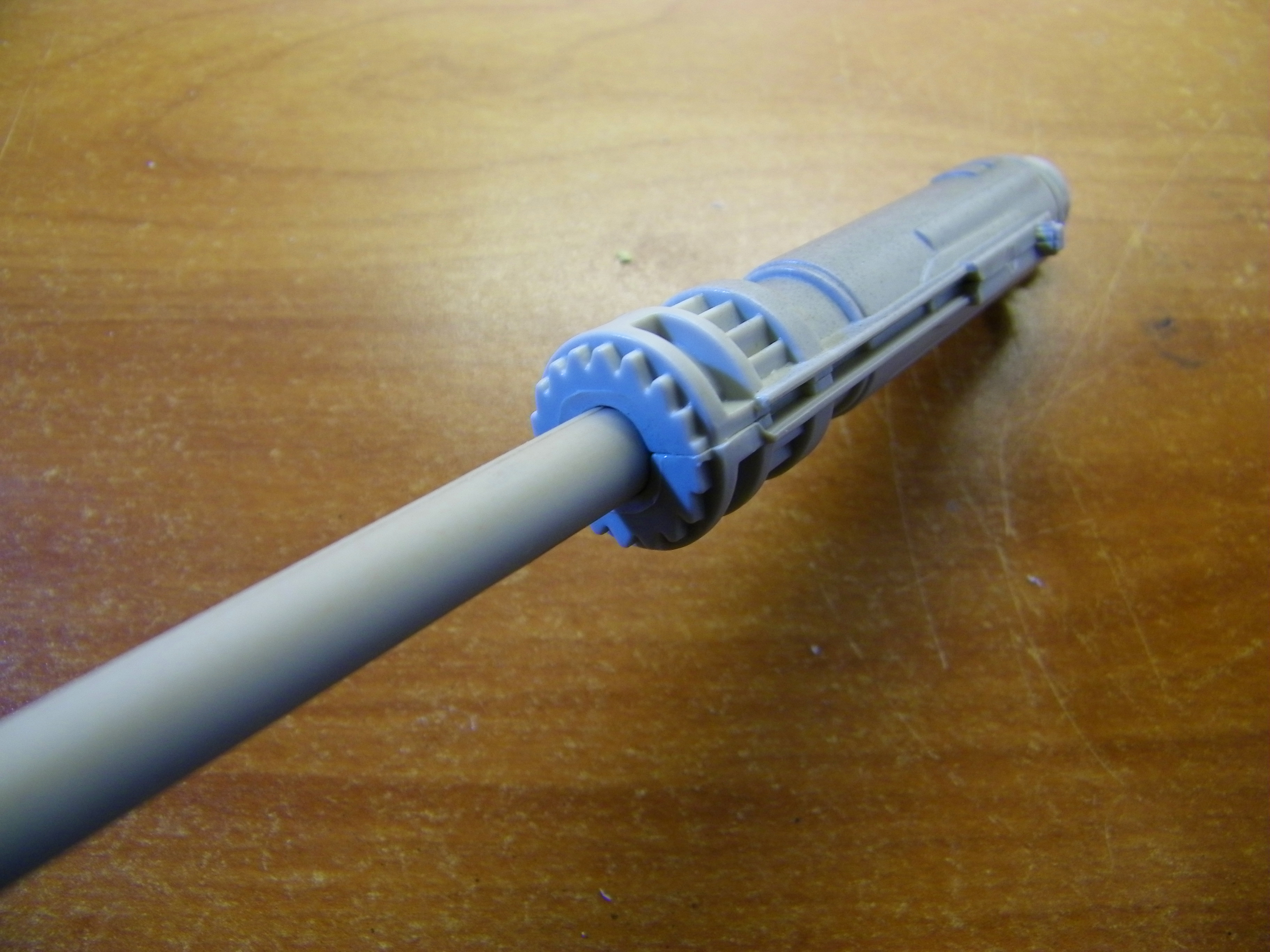

First the laser cannons. The heat sink part here had to go.

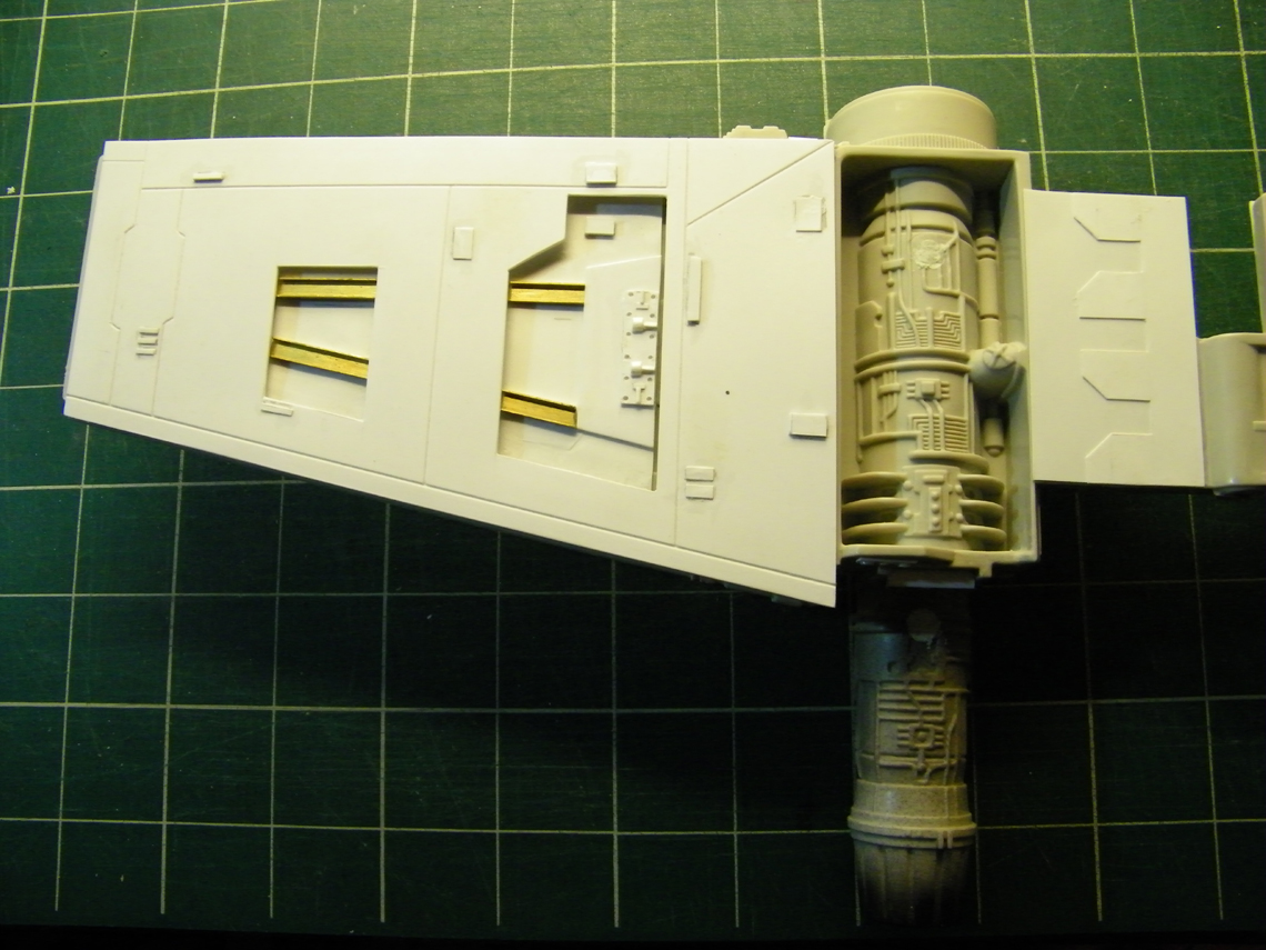

I'm not going to rebuild the wings but just add to it. After removing all the little raised pieces, I cut out a thin sheet of styrene and etched in the revised panel lines.
The one good thing about the inside of the wings it that there's enough room to add more accurate details. The long thing styrene part in the middle is there for support.
Then a test fit. For now I have just penciled in where surface details will be going.

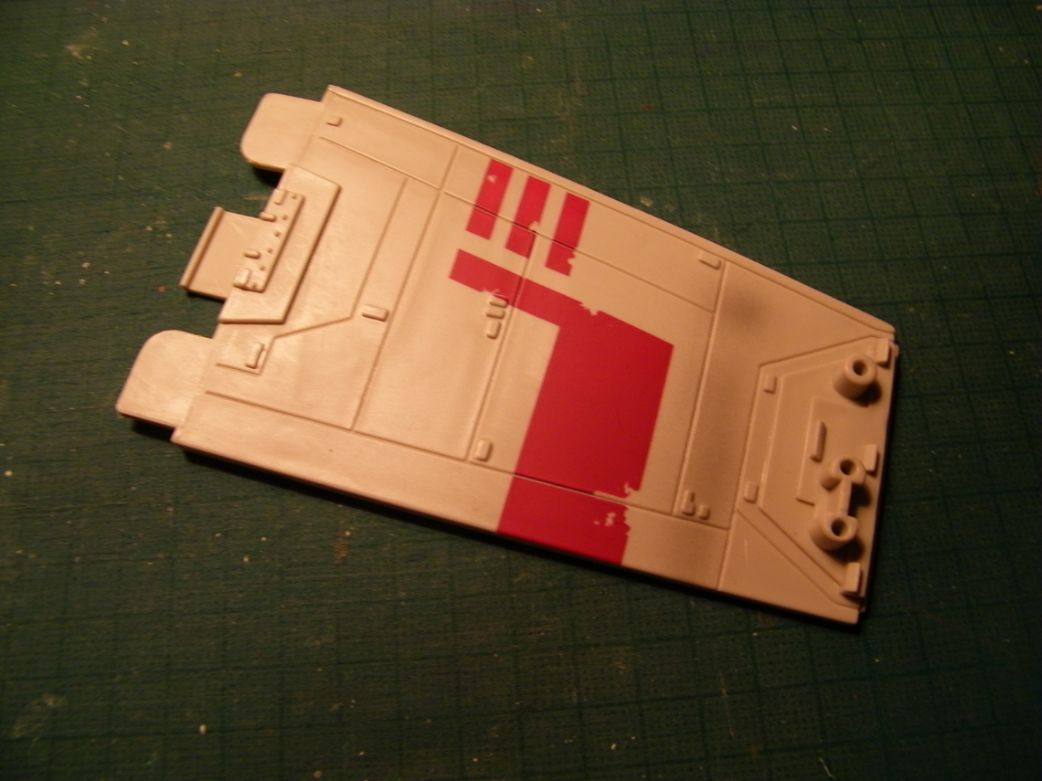

While waiting for putty and primer to dry on my Duel truck build, I had time to work on the wings.
Here are the original wings with the small surface details removed.
Here's the replacement which I just lay over the top.

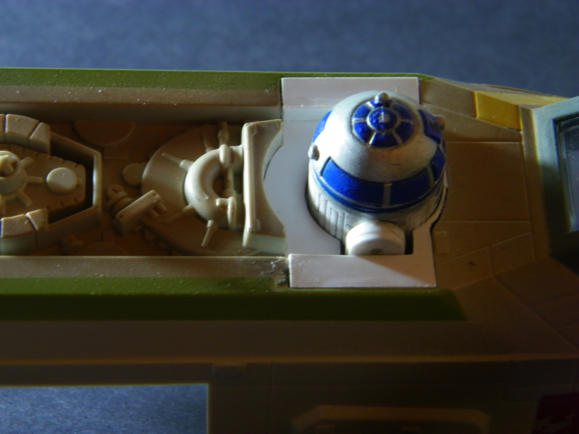

I worked on the droid strip and making the socket smaller for the PEZ R2D2. First I'm going for a close fit and I'll fill in the gaps later.
I did a little droid adjustment and this is how it turned out.
100_8964.jpg 100_8965.jpg 100_8988.jpg 100_8989.jpg 100_8987.jpg 100_8986.jpg 100_8985.jpg 100_8990.jpg

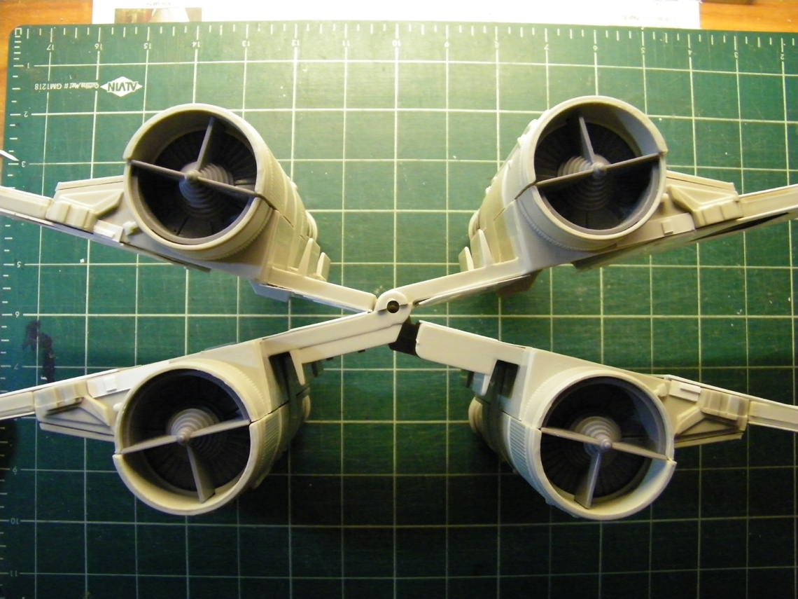

I scratched up some small details under the front and back of the engines. I couldn't stand seeing those blank spots.
Another look at the inner wings.

Might be something in-between. The picture of the cannons in your hand are what made me think it was about 1:35 or slightly larger. Is the overall length closer to 14" or 24"?
Ahh, just noticed the ruler in the picture of the wings. Pretty darn close to 1:24.
