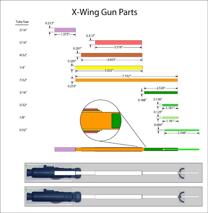

Hello to all,
It’s been some time since my last visit to the RPF. I’ve been lade up due to a bad car wreck. Now that I’m feeling better and have some of my fine motor skills back, I wanted to pick up where I stoped working on my Revell snap Max 1/30 X-Wing conversion. At present, I need to rebuild the four laser cannons. I have the kit from falcon 3D and now I have to make the cannons from brass or aluminum. Does anyone have plans or measurements for this scale? It’s seems like a straight forward build, but I was just thinking that there has to be a build sequence out here.
My best regards to all,
D.

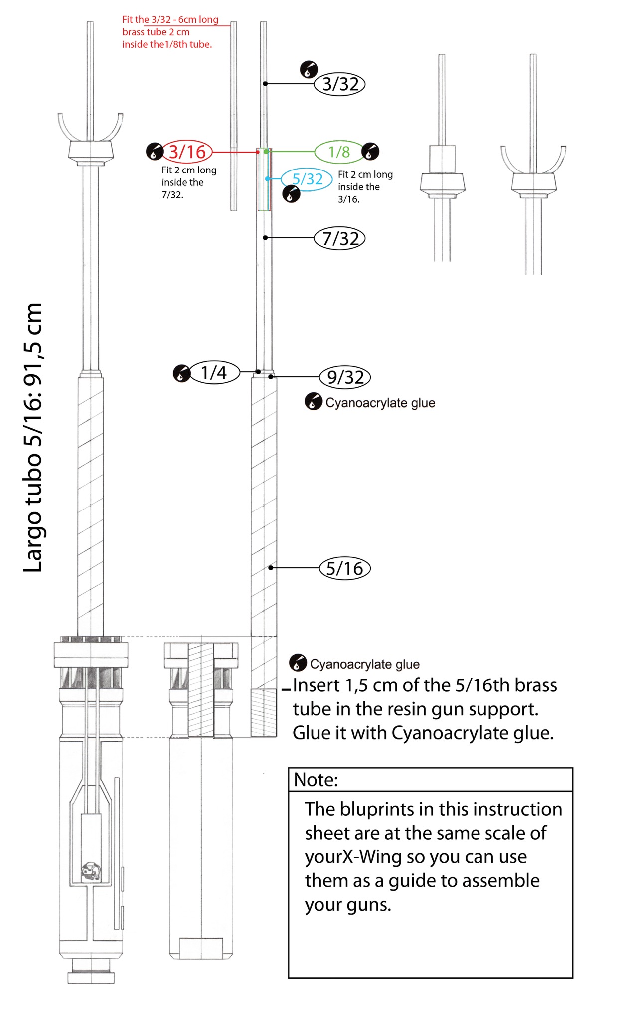

This is for 1/24 scale, I’m sure you can scale them down appropriately.
Forgot to add this one to give you the lengths of the tubes
