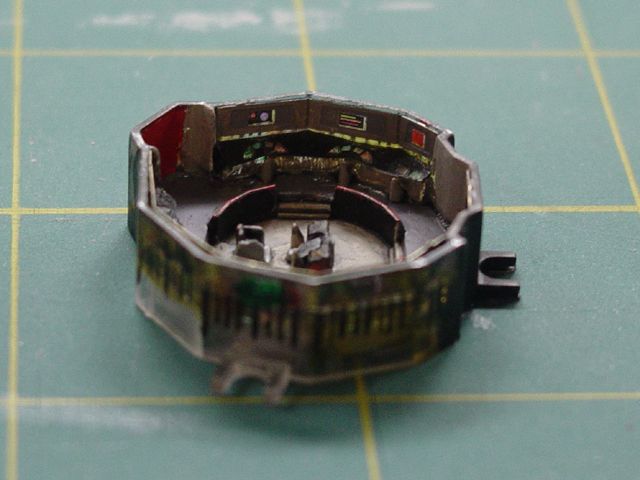

My first efforts are starting with the bridge. The lighting kit provides a clear bridge insert that allows for the consoles to potentially be lit, but admittedly this can't really be done effectively UNLESS you get your hands on the Paragraphics photoetch set (which I did). It includes etched panels for each station and viewscreens as well. It also includes options for the pilot 1 style ship with its different screens (I'm saving those for another model).

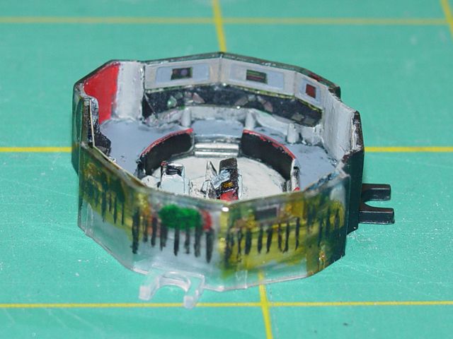

I lightly sanded the part with 600 grit paper before starting the paintwork. One thing I opted not to use from the etch set were the bridge railings as I am not experienced enough with etch to fold parts THAT tiny. Plus, at the angles the bridge will be visible under the dome, one can't necessarily tell if they are etched or plastic if they are painted well anyway.
The flash photography makes things look a little sloppy, but in person things seem to look fine. I still need to plug some light leaks on the part anyway until I get it where I want it. A black wash and a fine line black pen worked wonders to pick out details like the steps leading to the center section.
To do the viewscreens, after painting consoles with clear tints and applying the photoetch (then the black console decals) I next applied the stock viewscreen decals. They have no white backing so light can shine through them, but the entire set of viewscreen decals are clear, so without some type of light block (where the photoetch comes in) they look really funky. Thankfully, the photoetch does its job in that department. I encountered a slight alignment issue with the right side consoles, but the left side ones (engineering, auxilliary systems) seemed to work fine. One final bit of serendipity that I noticed is there is a skinny gap between the console and the viewscreens. So I back painted the areas with some clear yellow, used a fine line black pen to put in some small blinky screen dividers (eight per big station, four per small) and the results looked rather passable.
I painted the inside of the bridge dome silver. There are enough gaps that lights from inside the saucer should spill enough light up and over to cast some lighting onto the floor of the dome. I've been doing preliminary light tests with an LED flashlight and while it has shown I need to plug some light leaks in the floor of the part, I am liking the results a lot.

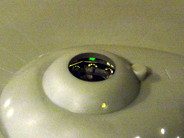

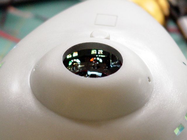

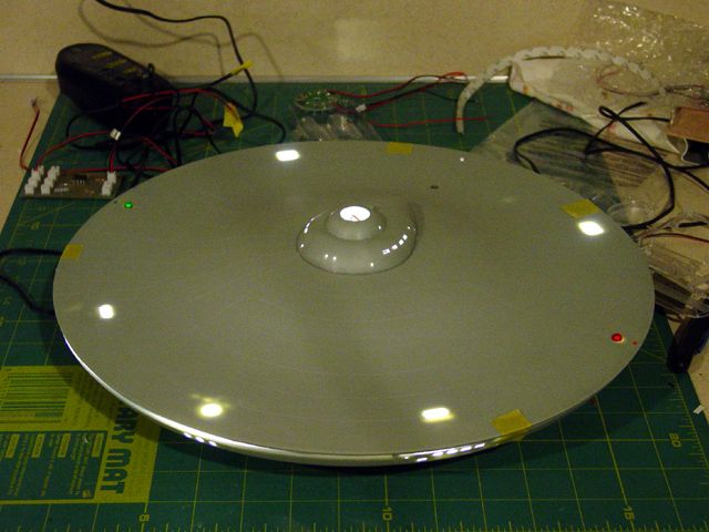

Well, I shot some more still photos of my work in progress...
The bridge still has a couple pesky light leaks, but my second fit test shows it should work fine
One thing I noticed on a test fit of the clear bridge dome is it acts like a magnifying glass, so the bridge becomes very visible. I want to try and keep the paint work as precise as possible here.

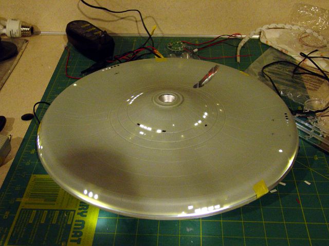

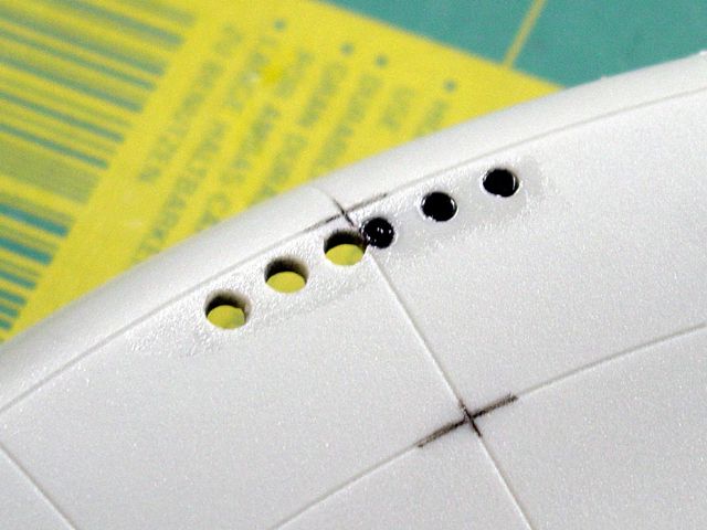

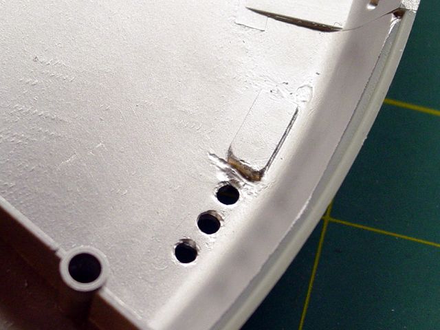

Remember how the model has a slight error with those round porthole windows on the bottom of the saucer being improperly positioned (on the wrong side of a panel line)? Well, I followed the steps to cut new ones. But rather than filling the old ones with putty, I just used the smoke tinted windows glued in instead. That way, when I sand them flush, they will sand the same as the rest of the plastic (and solvent glues lock them into the plastic VERY well).
With this kit, light tests are frequent to make sure it all works. So far so good with the saucer lights. I've got some light leaks I have to address, but they are relatively small. I am really liking what I see at least.

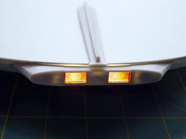

I installed the impulse deck a couple nights ago. To get that brilliant orange glow, I sprayed the backside with clear orange and backed it up with clear red to give it more of a "color of fire" look. The grills are from the Round 2 photo etch set (you get two slightly different types). Since my model will be at impulse, I probably won't light the intercooler grills on the nacelles, just the lighted and motorized bussards.
