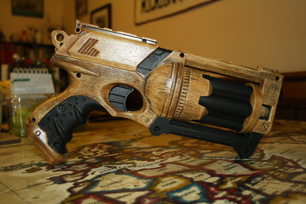

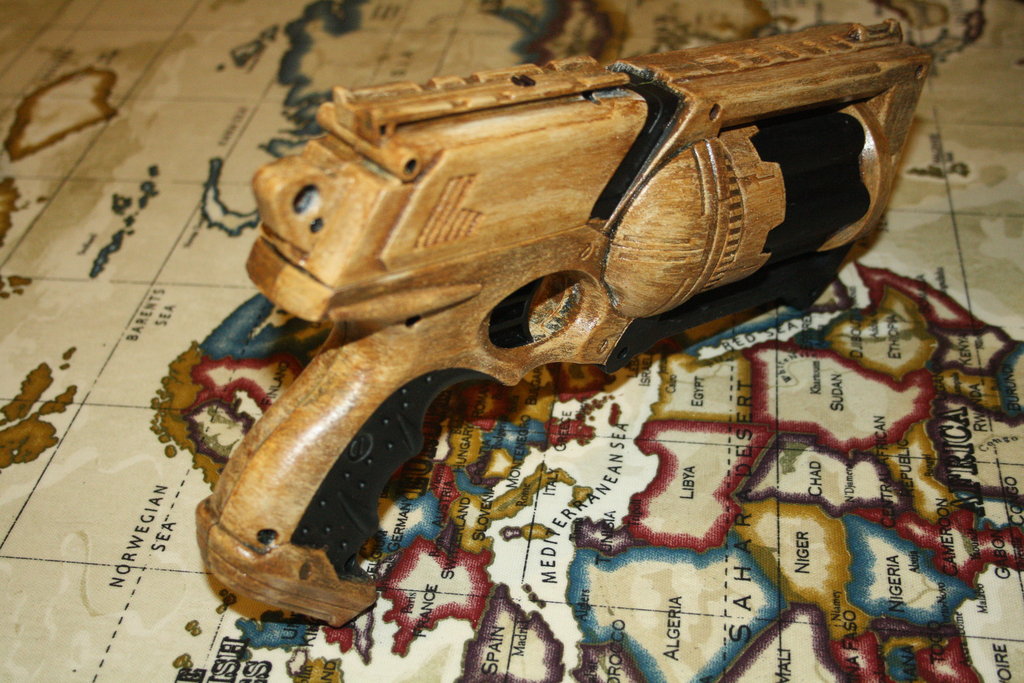

A year or so ago i was looking at things to do with my Nerf gun, various mods and paint schemes to do when I came across someone who had done a really nice woodgrain effect on a few of their Nerf guns, I found a link to a video he'd done showing how to get the desired effect and decided to give it a go myself. (if i find the video again or even the stuff i found in the first place I'll be sure to give a few links along the way)
The first woodgraining i did was on my old Nerf Maverick, but that'll have to come later as I believe the pictures of the wip and finished product are on my external hard drive. It's still by far my prized piece but I am happy with the other ones I've done too.

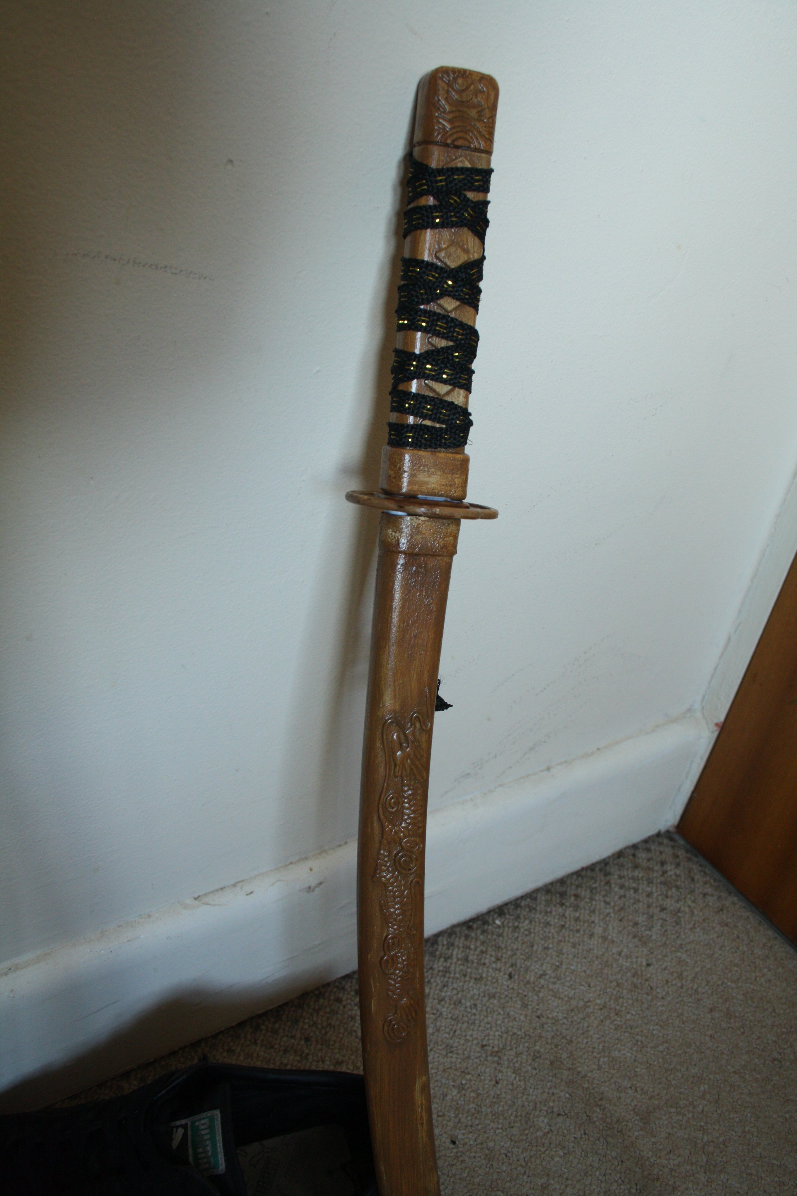

So first I'll be showing you my most recent woodgrained prop, a plastic katana. I got this off of my sister who had it for her hen do and wasn't bothered about keeping it. I'd forgotten to take a picture of it fully constructed before hand so this is just a google image I found, it's pretty much that sword with slightly different end 'caps' and a dragon on either side of the sheath.

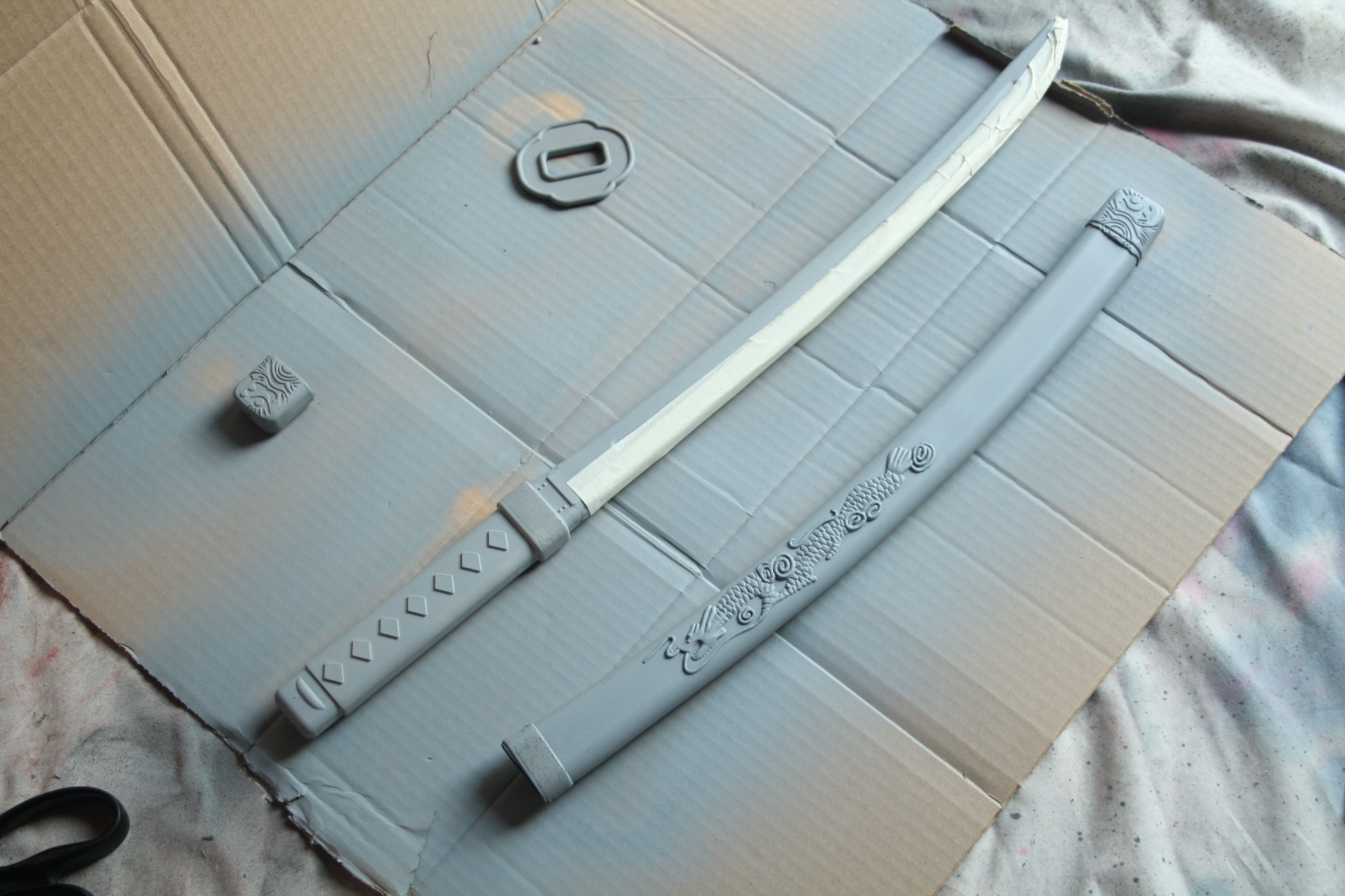

Firstly comes de-construction and prepping the surface for primer. The plastic this sword is made of isn't anything special, the sword is really light (too light if you ask me) and the plastic itself is flimsy and would bend easily, so if you plan on doing this with the same sword, don't go attacking somebody who's got a sturdier one, you'll come out worse.
So with the sword de-constructed and rubbed down with a bit of sandpaper I took it into my shed and applied just a single coat of grey primer (my local shop was out of black primer otherwise I'd have just used 2 coats of black primer, maybe even just once coat would do it)

What comes next can take a long time or it can go very quickly, on the sword I was a little impatient and wanted it to be done quick so I was heavy handed on it and in my opinion it shows and does effect the end product, but I'm still happy with how it looks.

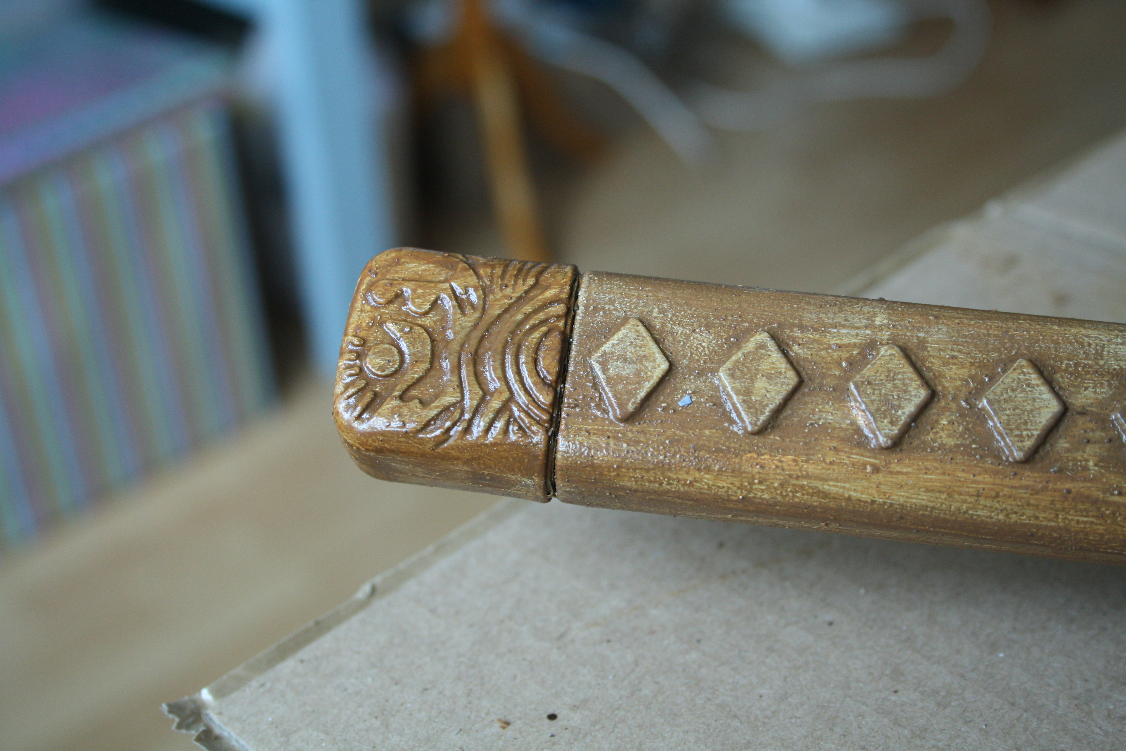

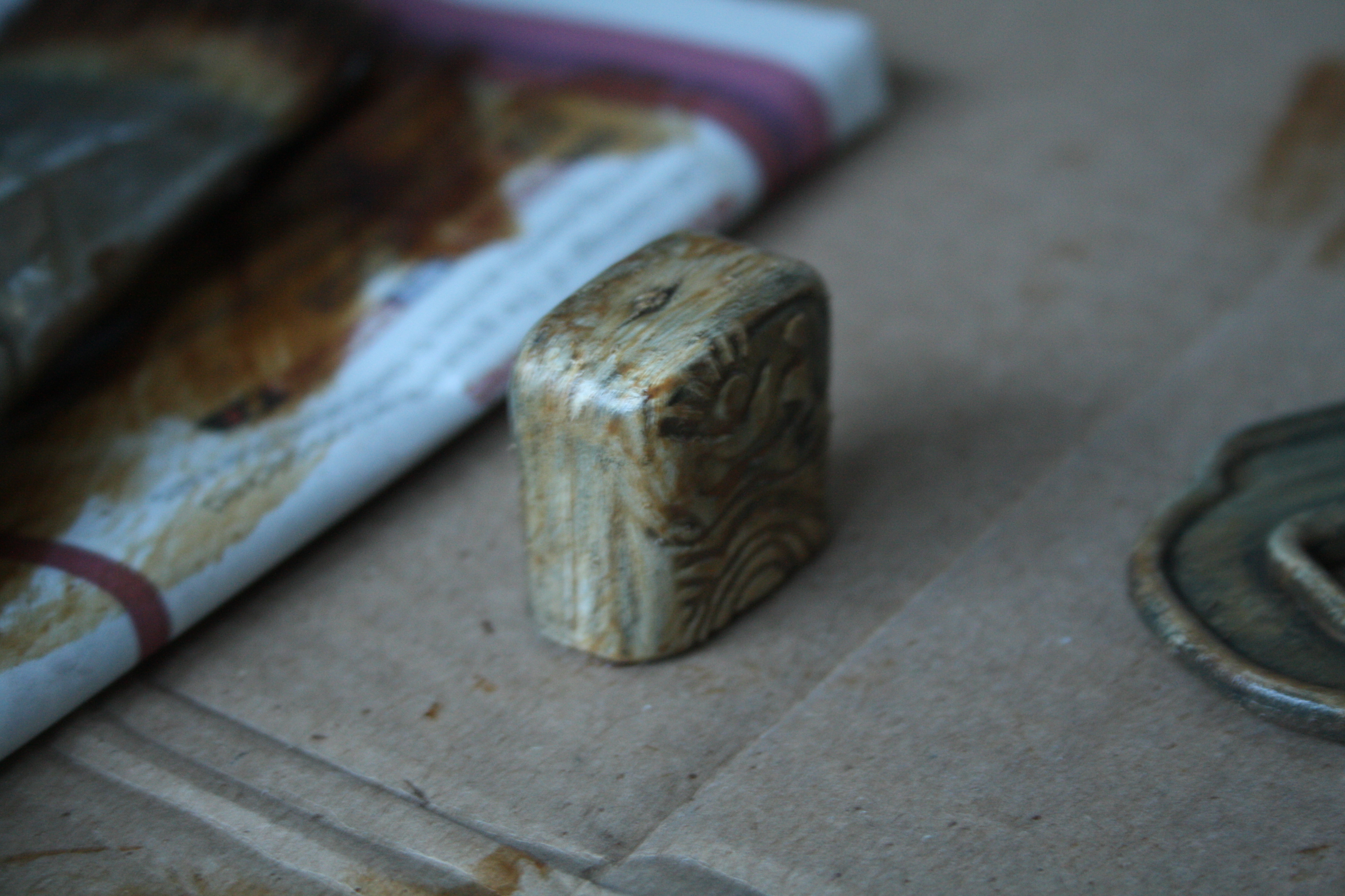

So, once you've dry brushed your first layer of white wait until that has dried and then coat it in a layer of the wood stain paint you've got. (Spray paint wood stain works just as well as brushing it over, again that's just preference, they take about the same amount of time including applying and drying)
After this coat of wood stain has dried you'll apply another coat of the dry brushed white paint and then the process is repeated until you're happy with the result you've achieved!
Just to explain why/how this works if people were curious, (you should be able to tell from the pictures but still) the wood stain paint only shows up on the white staining it the wood colour and not on the black, each time you build up the white dry brush and apply another coat of wood stain the layer underneath it gets darker, meaning the top most coat will be the lightest part of 'wood' and the bottom most coat of white will be the darkest part of the 'wood' So if you want a dark wood many layers may be needed where as if you want a lighter wood fewer layers are needed.
Even once your final layer has dried you can add another layer of the wood stain just to give it an all over layer making every layer darker but you will still have different parts different shades due to the layers.

I'll add another bit once I find the Nerf gun pictures so you can see different results.
