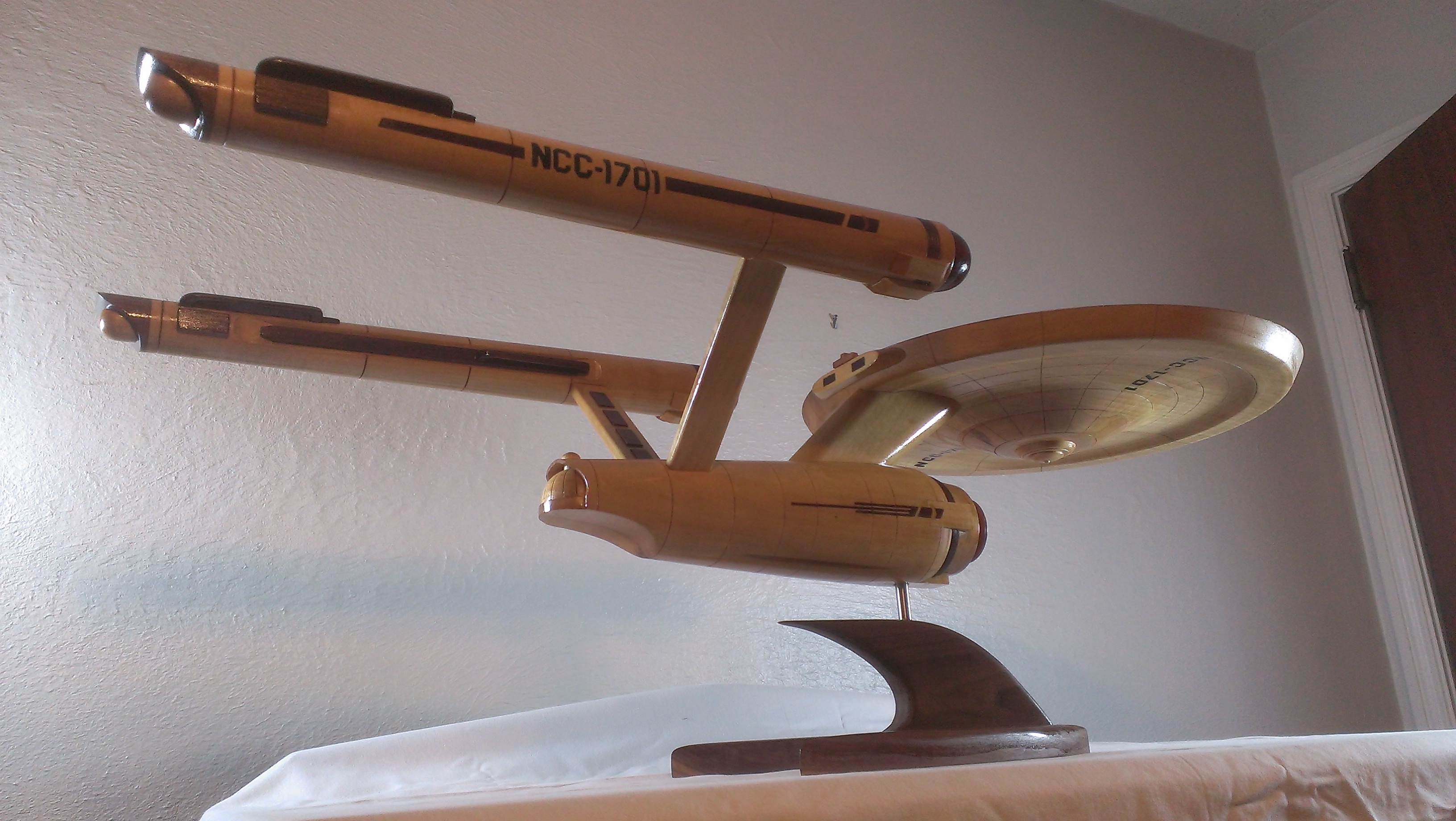

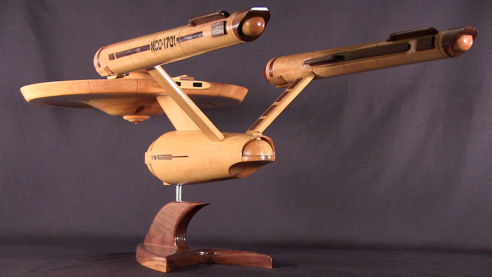

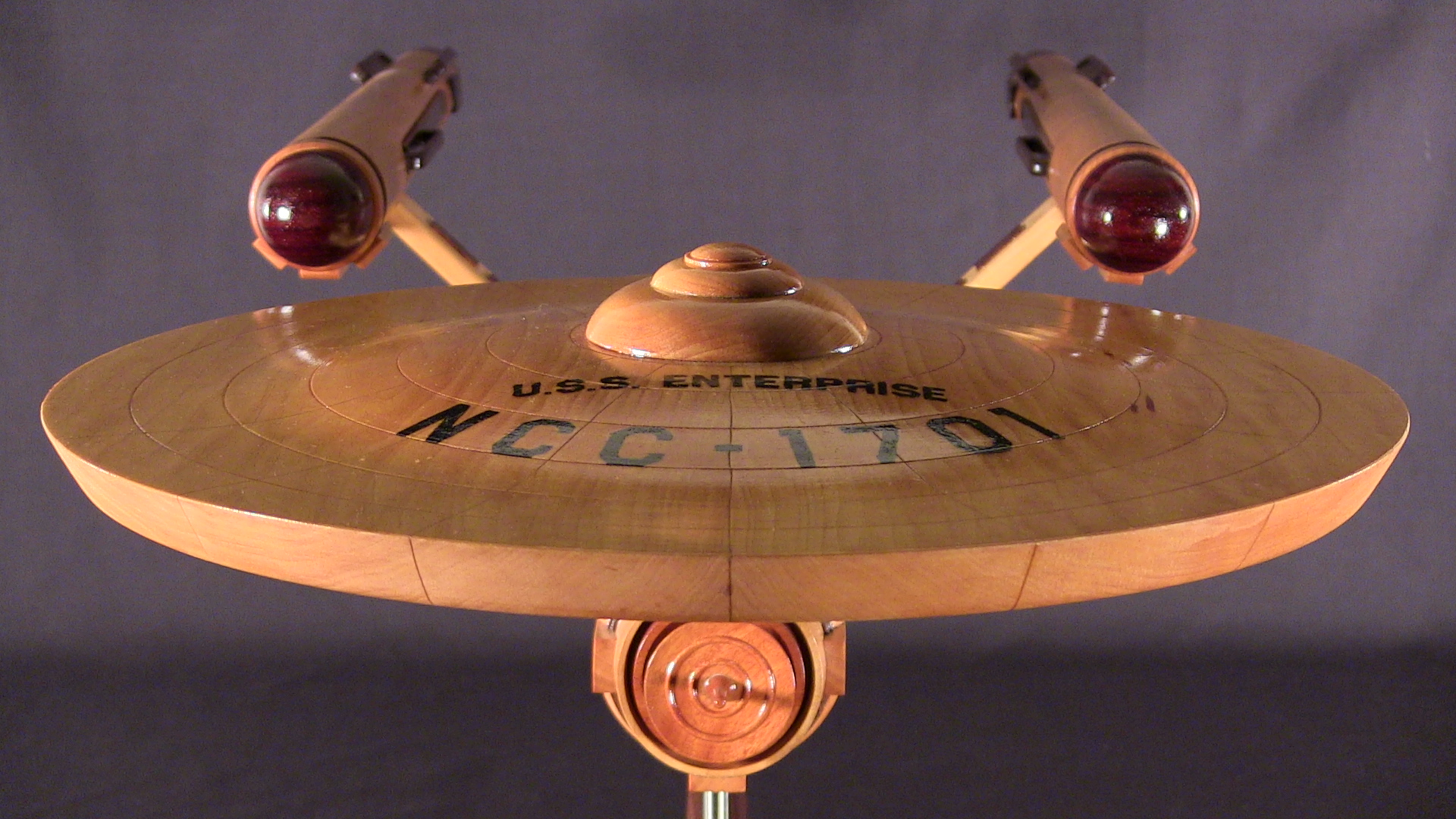

I just wanted to share my latest project with all of you. I built a 36 inch wooden model of the old school Starship Enterprise, made of maple, black walnut, padauk, osage orange, ebony, and yellow heart. The goal was not only to create the epic vessel, but to do it in original style not seen anywhere else...exploiting the natural grains and colors of the woods used. There is no paint or stain in this. It is coated with clear gloss polyurethane and rests on a 3/8" stainless steel rod fixed into the black walnut base sporting the starfleet emblem.

If by "no paint" you mean to say that the lettering and striping is all inlaid wood, than I really am quite impressed.

Yep, absolutely no paint. The lettering and striping were all done by dremeling out the shapes 1/16"-1/8" deep, filling the voids with superglue and sawdust (ebony, padauk, and yellow heart) and compressing it by hand, then sanding it smooth and flush to the surface. I don't know what the technical name for that technique is but it's used in electric guitars a lot. I call it pseudo-marquetry. So hopefully you'll at least be half-impressed...haha. I plan to do full marquetry on the next piece, whatever it may be...haven't decided yet.

Wow, impressive! Would it be rude to ask if there's any chance you could take a picture with better lighting to really show this off?
Brilliant idea with the glue an wood dust technique, I bet that made it a heck of a lot easier to contour those details onto the curved surfaces.

Ad Angelus Lupus: Not a rude request at all, in fact I'm planning to take some better shots with better lighting and from an actual camera...versus my phone...haha. When it came to the decision to do the glue/sawdust technique versus actual marquetry, that was determined by the fact that you wouldn't even be able to see the wood grain because most of it is ebony. The yellow heart boomerang shapes are too small and the padauk is too dark. So the work put into the marquetry wouldn't have paid off. Now, I'm considering turning this into a 3-piece adversary set (just like the old model set) with scaled Romulan Bird of Prey and Klingon Battle Cruiser to match. The Bird of Prey would then have actual marquetry for the bird on the underbelly.
To SenseiFetter: Funny enough, I actually thought about doing a mold of this for casting copies, but I don't know if I'm willing to risk ruining the polyurethane finish by spraying the mold release onto it. Tempting because of the awesomeness factor of making TONS of Enterprises...but not quite worth the risk. Mayyybe, someday I could make a version strictly for casting.
