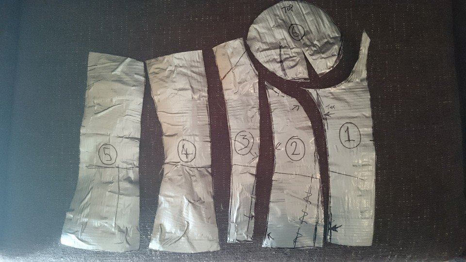

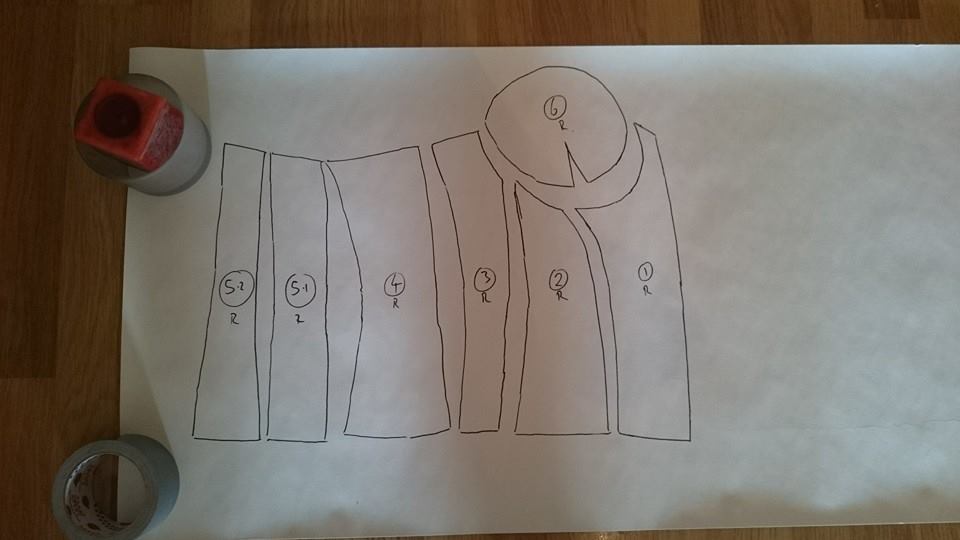

First I had to make a pattern. I did this by wrapping her up in clingfilm and using Duct tape to create my canvas.

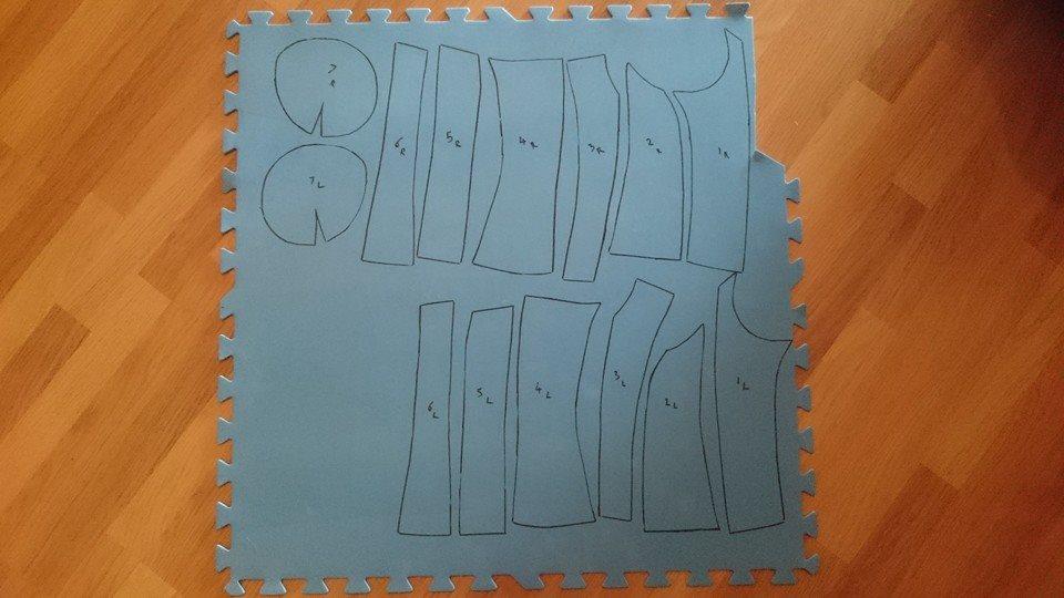

Once the pattern was made I cut out the corset side to create an EVA foam corset to begin the build on.

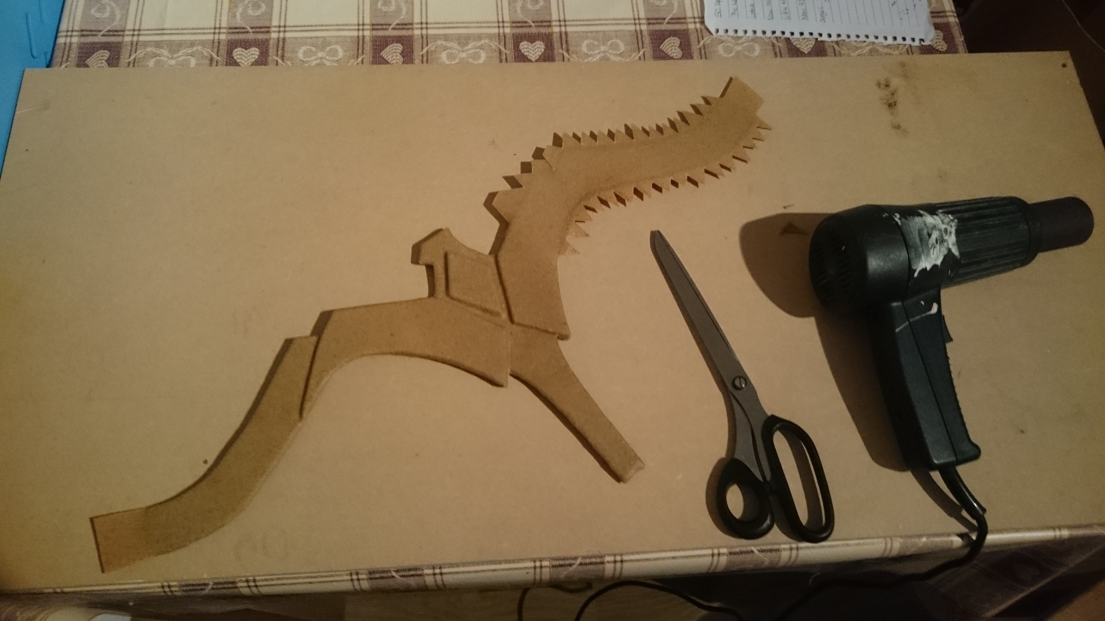

Time to make the breast plate. I began with 3mm EVA then I will use Worbla To finish it later on but for now here is the eagle.

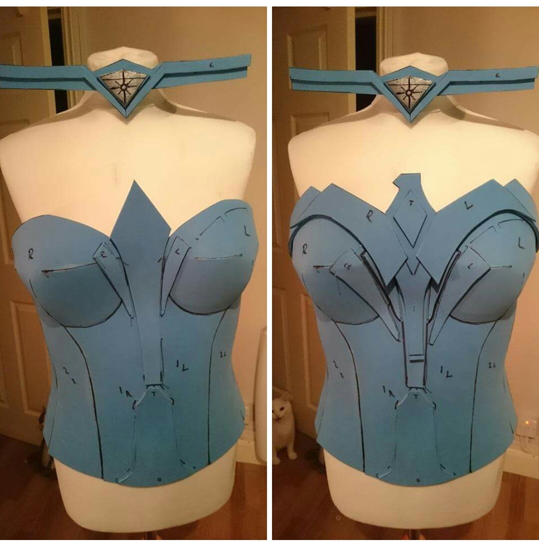

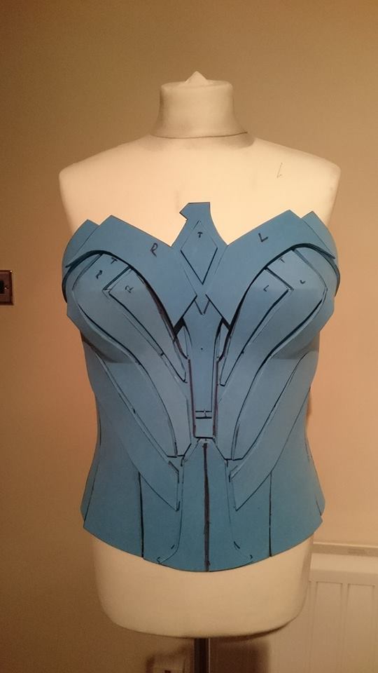

Ready to get on with the ridges on the corset now! I have got the corset shape done, Eagle and also the headpiece. I would love some feedback from anyone also making one :)

Another few hours... I guess I will get the last panels on tomorrow night! Must sleep. I hope you like my EVA #wonderwoman so far!
I took the second half of the hand drawn pattern I made, mirrored it. I have found the hardest part was the eva over the breast cups. I had to extend the original pattern to make up for the lager cups I made from the bra over a knee method.
So far this build has clocked around 20 hours. Will finish the rest of the corset shape and ridges hopefully tonight. (UK time)

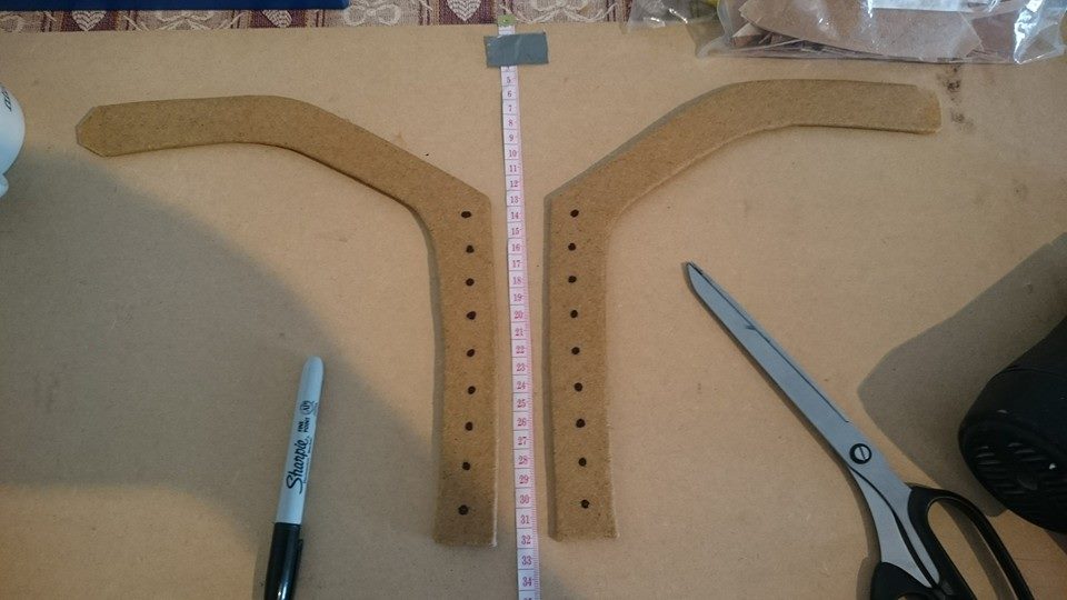

Corset ridges done. I have decided to add some Worbla down the back with holes throw to tie up the corset. It is only foam.
This will follow down from the eagle down her back. I will make one for both sides.

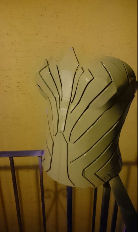

Got Some good work done today. I coated the corset with PVA glue then gave it an undercoat.

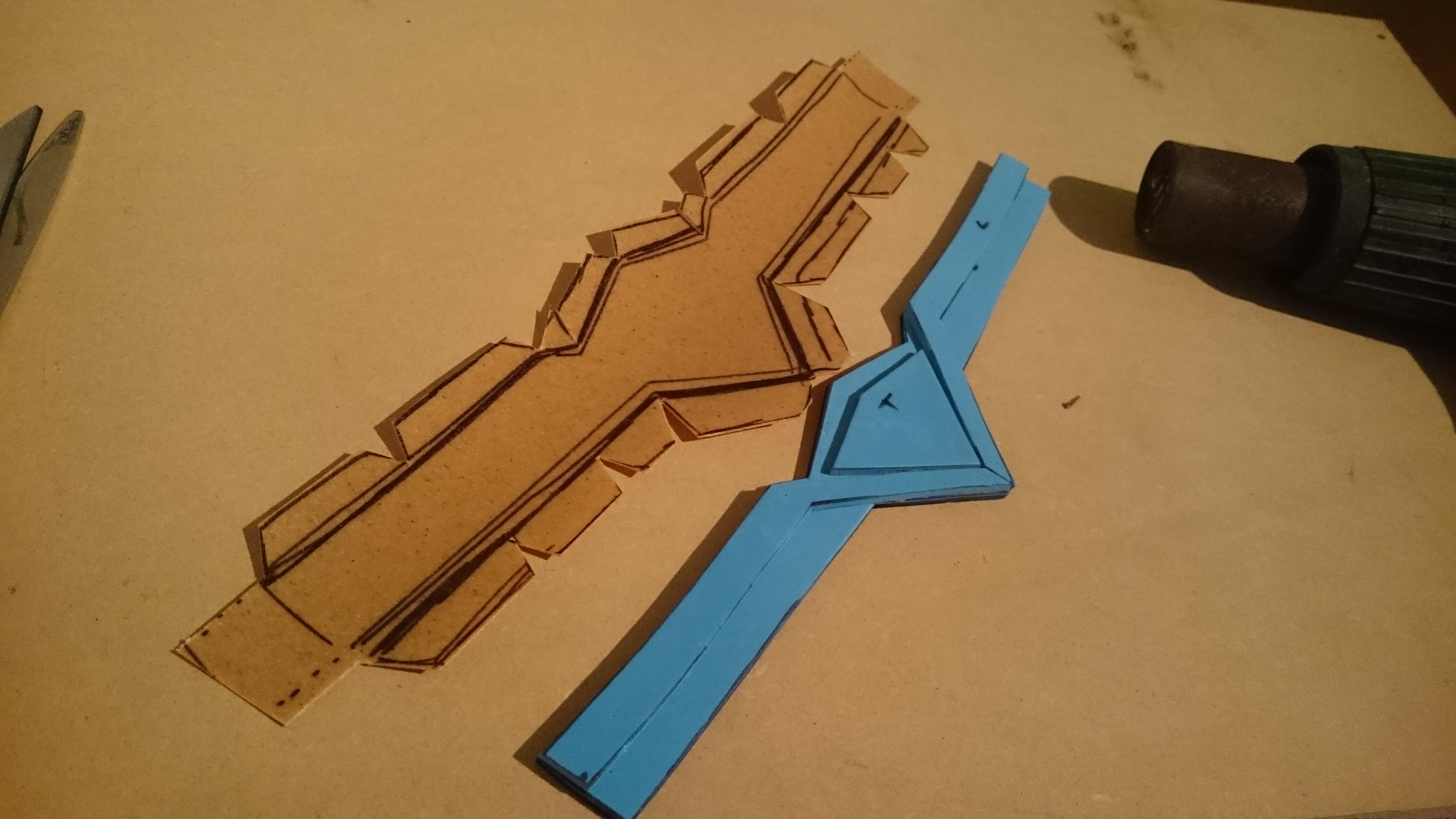

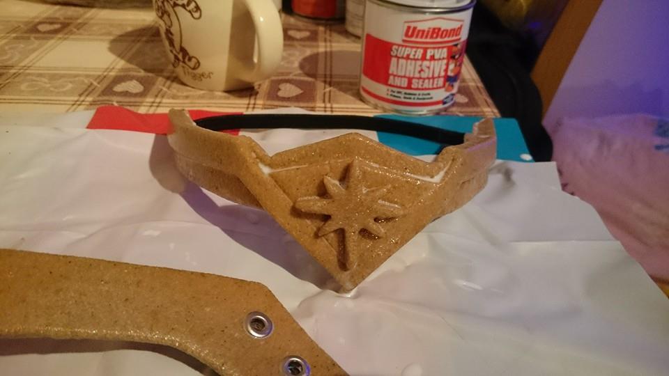

While this is drying its time to make the tiara. For this I took my EVA foam tiara I made earlyer this week and added a layer of Worbla to it so I can bend around the head.

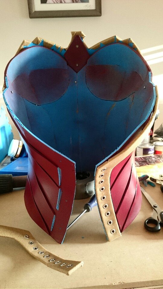

Now time to add the eagle. First I made the continuation from the eagle that do down the back. I have desided to have a tied up corset design. Magnets just wont do the job.
I evened out the holes and then heated up the Worbla and shaped the the corset.
1170692_1161395800551995_6948157580268243637_n.jpg 10459108_1161395820551993_4782900942272556579_n.jpg
I the trimmed the EVA corset to size then took off the beams and resprayed.

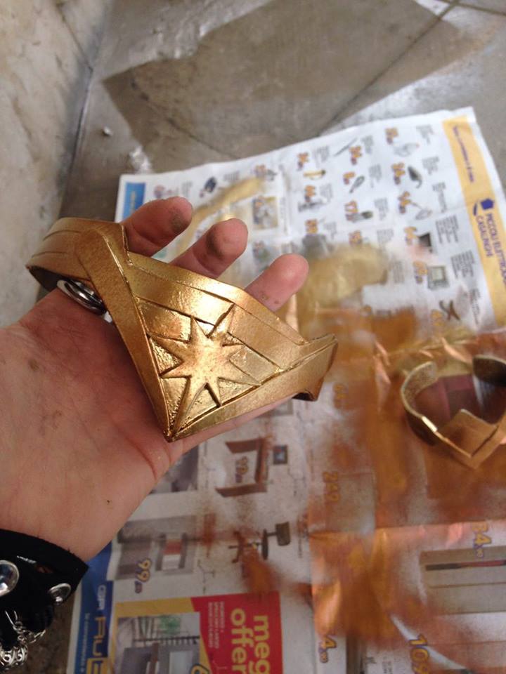

Will paint it gold tonight but for now here it is!

Not a lot done tonight, Covered the 4 Worbla parts in PVA/water ready for a paint job tomorrow!
Let's see what it looks like tomorrow! Then I have to get on with her belt before tapping up her leg and making her leg armor.
