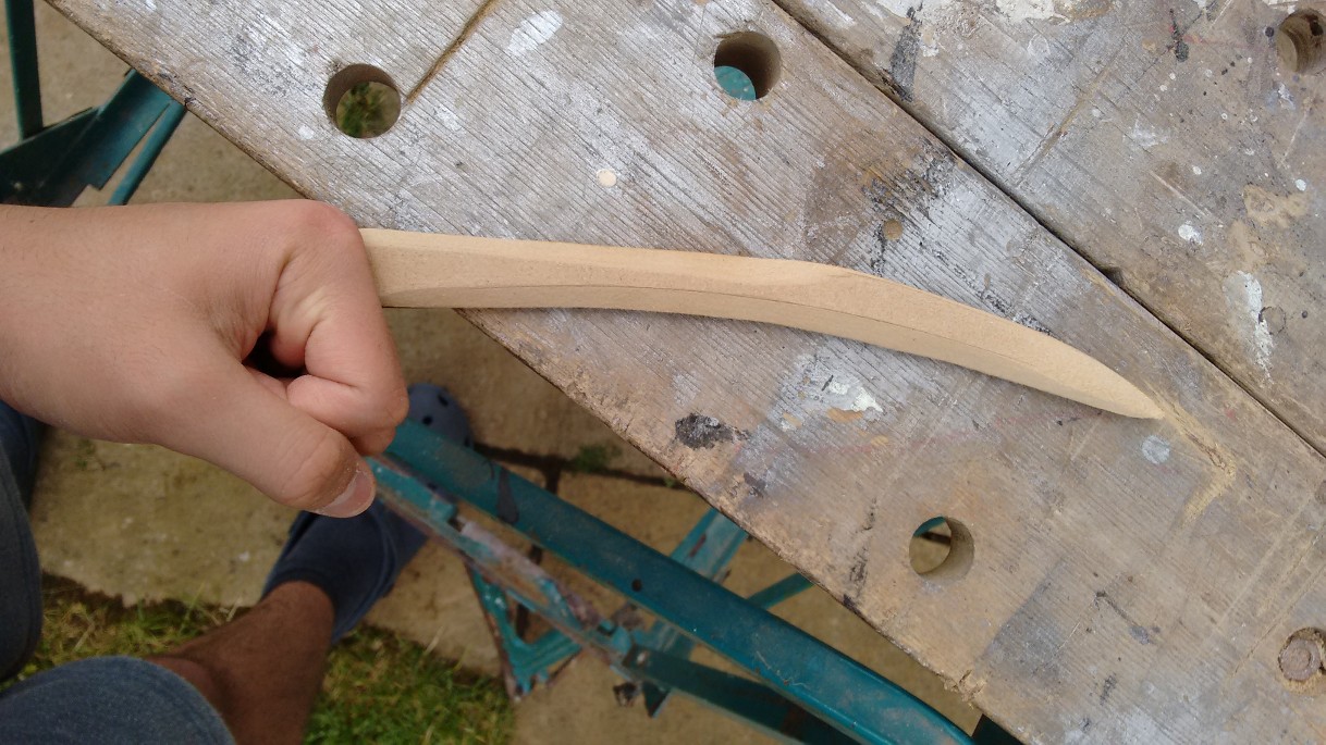

I actually found some more images and ended up choosing to resize it, its difficult because my fist isn't as big as Hugh Jackman's, I'm only seventeen, so I'm designing for an adult fist, and not my own.

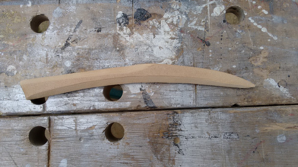

I've now started the sanding, I'll take my time with this because the shape and curve of the claws I'm after is quite difficult to replicate.
I've almost finished the sanding for the claws. Using MDF has some problems, the sharp end frays, and if it is wet it expands. So I will have to coat it in something so I can continue to sand it.
I'm still slightly worried about the size as well, the screen used claws I had found on a Prop Auction site said they were 9" so it may just be the size of the bevel.

I'm still not 100% happy with the size, the claws in my opinion resemble the film claws, but may be too small. during the prototype stage I had cut several sizes of the MDF claws, so I may sand one of the larger ones to shape to see if it looks any better.

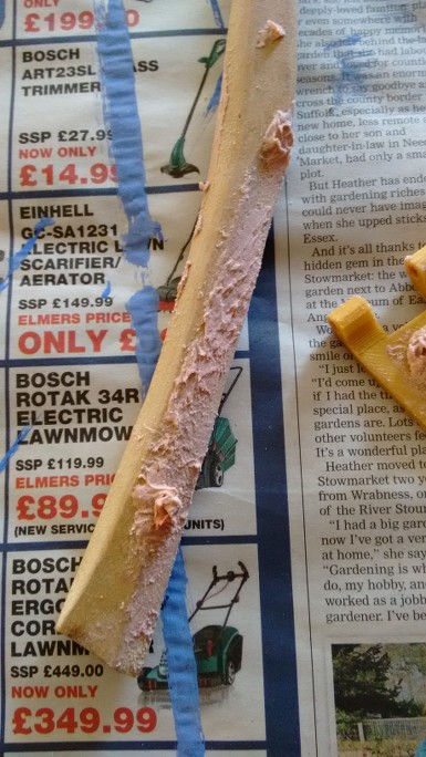

Today I had added some bondo to the edges, to make sure they are clearly defined. I'm really just trying to make both sides parallel and sharp looking.

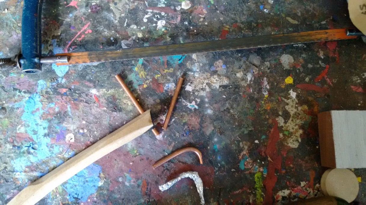

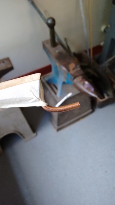

I also cut and shaped the metal wire that will connect the claws to my fist, and that came out quite well, a tight fit to my fist.
