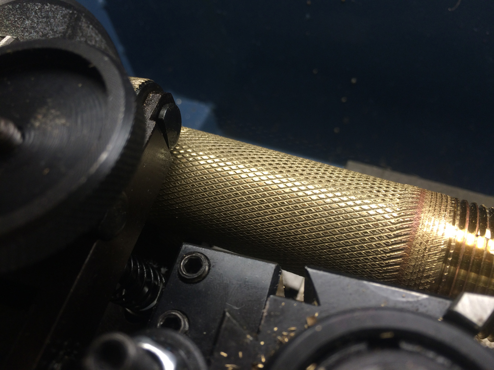

I decided to machine a few of these lights. The originals were magnesium powered and had a big flashlight bulb inside. I'm making mine cosmetically identical, but the internals are modernized to fit regular AA batteries and an off-the-shelf Maglite xenon bulb and reflector. Testing the knurling pattern on a piece of brass pipe:

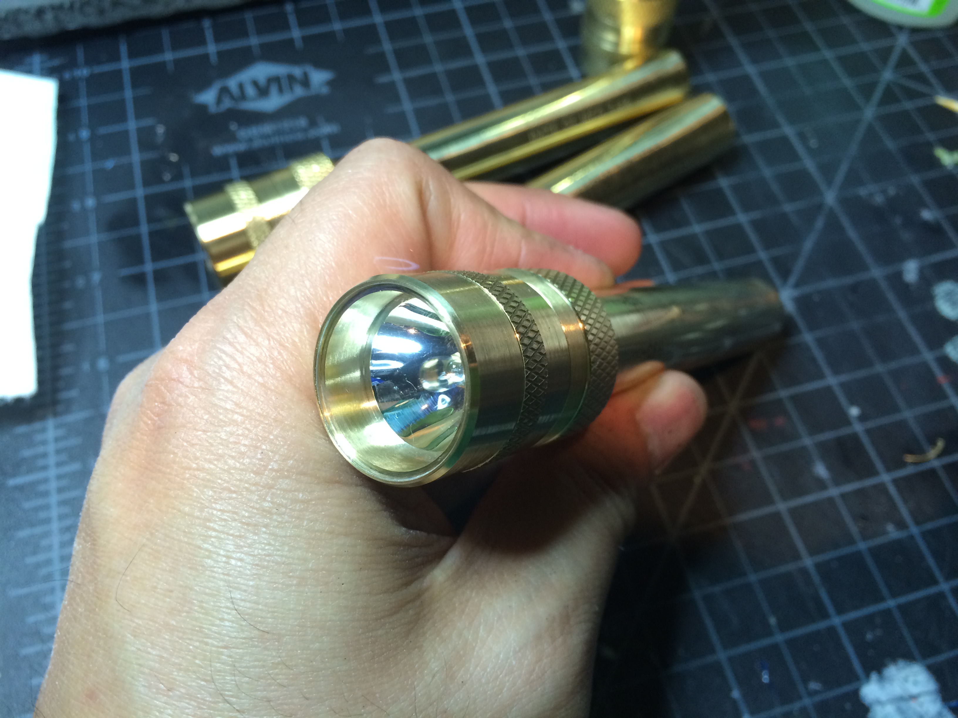

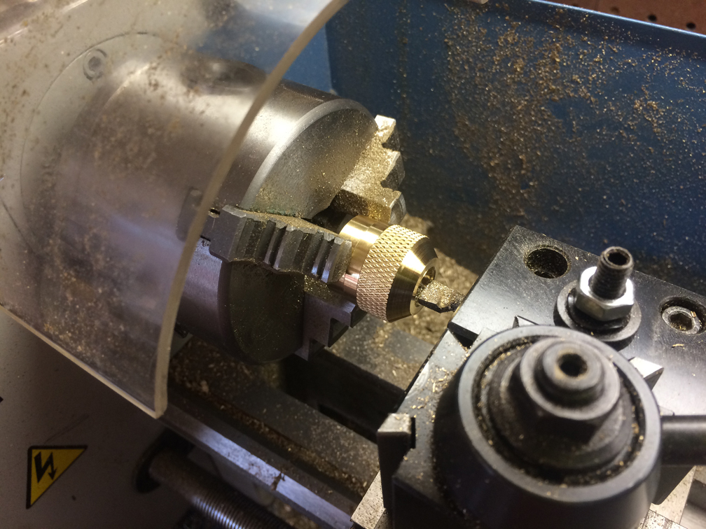

Machining the parts to fit the reflector:

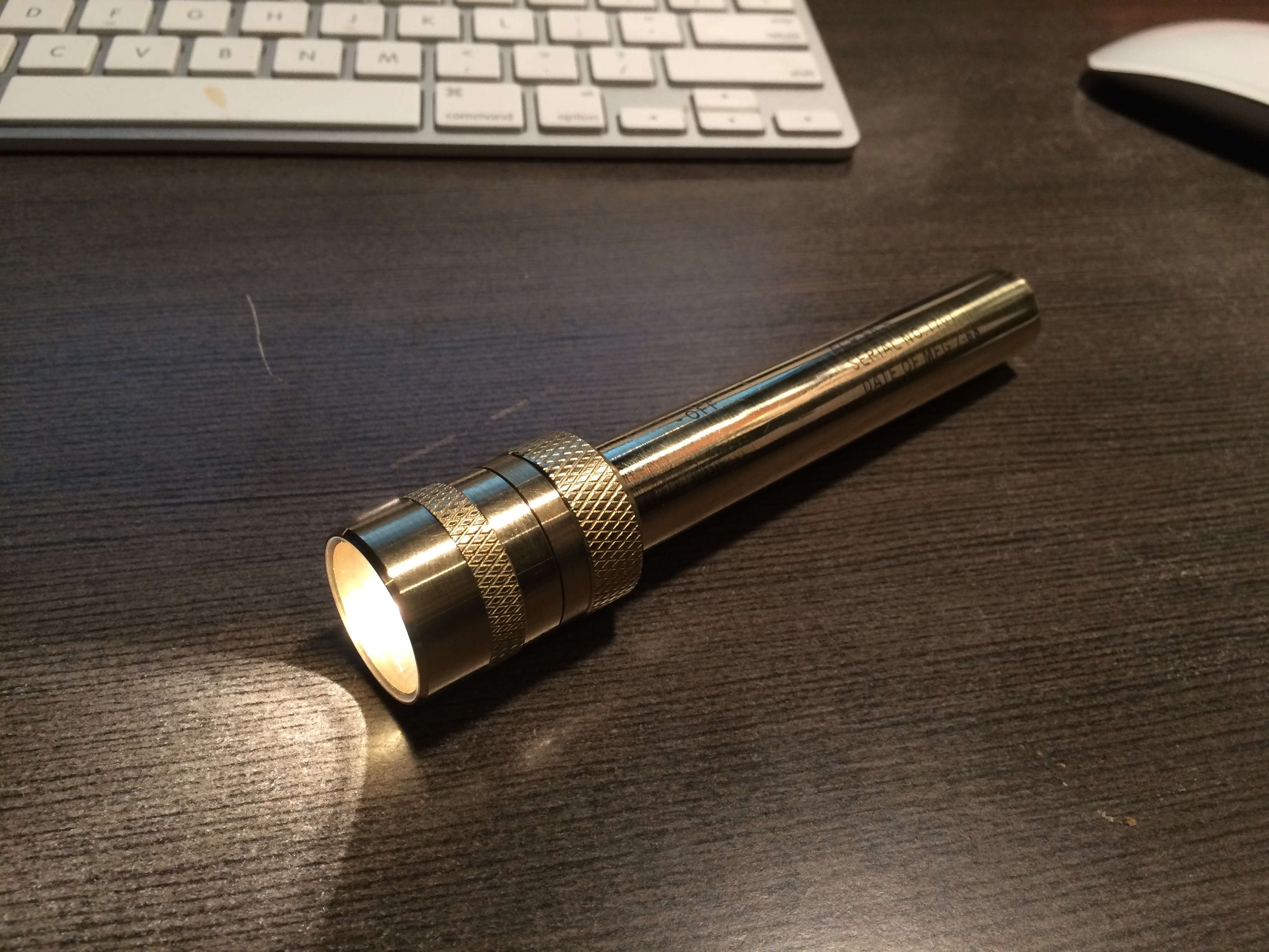

Did an acid-etch test on a scrap of brass pipe. I got some custom vinyl stencils cut and soaked it in an acid bath for 10 minutes. It's a little shallow, so 30 minutes will probably do the trick:
