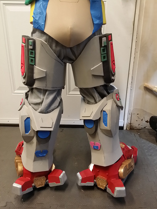

LEGS:
For the legs, I started off with the papercraft templates I had scaled up and began building the lower legs.
I bought some Dollar Store flashlights, and cut them up to make the lights in the front and the back.
With those added, here is what the foam lower legs looked like:
I then built the upper leg:
After getting them all created...(and the waist piece, I got my 7yr old into them to make sure they fit!
Things check out, so I hit these with plasti-dip!
Then I applied the Adhesive Promoter, Auto Paint and model paint...
I don't have these detailed yet (no weathering/damage yet). But here's what they look like currently...

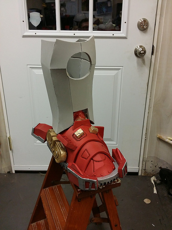

Workshop is a bit of a mess right now, but I'm working as fast as I can and don't have time to clean!
Sitting on the desk is the start of the back in 5mm foam. That will be attached to the wood frame sitting on my chair at the bottom of the image.
That framework is the support system for the chest piece.
Here it is closer up and below is how it fits on my kiddo!
He will look out from the chest (above the arc reactor and below the hulkbuster head piece). I'm planning to have the massive Hullkbuster arms mounted on the sides of this frame. He will be wearing black long-sleeves and be able to reach into the forearms of the giant 'dummy-arms' to move them around and poise with them.... at least that's the plan.
Here is the center piece of the back panel. as I'm starting to work on it.
Last evening I finished up most of the details and added the four lights. These are (again) Dollar Store flashlights, that I've pulled apart. For this application, I'm only using the HOUSING of the flashlights... I've pulled out all the flashlight LED's and simply stuck in LED's from a single strand of battery powered Christmas lights. This allows all of them to be on one set of batteries and controlled by a single switch.
And that was where I left it last night... hopefully, I'll have more to add this evening! :)
