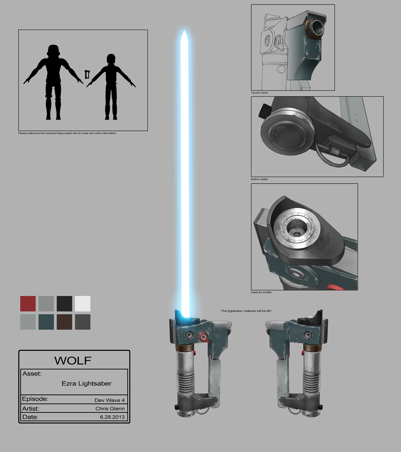

I have designed up Ezra's Light Saber but I think I have messed up the scaling. Obviously, I would like to fix any issues before I print up to much.

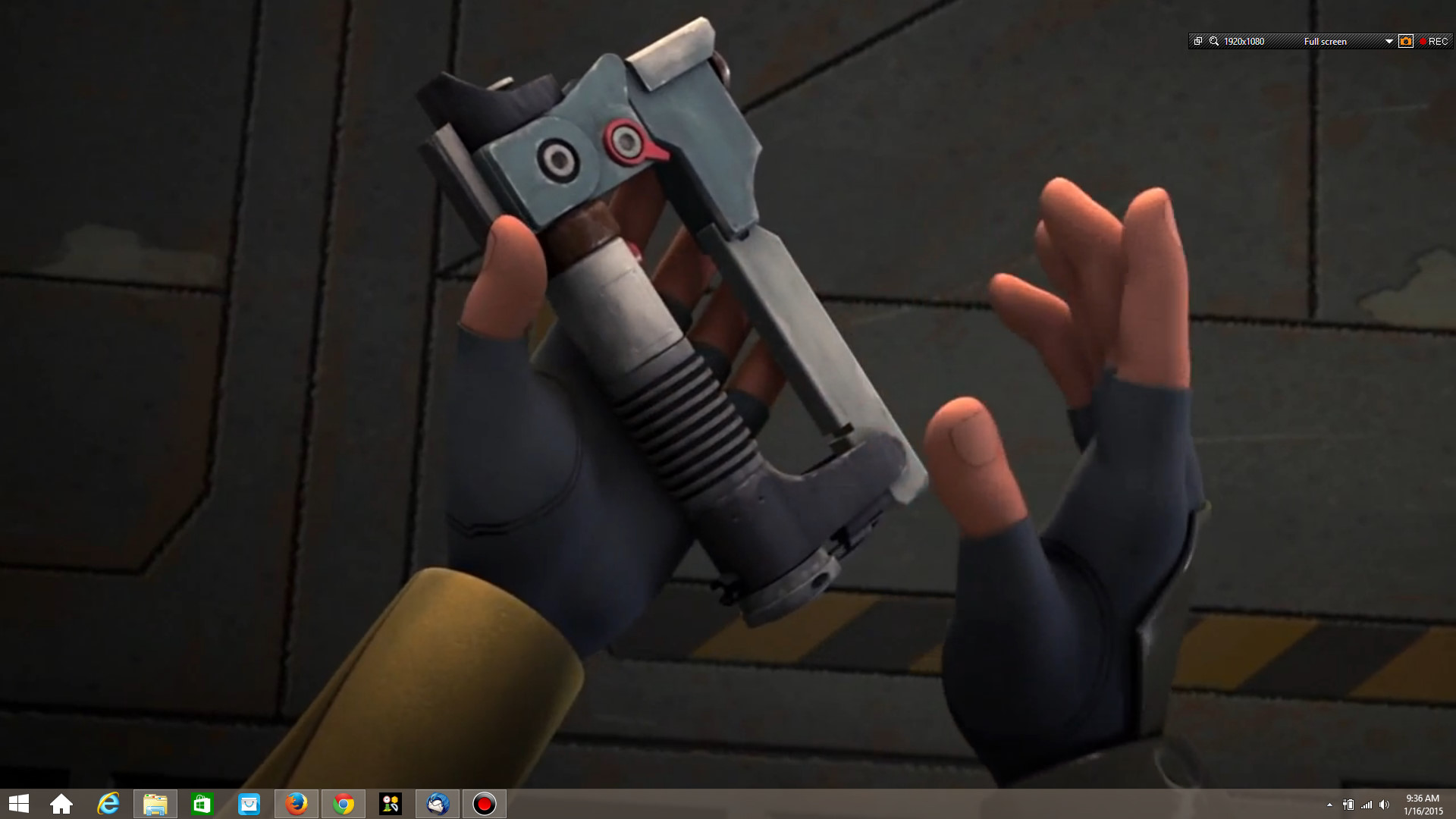

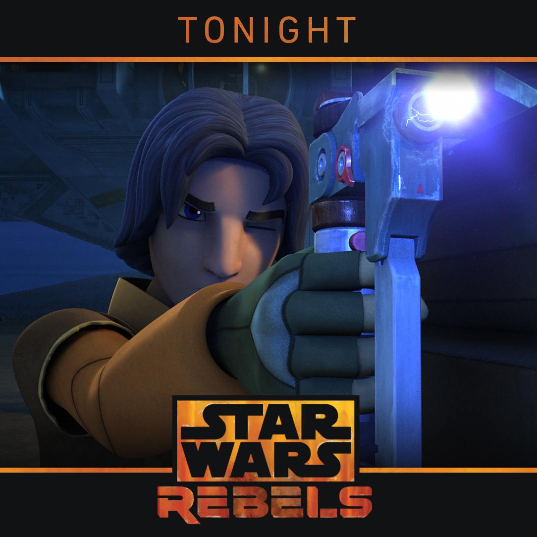

My scaling started with this screen grab from the episode "Path of the Jedi"

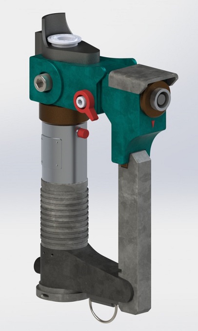

Based on the size of Kanen's hand and using my own to scale, I figured that the hilt had a diameter of 2". So I came up with this as my final design...
Overall Dimensions 2-1/4" x 7-3/4" x 12-1/4"
I'm starting to wonder if my scaling is off. A 2" diameter hilt is a bit big for me, it would probably be HUGE to a 14 year old. I've been looking at http://www.thecustomsabershop.com and most of their main bodies are 1-1/2" diameter.
I really want to get going on this build, but I don't want to waste time and effort on something oversized.
Thanks
ARKM

From those pics and from watching the series, to me the lightsaber's overall length looks much smaller than 12" (it's a 1 handed saber after all and in a young teen's hand which can be considered smaller than an adult's) and around 1.5" or less in diameter where the rings are on the lower part of the handle area.

I made a model of it and I'm pretty happy with the scale. I have the upper (lighter silver) section of the grip as 1.5 inches, and my total height is just a hair over 10". I can post a picture in the morning of how it lines up with my hand, but I think that's pretty close to accurate size.

Alrighty, I think you all are correct, thats why I asked the experts :cool I'm not sure how I came up with 2" for the hilt diameter, but that's not important.

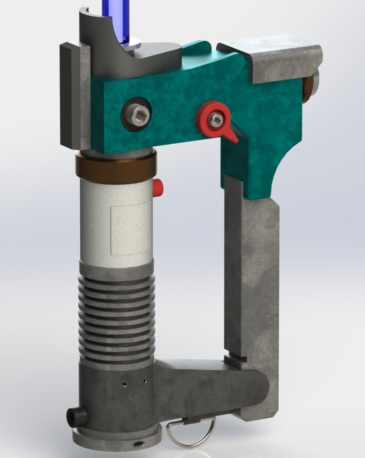

I spent all morning rescaling and tweeking my model.
Now the overall height is 9-1/2"

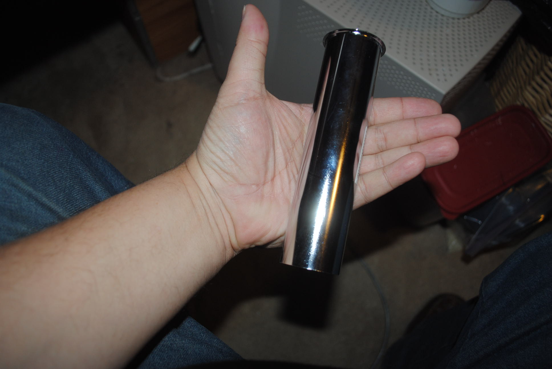

I guess this is as good of a way as any. I just purchased this tube to be the upper part of the Hilt. It is 1-1/2" dia.
And compare it to the screen grab
it is very obvious the Hasbro version's hilt is to big by about 25% (the same problem I had originally)

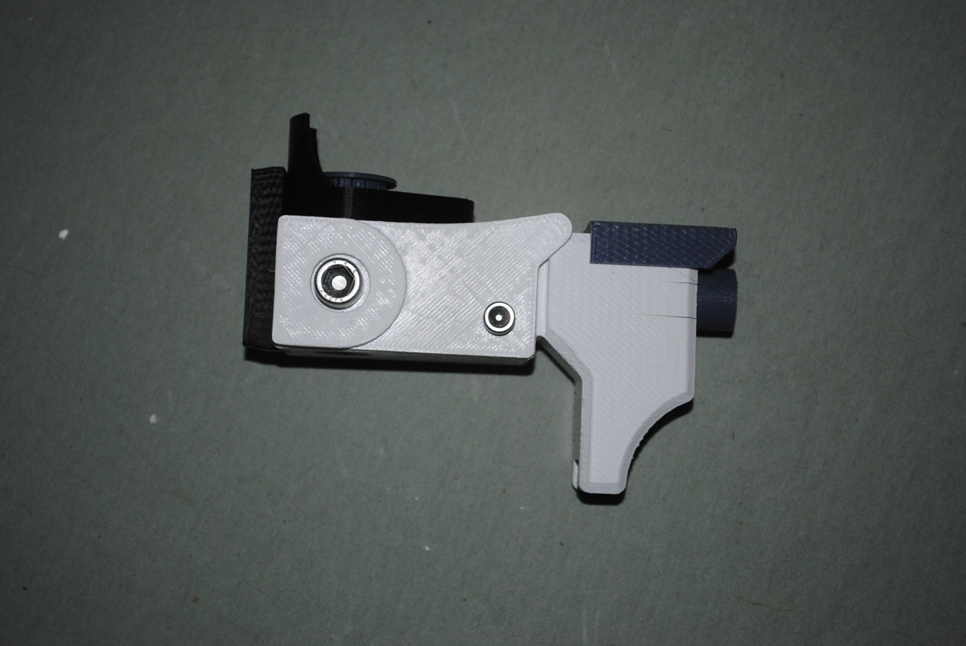

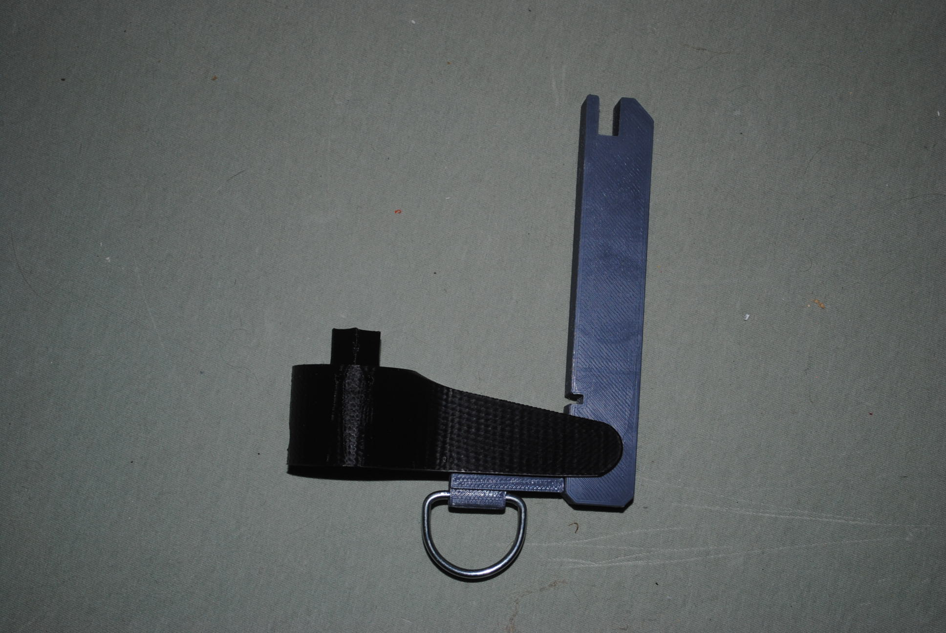

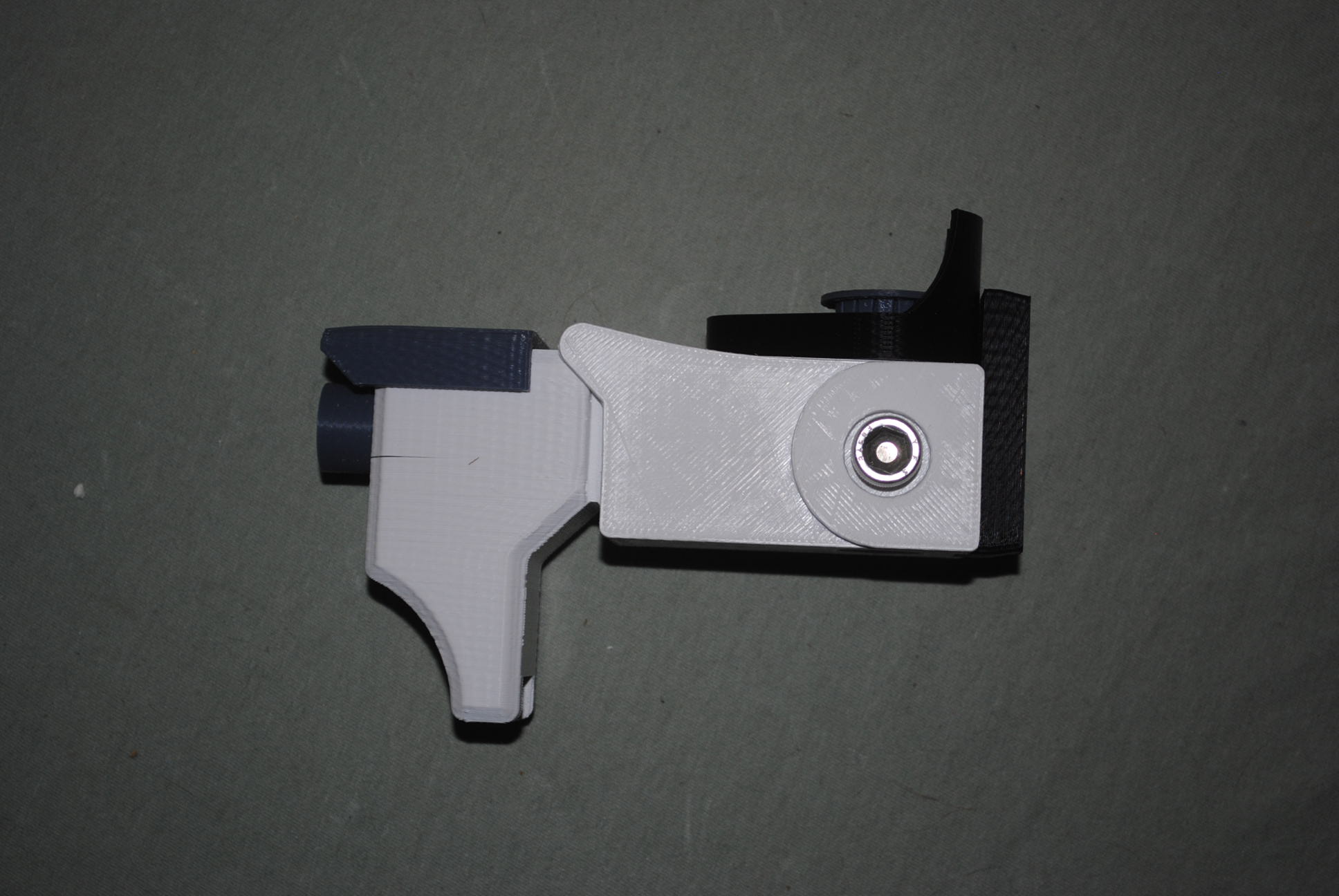

Here are the first few parts of Ezra's Light Saber. This is a test to see how everything fits.
Prototypical
A few more parts done. I have to remake the clamp because I fat fingered a dimension (opps). Unfortunately the Pommel does not fit at the moment.

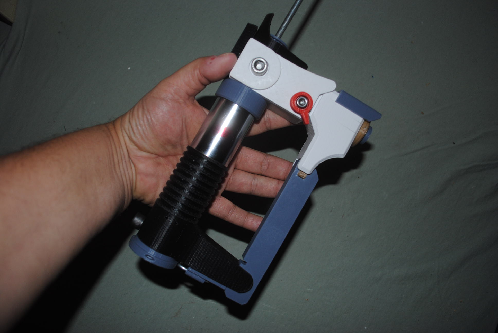

Here we go
The Printer is up and running, even with the USPS trying their best to delay me.
Right now, I'm trying to fit this in between other projects. The good thing is that most of the 3D printing is done, all I need to do is finish work.
Yes, that is a 1/4 threaded rod sticking out of the top. And yes, it will get cut back. And the 2 red spots are locations I have to drill holes.
