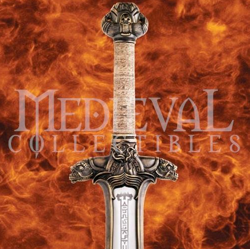

According to their Photos it looks good, for those on the RPF with Atlantean Swords how does this Compare?
The Atlantean Sword From Conan the Barbarian - 884016 by Medieval Collectibles
Availability : Ships in 3-4 days.
The Atlantean Sword is hand-forged from 1085 high carbon steel and tempered to 52 HRC for strength. This swords has been expertly reproduced by the master craftsmen at Windlass Steelcrafts, as an exact replica of the sword used on screen from the movie Conan The Barabarian. From the intricate details on the guard and pommel, to the deep runes on the powerful blade, this is truly a masterful reproduction. The Atlantean Sword comes with a Certificate of Authenticity. The Atlantean Sword is a fully functional sword.
Key Features: Hand Forged
1085 Carbon Steel And Tempered To 52 HRC
Intricate Details On Guard And Pommel
Comes With Certificate Of Anuthenticity
Licensed From Movie Conan The Barbarian
Measurements: Overall Length: 38-7/8 Inches
Blade Length: 28-1/8 Inches
Weight: 8 lbs
