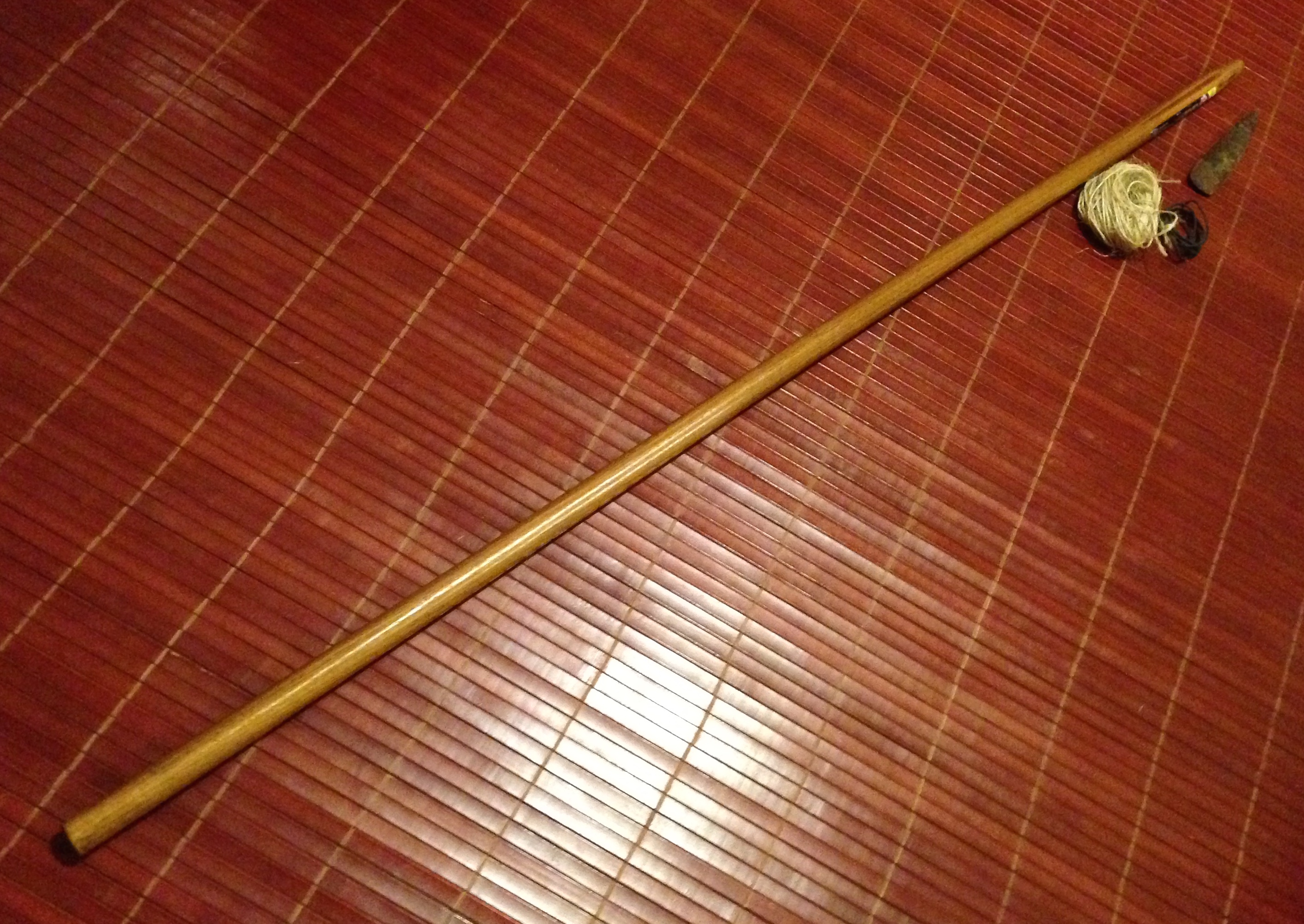

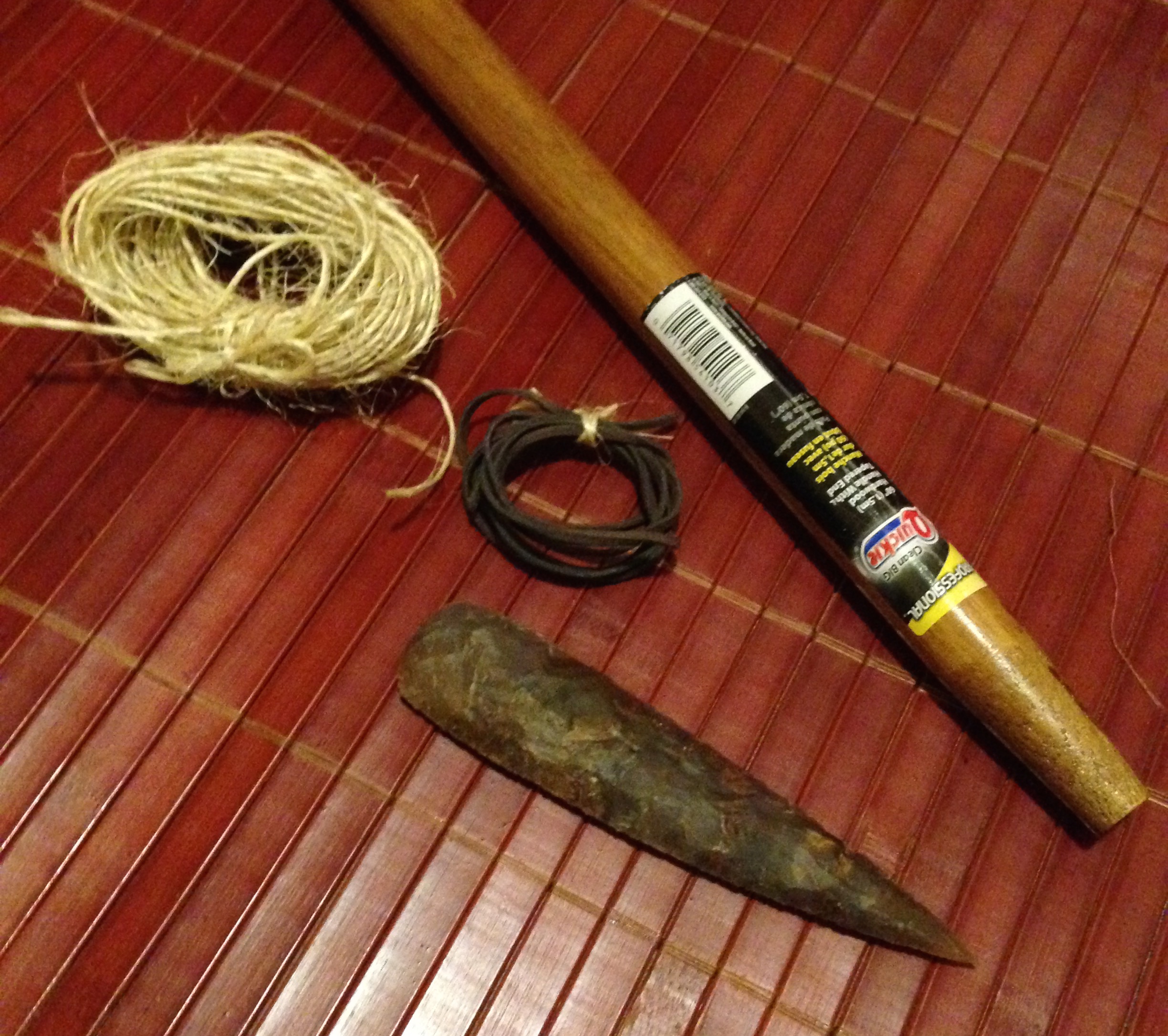

He also came with a real stone spear tip, rope/twine, and leather strapping. After an initial look around the area to see if i could find a proper tree branch, I decided to just go with a broom handle from Home Depot. I will sand it down, rough it up, and maybe add some numbs so it looks like it once had small limbs growing and finally some sort of finish for color.
But before I start, I need to know where to cut.

Below is a pick of the broom handle i will be utilizing and the spear head kit that came with my Wicket.

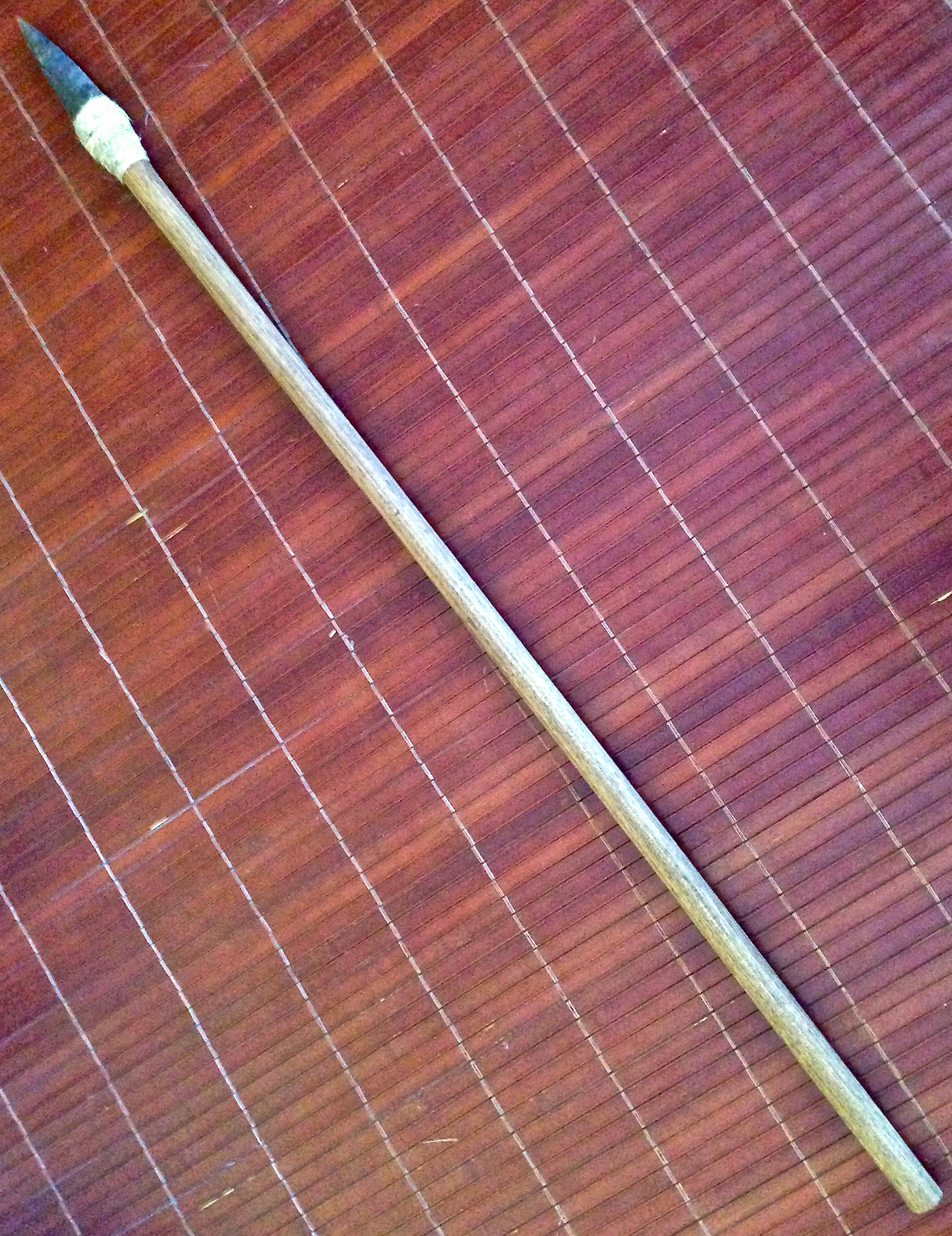

I finally got to this project. I built it the same way Native Americans did over a hundred years ago... with a Dremel and gorilla glue. What? That's not right? I got it from Wikipedia so it has to be right.
Seriously...
Here are the results...
The pictures really don't do justice to the actual work involved.
  • I first used a drill to get a slot started for the spear tip to sit.
  • Enlarged the slot using a grinding wheel on the Dremel.
  • Used a 2 part epoxy by Gorilla Glue to secure the spearhead in place.
  • Wrapped the twine around using layers of Elmers glue and burned off the loose threads.
  • Measured out 50" from the tip and cut the shaft to length.
  • Used a sanding wheel on the Dremel to taper off the cut end.
  • Utilized same Dremel sanding wheel to remove finish and create an uneven surface along the entire surface of the shaft.
  • Lightly sanded shaft to remove roughness.
  • Applied Linseed Oil to darken wood.
  • Used steel wool to dull finish.
  • Applied a brown paint and water mix to dirty up twine and highlight flaws in the shafts surface.
