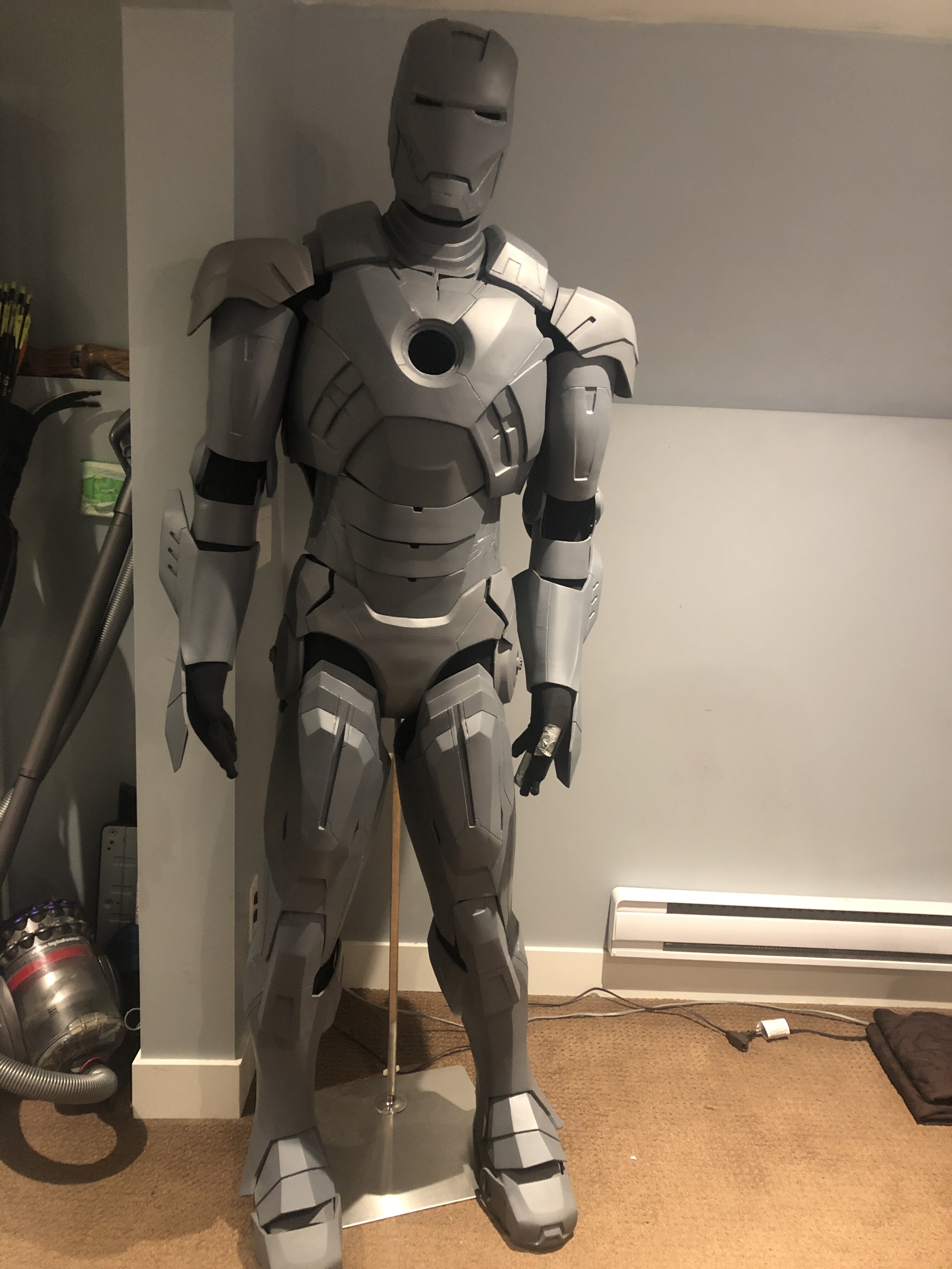

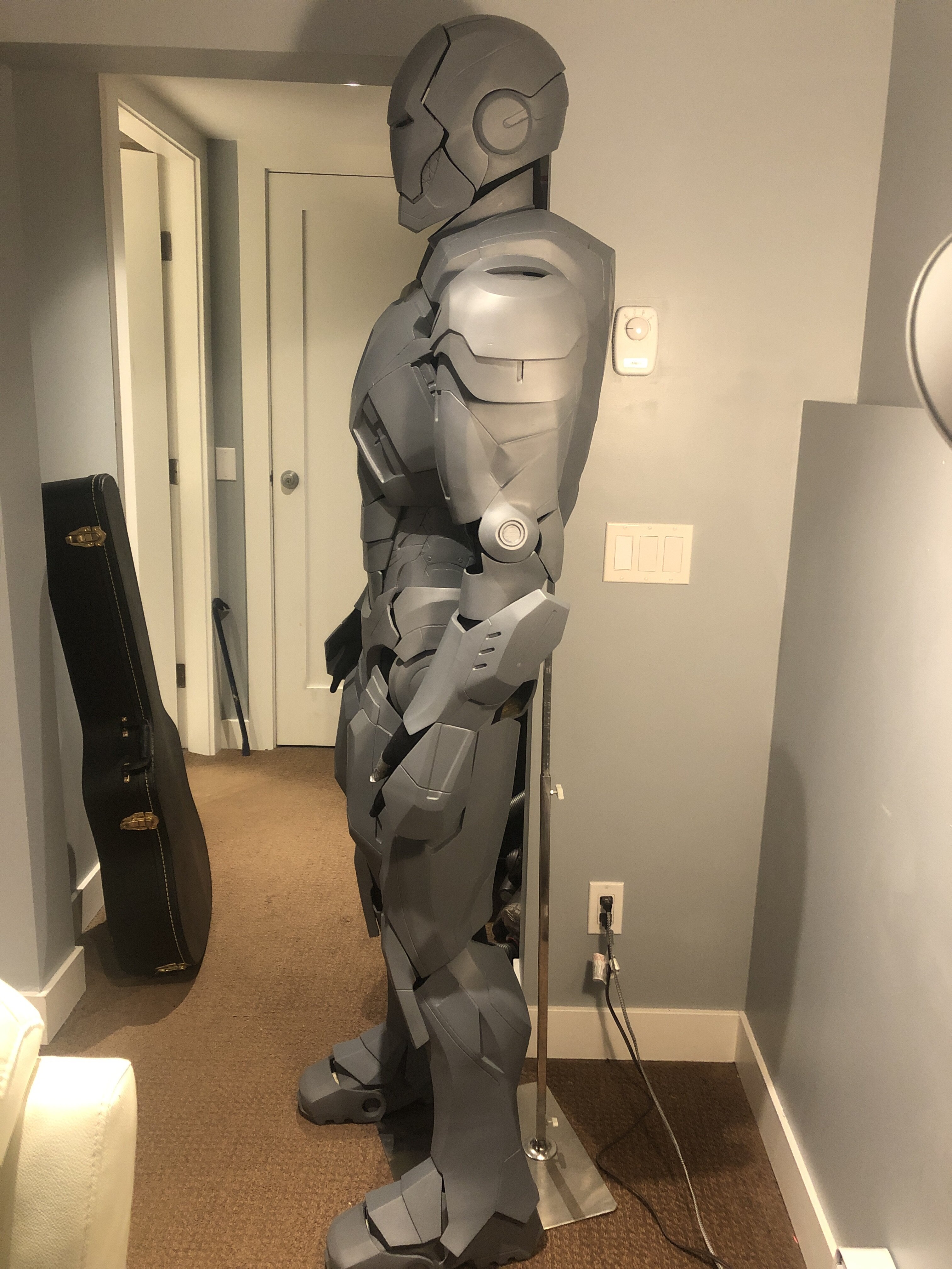

Thank you for the tips. Here are some current photos.
This is him right now. Everything is 100% scaled except for the helmet which is 110% because I have a fat head. He's about 6'2"ish.
Printed on gold ABS, and primed with grey paint.
Just gotta print and build the hands although I'm having a hard time finding the best files for them.
