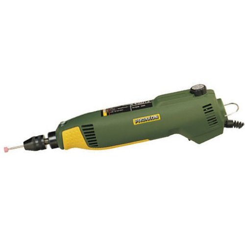

I had a Proxxon FBS for years before I switched to a flex shaft. It never failed me. I used it to carve wood, antler and gemstones (a lot) . I had to buy something else when I accidentally broke off a pin in the drill chuck.
I always have used a Proxxon at my workplace,
Dremel at it's lowest speed settings melts most plastics, Proxxon has a lower speed setting that is perfect for plastics,
if you want to do routing then Dremel is better, real handwork is proxxon better
This type has a real drill type head that can handle minute drills (or anything else) or larger up to 3.2mm
