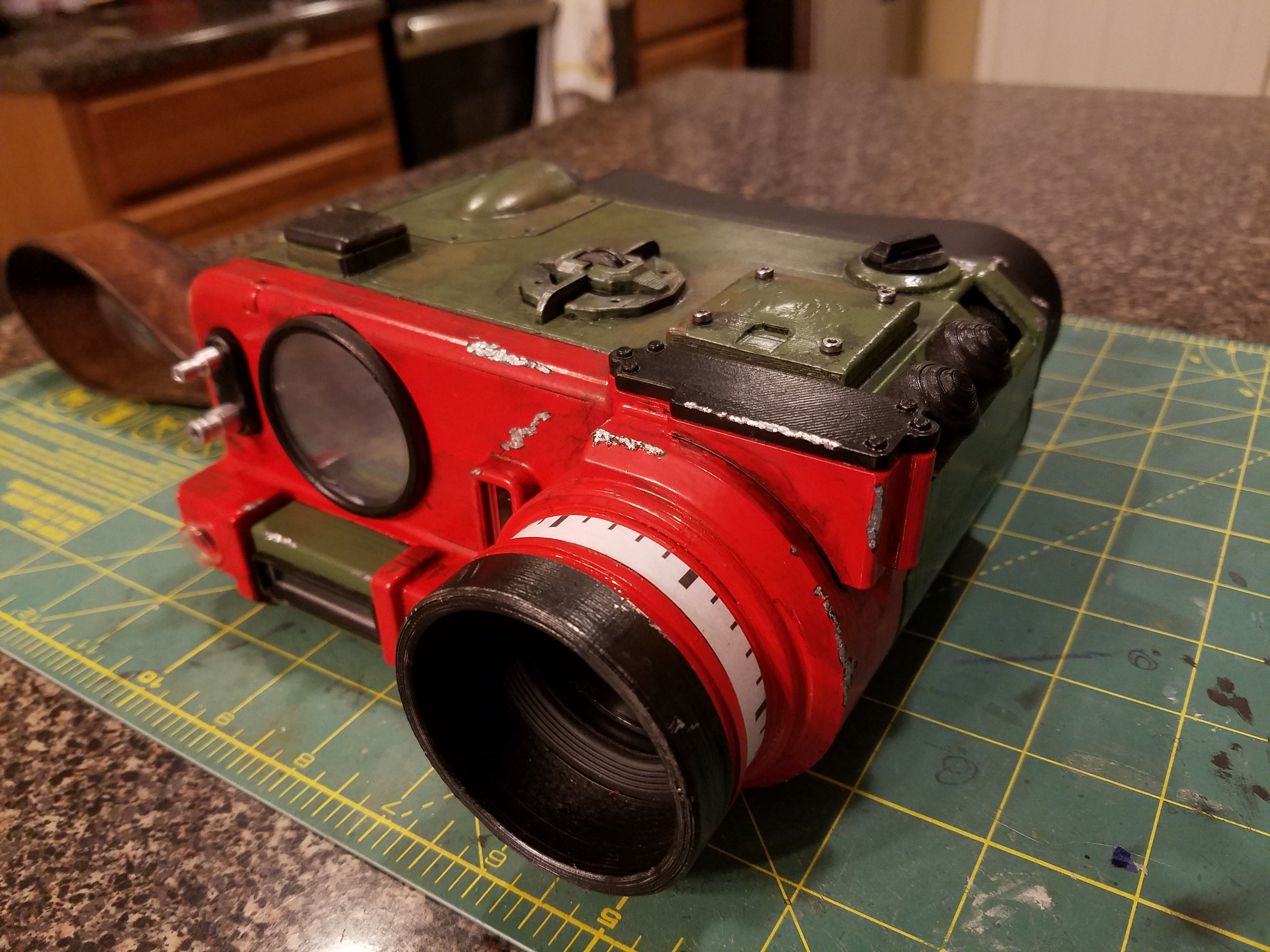

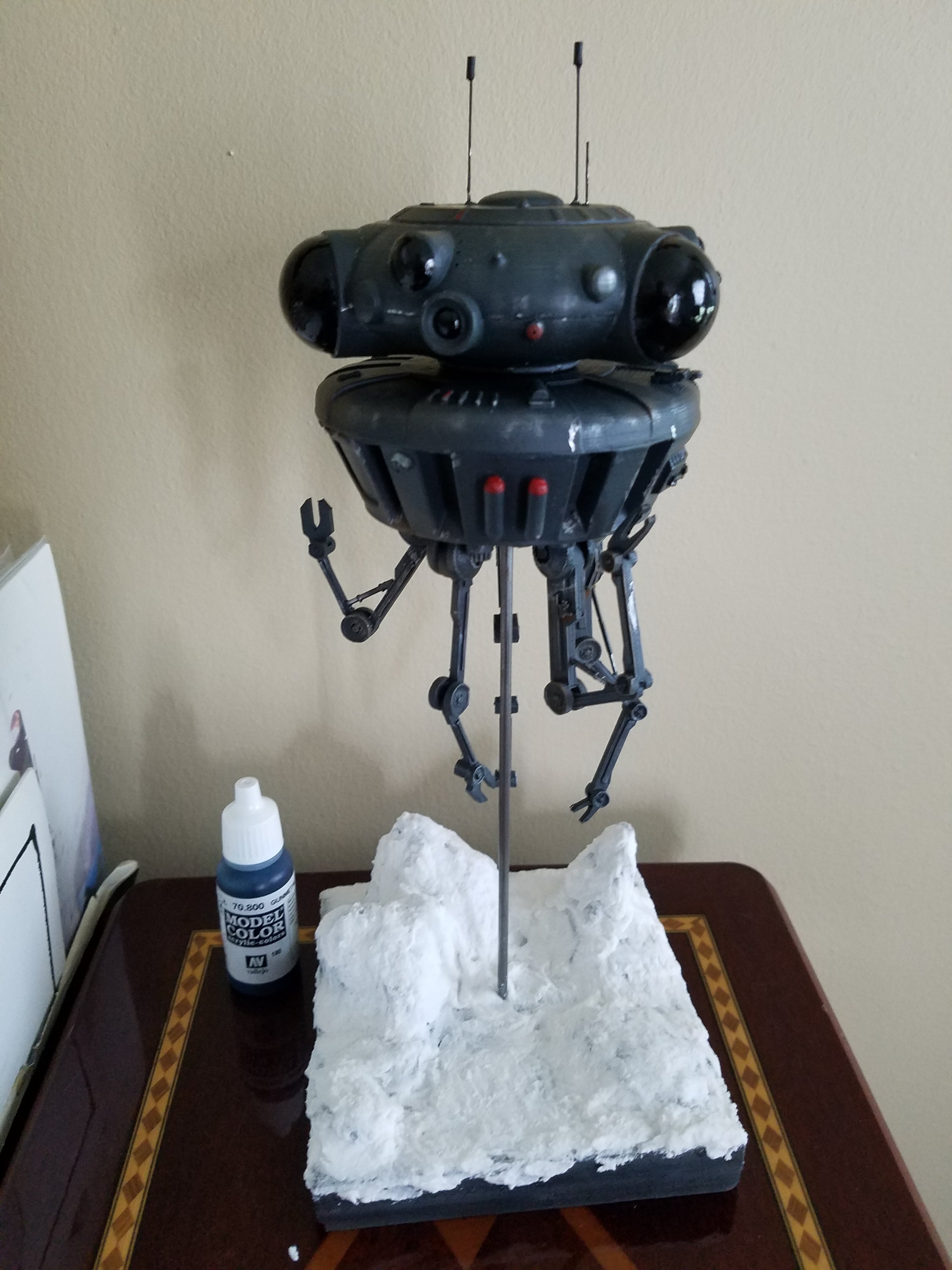

I've been loving the hell out of my Ender-3. Tons of community support, great reviews, and it's super easy to use and does amazing prints at 0.1mm layer resolution. Here is a pic of my first try, a large Probe Droid, the, I printed the Bladerunner 2049 binoculars, and currently I'm almost done printing K's gun. I've only had it for maybe 3 weeks?
